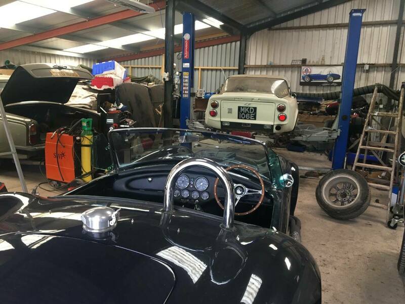

Not a huge amount achieved today, though I did tidy* up a bit of the shed (I moved shite around) and changed the order the cars are parked. Today was that rarest of rare days, warm and sunny in the North East of Scotland and despite having loads to do, nothing with a pressing deadline. Decided to take the Cobra to fetch milk from my local shop 4 miles away. Thought I would take the scenic route over the hills, and arrived home about 3 and a half hours later with my milk, having covered 147 miles.
Must resist a repeat tomorrow as I have a lot to do, but a test run in the Sonett is looking more appealing.....

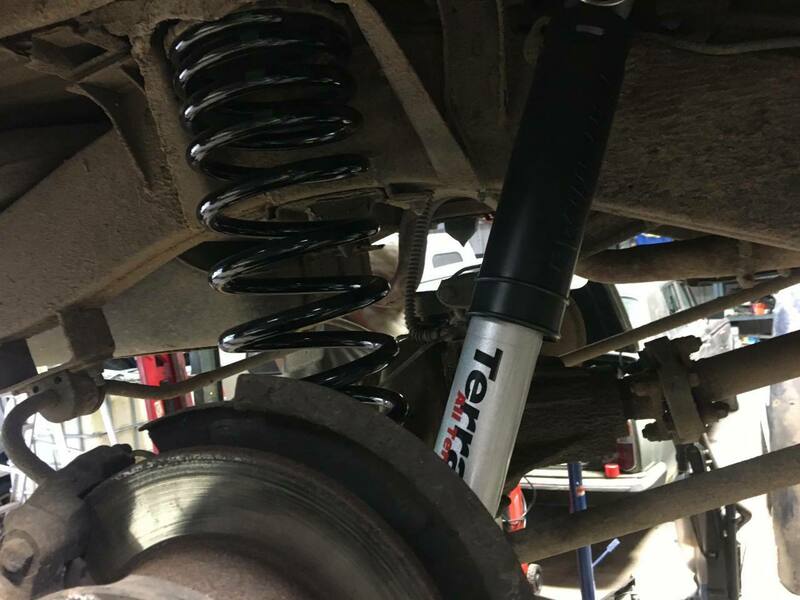

|The old rear suspension put up a bit of a fight, but Mr Angry Grinder won the argument
By the time we had had enough, the rear suspension is done and most of the front suspension is off. Hopefully finish it tomorrow

No photos, but the rest of the suspension swap on the Disco went smoothly. I decided to replace the front turrets as the originals were showing a bit of delamination as I had bought new ones, although the old ones would have been fine for a few more years. The reason for buying them was I wanted to have new turret retainer rings on hand and every source said they invariably shear when being undone. Mine of course came off with no  brakeage and the quality was so much better than the replacements, I decided to give them a clean, a coat of paint and reuse them. The replacements can stay on the shelf "just in case".
Replacing the original EDC injection pump for a manual pump (the EDC is only fitted to the automatic 300TDi) hand fixed the lack of power at the cost of losing the kick down facility on the auto box. A bit of googling (OK a lot, there is not much info on these out there) suggested Armstrong Transmissions offered a set of brackets to get around this at a cost of around £60. Took a chance and ordered a set and two small metal brackets (admittedly of what looked high quality) arrived, and as my knowledge of diseasals is zero, my friend Gary fitted them, although neither of us had high hopes, and no instructions were provided. A short test run showed we were wrong, kickdown restored and £60 well spent.

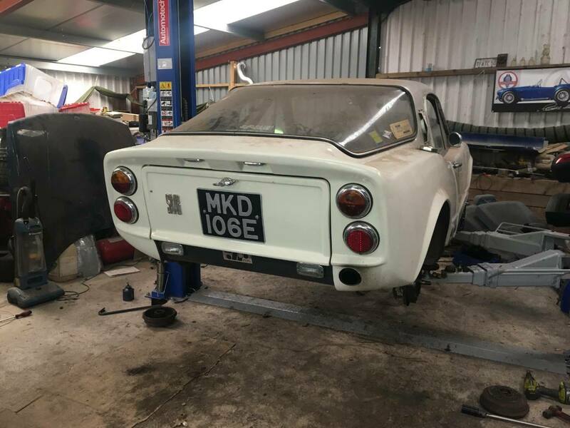

Today, I moved the Sonett out of the shed, planning on giving it a clean as it has 3 years worth of dust on it. The reason for the sudden flurry of activity on both the Sonett and the c900 is they are due at Prescott Hillclimb next weekend. The Sonett is going up the hill at Saabfest and the c900 is towing it down. Happy I was ahead of schedule, this morning was spent putting a new exhaust on one of the fleet for its new owner, a fellow Shiter, so will let them introduce it if they so wish.
When I moved the Sonett out I noticed that the brakes appeared to be binding, so thought I would give them a strip and clean. Onto the ramp with it
Straight away it was obvious that the fronts and offside rear were turning freely but the nearside rear was really binding badly. Pulled off the wheel and drum and sure enough the wheel cylinder is seized solid. Pulled off the offside rear to check that and again one of the two pistons was seized. Great. It was now 4:45 on Friday evening, and I have to leave home early next Friday morning. Shot inside but none of the usual suppliers were showing any in stock and the only ebay sellers advertising them are in Germany so no chance of getting them in time. Tried to ring Bill at Saabits to see if he had any suggestions but they had finished for the weekend as it was now after 5pm but left him a message.
Gave up on that and resigned myself into spending the weekend contacting any Saab people I could think of to see if I could even get a secondhand set, so put the kettle on. Whilst drinking my tea, the phone rang and it was Bill returning my call - at 6pm on a Friday, that is what I call service. After explaining my needs, he went off and came back a couple of minutes later to say he had a couple on the shelf, but without boxes, hence not listed on his website. He said he will send them by Special Delivery for me and at a very reasonable price. If anyone wants anything for a Saab, I cannot recommend Bill at Saabits too highly.
As the Sonett is in bits blocking the ramp for the weekend, just got to decide what to start on tomorrow....

Thanks to Bill at Saabits and Royal Mail, the new cylinders arrived on Tuesday afternoon and were the correct parts. New wheel cylinders fitted, bled through and handbrake adjusted. Bleeding was fun as the bleed nipple is below the pipe on these, so pipe was pushed through the back plate, cylinder connected upside down, bled then carefully turned and attached. All sorted and out of the shed last night, just in time for a downpour of biblical proportions that washed some of the dust off nicely.

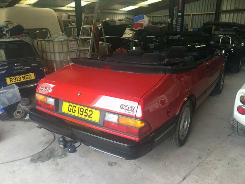

Today I bailed out the back of the 900 (the roof leaks below the rear window and it gathers in where the parcel shelf should be and makes an annoying sloshing on corners if you leave it) and the boot loaded with trolley jack, trailer spare, dugga gun, tent, air bed etc ready to go. Then the small trailer was hitched on and the Sonett loaded and strapped down. The 900 was then parked in to the barn as it was looking like another storm was on its way and I can't be bothered bailing it out again. Of course it was just a few spots....
The 900 has done 40 miles since its MOT after spending the last 2 years parked up waiting its turn. The Sonett has driven about 20 yards since a new ignition system and brakes after 3 years of sitting in the shed. Tomorrow I will leave home about 6am and head to Prescott, a mere 444 miles away. WCPGW? :-)

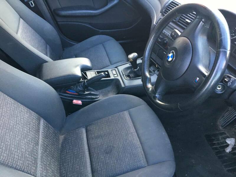

No, I have not bought it! A friend of mine is going to re-engine his coachbuilt Mk2 Transit Camper and is going to use a BMW 2litre diesel as it is such a compact engine and a standalone ECU is available giving it 211bhp. This engine means the transplant will be fully reversible should it be wanted.
It is a 318 or 320D with 127k miles on it. Everything works on it, bit of surface rust and a crack in the windscreen being the only faults so far. He wants me to put some miles on it (it has 9 months MOT) to make sure the engine is good. Of course he phoned me to say he has bought another engine/box/etc on a pallet today, so this one may or may not be needed. I will run it for a while (after all it has a BMW "M" on the steering wheel) and if anyone offers the £850 he paid for it, it will go, otherwise it will be broken when the MOT expires and the engine will go on the shelf as a spare.

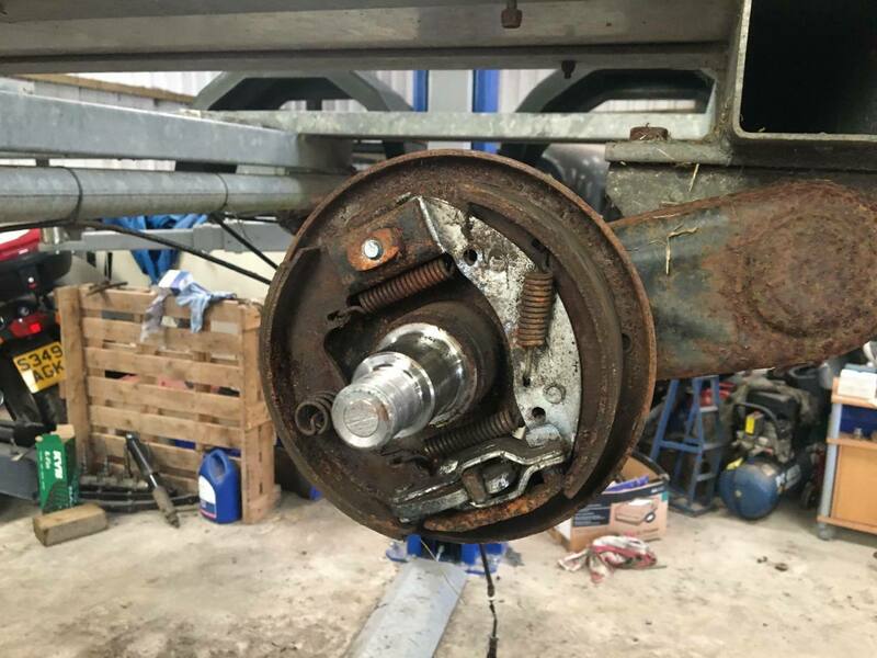

So, at the weekend out came the strimmer and the trailer was released. Of course, all the brakes were seized solid and 3 of the tyres had cried "enough" and whilst still being black(ish) and round(ish) no longer held air. First thing was to order 4 new ones (Toyos for £117 delivered for 4) and then to look at the rest. Now, there are two thing I hate, working on brakes and working on trailers, or at least there used to be. The 2 post lift has changed all that
First job was to remove the drums/hubs
Which put up a fight. The hubnut covers took ages to get off (the trailer has not been touched and only a used a couple of times since it was built over 20 years ago and then the nut needed a 36mm socket which I do not have. Managed to borrow a 3/4" drive set but even with that I could not release the nuts, which according to stickers inside the nut covers should have been 280nm. Found a 1/2" to 3/4" adaptor and the Ryobi dugga gun made short work of 3, but the 4th would not budge. Eventually I got my big air dugga gun (680Nm) and that struggled but eventually it came off.
Next the cables came off, but I could only get 3 to move, and 2 of them were not great. I was plesantly surprised to find 4 new, genuine Knott cables, 2 x 930mm and 2 x 1630mm delivered was only £56. I have ordered those, freed off and lubricated all the brake mechanisms and got the handbrake lever moving freely again. Now, waiting on parts.
I wish I had bought a lift many years ago!

no envy for your workshop..... aye right.... at least with trailer brakes there is no leaky fluids

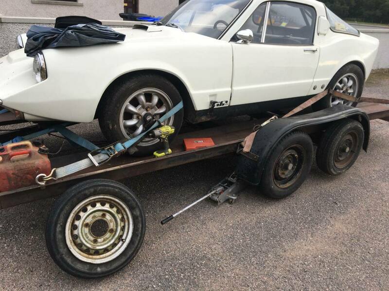

After that had gone, I started to load my trailer that I had been working on this week ready to head to France. Rudely interupted by @hairnetwork stopped whilst tea was drunk. Good to catch up again, hopefully he has made it back home safely.
This morning, loading was completed and many straps appled to secure the load. Tomorrow I will collect a number plate for the trailer and attach the lights ready for heading to Gatwick Tuesday and France on Thursday. I have soom grass to cut.....
