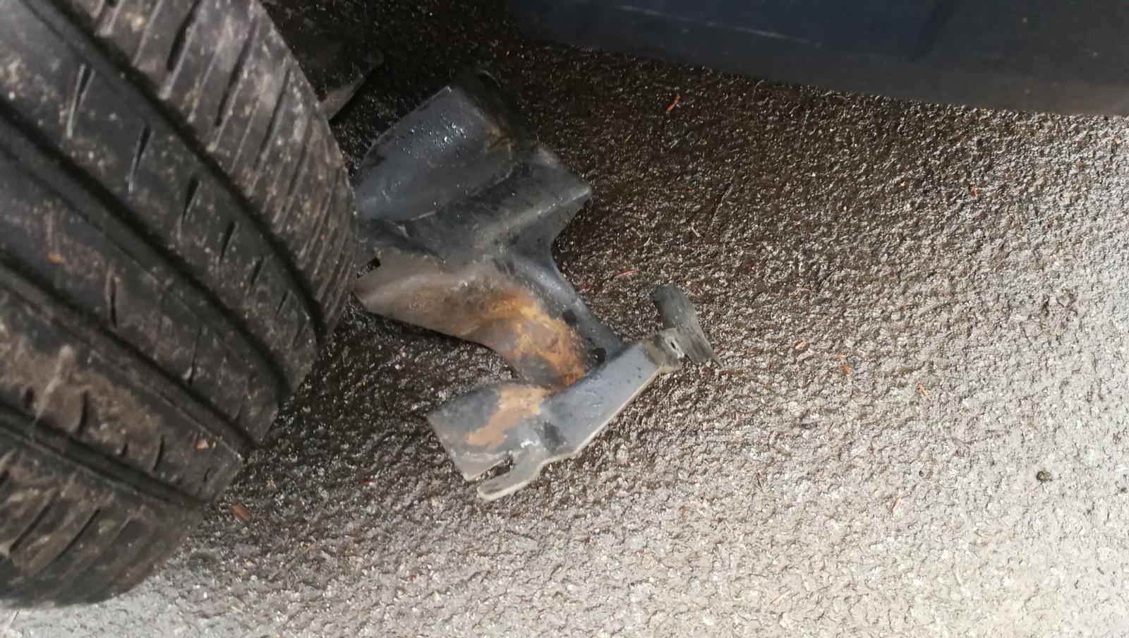

Went out with the good lady for lunch today.
Over a Tuna and cheese panini she let slip that the ole #60, the bastion of reliability was making a noise from the front right.
I enquired as to type of sound and frequency...
1. A rubbing sound almost constantly
2. A clanking sound sporadically
Sounds entertaining.
Anyway, get your Clio in the air and wave it like you just don't care.
With the wheel off, it was relief all round..
The rubbing sound was this piece of arch liner that had detached and was sitting on the bottom arm rubbing on the tyre.

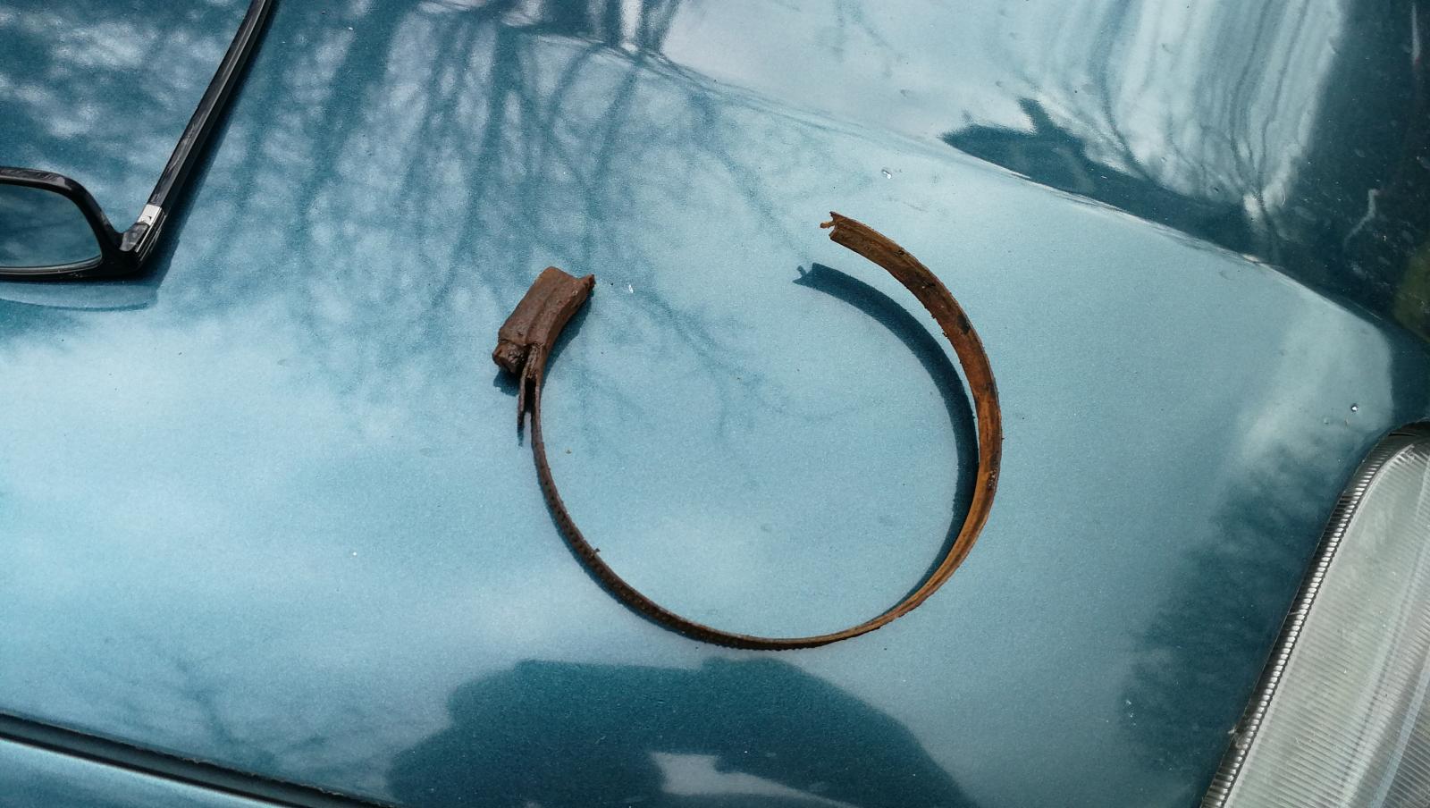

The clanking sound was this jubilee clip that had escaped from the CV boot, and was rattling away merrily on the ARB.
I put everything back together and took it to Halfords, where a new jubilee clip was procured.
For the first time in a long time I've managed to identify and rectify a fault in the same day:)

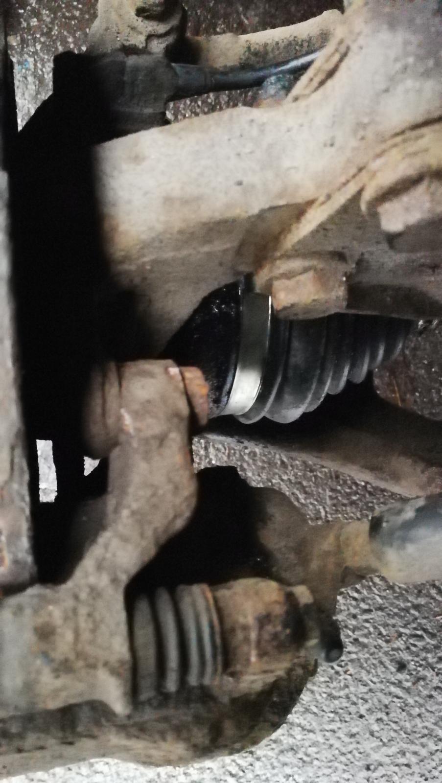

Got home from work, and set to looking at calipers..
Front left binding. Rear left ok.
Front left stripped cleaned and rebuilt - functioning well.
Rear left now binding :(
Stripped, cleaned and reassembled. Now working correctly.
Right rear was binding - this is the one that had the snapped disc, and was stripped and rebuilt when rear discs were replaced.
Despite stripping, cleaning and rebuilding, it is still binding a bit.
If so ever meet the chap who designed the rear calipers on these, I shall boot him in the foof. Repeatedly.
