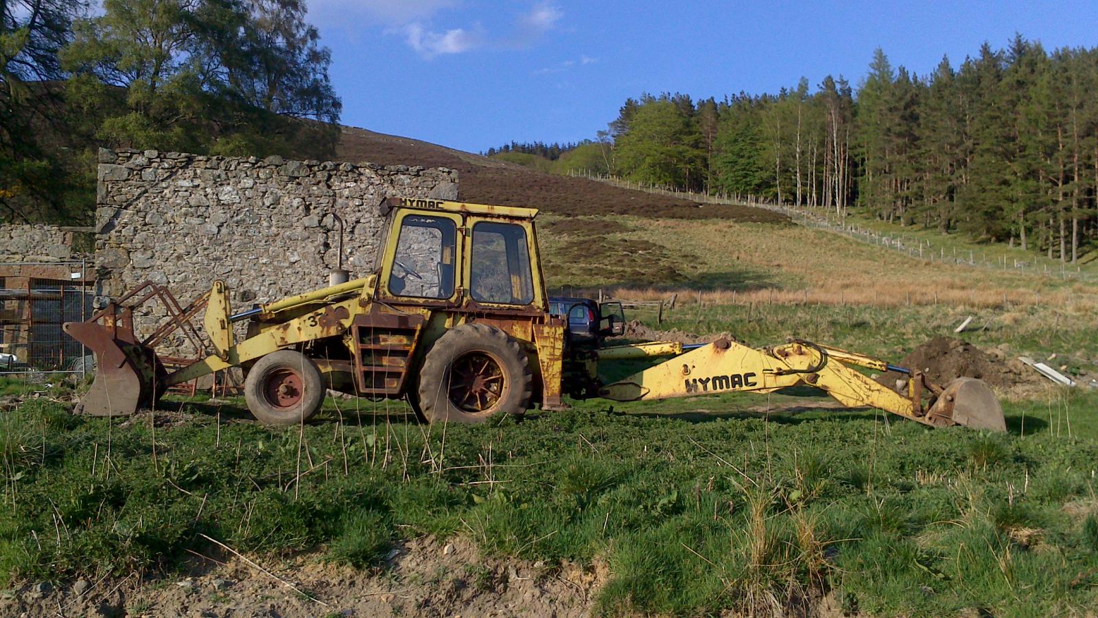

drum Posted November 3, 2017 Posted November 3, 2017 Breaking the bead is no problem when you have one of these richardthestag, DVee8, Banger Kenny and 6 others 9

colnerov Posted November 3, 2017 Posted November 3, 2017 Breaking the bead is no problem when you have one of these IMG_0526.JPG I used to use one of these, in fact maybe even that one. Colin
