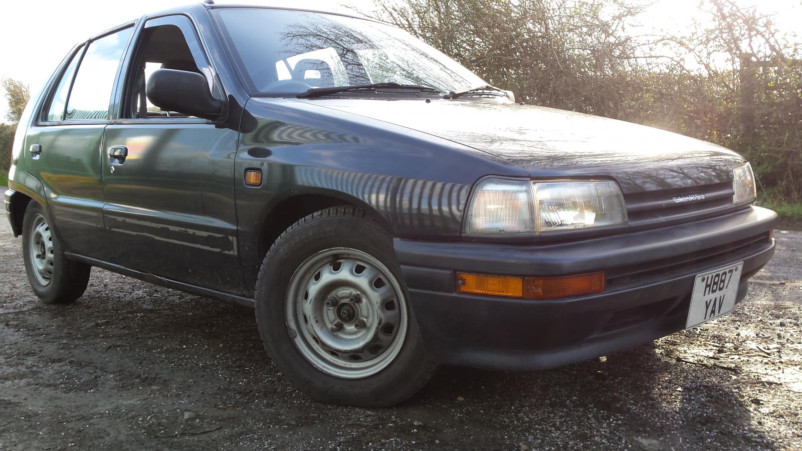

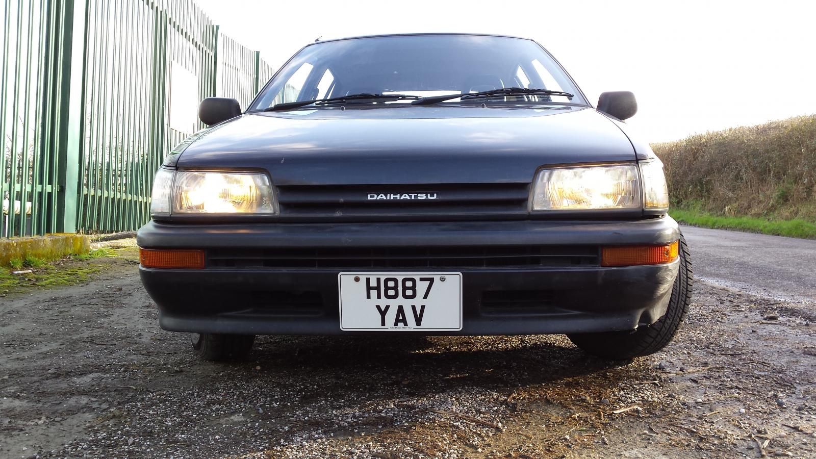

Well, it's now MOT'd, taxed, temporarily insured and now it's back home.  Hurrah!  Have some photos to celebrate - it's a novelty to see it in daylight.
It drives really, really well.  Very lively, seems happy to get up to 60mph without too much fuss and is eager to kick down.

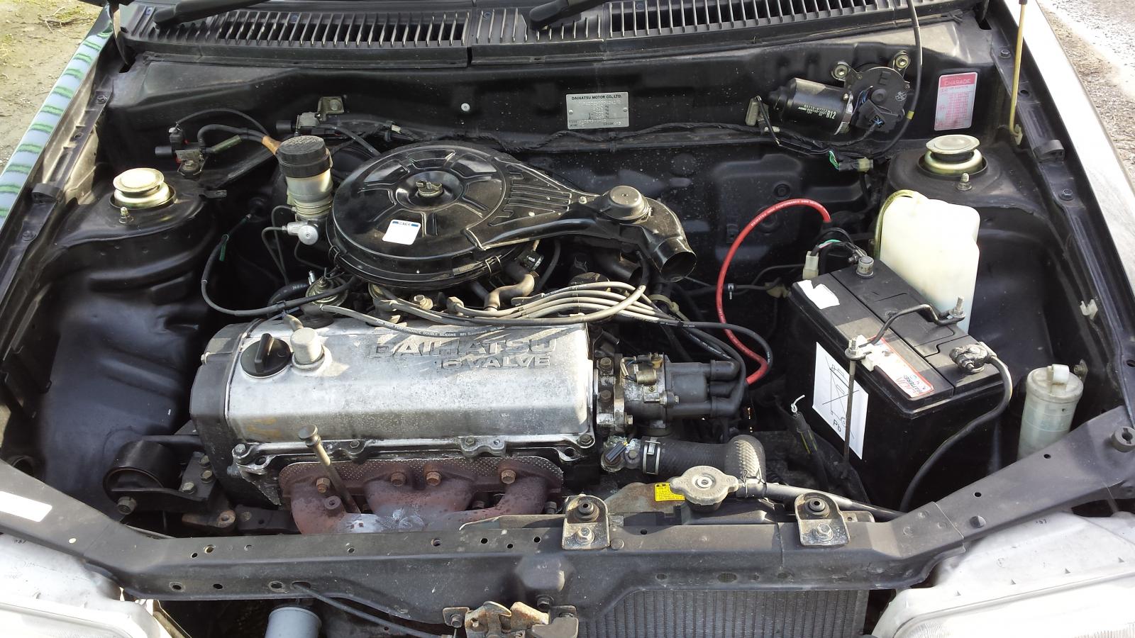

It developed an annoying problem on the drive home - with the choke off, it stalls at idle which isn't ideal in an auto that won't let you start the engine unless it's in park!  I pulled in on a (fortunately very quiet) country road to let a car past and had a couple of minutes of bewildered confusion until I realised why it wasn't turning over.  With a bit of throttle it starts instantly and runs well but at idle is grumpy.  After a few more miles it now idles sometimes but not always.
As it's barely been used for several months I suspect it's pulled some dirt through into the carb - if I get a chance at the weekend I will investigate.

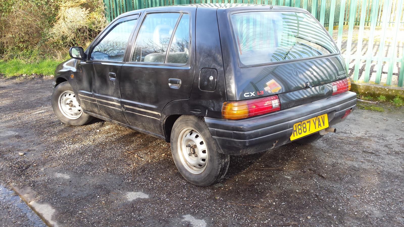

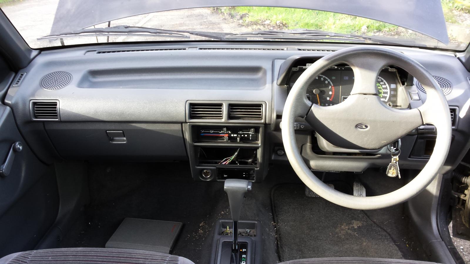

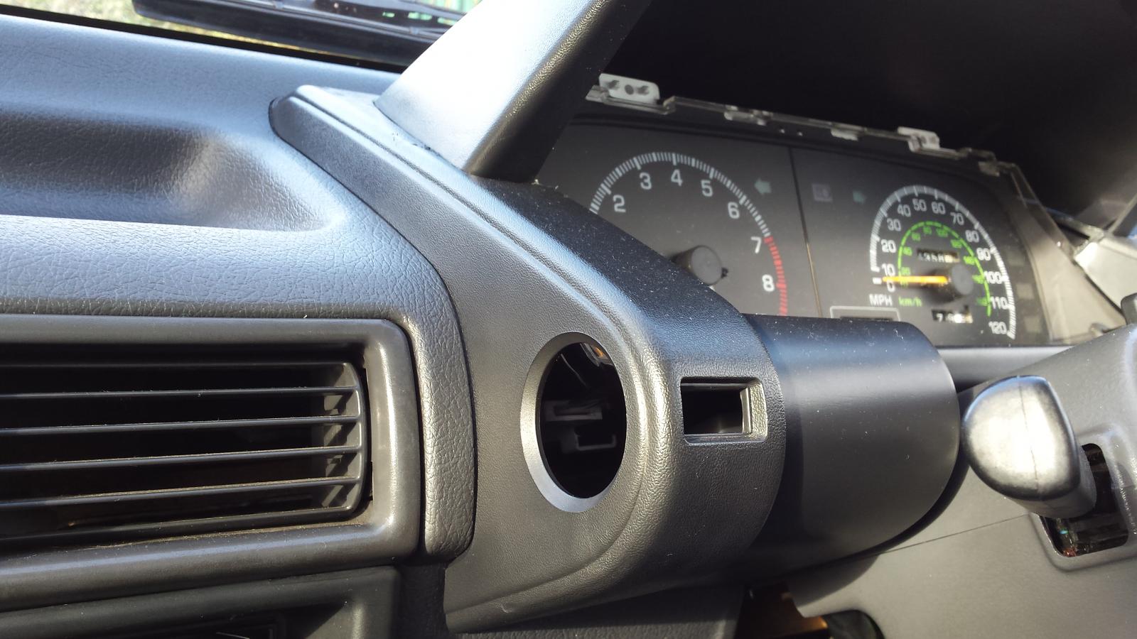

Other than that, it's not half bad really, shame there's various bits of trim missing inside (I have a rear view mirror which will be fitted shortly) and the NS door/wing are bashed up.  I will see about trying to straighten them out a bit if I get a chance but it will never be pretty.  Brake pads are needed quite urgently so I'm told, despite it only being an advisory on the MOT, so I have ordered some new ones which will be fitted before it goes anywhere else.  It is minus a power steering pump so the steering is a little heavy but perfectly acceptable in a car this small and light, had I not been told by the previous owner I'd just have assumed it never had it in the first place.
Despite the cosmetic issues, it has zero rust - really, I can't find a spot anywhere - and hasn't quite reached 35,000 miles on the clock.  Feels like that's correct, too, no baggy suspension or wear on the interior to suggest otherwise, anyway.  MOT history suggests it has done very few miles for the last few years.

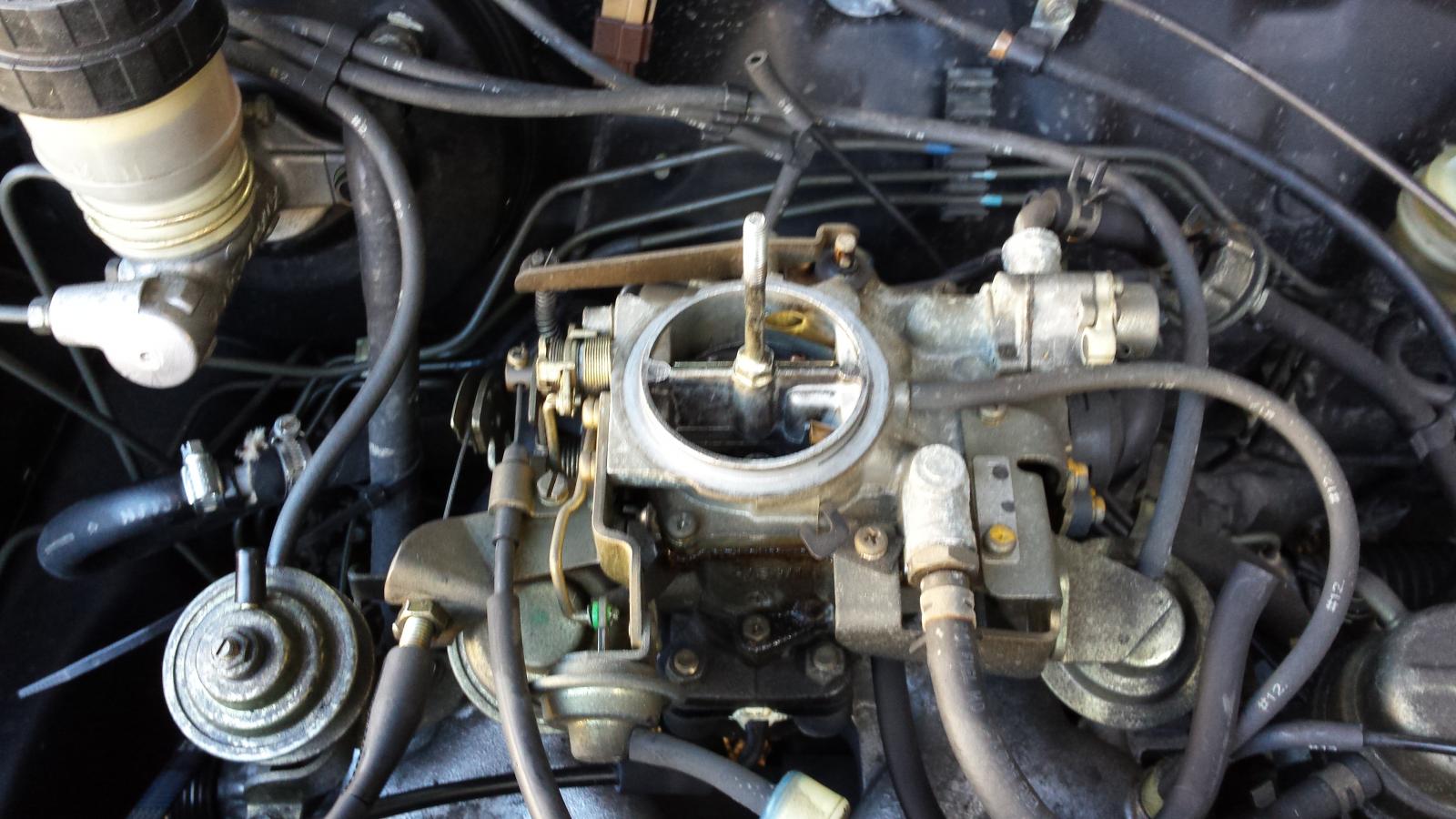

Right then, got a bit of time on this today.  Had another play around with it, it still will not idle but with the choke out it will run at higher revs, albeit it bit rough.  It's hard to tell exactly what revs it will go down to, the rev counter's stuck, but probably around 1000 - 1200.  It stalls immediately if you lift off the throttle or take the choke off.  It was absolutely fine before and only started doing this abruptly on the drive home from the MOT station so I am assuming that mixture/timing etc. is all absolutely fine.
My current assumption is that it has sucked up some dirt in the fuel and blocked the idle jet in the carb.  This theory is based on vague understandings of carb-fed motors and I'm willing to be told otherwise.  I am assuming also that if there was a vacuum leak, it would not have started suddenly like this.  Again, I could be wrong.  If it is a vacuum leak, realistically I am not sure where I would start looking for one.
In the spirit of investigation, I started investigating.  My first goal was finding the idle jet and this was not a success; I got as far as taking off the air filter housing and starting in horror at the mass of pipes and linkages before I had to have a strong cup of tea and a sit down.  This car is equipped with an Aisan carburettor, something common to Daihatsus and Toyotas from what I have seen online.
I have now removed a couple of pipes and the four bolts holding it to the inlet manifold so I can now lift it clear for inspection but frankly I'm already out of knowledge here.  I have never played with a carb before and to me this one looks fiendishly complicated.  For example, I do not know how or why it has wires going into it as I thought it was a purely mechanical device.  What do those wires do?

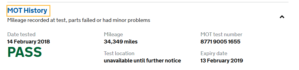

if it passes, it's next due a service but it does run very well and for all its cosmetic failings it really isn't a bad car.  I never have warmed to it, it's too flimsy, loud and shoddy, but my mate's wife and he both love it so it is in good hands.  There's even talk of replacing the rusty driver's door with a new one if a Trophy Yellow ZR turns up for breaking at the right time.

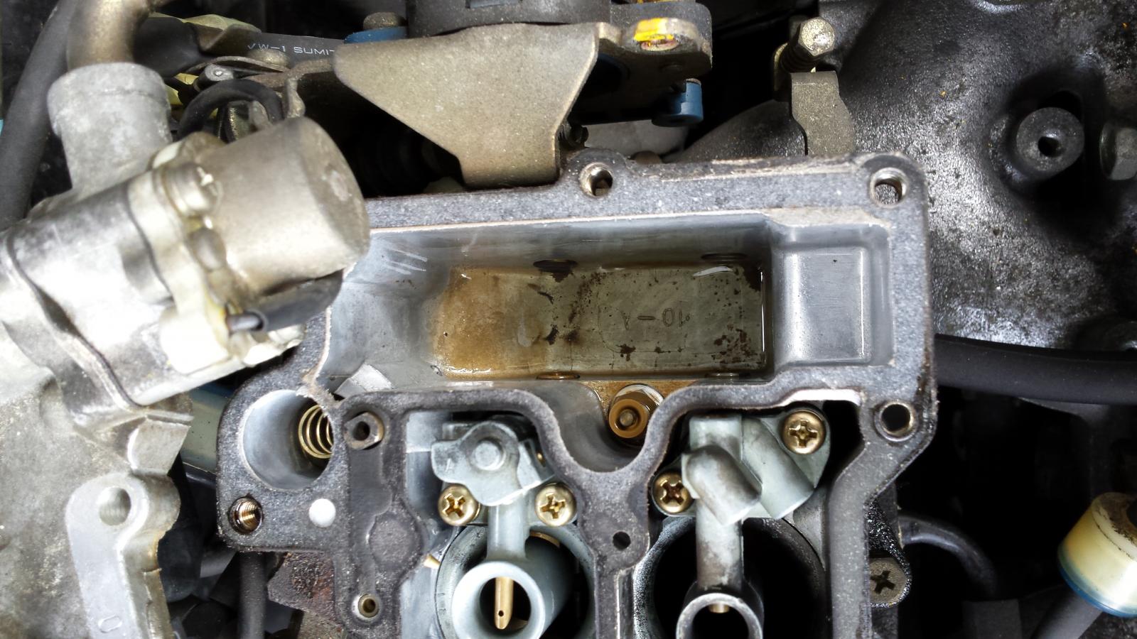

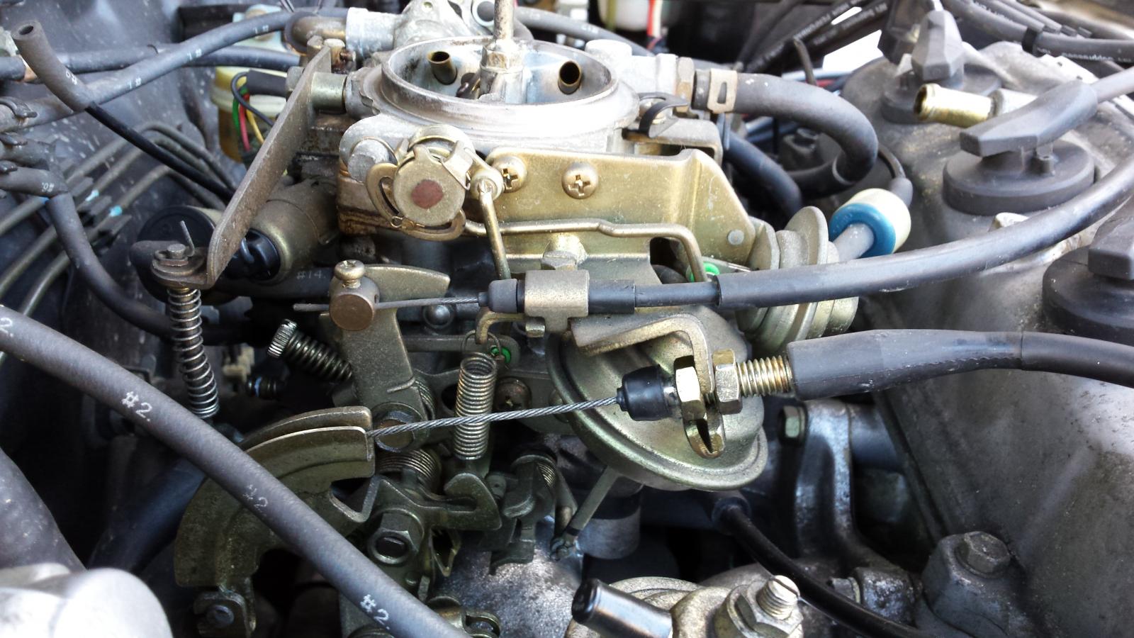

This thread does seem to be pretty dull reading!  Anyhoo, for what it's worth, it's useful for me to keep a note of what I've been up to. I had a quick bash at the carb today as I had a spare hour, I even got a reasonable way into it, to the point of finding a few bits of dirt in the float bowl.  That's now been cleaned out and there wasn't anything else obviously amiss to my inexpert eye.
Trouble is I don't know the names for half the bits I fiddled with, I removed what I could and cleaned everything that looked like it'd benefit from it.  The two bits to the left of the float bowel with two screws each were removed and cleaned but I don't think they'd be what I need to get to.
I have no real idea where the jets hide and I'm wary of doing more damage.  As it is, there's a rubber seal on a tiny piston attached to the accelerator linkage which was most unhappy at being removed and is now causing the choke to not go quite all the way off as I believe it is not moving freely any more.  The rubber looked pretty manky and the seal was very difficult to place back in the hole.
On the plus side, when reassembled it did start back up again and it will run on full choke, albeit with a bit of misfiring although possibly part of that is because it really doesn't need that much choke (it never did before) but it's the only way to keep the engine running.  As soon as the choke is pushed in, the revs drop away and it stalls.  It will not restart unless the choke lever is fully out, even pushing the throttle pedal.

I'd take it to a garage personally. Carbs are the work of the devil in my opinion. The last ones got increasingly more complex to deal with ever stricter emission regulations. Gained many needles, vacuum pipes and other shinangians
I suspect you're right, it looks vastly more complex than the carbs fitted to the CG125 motorbikes I've had in the past! It is interesting to play with these things and I have learned a bit but I am now at the stage where I am likely to create more problems if I keep fiddling.
I see 6 vacuum and fluid pipes, 2 cables (throttle & choke?) and several electrical connections. God knows what half of those pipes and electrical connections actually do...
