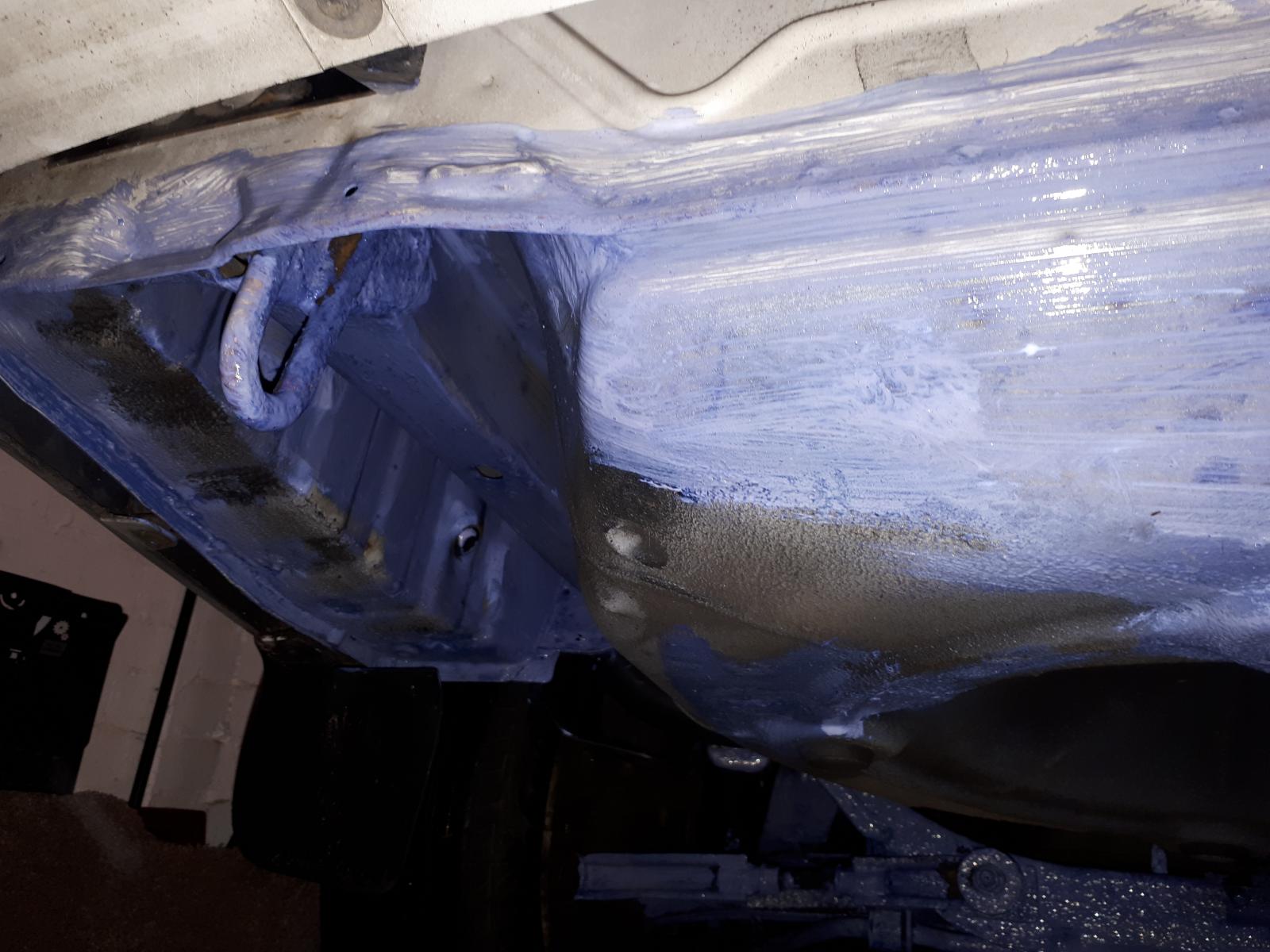

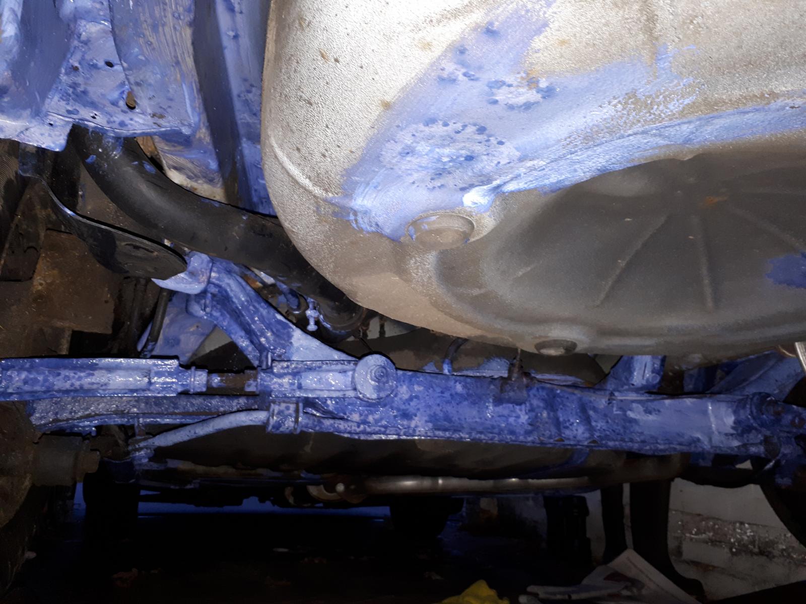

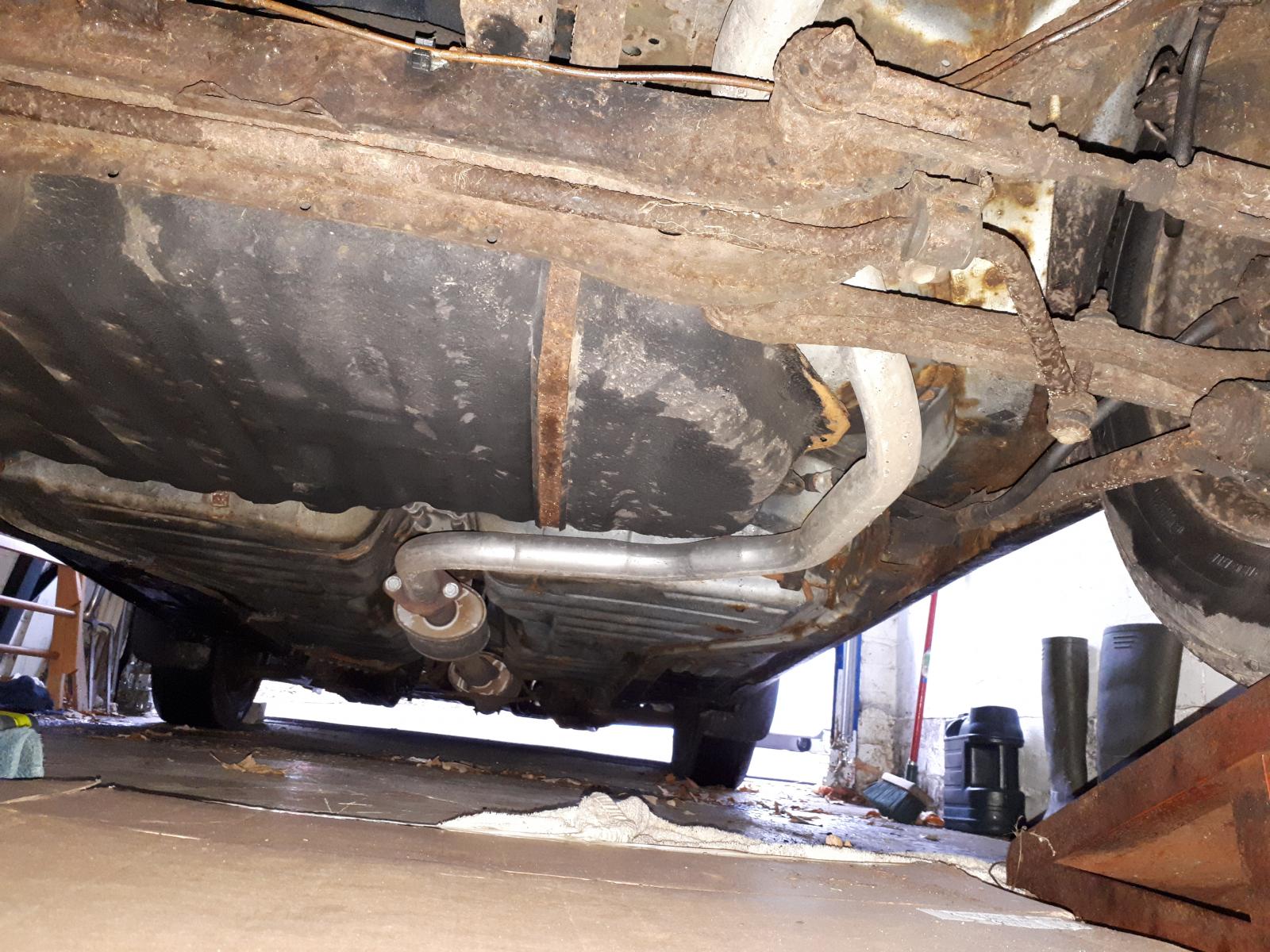

The sill crustiness turned into a hole so I got a patch welded a few weeks ago and then proceeded to deal with its rusty bottom.  The application of Deox-C sounded a right faff, having to wash it off after use, so I went for Vactan instead after dollywobbler’s recommendation.
Before
After
Not the most enjoyable of jobs so I was a bit slapdash, but it's quite satisfying seeing it done.  I’ll finish with Dynax UB when the weather improves as I’ll just be sealing in the damp otherwise.

Thanks for the heads up on the ‘save your rusty Jap motor’ items. I’ve added both to my eBay watch list - any ideas on a decent paint to cover the treated areas prior to waxing?

Hammerite is deemed shit by many, but I'm not sure what else to use. Must be better than leaving it to rot though.
I’d rather use my dog’s excrement than Hammershite, but thanks for the thought anyhow.
Being a Land Rover owner, I use Vactan a lot.
The thing is, I don't over paint it.  I just apply the stuff like you have and simply leave it- it forms a very effective barrier against crud.  The idea of doing this is so that when/ if the metal underneath develops active rust, you can just duff it up a bit with a wire brush and go over again with Vactan.  You're not hiding anything under paint and there's no surprises waiting for you!
In fact the entire chassis on my 110 CSW is covered in the stuff... and it never really gets any worse, even after a harsh winter.
Not over painting it sounds good to me, fewer jobs to do is always a winner.
