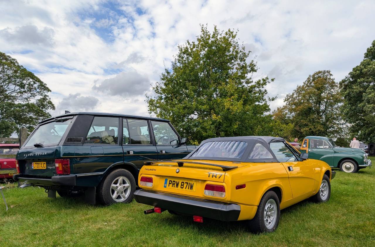

Initially I was internally rolling my eyes at the "modern" alloy wheels on that Range Rover looking to my eyes out of place...before realising that I'm an idiot and that being on an L plate they quite likely were factory spec.  My brain repeatedly forgets that they made them later than the mid 80s!
