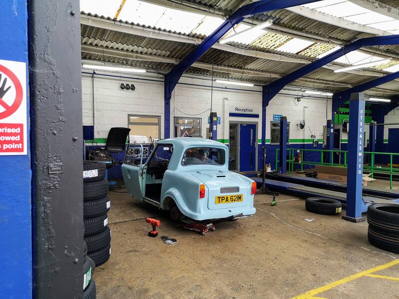

It's been a while, so here's the current situation.
[] On 2nd September 2019 I went to get a slow puncture on the nearside wheel sorted.
Just needed the rim cleaned up a bit, took five minutes to sort.  Right up until this happened.
Closer inspection revealed the rest of the studs on this wheel to also be knackered.  You can actually see the upper right one is bent in the photo.
[] Three of the studs unscrewed from the hub without too much protest.  Except for the one which had already snapped.  Which snapped twice further before ending up snapping totally flush with the hub.
[] At this point I made a blundering mistake.  Rather than taking the hub off and sending it to a machinist to be sorted, I figured I'd have a shot at drilling out the remains of it in situ.
This was foolish for a couple of reasons.  The first was that I had utterly underestimated how hard to source a replacement hub would be if I could things up.  Secondly was that I was doing this folder into a cramped, poorly lit corner of my garage.  So there was absolutely zero chance of me drilling it out straight as I couldn't see what I was doing and by the time I had the drill set up had already lost feeling in my left leg.  I'd also underestimated quite how awkward this job was determined to be.
By the time the stud was removed the hole was distinctly oval.  That is the point at which I started seriously looking for another hub - and that's where we are still.
It took a bit of experimentation, but we managed to figure out that threads in the hub are 3/8" BSF, and there are currently three high tensile bolts holding the wheel on.  I'm not 100% happy with the way I've had to use the original wheel nuts (they're bog standard Mini ones) to centre the wheel, I really need to get some proper conical washers.
Having thought about it a bit I don't see any problem using bolts rather than studs and nuts.  I can see that they'd use the studs when the cars were in service s it's going to be far quicker to swap out a stud if the threads get mangled than change a hub.  However I'm hardly going to have the wheel off every weekend, and with me being careful rather than monkeys in Kwik-Fit it should be absolutely fine.
The remaining one is getting drilled out to the first size necessary to get the hole properly round and is then getting tapped and an appropriately sized bolt will then be fitted.  It's not a perfect solution but in the real world it should be absolutely fine.  Plenty of cars far heavier and more powerful do just fine with three wheel nuts or bolts just fine...and I really can't see a 400kg 20bhp three wheeler having the slightest issue because the fourth bolt is a fractionally different size.  So long as the wheel is properly clamped against the hub it will be just fine.  The only issue I can possibly forsee is the balance being thrown off a little if the one bolt is slightly heavier, but realistically I'm not going to be doing hot laps around the 'Ring...it'll be fine.  There's enough vibration from the drive and the engine as it is I'm probably not likely to even notice if there's a slight imbalance from a wheel.
This isn't going to be a long term solution.  Once the world returns to some semblance of normality I'll be pulling the hub and sending it to a machinist to be sorted out, probably adapted to take standard press-through Mini studs.  However as all of the places I'd be looking to send it are currently closed, I'm forced to improvise.  Everything will be very carefully monitored but I'm really not expecting issues once the wheel is bolted on.
Plus if the usual way of the universe continues, the moment I get a workaround sorted another hub will materialize as if by magic in tomorrow's post.

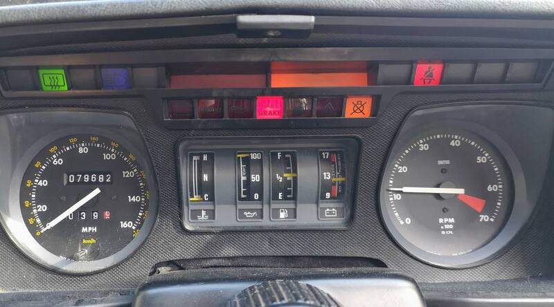

Got a really good MPG readout today!
Yeeeaaah...the poor computer is a bit confused.  Some idiot (yes, that would be me) managed to leave the interior lights on yesterday and flattened the battery.  The resulting voltage dip when I went to try to start it this afternoon wiped half of the memory...it has zeroed the fuel used but not miles covered...hence the ridiculous average MPG listed.  Battery has been left on the charger overnight.  Hopefully it will have survived the experience as I could do without having two cars with stuffed batteries right now.
