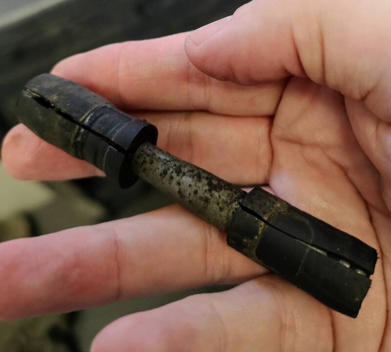

Decided to take advantage of the sunshine this afternoon to try to get something done without me having to leave my property.  Garage clear out is now on hold as we obviously can't get any rubbish cleared out to the tip.
Today's target was the thoroughly blocked "atmospheric coolant catch tank" - seriously Jag, it's an expansion tank - on the Jag.  I'd like to get rid of the bottle currently wedged between hoses in the nearside front of the engine bay.
Access is gained by removing five 10mm (I expected them to be imperial sized!) Bolts and pulling the wheel arch liner out.  First contact with the enemy.

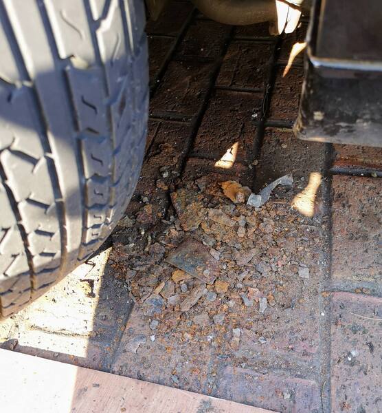

Immediately obvious is that the overflow bung has escaped the side of the tank.
The idea is that if this tank were to overflow any water or steam would exit via that metal pipe you can see to the left.  However if the seal between the tank and that pipe is compromised (which it is basically from day one as they never fitted well) this will simply escape into the wing.
Made worse by them sticking a foam pad underneath it to hold onto the moisture for as long as possible!
The tank originally would have been a friction fit between two brackets however these were missing so once I fed the pipe through from the engine bay it was just lifted out.
This left behind a lot of crusty mess.

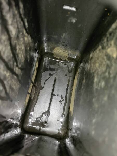

This much once it was all swept out.
Hey, there's the bracket that should have been holding the tank in place!
The results of this were predictable to be honest.
On the plus side, the outer wing just bolts on so access should be fine to carry out a repair.  I could be naughty and bolt the liner back in and pretend not to have seen it as the MOT tester would never know... I'd rather properly fix it though.  Even bearing in mind that I'll need to chase it back a ways to find solid metal it shouldn't be the worst repair to do.  Especially as it's out of sight so my horrible welding won't be visible.
I had a bit of a peer into the void using my phone camera and the inner will looks fine.  Couple of bits of surface rust but nothing terrifying.

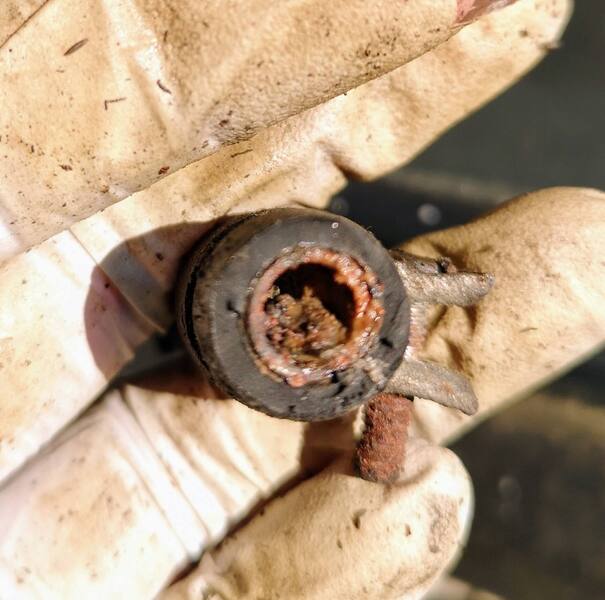

It looks like the tank itself was replaced in the early 90s judging from the date of 1991 on a sticker on it.
Given the line was completely clogged I was surprised to find that it did have some water in...well...something vaguely resembling liquid which may at some point have been water anyway.
This smelled precisely like you'd expect for 30 year old Barr's Stop Leak or K-Seal...lovely!  Given that Jag used to recommend adding two bottles of the stuff at each coolant flush, not surprising to find this.  There was about an inch of compacted mud at the bottom of the bottle under about 1/2 a pint of water.
Trying to clear the pipe took way longer than getting everything out.  The culprit was unsurprisingly the narrowest point in the system, the coupler between the two pipes.
That was choked solid end to end.  I had to resort to drilling the gunk out of it as it had the consistency of concrete.  Again, I reckon age old leak stop compounds are probably to blame.  Removing the hoses (once I eventually managed to get the hose clips free) required them to be cut off as they were utterly welded onto it.
The whole lot is now soaking in the sink in the utility room, probably awaiting a run through the dishwasher tomorrow before being refitted.

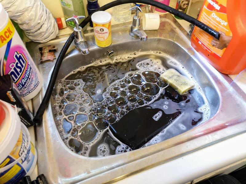

The bottle was left soaking overnight before getting thrown in the dishwasher on an intensive wash this morning.
Hasn't cleaned up badly actually given there was about an inch of solid mud in the bottom of it originally.
Looks perfectly serviceable to me.
Has now been reassembled ready for refitting.
I'll make sure both the hose inlet/outlets are sealed properly once it's back on the car.  I'll be careful about the hose routing to make sure it doesn't get kinked as I know that's a common problem with this setup.

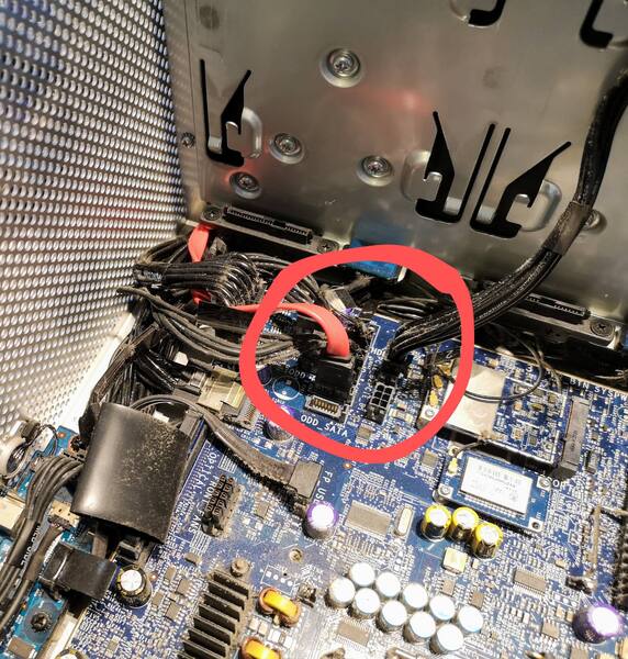

The initial strip down before you need to get the tools out involves removing any full length expansion cards (only card I have fitted is the graphics card), the DRAM boards and the hard drive caddies in slots 1 and 2 (nearest the front of the machine).
At this point you need to get out a smallish Philips screwdriver.
You now need to remove the screws holding in the memory cage.
Two screws are immediately obvious once the memory boards are pulled out.
Less obvious are two tiny screws hidden behind the lip at the nearest edge.
Yes everything is horribly dusty.  Sorry.

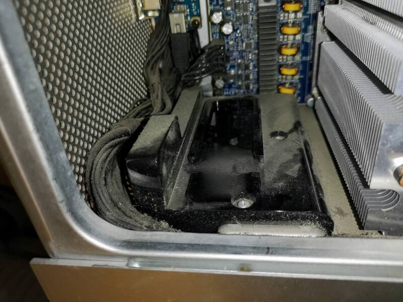

Next the front fan assembly needs to be removed because it slightly overlaps the CPU heatsinks.  Three things hold this in place.  A single screw up by the hard drive caddies...
...A clip on the front upper edge (just lifts out) and one final clip which is an utter, complete pain in the tail.  The clip down at the base (shown below) is strong enough to lift a small car by.
This slots into a groove in the black plastic bracket in the base of the case.
Getting this out requires something I don't like applying to computer hardware: brute force.  The problem is that you need to pull it straight out of the case.  I attempted using an expansion bay cover as an improvised puller, but it just bent.  The combination I eventually found to be effective was to use the expansion card retainer to lever from the front edge and to pull by hand from the rear.
I did seriously consider disabling the lower mountin clip to make removal easier in the future.

While I was in there I also wanted to hook up the Blu-ray drive.  There is a SATA port on the motherboard for an optical drive for it, but it's near impossible to get at as it's buried under the front fan housing.  So hooking it up while the housing was out makes a lot of sense.  It's the red cable here.
In addition to this you need to add a Molex to SATA power adaptor as there's no SATA power provided in the optical drive bay.
At this point I put the front fan assembly back in - or rather I tried to.  Discovery number one: You need to use a right angled SATA connector in this location or it fouls the fan housing.  Cue twenty minutes of raking through my bags of random cables etc to find one.
Much better.
The front fan assembly, CPU heatsink cover and memory cage were then all refitted.

Another half hour of digging around sourced another, longer SATA cable.  I then quadruple checked I hadn't missed anything before I reassembled things for a second time.

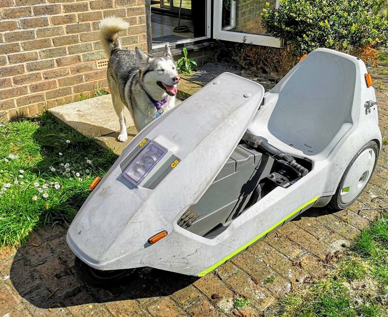

Today I decided that in the interests of getting the dogs (and me) exercise while being a far faster moving target for hassle that it was time to get the C5 out for the first time this year.  I'd meant to a couple of months ago, but couldn't face digging it out of the back of the shed at the time.
For those of you who haven't seen this little beastie before, I present to you Scruffy.  So named because it's probably the most cosmetically challenged functional C5 I've come across.
Star decided that she wanted to model for us too, it took me six attempts to get a photo without her actually being in the way.
Apologies for the state of the garden here as well...This area is pretty much exclusively used as an exercise area for the dogs and is due me going around to do a litter clearance (it gets done a couple of times every week), so is a bit of a mess.  Only reason other than the dogs to be out there is that it's also the route between the shed the C5 lives in and the outside world.

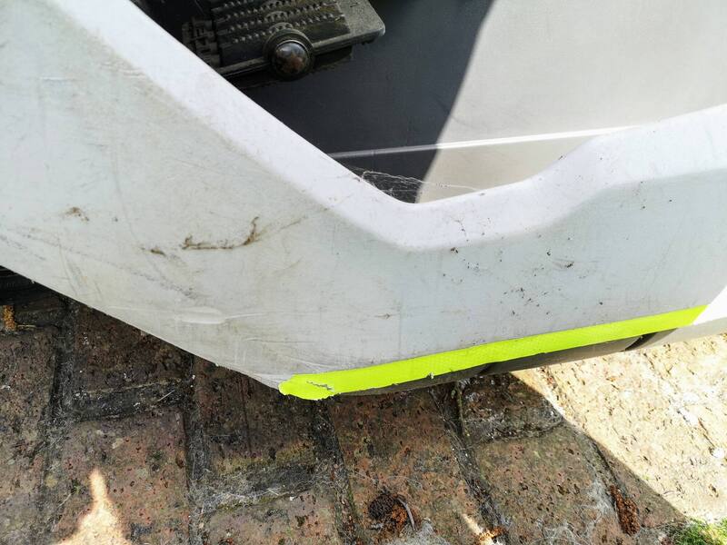

Aside from missing hub caps, a missing front mud guard (I do actually have that, I've just never got as far as refitting it as it makes checking the front tyre pressure a pain) and every single surface being scratched to Hell and back the reflective stripes are falling off and are the wrong colour.  They were applied in minutes by me with stuff that I just happened to have laying around about five years ago.
Completely at random I stumbled across some reflective tape in Halfords a couple of months ago which is a far, far closer match to the colour of the original stuff.
The two little squares on the wheel trim here are still the originally applied stickers, so you can see while it's not a perfect match it's a lot closer.
An empty paint tin I've found makes an ideal jack for working on the C5.

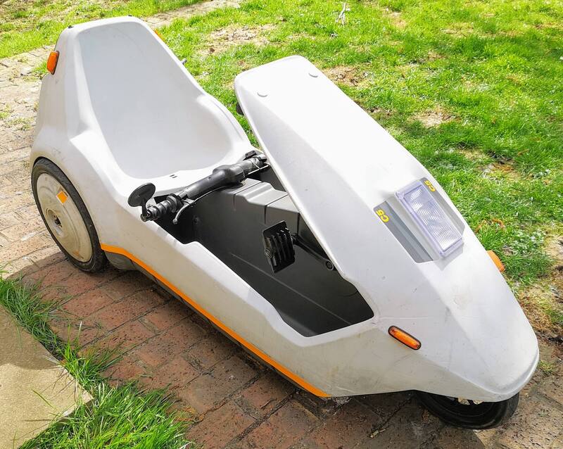

While it's still scruffy as anything I think it looks a good deal more presentable now the stripes are all there and actually match.

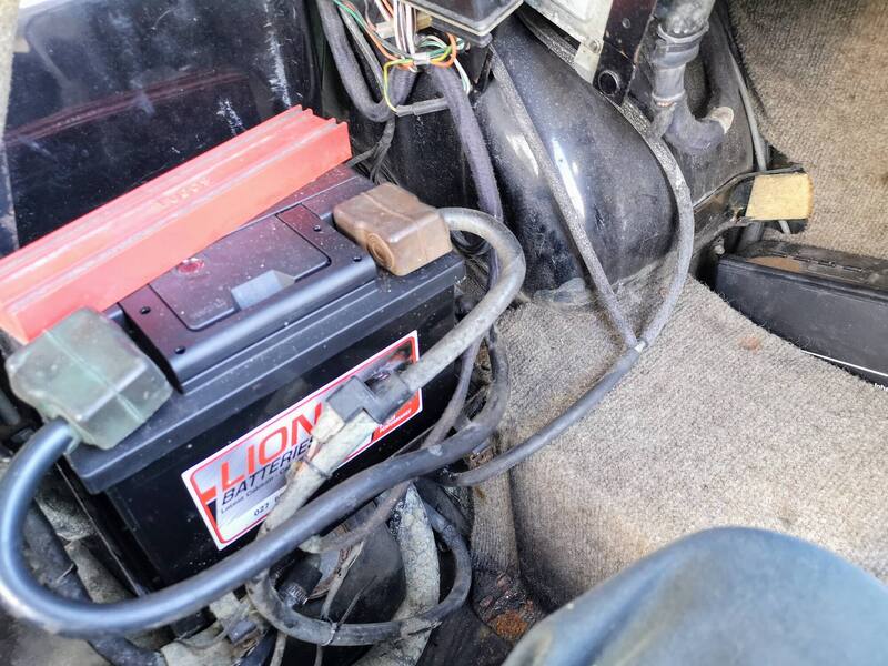

Next up for it once the lockdown finishes will be a new battery as the one currently in use has pretty much had it.  Can't really complain though, it's done five years of regular use and is just a standard car 038 type, so not designed for this type of application really.  I'd really like to go down the lithium ion route as it's entirely possible to build a pack into the base of the luggage compartment that's a fraction of the weight of the original yet gives a real world range of 50+ miles even using motor assistance more than normal.  However you're looking at several hundred pounds worth of batteries alone...plus obviously a charger and controller would also need to be factored in...and some form of monitoring as the original "fuel gauge" calibration wouldn't be suitable for a different battery chemistry,

It's easy to see how much the top hose has swollen with the new hose next to it (it looked ten times worse once there was some pressure in the system too).
I'm still baffled as to why the garage that fitted the radiator didn't flag up the state of the hoses and the belts when they fitted it.  The belts especially would have taken them minutes to change and only cost pocket change.
Getting this hose off was made slightly more awkward on account of the hose clip having been fitted the wrong way around.  There's a hole in the slam panel which would have given easy access if the screw was on the opposite side of the hose.  It wasn't though...so it was really fiddly and had to be undone 0.1 turns at a time.
Once I got that undone changing this took about two minutes.  Looks rather better.

The bleed line between the top of the radiator and the filler neck was the other one which had swollen alarmingly, that was swapped with barely a drop of coolant spilled.
Forgot to photograph that one after changing it.

The two I'd spotted bulging were by far the softest so it seems they have broken down more than the others.  The whole lot will get done, but I'll need to get (a lot) more antifreeze in before I can tackle the lower ones.  This is as far as time allowed this afternoon, so got things bled through and we'll come back to this project in due course.

The exhaust has been rattling noticeably the last few trips out, especially when the engine started or stopped, giving an almighty clatter.  This was quickly traced to the downpipe to mid section clamp not being done up quite tightly enough.  1/2 a turn on the pinch bolt and we just had honest diesel clatter without a metallic accompaniment.  I didn't realise quite how much it sounded like there was a tumble drier full of gravel under the van until I sorted it.
While it's quiet around town but there is still traffic around, the A5 itself though was utterly deserted.  Only saw one other car on there...an old gent dawdling along at about 40 in a 51 plate Fiesta.  I think he got the fright of his life when I went howling past in full juggernaut mode.
Later in the afternoon I escaped outside to get a couple of things done on the Jag.  I still haven't quite got used to walking outside to see this thing...and while it may be an utter pain to work on, has cost me over a grand in fuel alone since I picked it up, it's impossible not to like it.  I mean...just look at it...
I really need to do something about the exhaust tips though.  Their being at the wrong (and mismatched) angle is really bugging me.

Task number two was to pull some of the carpeting out in the boot to see if I could pin down why it always absolutely reeks of petrol.  It doesn't make any odds whether it's warm or cold, tank full or empty or whether the engine has been run recently.  It always smells...and if you open a window the smell then gets drawn into the car.
Now while it's always been bone dry in my ownership I knew there had been water getting into the boot in the past at some point because I'd seen a bit of mould on the spare wheel cover.  Once I took it out it became apparent that there was quite a *lot* of mould on the spare wheel cover.
I had a feeling I was going to find worse once I started digging, so I sensibly donned the mask I picked up when painting the Invacar and gloves before delving further than this.
Sure enough, what was hiding behind the carpets was truly gross.
Fuel filter has a 2003 date code...though obviously it could have been changed far more recently having been sitting on a shelf for fifteen years.  Nevertheless it will be changed shortly anyway (honestly can't remember if I've already picked one up or not, I'll need to go digging in the ever increasing box of bits of Jag currently occupying the driver's seat in the Invacar) as I'd rather look after the fuel system.
Again, the willingness of Jaguar to use normal hose clips (or mere friction fit without any fasteners whatsoever) on the pressure side of the fuel injection system on this car never ceases to surprise me.
Yep...I think we've located the original source of the bubonic plague...that would be the mould in the general vicinity of the surge tank and fuel pump in my XJ-S!
There's definitely evidence of historic fuel leakage here but nothing that looks recent.  The closest I can see is this sticky, tarry deposit on the fuel pump itself.  It doesn't smell even vaguely like petrol though.

The next thing on my to do list after an initial visual inspection was to attack everything with disinfectant wipes to hopefully remove the need for biohazard tape to be wrapped around the car every time I open the boot.  I got about half way through it when I ran out of time...will be picking up where I left off tomorrow.
