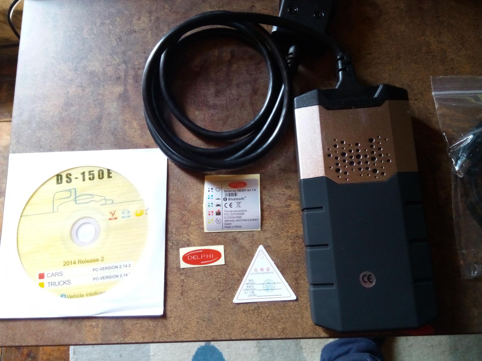

On SiC's recommendation I also got a knock-off DS150 - this one in fact, for a bit less than £30 off AliExpress:
http://s.aliexpress.com/fyYJfYZR
It took a few hours of messing about to get to work, particularly as the old laptop I had lying around was Windows 8 and needed downgrading and the installation instructions were a bit Chinglish, but all working eventually and seems to cover most things I might need it for.

The DS150 I have was easy enough to install, just came with a DVD with installer EXE and then a crack to replace a couple of DLLs and an exe once it's done, no loaders or dongle emulators etc.

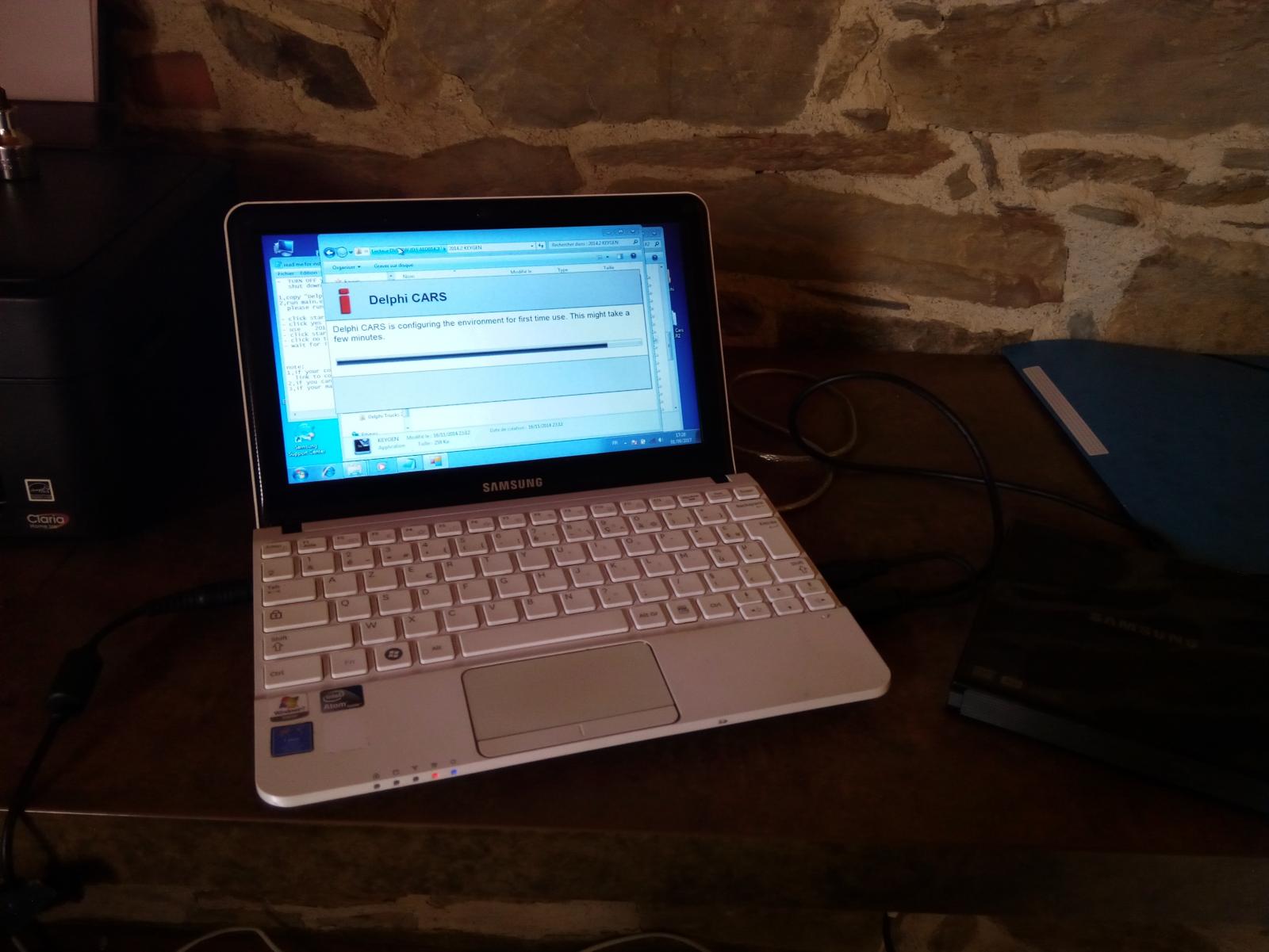

Do any of the current DS150 users have an alternative source for software from a car tech forum or something? I have an old XP laptop I can chuck it on but there must be less malware riddled versions on the internet somewhere.
Installation was easy enough compared to Lexia.
I have an old netbook I keep in the garage for tunes and occasional diagnostics that I dont use for anything else so no trojan worries.
Run the disc, when it wants to activate, press no to save the activation file to the desktop, run the keygen program on the disc which alters the saved file, then re-run the activation with the modified activation file.
It wouldnt connect to the laptop but there is a USB driver on the disc which sorted that out.

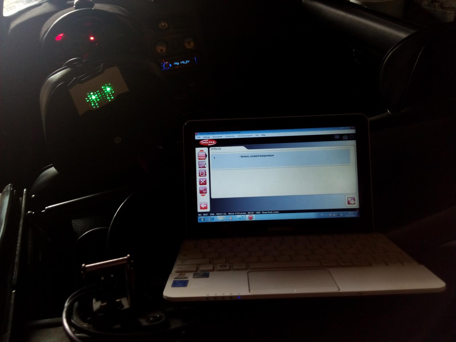

Seems to work fine. I am temporarily out of stock of electrically broken cars, so cant do much, but it connects to stuff I have and reads and clears old codes etc....it seems pretty intuitive to use. For under 40 sheets I reckon its fine.
Depending on the ECU you'll be able to change settings with the delphi jobbie. EG Merc truck ECUs I can change what type of oil pressure/level sensor is fitted, what temp the fans kick in at etc etc. On body control modules you'll be able to turn features off, probably.
