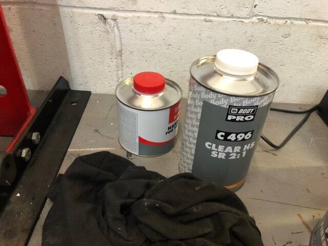

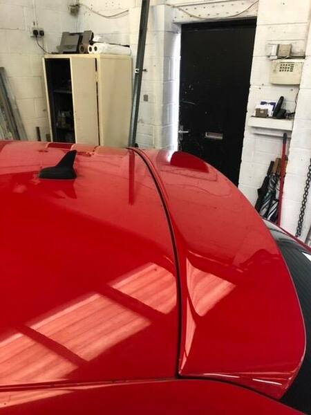

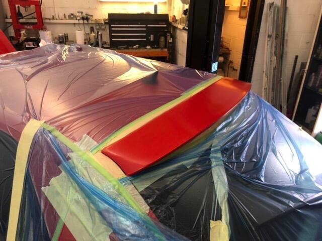

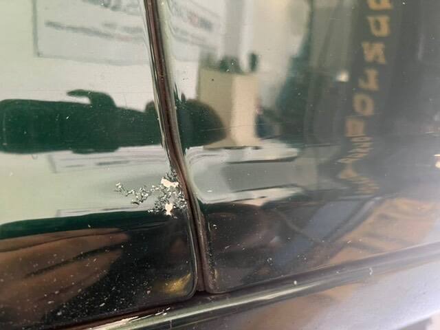

Today’s job was a spot of lacquer replacement.
First up, mask it off and attack with a scotchbrite pad…
Then mix up some 2k…
Add aforementioned 2k to spoiler…

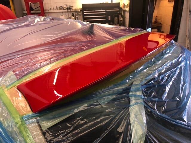

That’ll do, donkey…
Had to go out this afternoon so it’s currently sat up in the air overnight with the sump plug out, awaiting a new filter and the proper VW 507 oil in the morning.
Oh yes, I also found a dried up tube of tiger seal in the back of the cupboard so I cut it open and got enough out to reattach the drivers door trim that had detached itself, followed by 45 minutes of removing excess tiger seal from various areas of the workshop and my body with thinners.

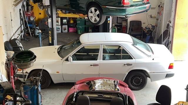

On 22/02/2022 at 22:22, NorthernMonkey said:
There was actually a second dead red VAG offering relocated to the workshop yesterday too…
I’ve only driven it once when Ceri dropped it off last year, whereupon I drive it down to the barn where it then cut out and refused to restart.
I thought it was about time to drag it over to the workshop whilst having a tidy and give it a bit of a fettle. It’s the first time I’ve seen underneath…it failed it’s last test on various bits of welding and other odds and ends. It’s actually pretty solid underneath…just three small bits required on the jacking points but otherwise it’s quite sound under there.

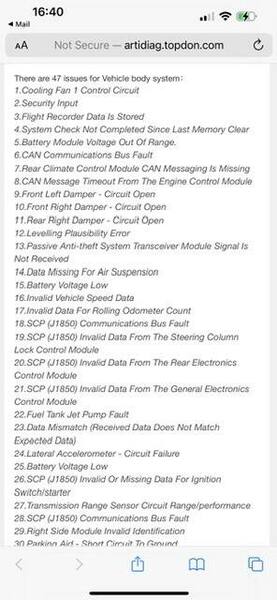

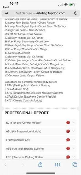

Ok…what you’ve all been waiting for*, Jaaag update time.
First of all, let’s plug the scanner in and see what’s what…
Could be worse…at least the phone module seems ok. Actually, most of them are related to low battery and once cleared, have not returned 😂

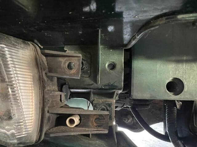

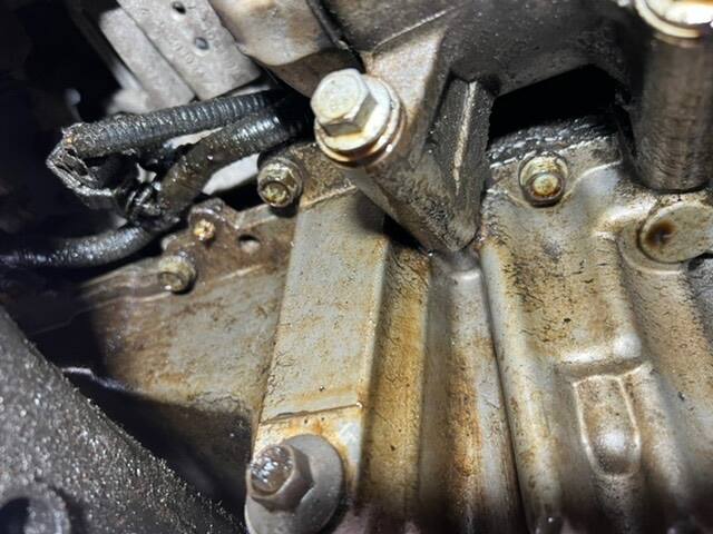

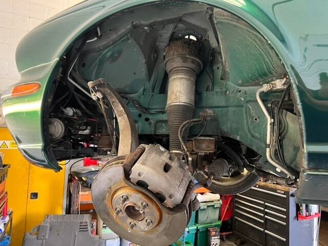

Up in the air and the general consensus is it’s a good, solid car. The rear brake pipes that looked a bit crusty on the POs pics are actually pretty solid and just covered with road muck. The subframes front and rear are solid and just need a good wire brush and repaint and everything else is very clean and solid…
It really is like new on the sills, jacking points etc…very clean indeed for a 18 year old car.
The ZF transmission is as dry as a bone…there is a fair old oil leak but it’s completely clean above the sump line and the oil on the gearbox is what’s been thrown back from the leaky sump gasket…

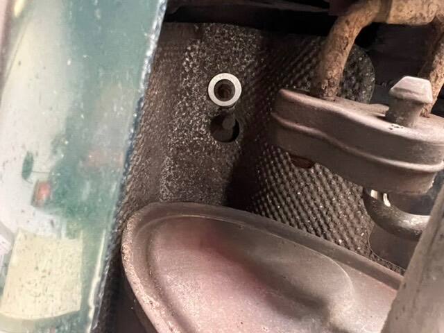

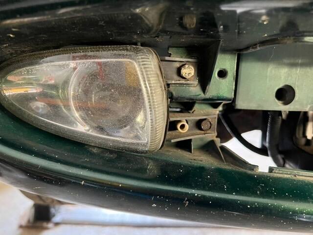

Otherwise, it’s just random bits of trim underneath that need new fasteners. The nearside front fog light was missing it’s bolts…two new ones and it’s nice and secure now…
One of the rear exhaust shields was making a bid for freedom so that’s been fettled…
 The handling is a bit twitchy at speed but all the wheels and tyres are perfectly balanced. The steering wheel however is 20 degrees out and the rear track control arms have both been replaced so I’m pretty confident that a full four wheel alignment will sort that out…
Other than that, the only issues I can find are a dead key fob and a (very slight) bit of corrosion on two door bottoms…
I’m going to replace the front track rod ends next week then get a full alignment done which will hopefully sort out the wayward ride, then it’ll be doing a niggle list to sort out all its little issues. Not sure what it’s long term future is on the fleet as I’ve another barge coming in this weekend but I’m really glad I jumped in to rescue it as it’s fundamentally a very straight and original car.

Sorry about the foglight screws - I don't know where they went! They were T27s IIRC.
There's one brake pipe that I was concerned about but it's visible from above - and not concerned concerned, just didn't like the look of it - the one that runs across the front along the slam panel, so I saw it when changing the radiator. Any traces of ATF may be the small amount of spill when I swapped the rad, also.

What about the air suspension light?
I will feel a bit daft if all it needs is an alignment, which is exactly what my local garage tolds me it needed to sort the ride.
It definitely has a coolant leak, interested to know if it is the water pump.
There’s two separate issues, I believe.
The slightly wayward handling is definitely down to the alignment, there’s no doubt about that.
Regarding the light, there is some sort of issue with the nearside front…I haven’t really looked into it much more at the moment but I think the noise is down to a worn ball joint…it’s too severe when going over a bad pot hole to be the pump which seems to be pretty well mounted. There is however occasional evidence of an air leak from that corner which may or may not occur with the occasional random warning light.

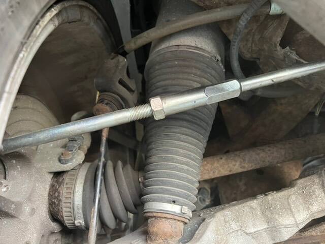

As mentioned on the collection thread, the knock on the front is down to a knackered ball joint on the upper wishbone. A new one was delivered yesterday morning but to fit it, the shock needs to come out to make room for the bolts to be removed and it was about this time I realised that one crucial omission in my tool box was a T60 impact bit.
Having ordered a set yesterday teatime for prime delivery today, the delivery time kept getting put back…it eventually arrived around 16.30 by which time I’d decided it was time to come home so the Jaaaaag can wait until tomorrow now to be rebuilt.

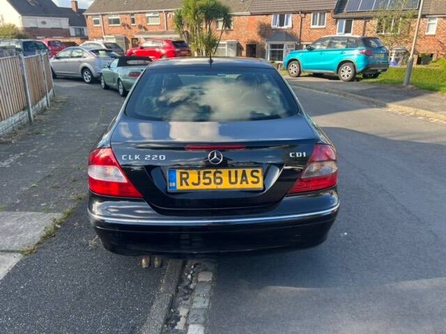

Following the FiLs fancy of my Jag, I’m taking back the CLK I gave him last year to use and as someone on here has expressed an interest on a deal with it, I decided to get it in the garage and give it a once over pending a new MOT on it as it runs out in a couple of months.
The only issues I could find were a bit of coolant staining around the water pump pulley and some play in the NS track rod end so bits were ordered.
The pump was indeed as rough as a badgers arse when the 20 foot auxiliary belt was finally removed so that was replaced for a nice new shiny one.
The track rod end? Not quite as straight forward unfortunately. The fun started with removing the wheel bolts…three were ridiculously tight and twi actually snapped off….joy! 🤬🤬
I thought I’d better check the other side and sure enough, one was seized completely so what started off to be a quick small job rapidly escalated as my OCD hates the thought of anything I sell not being right.
Today was spent replacing both front hubs and bearing assemblies and back plates (which had rotted away and allowed all the road crap to be chucked all over the exposed thread ends) along with new discs and pads for good measure!
Bloody good job I’ve got a local factors who look after me….😂😂
