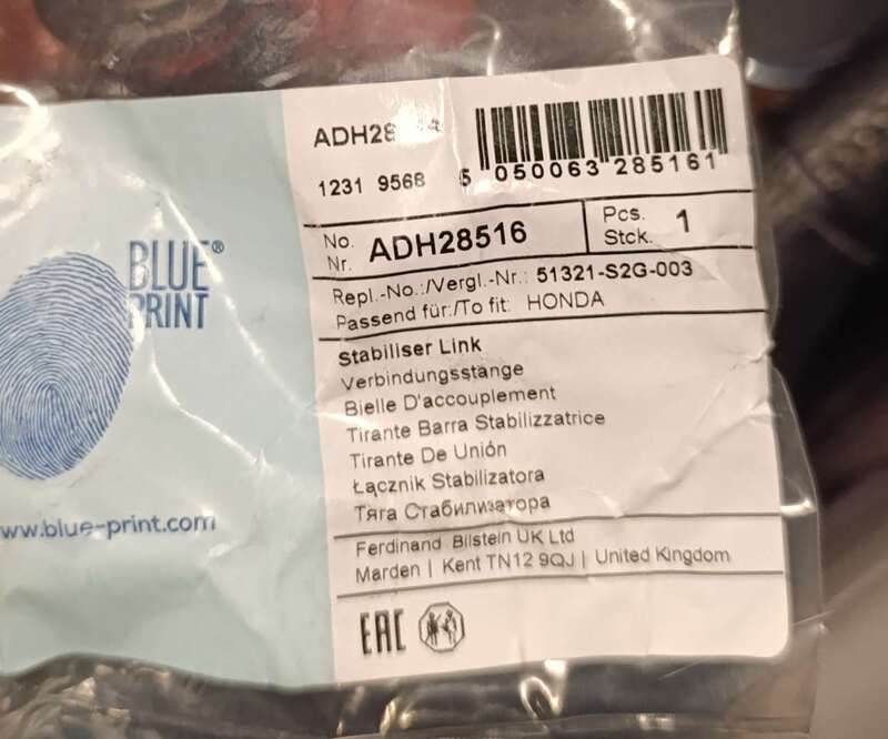

It also came with a drop link. Listening to the suspension it's not the last part I'll have to replace underneath.
