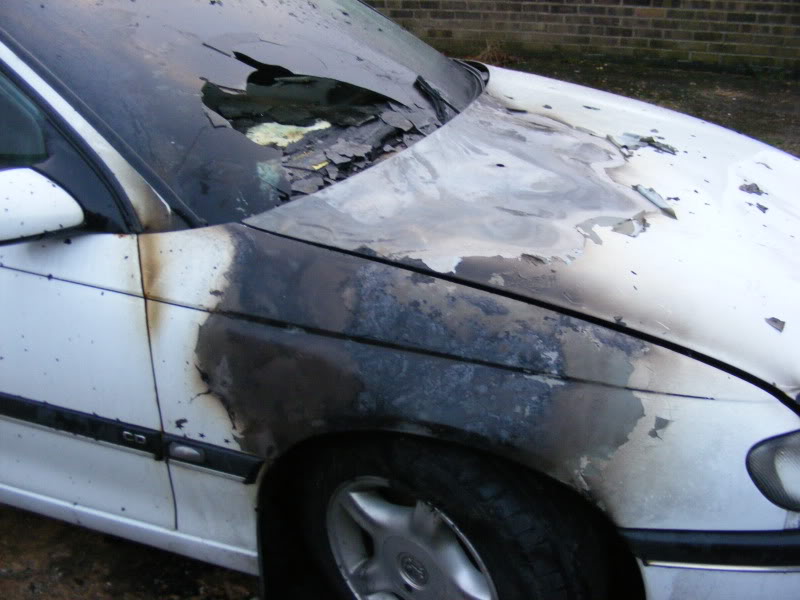

I really would remove the powersounder as it's on it's way out, picture for encouragement
