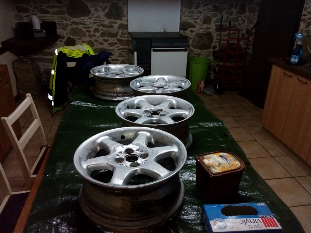

I ordered new booties for the MGF and got on with fitting them today. As I got started I realised the wheels were scabbier than I remembered so it turned into a refurbishment session, which I decided to document on here for your entertainment and education derision.
Yes, getting them done properly will probably last longer term, but I aint got the monies for that, and dont know anywhere nearby that would do it anyway, so its good ol DIY for me as usual.
 Note - I am not saying this is the best way to do it - its the way I do it. Its what works for me on steels and cheap alloys as fitted to the kind of toss I drive but if I were a powerfully built company director I wouldnt be trying this on the diamond-cut 22s on my orange girlfriends X5.

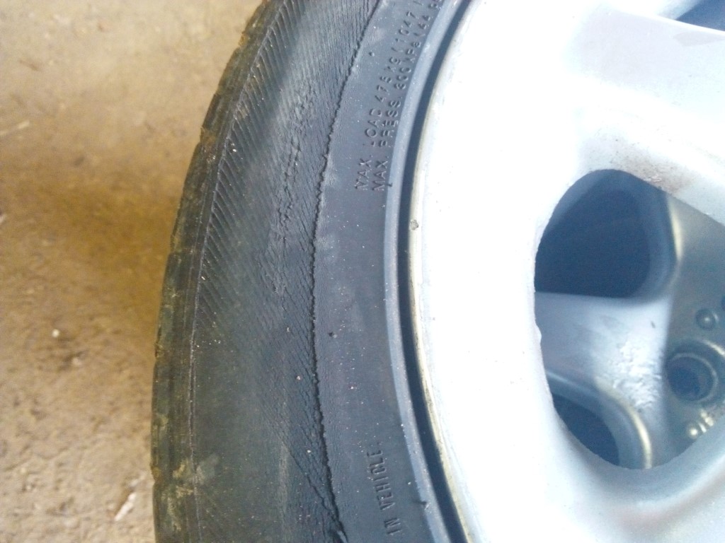

The old tyres. 4 mismatched budgets, which is a pet peeve of mine. Two nearly new, one ok, one near the limit and two of them with a slow puncture or something causing them to go flat over a week or so.
This one looks to have been run flat in the past.

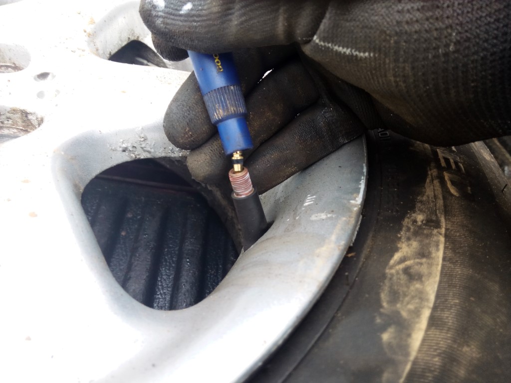

Remove the valve cores....A (very cheap) special tool is really needed here although you can wing it with pointy pliers if they are fine enough.

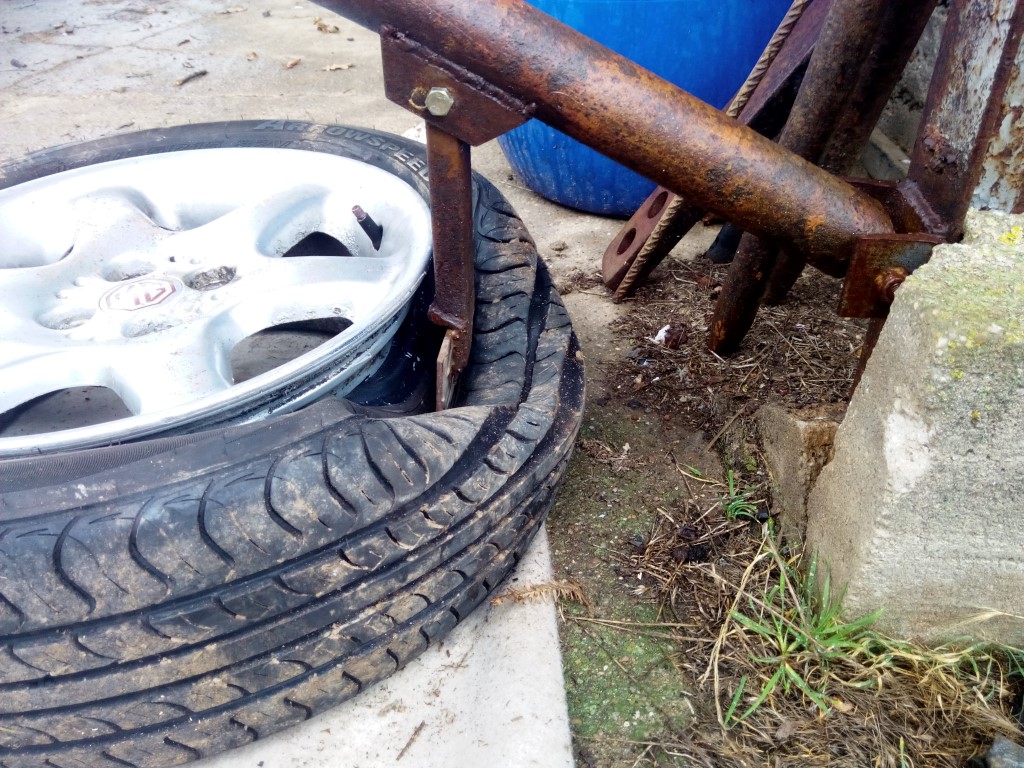

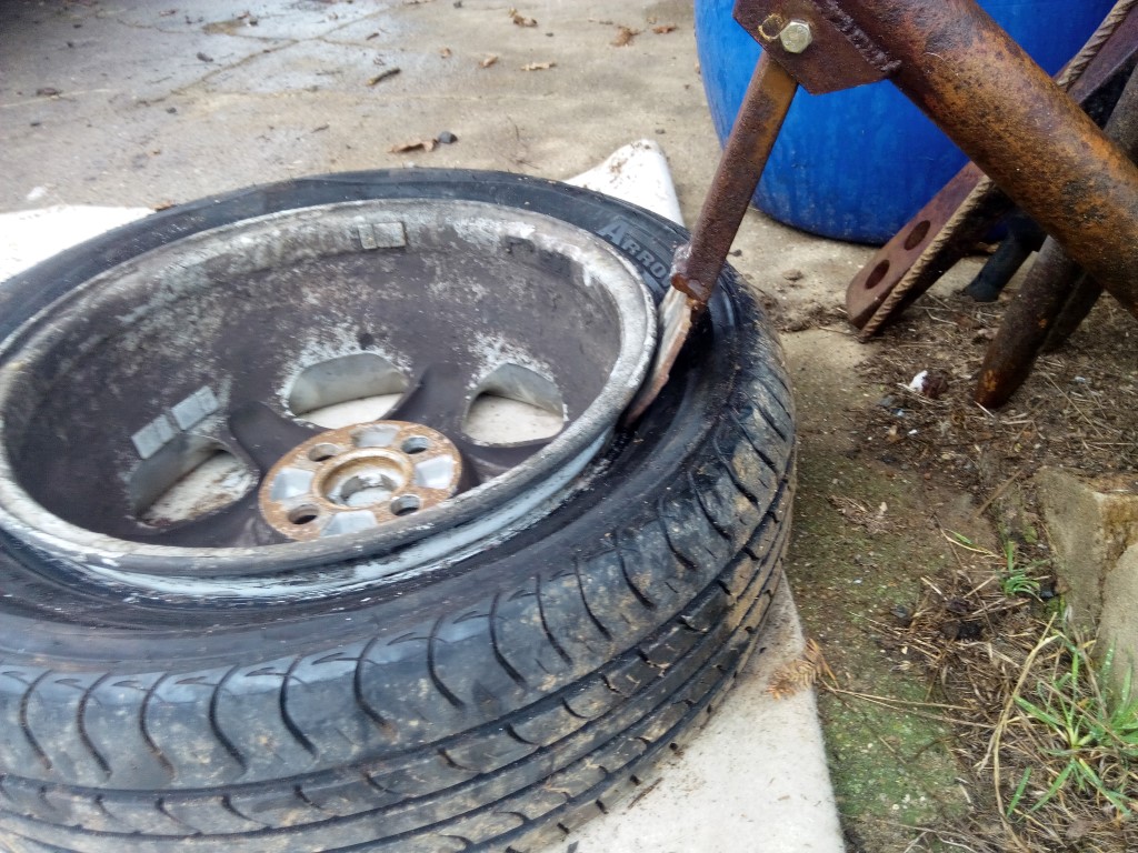

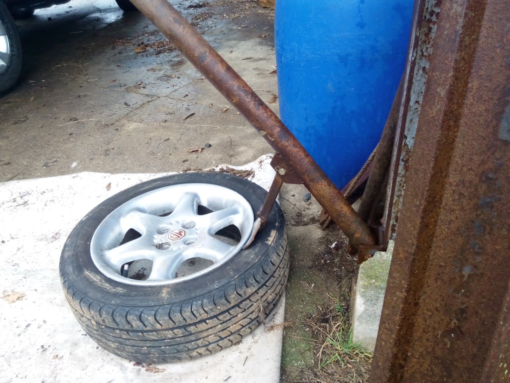

Break the bead seal. I made this lever a few years back. I used to use the front bucket of a tractor, but that was always a pain in the balls - this is much better....just a length of scaffolding pole, some box section and some steel plate.

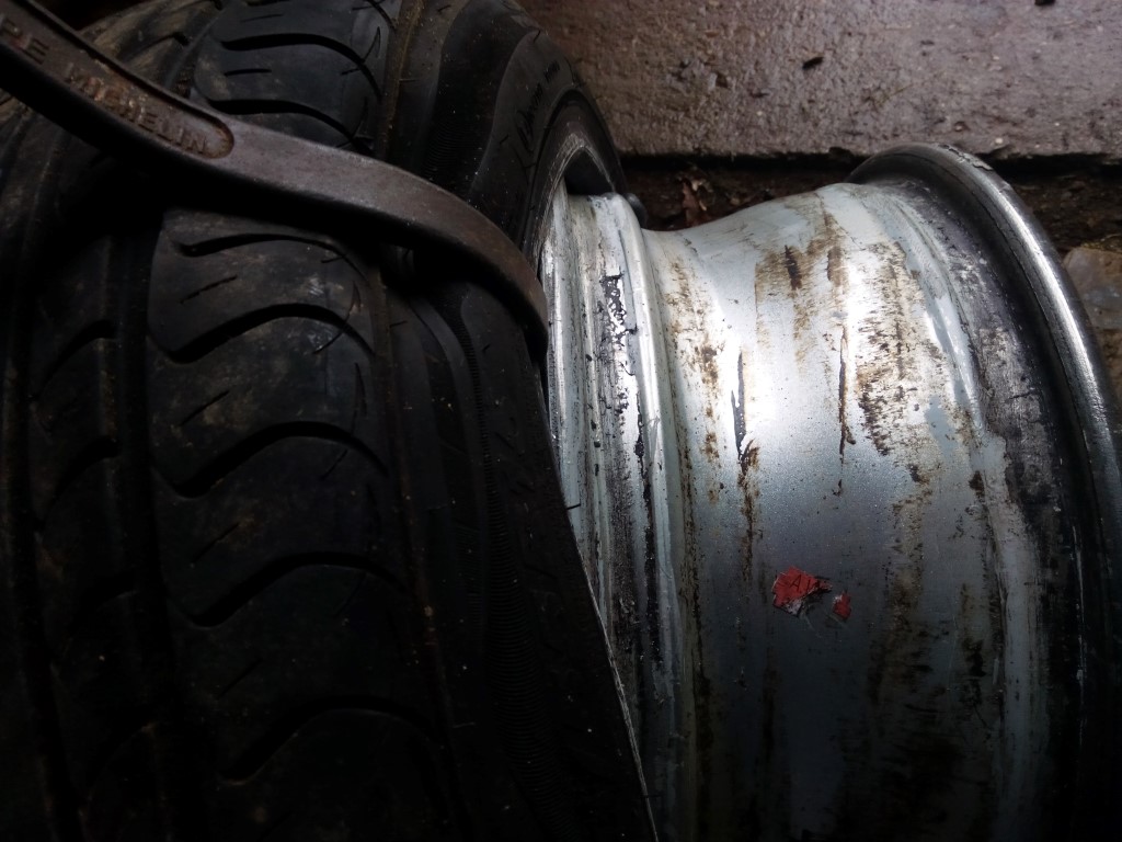

It often wont pop first try so I have to work my way around the rim pressing down as far as it will go until it slips down into the central section of the alloy.
Flip it over and do the same on the rear bead. Note the bit of rubber matting to prevent the face of the wheel scraping on the ground.

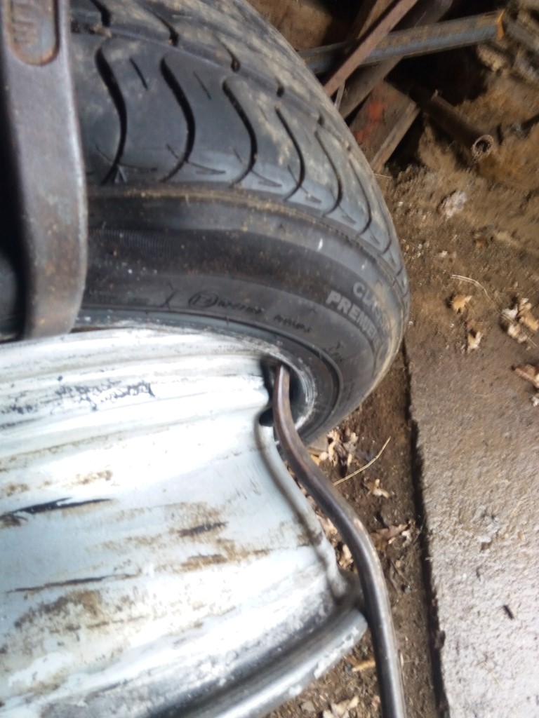

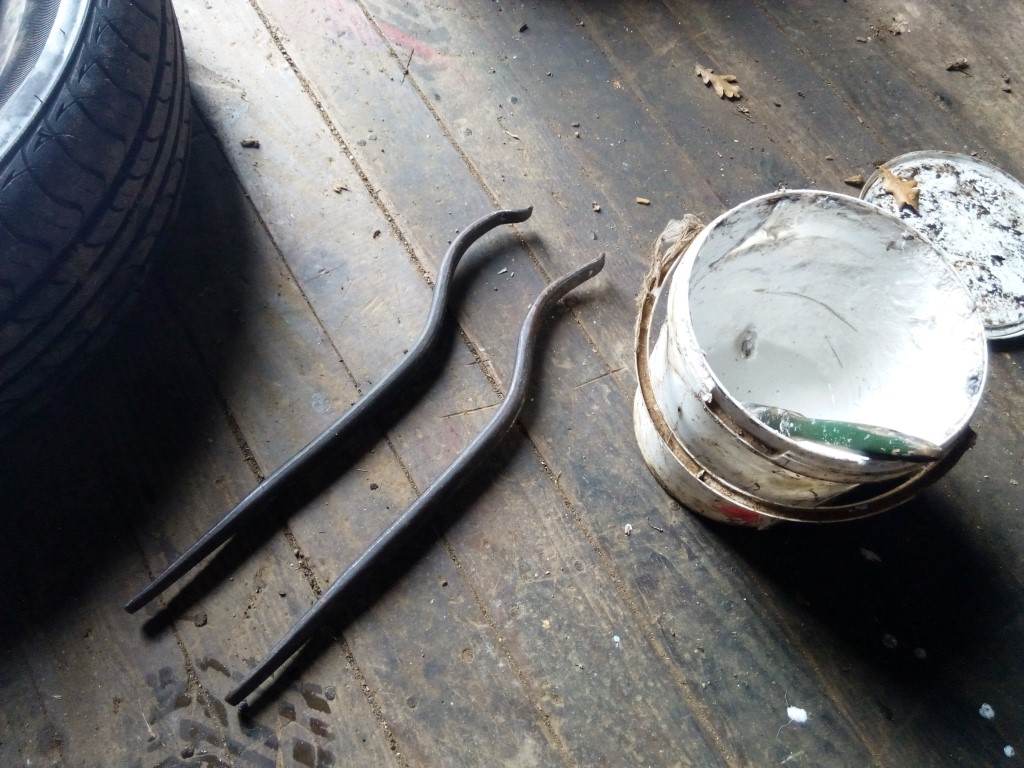

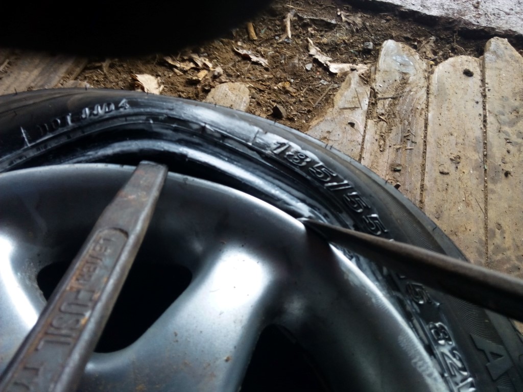

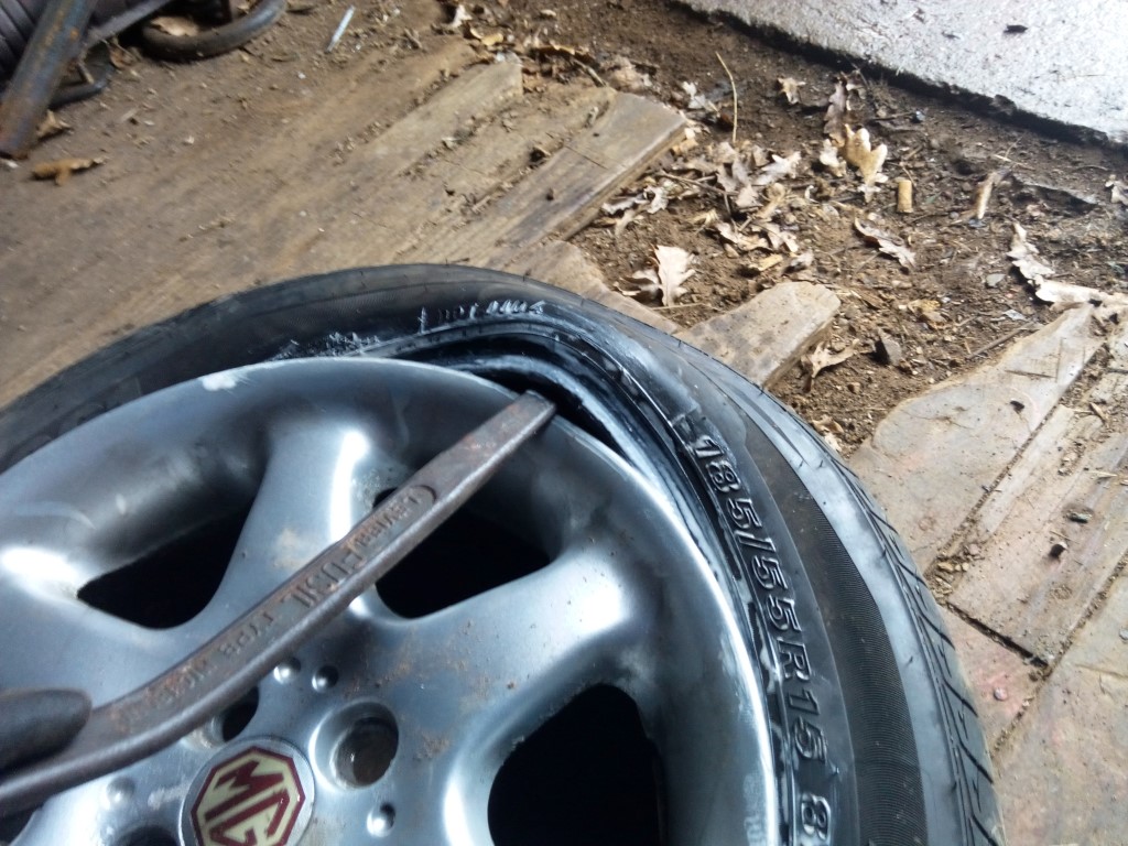

Now to get the tyre off you will need a couple of proper tyre levers and some lubricant. Obviously proper tyre lube is available but anything like fairy liquid would do in a pinch. My brother in law choggs these tubs of lube from his work where they use it on the massive o-rings before they slide large section drainage pipes together.... Seems to be the same stuff as proper tyre lube.
cont.....
Get the flat end of a lever under the tyre and making sure the other side of the tyre is properly in the central section of the alloy, lever the edge up over the rim. Some lube helps here...its not just for refitting!
A little way further round, get the second lever in place.
Flip the lip of the tyre over the rim and keep working your way round. The first part is the hardest.

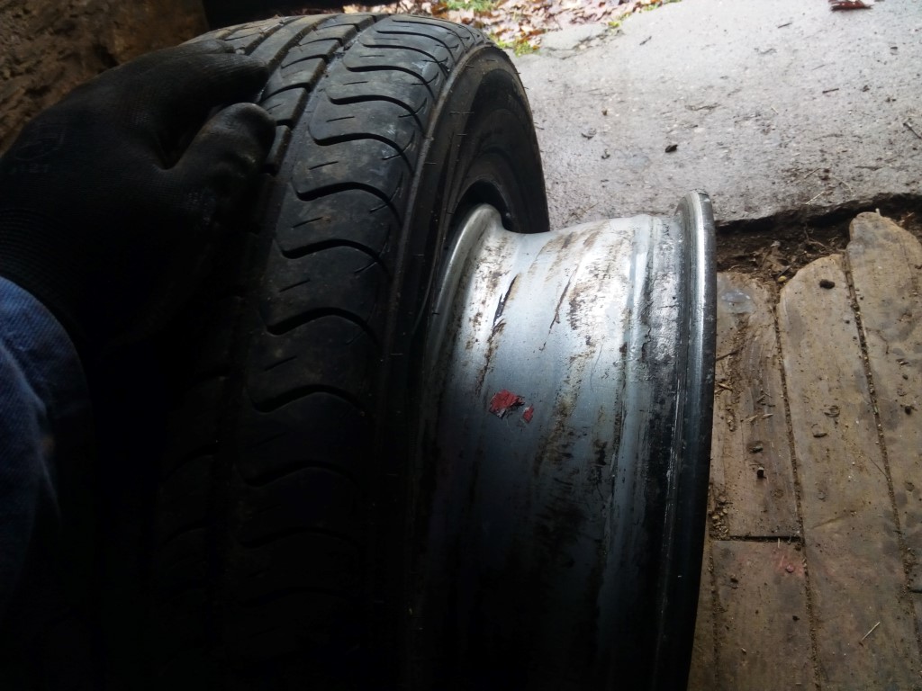

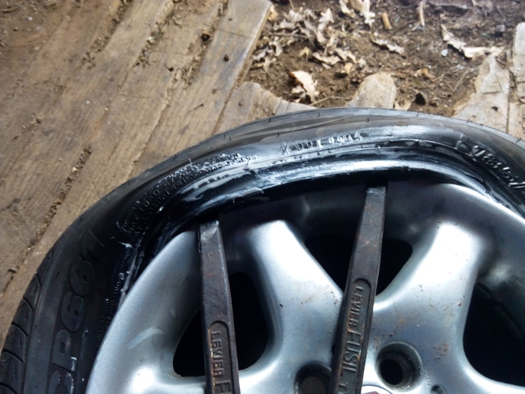

With it right off...

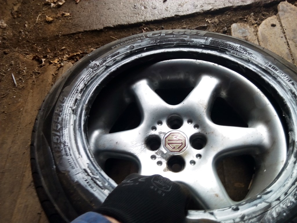

Turn it over and do the rear face. I prefer the curved ends of the levers here. Again get one, then two under the lip and ease it over the rim, then work your way around.
Cont....

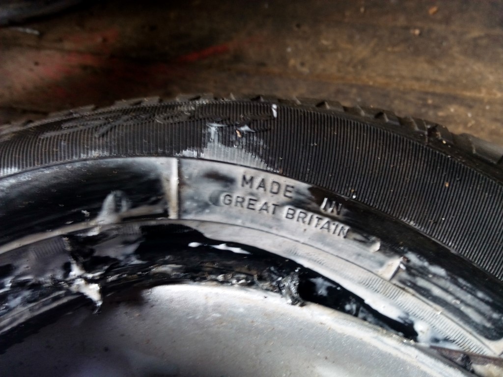

A symptom of being run flat...little balls of rubber inside the tyre.
Really? Not just the Chinese doing cheapo tyres, then.

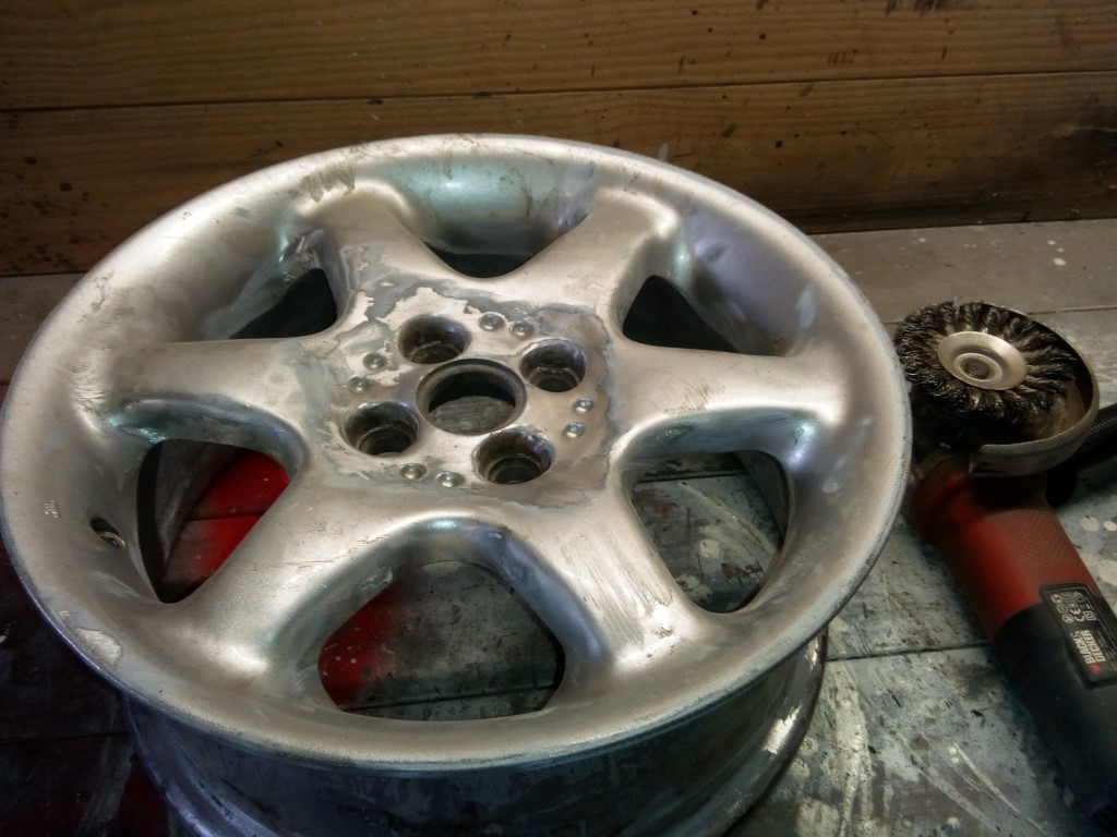

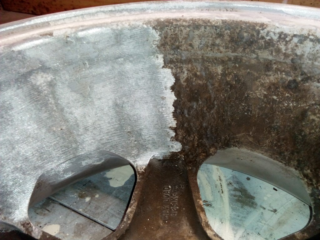

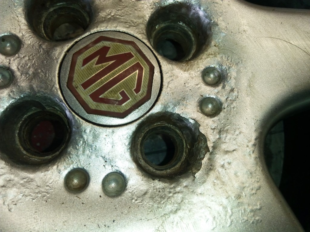

I then hit the alloys with a knotwheel wire brush in the grinder. Note that this is dusty as fuck and needs eye goggles. be careful. Also, dont breath it as especially the stuff on the inside of the rim will be a mix of paint dust, alloy dust, brake dust and other likely cancerous stuff.
I dont wear a mask, but thats because I am stupid.

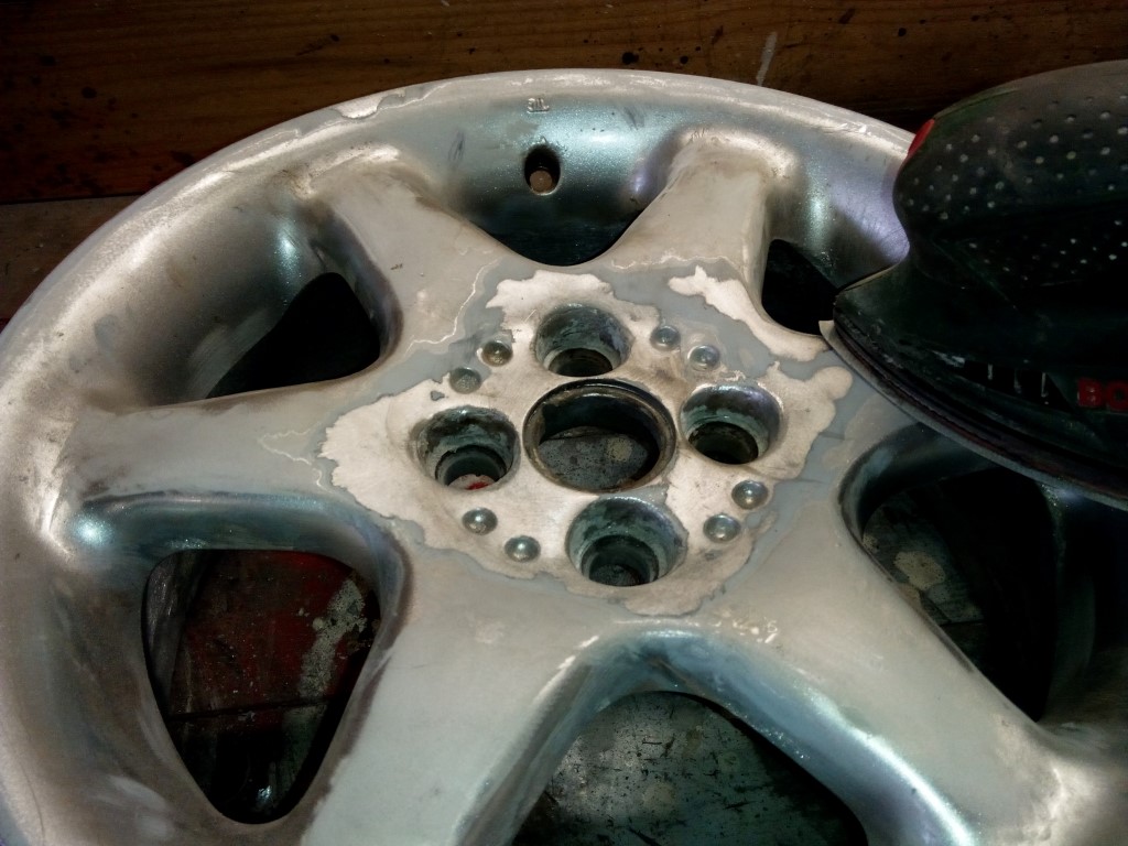

knock off all the loos shit with the wire wheel and then sand the edges smooth with a palm sander and some 120 grit.
Everyone always says the key to a good paint finish is in the prep, and they are totally right. However, I hate painting and am invariably bored of it all by this point so its a case of "that'll do" once its all smooth-ish.

Soz for interrupting this, mate. Just wanted to advise folk to say away from the chocolate 'Toolzone' etc levers!

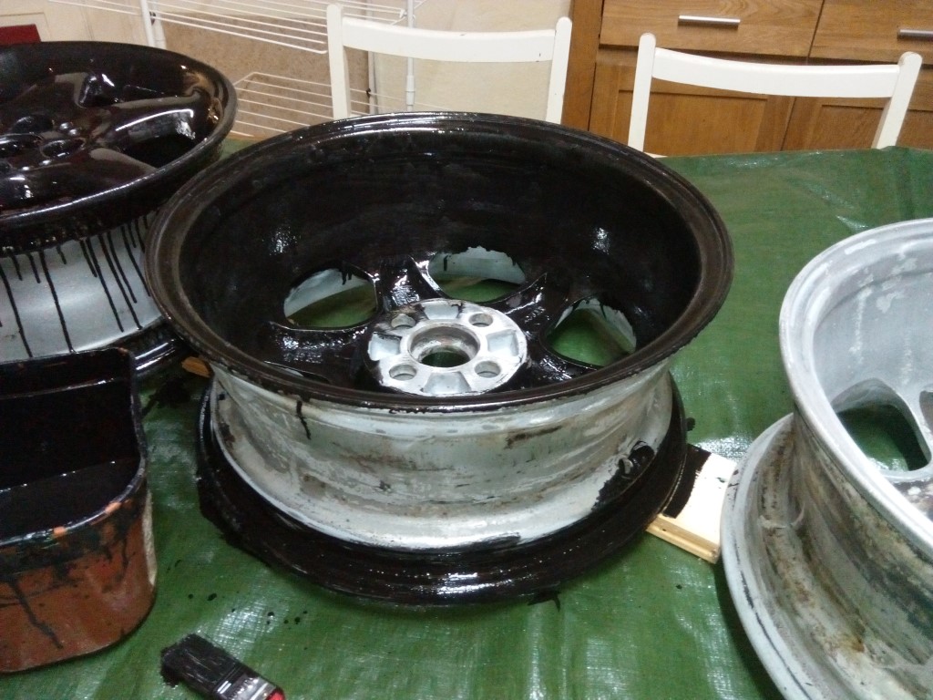

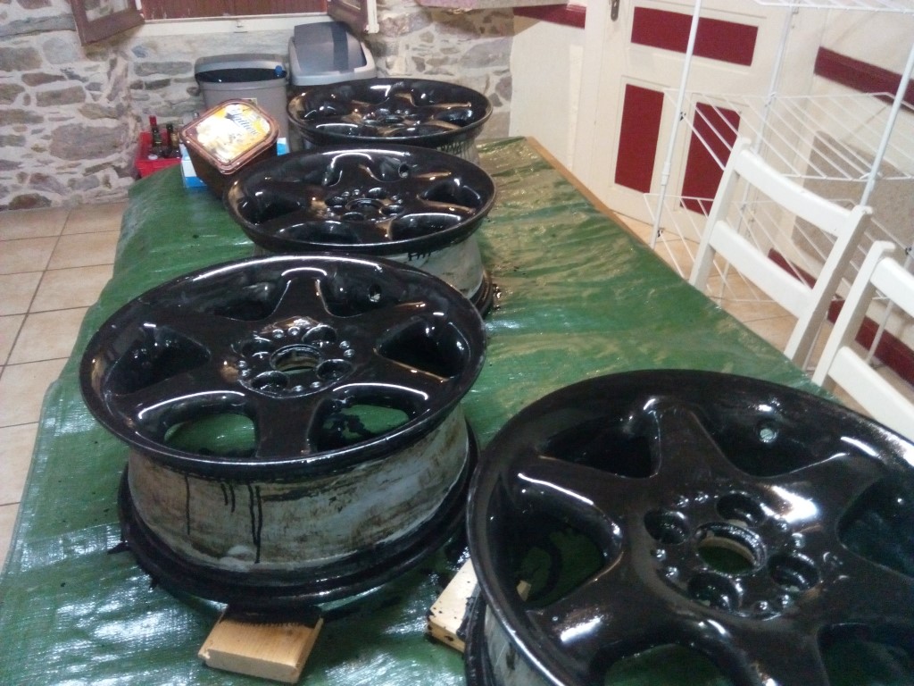

Its Baltic out and paint would take days to dry so in the warmth of the kitchen things will go a lot faster.
I just use normal metal paint for garden gates and stuff. Avoid water based stuff as I find it to invariably be shit. If the tin says it needs cleaned up with water, its waterbased and basically just tinted dog piss. If it needs cleaned up with white spirit, its oil based and should be better.
After carefully considering the aesthetics of a blue car I decided to use I had a load of black paint left over from a previous job so they got done black.

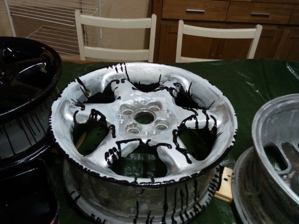

For the first coat, thin the paint with white spirit quite a lot. Coverage will be wishy-washy but thats fine, you just want it to form a sticky surface for the next coats which will fill in the gloss properly.
So that when  you flip it over you can deal with the runs from the edges..
You arent too worried about runs on the back.
also, make sure you get a good layer around the inside of the rim where the tyre seats, this will help provide a good seal.
Dont paint the mounting face. Ideally you shouldnt paint the wheel nut seats eaither as this can cause problems with wheelnuts coming loose in the future. Its pretty hard to avoid the nut seats though so I dont worry and will just scrape it off later.
First coat done.
Like I say, I am not looking for perfection at this point, just a good key for the next coat, which I will get on this evening.

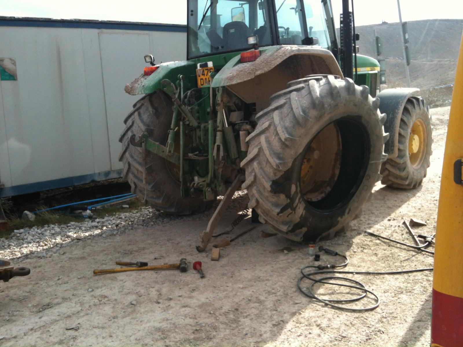

A buck rake tooth makes a good tyre iron and I've used the jack under the weight of the Land Rover's Perkins loaded front end to break the bead.
Think I'll use the hydraulic stabiliser leg on the hymac the next time though.

I re-coated the wheels at dinnertime and they looked excellent - glossy and smooth. I then added a third coat just before sleepytimes and it went to shit, reacting and going slightly wrinkly.
eh fuck it, i dont want to sand them any more so I just left it.

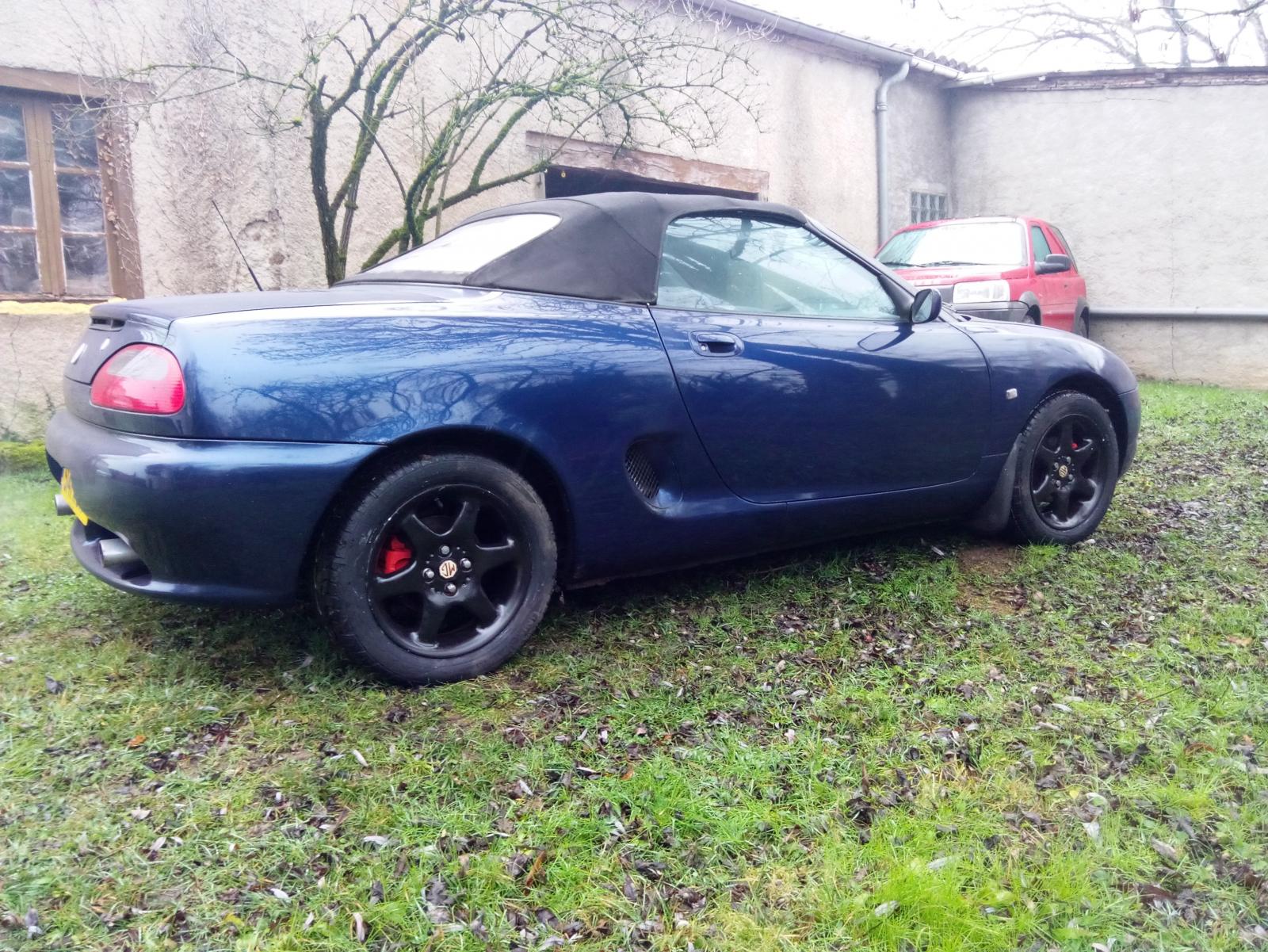

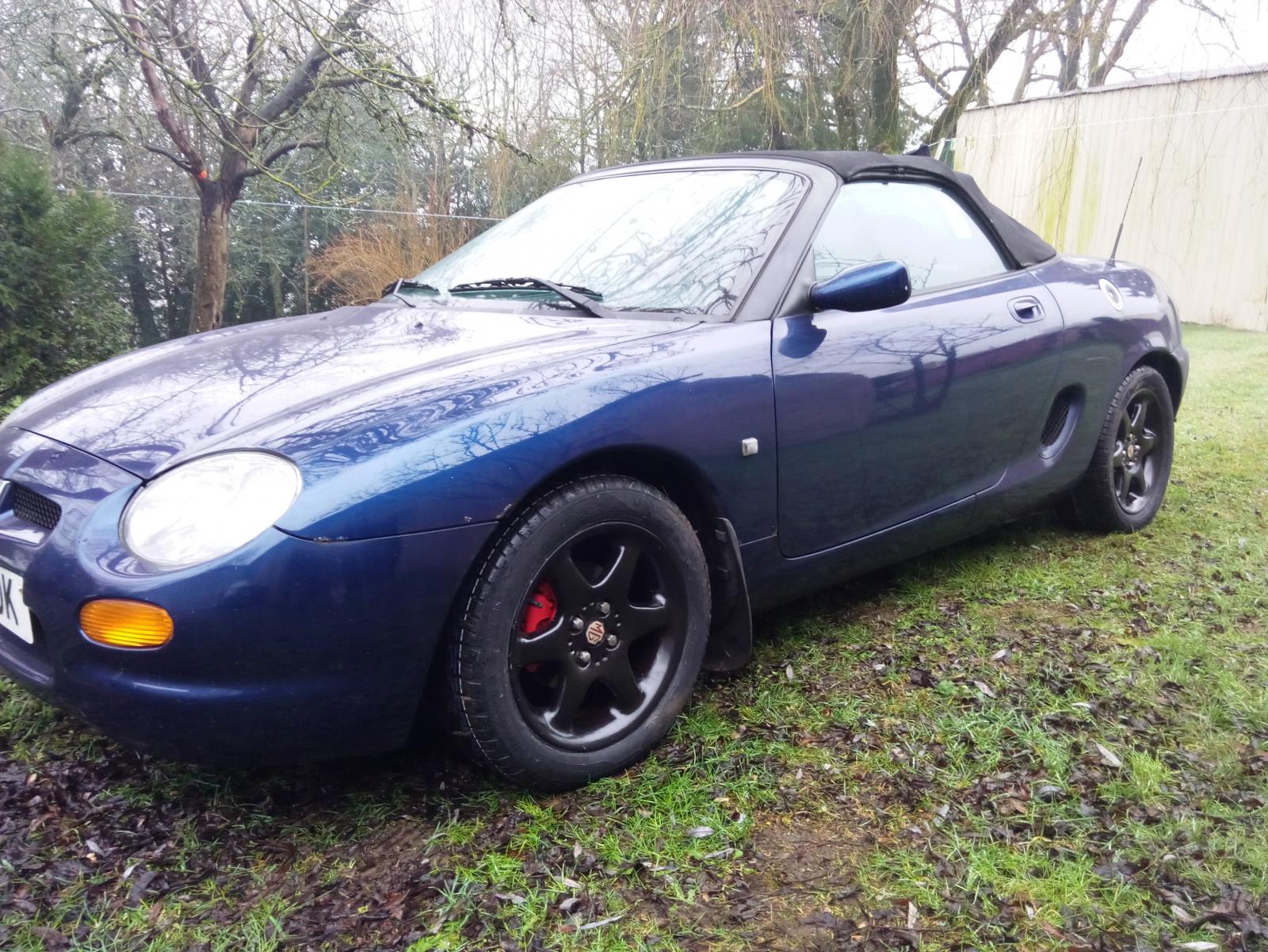

This morning I got 4 new valves from the tractor parts shop and fitted the new tyres - Uniroyal Rainsports. Refitting is literally the reverse of taking them off, so no photos. Use lots of lubricant to help them slide over the rim.
I then balanced the fronts using a manual wheel balancer I picked up a while back. Its quite a trick thing, but fiddly to use. I only did the fronts as I have run out of balance weights.
Before refitting the wheels I gave the calipers a quick squirt of red paint because extra top end speed.

I'm usually quite sceptical of black wheels but that manages to look pretty smart. If you're not sure maybe take the centre badges off, that might help.
