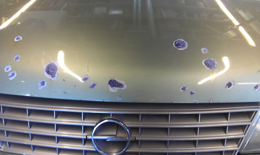

Royale80 Posted January 21, 2017 Author Posted January 21, 2017 Afternoon all, Whilst waiting for a set of injectors to arrive (from the excellent Autobahnstormers club shop-Keith is superb!) I've done a couple of other jobs today. The oil light and gauge did not work-buyer told me about this - the wires were off and he said they were a pain to get back on. Totally correct-access to the sender even from below was very bad! Eventually (1.5 hours later) got everything attached and now have a fully working gauge and warning light-pressure looks very healthy (62000 miles). Then had a go at the numerous rust blebs on the sills and bonnet. Thought I'd give Vactan a go-seems to be good. Friend (Civil Engineer) recalls that this was the only rustkiller allowed on a military job he was involved in years ago. Will hopefully get the injectors in the week and swap over. Underbody is superb on the car- mileage does seem genuine. Onwards and upwards! Steve Coprolalia, Vince70, danthecapriman and 8 others 11

sierraman Posted January 21, 2017 Posted January 21, 2017 Is it suffering from syphillis going on the wart like growths on the bonnet? Top bombing there. Not many of these left they were a real cut above the Granada. Royale80 1
