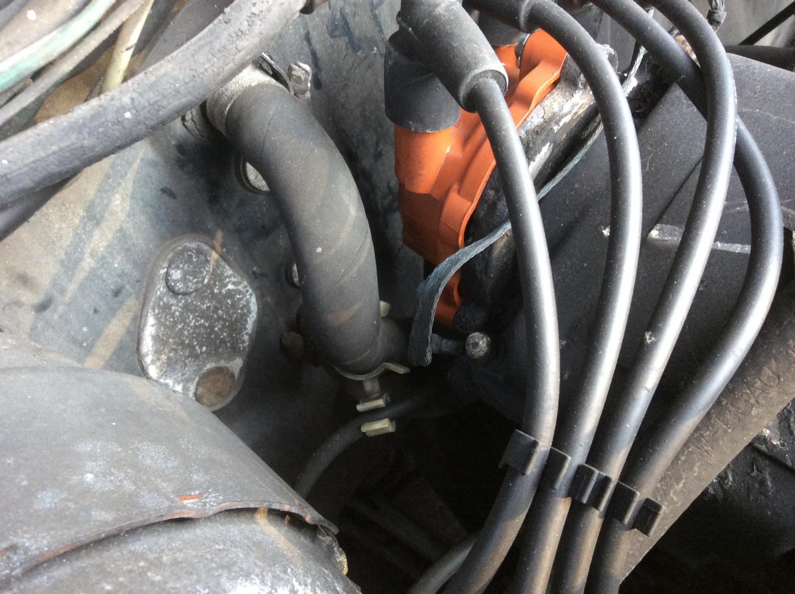

The two heater hoses are a bit tight to get to.
The lower hose clamp was a bastard to loosen. It was rusted to hell and not in an easy position to get off. I’ll replace them all for new after this though.
Hoses off and the two heater matrix stubs are visible. Both of which look in decent enough condition but were visibly full of sludgy mank.

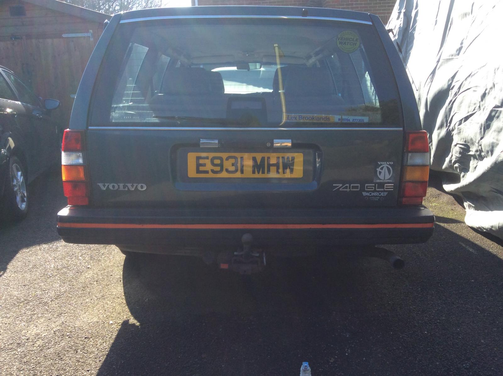

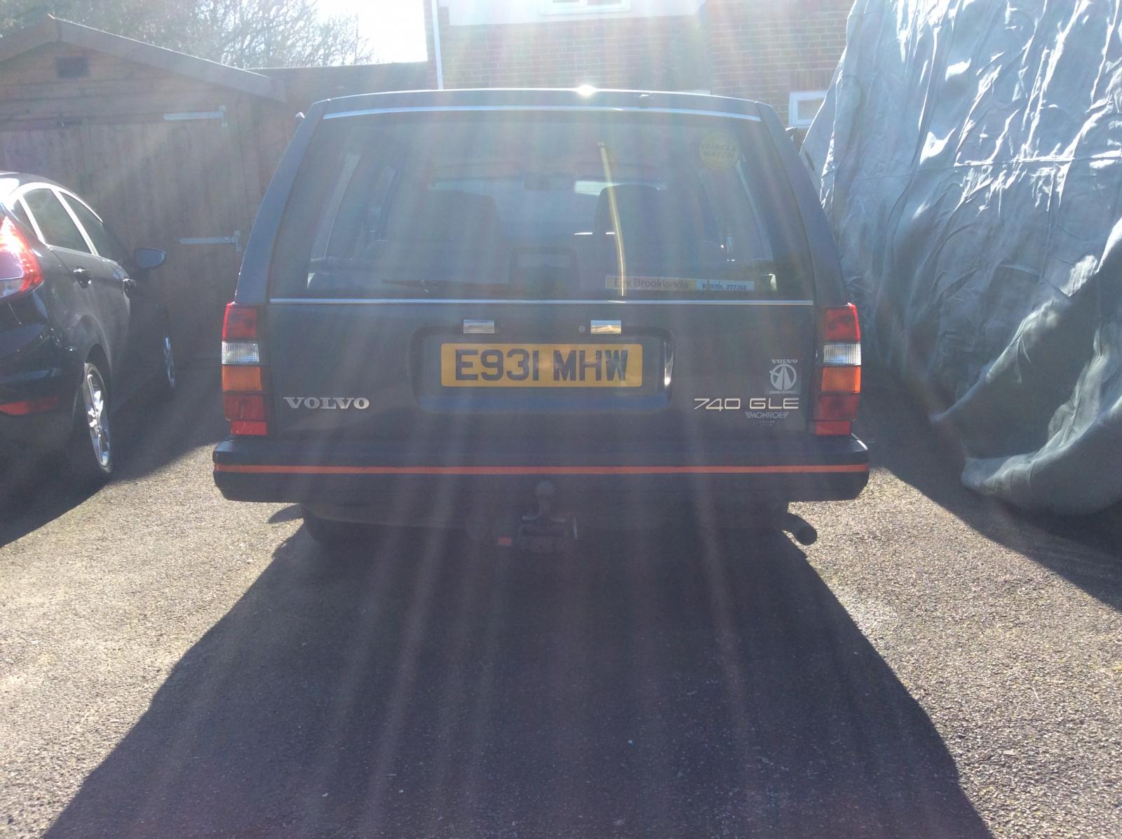

Since it’s a lovely spring-like day down here I’ve finally fitted the new rear lights.
Old ones weren’t too bad tbh, and most people would probably have just left them. Not me though!

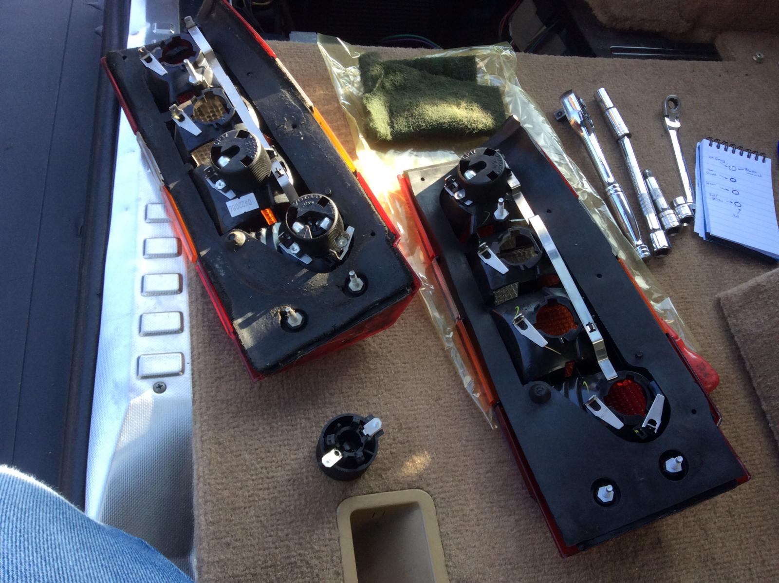

They were a mixed make pair and both had faded a bit and had dirt/grime in the lenses. The seals weren’t great either.
Access to the estates rear lights aren’t quite as good as it is on the saloons! My big fat hands made it a bit of a struggle to get the retaining nuts and bulb holders out!

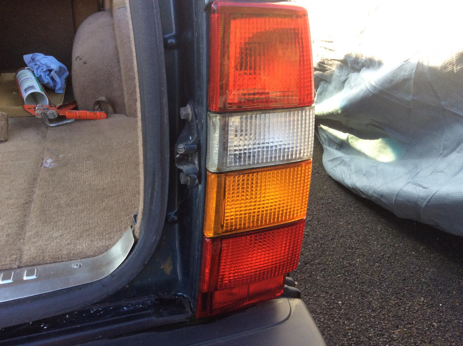

Passenger side light was easy, the old light was even the same make as the new ones. Only three nuts to undo, pull the wires off the back and the light just lifts out. Ive cleaned the paintwork under the lights too, there was quite a bit of grime under there.
While all this was in bits I’ve taken the time to strip all the bulb holders down, and clean them up. The contacts have all been cleaned up with a green scotch pad and on reassembly given a very light dab of silver electrically conductive grease. Should help everything to stay clean and corrosion free.
Reassembly was the reverse of removal. Only thing extra I’ve done was a bead of sealer around the light hole in the body and around the bolt holes, just to be sure it stays water proof.
One down, one to go. New light on the left old on the right.

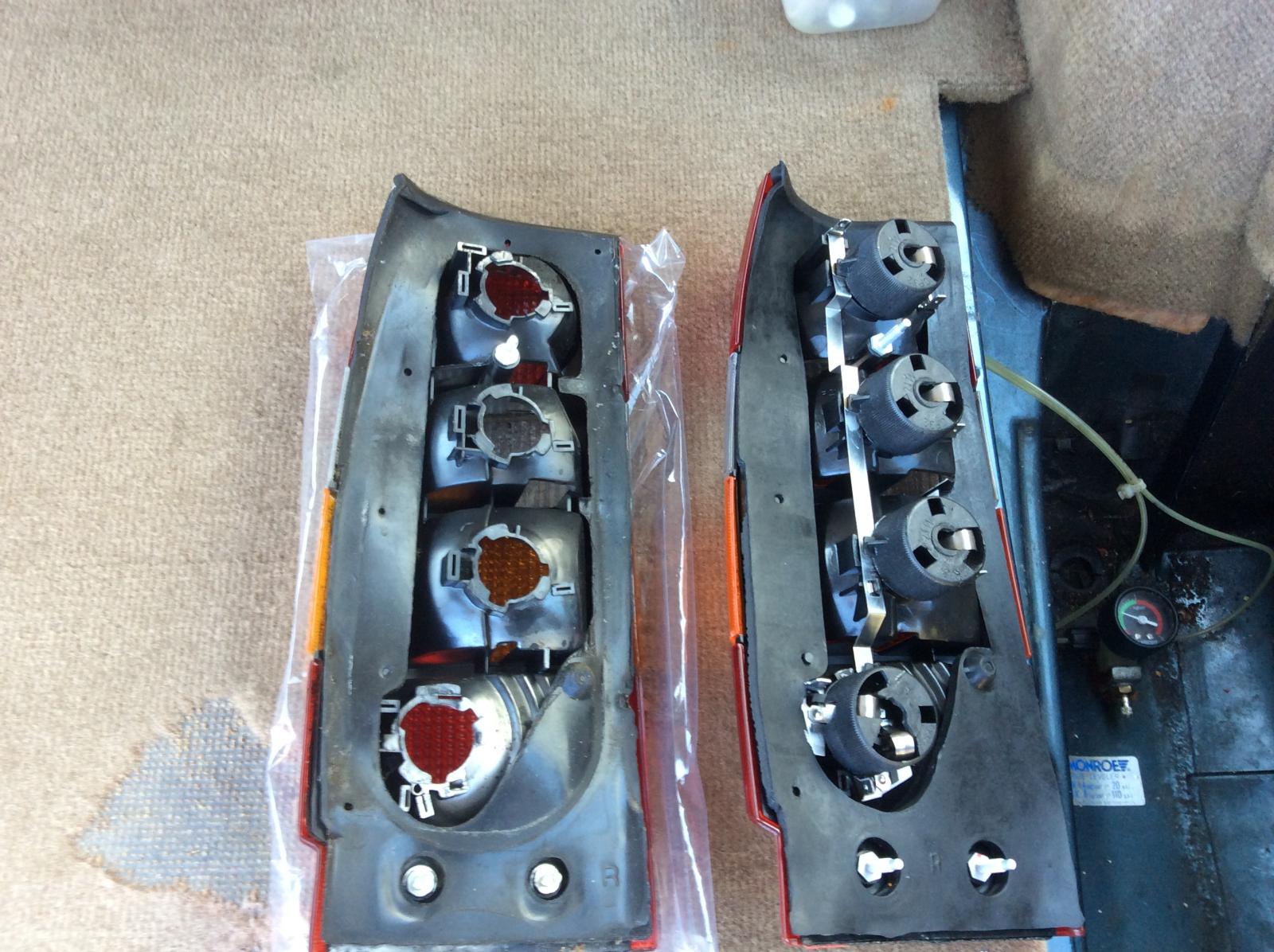

The drivers side light was a little bit different. This one was much older than the other and a different make.
Main difference was twice as much wiring in the back of it. On removal the reason why became clear.
Spot the difference!
The old light hasn’t got the silver earth/common return bar. It looks like it did have one as the clips for it are all there but the bar is long gone.

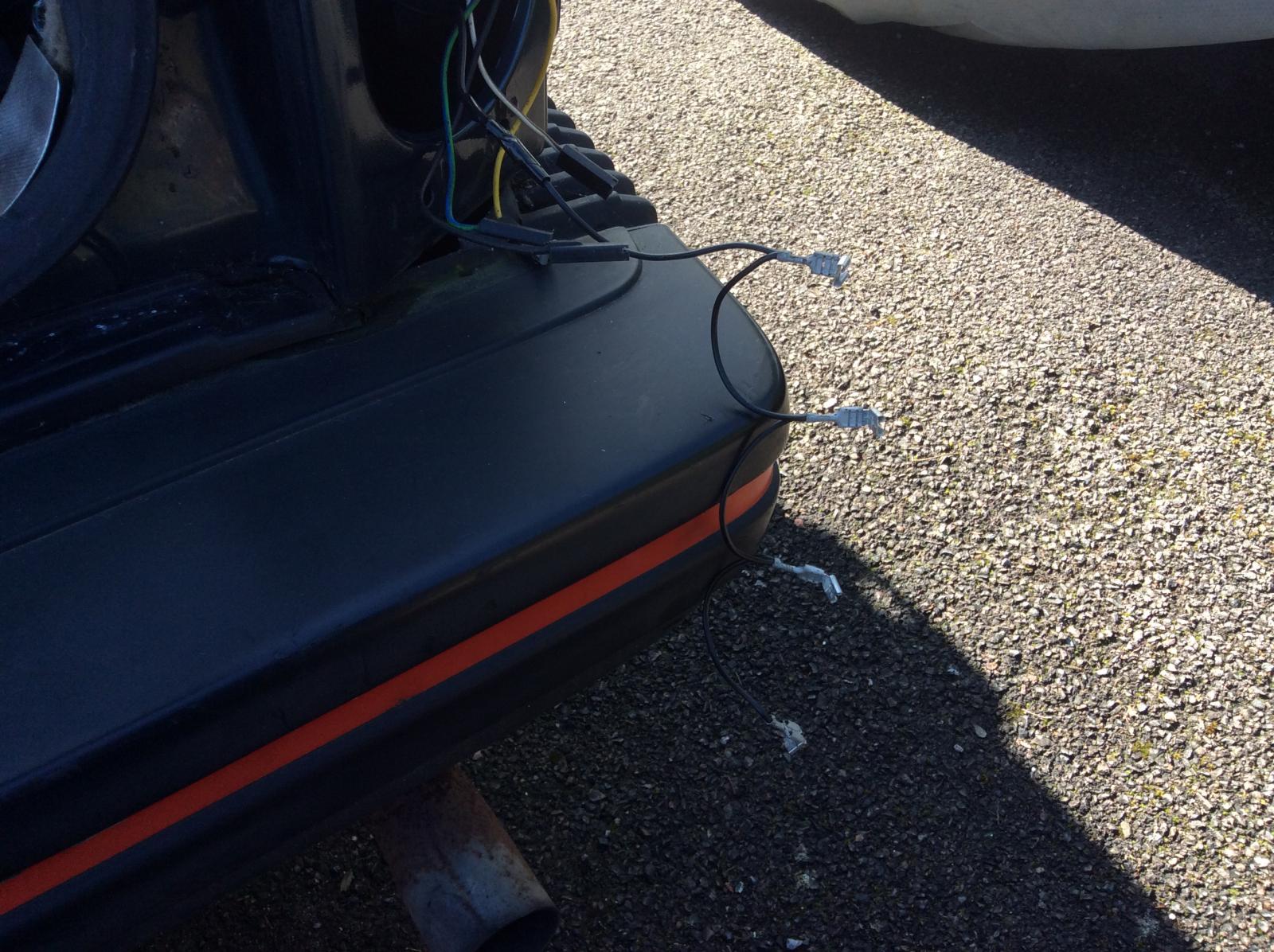

Instead someone has cut the main earth wire back, crudely added another short length of wire to it (wrapped bare wires together and used electrical tape over the top!) then crimped a new connector on the end, with some extra loops crimped to that to individually connect each bulb holder together on their earth sides.
Here’s the wire in question.
There’s nothing wrong with this, apart from the shit way they joined the new and old wires together. But, on these lights it makes the earth/return connections interfere with the good connection to the contact between light body and bulb holders on the new light units. Plus, on these cars the bulb failure warning lamp on the dash works by electrical balance side - side. So if the car picks up an imbalance when a bulb pops that difference is shown as a fault and the bulb fail light comes on.
Problem being that given all this bollocks basically works on resistance the current way things are means both sides of the car are currently wired differently. One side (drivers rear) has significantly more joins and connections in its wiring than the other side... this all adds resistance to the circuit. That piss poor connection mentioned above will also add extra resistance!
Funnily enough I’ve had a lot of problems with the bulb failure light coming on with this car, often with no bulbs actually faulty! Now we know why!
So on this light I’ve done exactly the same, cleaning everything up and using a tiny dab of contact grease on everything and reassembled the new light unit. It was harder on this side as all of the earth contacts on every bulb holder had been bent and mangled by whoever had fitted their ‘new and improved’ earth/return system!
To fix their shit wiring I’ve just cut it off entirely, soldered on a new length of wire to replace it with a single spade connector on the end to go onto the one and only connector on the back of the new lights earth bar. Much better and much tidier.
Both new lights fitted. I’ll leave them as they are for now then after a few months try retightening the fixings as the new sealing rubbers were quite stiff! Hopefully they’ll settle a bit after a while.
They look way nicer imho.
Tested and all working now too, with no bulb failure light illuminated on the dash!
