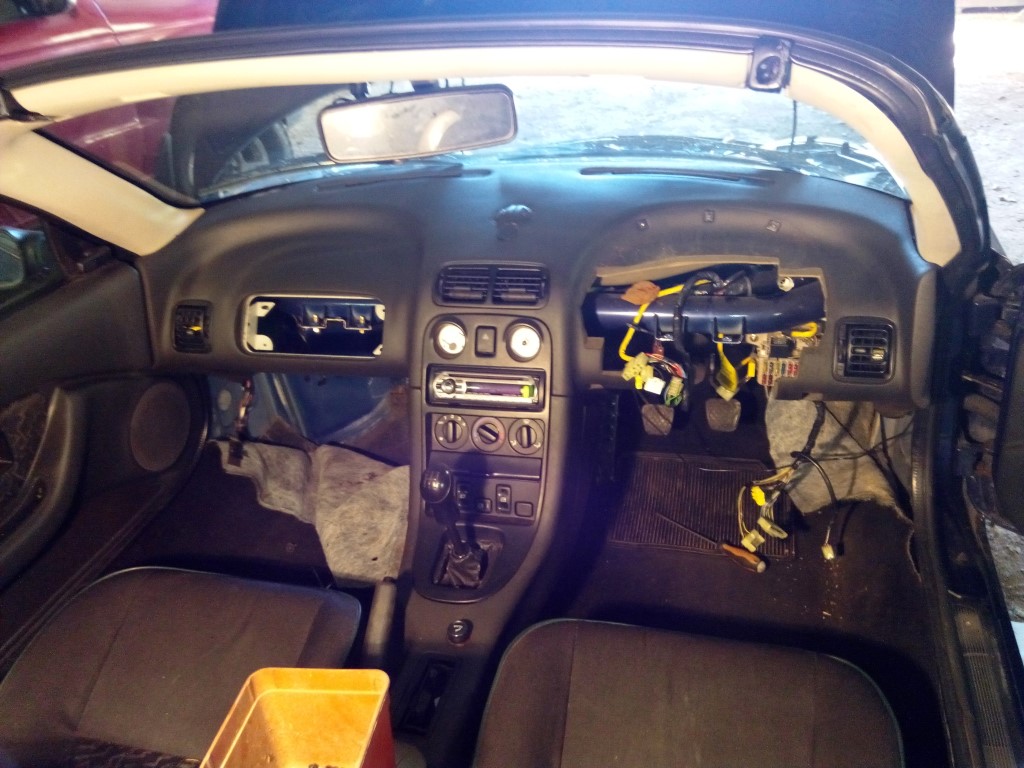

dave21478 Posted October 15, 2016 Author Posted October 15, 2016 I decided to have a look at this with a serious view to LHD conversion. Get yer column oot for the lads.... Its a slightly unusual arrangement in that it uses a manual steering rack with an electric motor providing assistance directly to the column. This simplifies things for me as I just need to buy a basic manual LHD rack, which is quite cheap as opposed to a hydraulic one. The dash cutout is less symmetrical than I had hoped. In fact it looks like Nigel at the factory hacks the relevant section out with a blunt axe.Need to find a solution to cover that hole on the right if I cant get a LHD dashboard. I have some ideas in mind. In the front I took the servo etc off To remove the crossbar that links the left-mounted servo to the RHD pedals.This can go in the bin. The pedals then came out. These cant be swapped over without major re-working, but feck knows what the chances of finding LHD ones are. Not good, I suspect, so I will likely end up reworking them to fit. Dash out to get at the wiring loom. I will need to cut and extend part of the loom so I can relocate the fusebox on the left. This is less work that extending all the wiring to the column controls, plus if I left the fusebox on the right I wouldnt be able to fit the glovebox there. Pile of bits.... And thats where I got to today.I havent crossed the point of no return yet - it could all go back together as it was, but I reckon I will forge onwards and convert it. Its perfectly feasable....not the easiest I have ever done, but not the hardest either.In an ideal world I would find a LHD one in a scrappy to get parts from, but they are mega-rare here. there is a couple being broken on LeBonCoin but its a hassle getting replies from folk and I doubt anyone could be arsed removing stuff like a pedal set to sell without asking a massive price.I could do with other LHD specific stuff too, but its relatively minor bits like LHD wipers, air intake and heater ducting. I can do without/bodge as appropriate in the meantime though. Jim Bell, trigger, DeeJay and 13 others 16

Dave_Q Posted October 15, 2016 Posted October 15, 2016 I'd wager a strange plastic fiver that the pedals are the same as something else that sold more in lhd-land - 25/45 etc? RobT and overrun 2
chaseracer Posted October 15, 2016 Posted October 15, 2016 Are the pedals common to other Rovers? EDIT: Dave Q quicker on the draw there!
dean36014 Posted October 15, 2016 Posted October 15, 2016 Is it not worth looking over here for left hand drive bits? normally LHD stuff goes for peanuts as nobody wants it.
DodgeRover Posted October 15, 2016 Posted October 15, 2016 Is it not worth looking over here for left hand drive bits? normally LHD stuff goes for peanuts as nobody wants it.Seems to fetch more than equivalent RHD down here for export!!!!
dave21478 Posted October 15, 2016 Author Posted October 15, 2016 Aye, the days of cheap LHD stuff in UK are long, long gone since the French and pretty much everyone else in Europe realised the price difference and hoovered up all the good stuff. During the week I will be heading to a few scrapyards. I also thought about other Rover group pedals, and even if they arent quite the same would probably be easier to modify than re-doing these ones. Need to stock up on wire and heatshrink too.

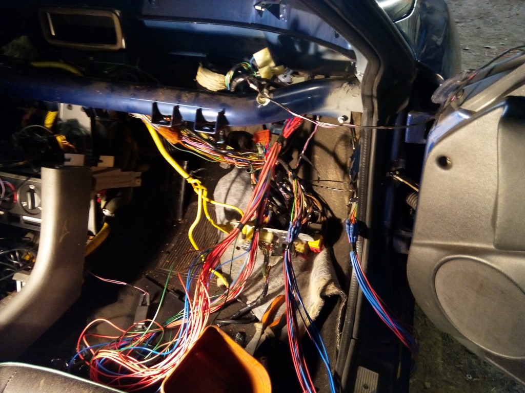

dave21478 Posted October 16, 2016 Author Posted October 16, 2016 I quite like the position, but my body is an odd shape, so it suits me. And no, Im not doing this at the farm so Kevin hasnt been able to shit on it yet. This afternoons progress was the wiring loom. In total about 35 wires of various sizes needed extended. I could probably have done less as I didnt think too carefully about the door loom. Mine doesnt have electric mirrors so thats a load I did for nothing anyway. There is a main trunk that goes across the dash rail to the fusebox with hundreds of wires in. I didnt fancy doing all of those so my plan was to rerout this main trunk back over to the left where the fusebow will go and extend the stuff that goes to the right from the fuseboxes old location. This is mainly the ABS loom, right hand headlight etc and the right hand door. Getting into it.... Obviously I only had 4 colours in the correct thicknesses, so....well, good luck fault finding that, future owners.....I cut and extended one at a time as there are several wires of the same colours in the main loom that go to various locations so cutting them all at once would have fucked it right up. Moving the fusebox and main trunk.... Nightmare. At this point I started wondering how many strands of wire I would need to braid together to make something strong enough to hang myself from the garage roof. Stop being a pussy Dave, you have done worse than this.... Fusebox bolted in on the left (bracket is already there as standard) Starting the neaten up and tape the bundles. I have run out of tape so stopped there for the evening, but everything seems to be going well. I had to cut three ABS wires to unpick them from the main trunk, which I havent reconnected yet. Since resistance is crucial there I will solder those when I join them. Everything else has been crimped so far.Still need to tidy up around the left hand side but I want to get the steering column in for a trial fit to see how long I need to leave the sections that go to the wipers etc.Also need to reposition the power steering ecu which is the silver box on the left. I would say I plan on making a nice custom bracket to bolt it to, but realistically its going to get shoved down the back of the fusebox and held with cableties. trigger, Sigmund Fraud, michael1703 and 24 others 27

dave21478 Posted October 19, 2016 Author Posted October 19, 2016 Its been one of those afternoons where lots gets done but nothing really shows in photos.... I finished the last of the wiring, neatened up the loom and clipped it all into place. I then set about the pedals. I had a rummage in a breakers for something more suitable but didnt find anything at all, so just re-worked the originals. I screwed them to a wooden block to use as a jig/measuring reference, cut off the arms and rewelded them, then added some gusstes.lol, Gussets. I then hit them with some satin black and bolted them in.I then did the accelerator, which is a seperate mounting and appear to have made a right cunt of it somehow. It sits far too high.Eh, no biggie, its just a bit of 8mm rod so I will re-bend it tomorrow. With the pedals in, I refitted the brake servo and clutch master cylinder. There is enough length of the clutch pipe to just bend it over to the other side, so that went in easy enough. The brake servo took a little thought, as without the right-to-left axtension bar thing across the bulkhead I had to join the pedal pushrod straight to the servo pushrod, but if I just used a pin or a bolt there would be too many pivot points on the rod and it would just pivot instead of pushing the servo. In the end I just welded the two together. I re-routed the throttle cable, which runs down the sill to the engine compartment. Again its long enough to just run down the other side. I should get the dashboard cut and installed tomorrow along with the steering column, so then its just a case of putting it all back together.Last piece will be the steering rack which is apparently easy enough to swap, but will likely have to wait until after payday before I can order one. Dave_Q, Jim Bergerac, Dick Cheeseburger and 11 others 14
