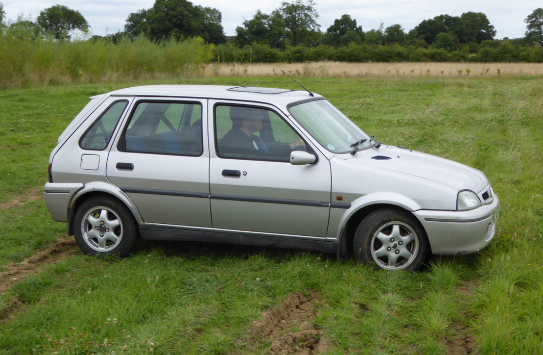

Did you drive sideways into that field?
Have you driven both types?  The K-series cars are so much better than the A-series ones in terms of ride comfort and refinement.  My last A-series one soon had K-series suspension, it's so much better.
Really? My A-series is unbearably harsh on bumpy roads...Is it a straight swap....displacers and pipes....anything else required? How much of a difference does it make?
I have spied a few K-series for sale cheap so could get a whole donor car if required.
Is there any other way?
