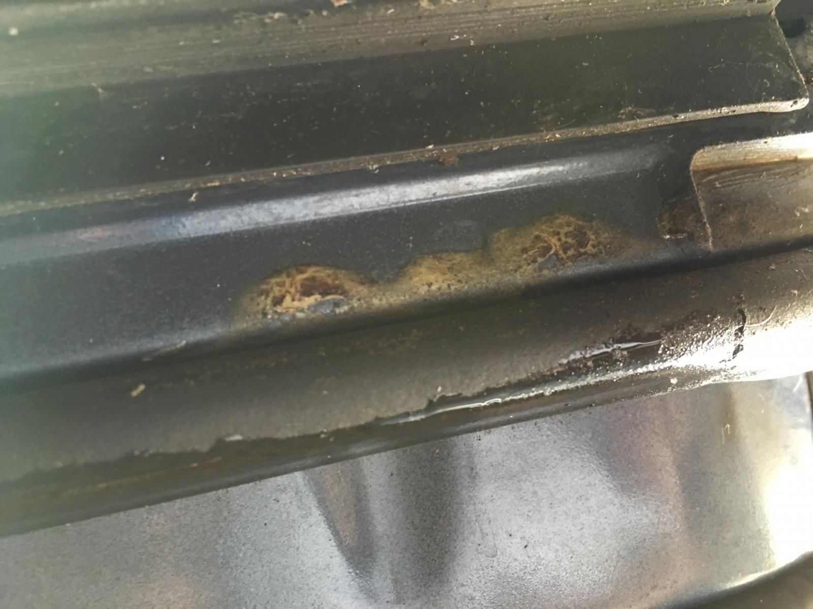

Investigations for today have revealed the extent of the door rust (driver's door), suggested the underneath is worth the investment, plotted putting the soft-close mechanism back to proper operation in the boot, discovered the headlight wipers have returned to their proper place when the lights were switched on and move effortlessly so it's just a weak thermal cutout, confused me as to why the seats don't slide forward when tilted (switches in seat, I suspect, but it may be a programming issue. That non-sliding mech is probably why I need to replace £120/worth of seat trim, the first expensive part broken. If I can't find a good used one anyway. The XJS has the same part damaged but I could plastic weld that one).

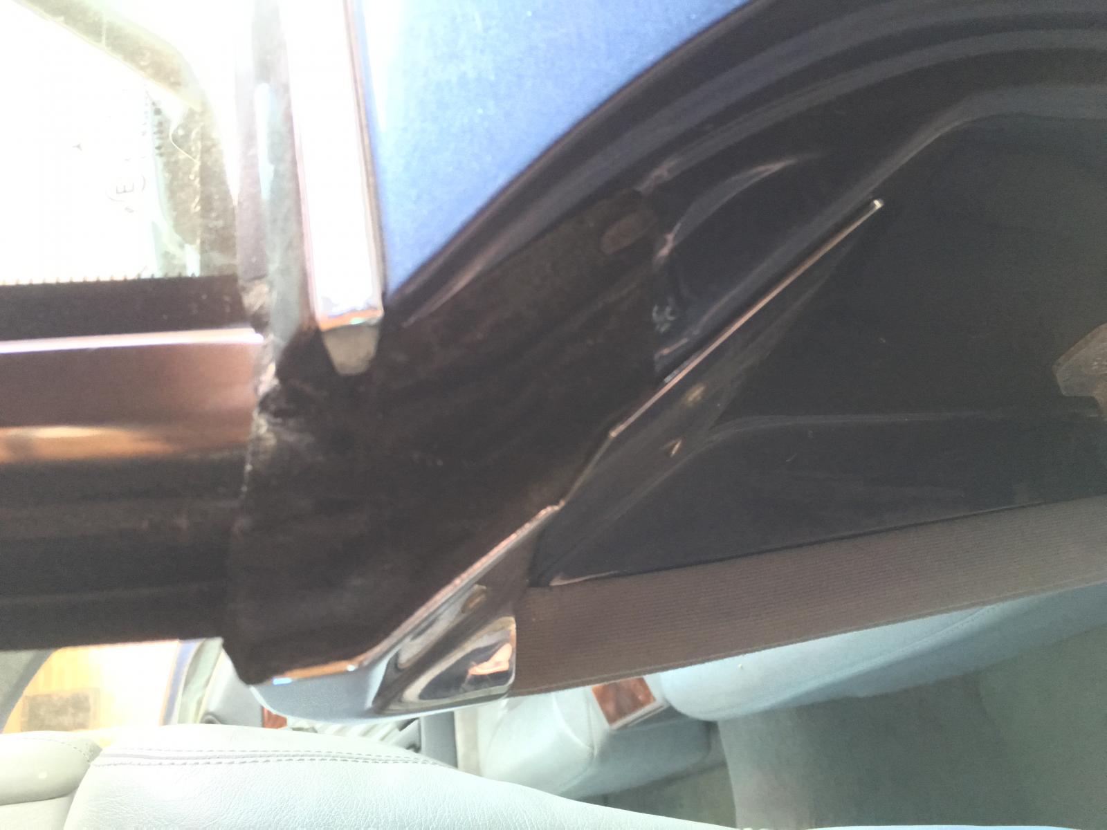

The A-pillar/door mirror sail panel rubbers are badly deformed and torn, probably contributing to wind noise - they're £33 each so will get done in the next batch of things, after I've done some mechanical bits (track rod ends/droplinks, steering damper if it has one - can't find it on the EPC but it's a box not rack, so should have). The wide rubber that covers between base of rear window and boot aperture is a whole £1.98 - this is why I replace all rubber seals on Mercedes, they're there for a reason and they're cheap to do when they've done the inevitable and shrunk so much there's a 1" gap either side. if it didn't need it, it wouldn't be there; if it's broken it may as well not be, so replace it, is my attitude!

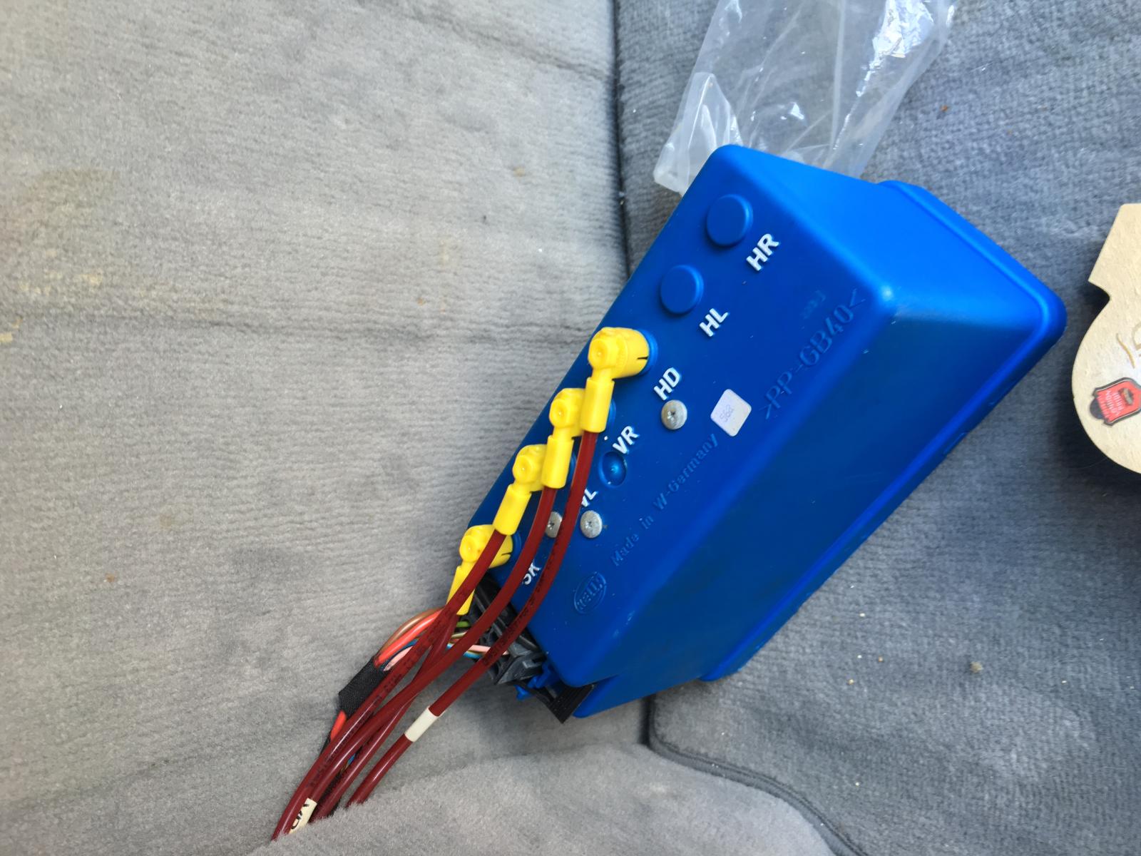

So, here's a Closure Assist pump - it's a pump to generate pressure, not vacuum like the PSE one under the seat. Outlets for boot and two doors, the blanked outlets are for rear doors on the saloon. Inside there's a module with solenoids and a large pump motor and reservoir.

Driver's door, however...
And a bit nearer the B-post end...
Kinda hard to see, but this is the mirror seal. It's all ripped up and folded over & stuff.

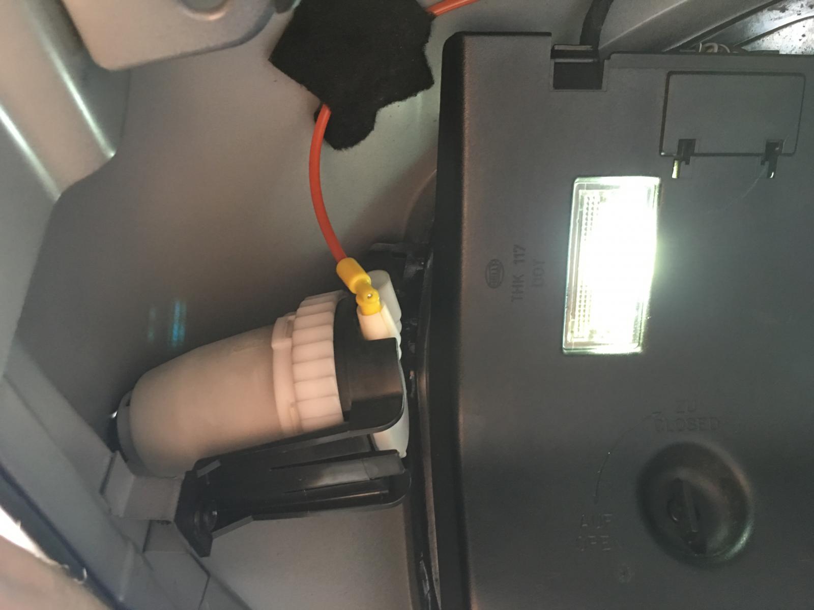

And here's an LED boot light. They're in the incredibly clever tail light holders and beautifully engineered. Of course.

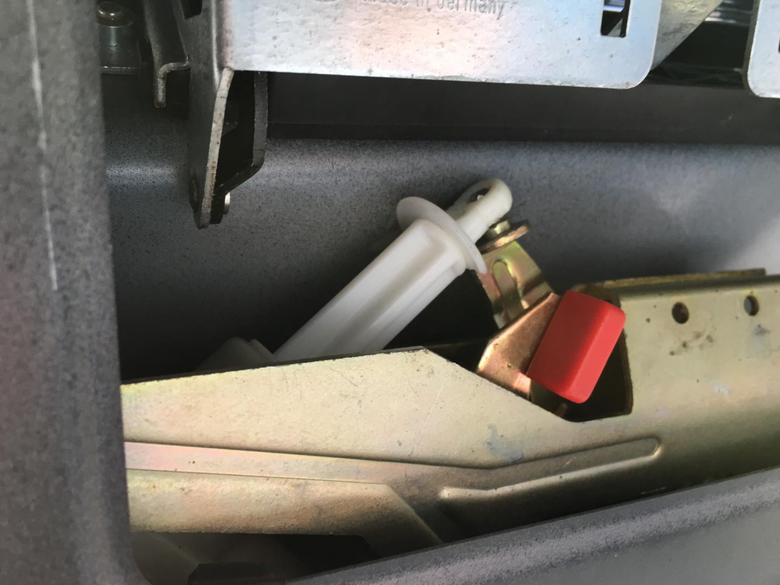

Soft close boot repaired, though I need to replace some trim clips - I broke one, and there are two missing from the latch adjustment (it gets a whole new trim piece because, Mercedes - no, not a complaint. The trim clips I found used people wanted £4 each for - they come as part of the whole trim. The whole trim is £22 brand new - so I not only get clips, I get a scratch-free brand new part AND all the clips needed, and I can sell the undamaged parts. Yeay Mercedes!).
So what was wrong? The pump was in shut off mode, and can be reset with Fuse 9 pull/replace, upon which it worked. This means "Pneumatic leak" somewhere.
The soft close works by extending, then reracting, the striker from the door - so all the pneumatic parts are in the bootlid - there are also pneumatic parts in the latch for the central locking. To get the boot to sit flush, the latch had been moved down, which was never necessary - there's a latch system in the back that will lock the striker in the withdrawn position and then the boot will close with a normal shut, albeit with a need to compensate for any wear. Looking though the latch, I spotted the first problem right away...
It may be hard to make out but there's a ball joint. That ball joint should have an actuator on it.
Still. That wouldn't explain the pump shut off. This, however, would...
I'm guessing that either it's rattled out, or the balljoint coming off the actuator caused it to jam and overpressure. Reconnect, and...
Soft close restored. I'll reassemble the carpet when I've got it all correctly aligned. Doors still not working but I strongly suspect the door microswitch, and will see if I can fake that signal to test the theory.

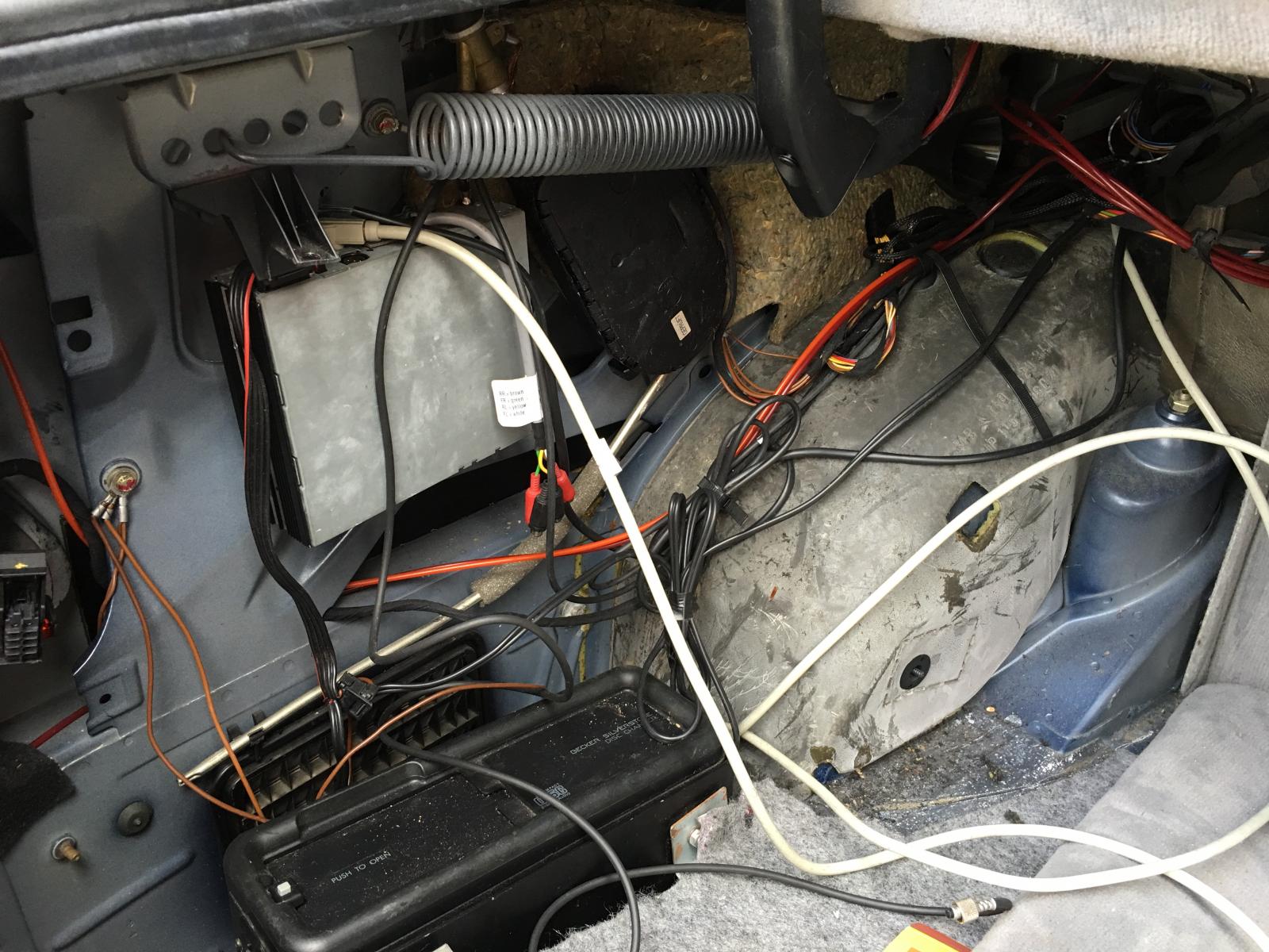

Now working out where the remaining components are in the system, the tuner appears to live in the boot!
Tuner in the boot sounds familiar, the chap who looked at it seemed to know what he was doing. Like you I thought the easiest way was to buy a replacement head unit but the only one I could find was in Eastern Europe and very expensive, so the Sony went in.
We need an Eastern German Railway station at twilight in the mist to exchange radios!
Started to untangle the radio system...
Uhoh, electrical tape *cold shiver*
Phew! Just protecting some wires!
So, let's remove the trim properly (very quick, of course).
So there's a lot of wiring, and a radio tuner, and a factory antenna lead to send radio to the front of the car, and it all looks good and not too butchered. Some foams have been damaged and the pneumatic tubes aren't in their guide, I'll sort that out at a later date, and the CD changer has been 'augmented" with some angle iron brackets - rather than remove them leaving the self-tapper holes, I'll work out why it was done, then smooth the edges and satin-black them so they look less of an improvised fix.
Oh, and there's the missing speaker finisher, must have been caught when someone last worked in there.
Detangling. I'm guessing from the length of the wires and massive cable ties, the CD changer was added afterwards, so.... out it comes. I'll make sense of the speaker wiring, my gut feeling is that an adaptor lead to the fader switch will yield the result I want.

Empty boot!
Looks promising for rust.
Got to tidy up this area, the CA pump wasn't in the right space, the foam box has been torn, will sort it all.
I think this was a guide to prevent rattles, will check EPC for location.
(It goes in behind the seat back - and had been pulled through from the back. Will remove seat and replace "at some point", the seats aren't easy to pull on this).
