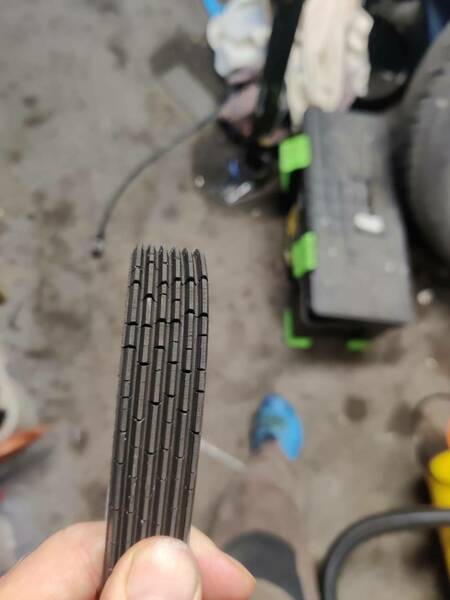

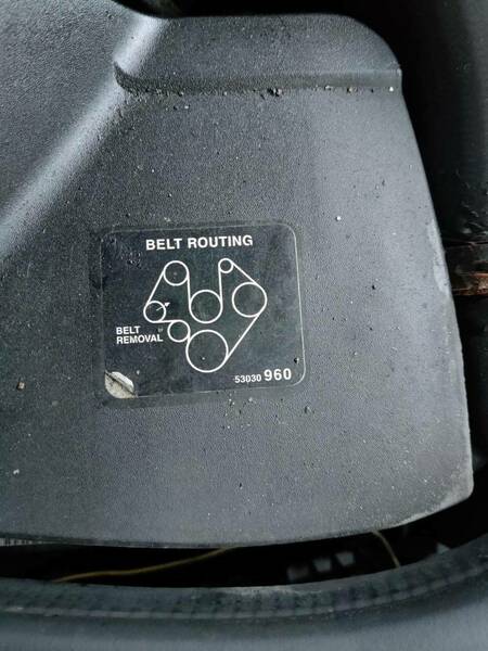

Next up a new Aux belt which was a bit worse for wear.
THis was a piece of piss, helped by this on the slam panel

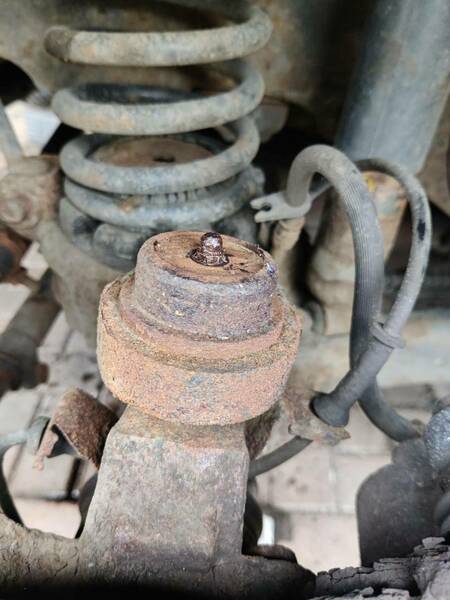

Today I got under it and gave it a poke around.
Grease nipples
Greased! For probably the first time ever. Note my Bilstein shocks, because RaceHeep

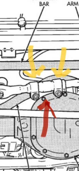

363B27F6-5DA2-4641-9564-4AA7F60DC7E9.thumb.jpeg.56eb14ed3fce9cf87f3a9c995fbb5d47.jpegto
to straighten the steering wheel
make sure your front wheels are pointing straight ahead, put the key in the ignition so the steering lock is off (important) slacken off the 2 bolts (yellow arrow)
then turn the adjuster (red arrow) till the steering wheel is straight you may have to turn it clockwise or anti-clockwise depending on how the wheel is cocked, tighten the bolts ( yellow arrow ) when finished
if you do take it somewhere to be tracked make sure they DONT clamp the steering wheel as it will damage the steering box

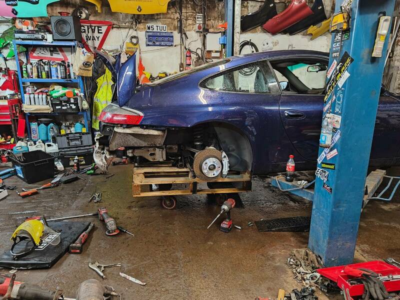

I finally managed to align things with the use of Clio Stus workshop and mate Craig being free to give me a hand to get the engine out of this pile.
Bearing in mind it had been out 5 years and 7k miles ago it put up a bit more of a fight than we expected, mainly around the exhaust. The bolts in the manifold came out no bother, the bolts holding the silencers on to the car we're an absolute nightmare though. We got there in the end with a combination of swearing, grinding, recip saw and more swearing. Bastard things. You can see them in this pic, they hide behind the bumper.
From the rear
With those off the next thing that we struggled with was driveshaft bolts. They were toit, and again didn't look like they'd been off for a while.

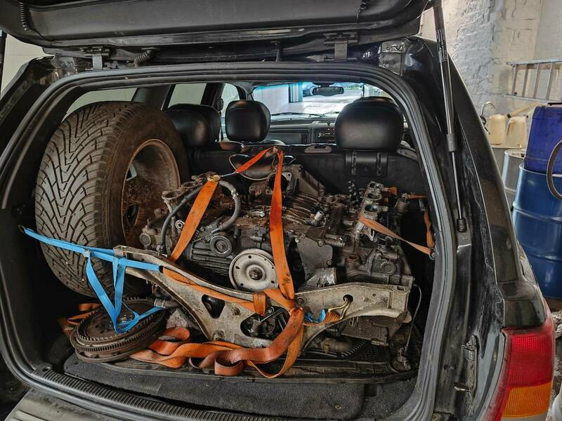

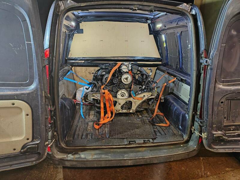

Once it was ready to drop we used a high tech engine stand to drop it on to.
And out it came!
And loaded in to the Kangoo to be taken to my lockup.
It's off to Hartech in a few weeks for them to do their thing. It's not going to be cheap but they are probably the most respected Porsche specialist so having a receipt from them will make selling it easier😳
To get it to Hartech I'll most likely use the Heep. As long as it's back together in time...

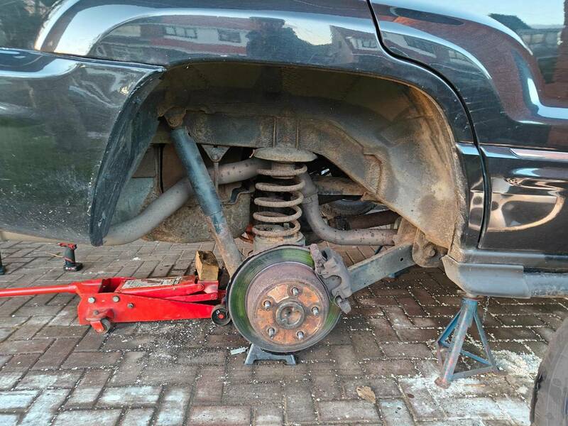

Now onto the rear suspension.
I have a bill for over £2k worth of work to the front of it from last year.  This included Old Man Emu(well known in off road circles) springs, Bilstein shocks as well as brakes and balljoints. All good, however the back end is, well, tired.
At this point I should probably mention I stuck it in for an MOT last month to make sure it was worth spending money on. The tester confirmed it was a decent example but have some advisories, mainly on the rear end.
Screenshot_2023-11-29-18-51-46-66_40deb401b9ffe8e1df2f1cc5ba480b12.thumb.jpg.fb965320188a1536df4af3ba0cb80006.jpg
So, I now have sitting here for it
Rear OME springs and Bilstein shocks to match the fronts.

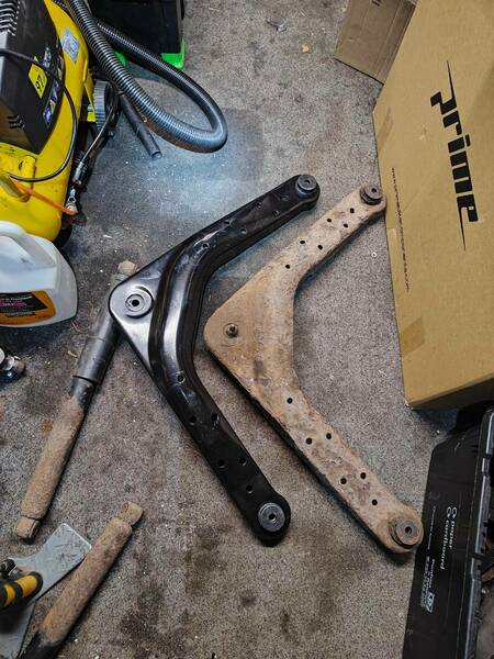

A full set of new trailing arms with bushings
Drop links
New rear discs and pads.
New steering damper
2 new* calipers (cheap off eBay as I snapped a bleed nipple on one of mine while trying to bleed the brakes up)

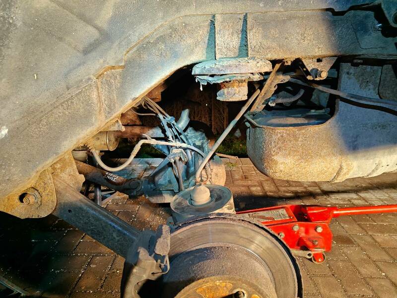

So, let's crack on then. It's lived by the sea for 8 years, how bad can it be?
Actually, not that bad!
It's at this stage just now. Everything old is off it and I've fitted a new caliper and disc to one side.
The old springs were definitely passed their best, with the weight of the car on them there was a noticeable bend in them. They had this "hockey puck" lift which consists of runner spacers to jack it up. As the new springs have a 1.5" lift to match the front they're a bit longer.
Might be fun getting these in.
That's where it's at now. I've ordered a new brake line to replace the really crusty one in the pic above.
In this pic you can clearly see the problem. My old stealth bomber was rusty.

New balljoint fitted to the diff and new upper boomerang/stealth bomber fitted
New lower arms fitted
New springs and dampers fitted

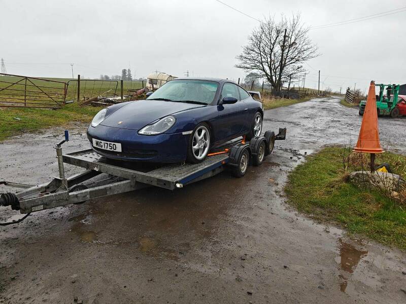

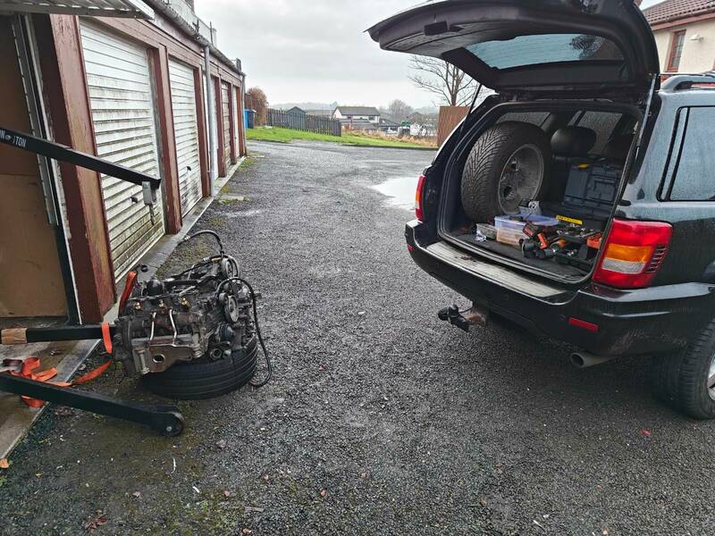

Heep gained an extra 6 cylinders today.
Fits perfectly! That's handy.

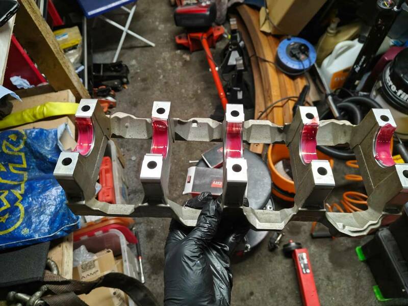

First off, I started assembling the 2.5 Duratec for the Manta. The block and crank have been checked and polished by an engine builder so I started by installing that along with new bearings.
Pakora sauce applied
And I'm happy to say it rotates beautifully, as you'd expect.
I'll get round to the pistons, the new rings are filed and ready so it's a case of fit them to the existing conrods and get them mounted.

911s engine has been built so it was time to ship the car down to them for installation and fettling.
I paid a man to do it, it was actually cheaper than it would have cost me by the time I'd rented a trailer, paid for fuel for the Jeep and Tebay pies

And talking about lowered, the Kangoo was worked hard.
No officer, I don't know why it's dragging its arse along the road🫣

911 wise I've not had an update for a couple of weeks. It did fail an MOT on brake pipes last week(which I knew were dodgy and had planned to fix over the winter before it shat itself) but I've not heard from the garage. I'll leave it with them🤷‍♂️
Congratulations, that looks like a fantastic play room, and with the lift as well……. Very jealous
