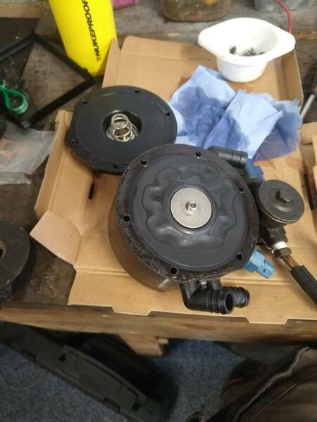

In a rare burst of motivation today I set out today to replace the gasket in the LPG reducer as it was leaking coolant.
Off and split, the leaking gasket still in place  in this pic.
The rebuild kit came with more parts but as it was working fine apart from the leak I stopped at the gasket.
Back together and refitted and initial reports look good. Time will tell if the leak is cured.

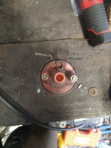

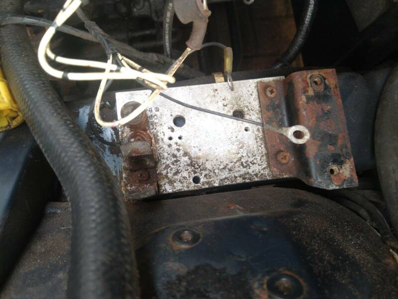

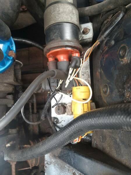

So, as we left this it would start and run from cold but misfire like a mofo when warm. A couple of journeys ended up with a walk home.
I duly fired the parts cannon and ordered up a new coil and ignition amp. I'm still waiting for the amp to arrive(it's on backorder) but one of Mr Lucas' finest coils arrive so I set out to fit this.
As found
Removed. It mounts on this alloy plate on the inner wing, I'm assuming the little capacitor type doofer is a radio suppressor.
I gave it a quick clean up
Old coil out, probably original
Connectors all cleaned up and reassembled with the new coil
First impressions were good. I did a few laps of my local test track, never more than a couple of miles from home in case I needed to walk home. All seemed OK, so far.

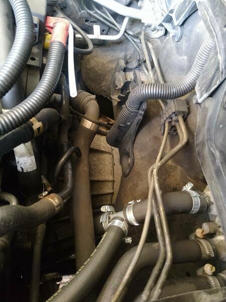

This has been in pretty regular use but had a couple of issues. First, and most annoying was a problem with the immobilizer not mobilising. I managed to get my hands on a new uch(body computer), key fob and ECU set.
This was easy enough to swap over, although the old ECU is an arse to remove from its cage. I elected to go for the easy option...
That's the new ECU zip tied to the case for the old one. I sealed up the connections on the old one, I'm not an animal...
This brought with it a slight problem-the traction control light is now on as the new ECU was from a car so equipped. It's the orange triangle. The rest were there already 😳
I'm ashamed to admit some black tape was used to cover this up for it's MOT. It'll do until I can get a shot of CLIP to get the warning light situation under control.
The MOT passed left the other issue-an intermittent speedo. The speed sensor is cheap to buy and easy to change, when this engine is installed in a Kangoo at least.
Here it is, down the back of the engine.

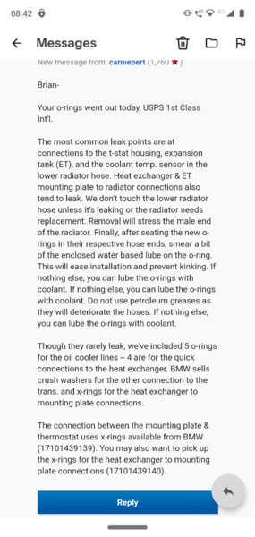

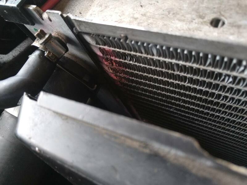

Finally I started swapping out orings on the cooling system to try and get to the bottom of the slight coolant loss. I did the two on the expansion bottle and noticed this telltale on the radiator where it had been weeping
I'm not convinced it's coming from the oring on that hose but I changed it anyway. I've not done enough miles to see if it's fixed but I don't think it is yet.

My BMW is going into an indy BMW place on Tuesday as it's giving it full Exxon Valdez
