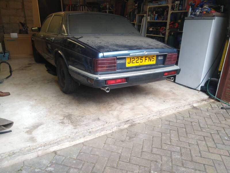

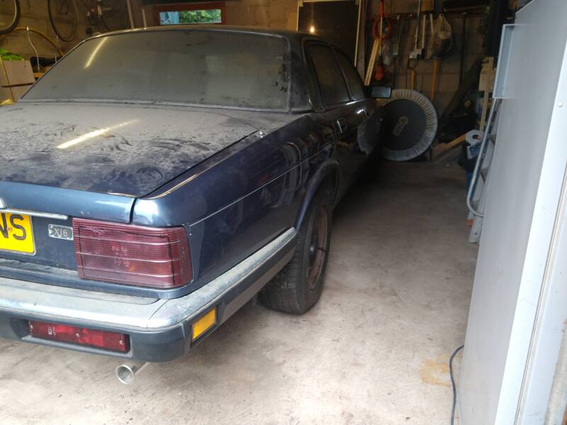

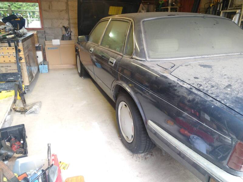

So, yesterday I set off at the crack of 10am to try and bring the XJ40 back to life.
The previous owner was there and helping/chatting as i worked so i got a bit more of the history of the car
It had been owned by him since 1996 and originally came off the road around 2001 with a leak around from what I think is the transmission cooler. A replacement cooler comes with the car but was never fitted.
He'd bought the burgundy car a few years later and the XJ40 had been left in the garage and forgotten about.
Ambitions were high but expectations were low. I'd love to get it fired up and drive it the half mile to my house (insured, obviously) but on the other hand I had no idea of the condition it was in underneath

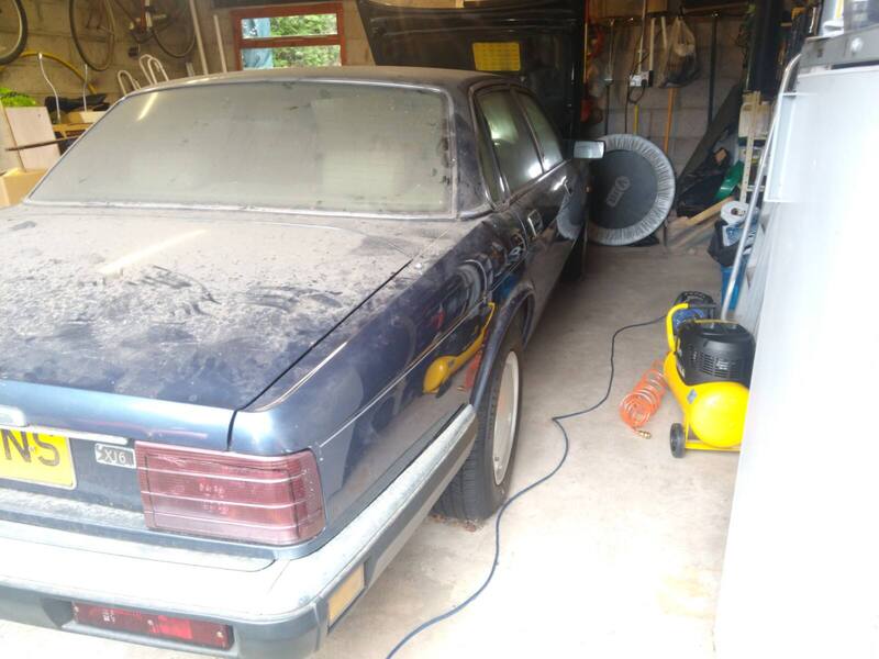

First things first, lets get some air in the tyres.
Yes, it'd been a while...
IMG_20200831_102428010.thumb.jpg.62c59ffad75035948453561167fdbf45.jpgIMG_20200831_102434578.thumb.jpg.2e46690151223e9d22fbb60958adc7c9.jpgIMG_20200831_174755130.thumb.jpg.37d701ec8bf7ecc6ee51009b566eae57.jpgIMG_20200831_174801144.thumb.jpg.d1cf85a24c74ff6517b2dd227782dcf4.jpg
That's looking a bit better.

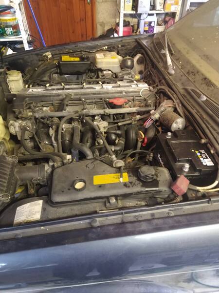

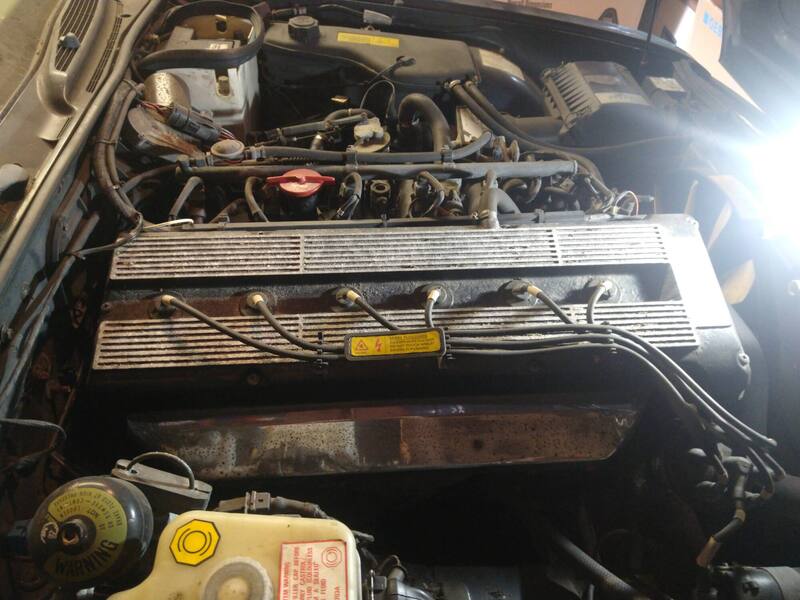

Next, plugs out and some GT85 in the bores. I wanted to turn it over on the crank pulley but it's something silly like a 33mm nut which I don't have so i left the oil to soak while I carried on with other things.
New plugs were fitted and the distributor cap and rotor arm were cleaned up.

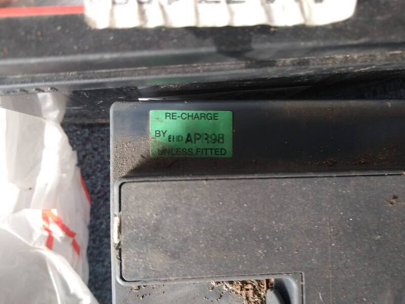

With brakes free it was time to put a battery onto it. i'd bought a new one so put it on and connected it up to be greeted with a wailing alarm siren. I'd bought a new battery for the fob but couldn't suss out how to get the alarm to stop beeping. When i got home i found a supplement in the manual for this alarm so I'll see if i can get it to shut up.

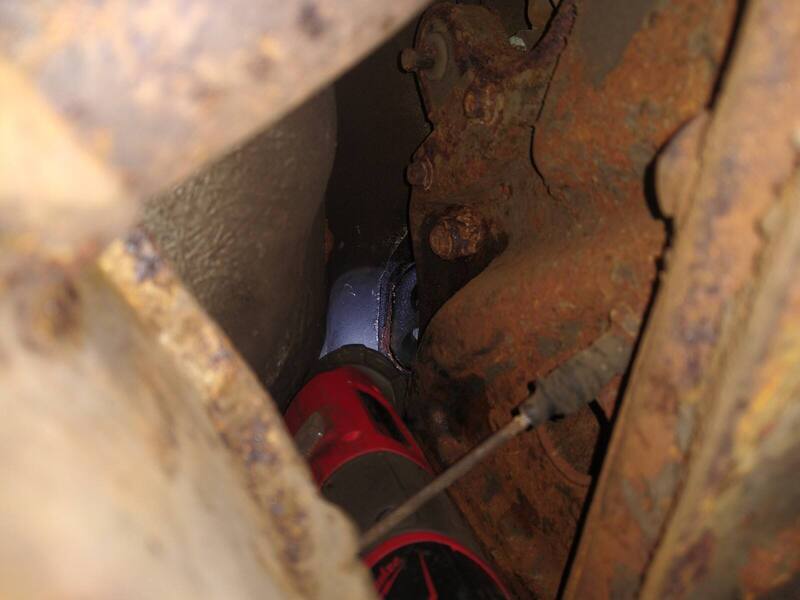

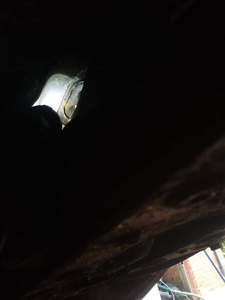

Yeah, about those.
These are located above the diff. There are little R Clips that hold them in, then it's a case of pulling out the pipes and removing the tank.
The Haynes manual helpfully says "remove the driveline"
Yeah, drop the entire rear subframe and you give it a mere 3 words?!? Fucking hell. I hate Haynes manuals.
At this point some pics would help wouldn't they?
IMG_20200831_173012091.thumb.jpg.2fcc6eb26b889ddc3a4f530cfcb0e27c.jpgUnions.thumb.jpg.4e0236f6fb7de7704c18d1dae106f79e.jpg
Yep, that's as good as you're getting. They're fucking buried.
I managed to get the R clips out and of course one pinged off never to be seen again.
The unions, however, would not come out. Solid. More solid than that. Access was terrible so no way to get grips or anything onto them. Far too long was spent swearing at them with no joy.
Fuck.

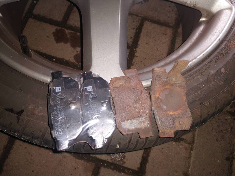

Oh and in more mundane car news the Accords rear wheel was hot to the touch on getting home last night-sticky caliper there then!

And good old euro car parts came up trumps* with the pads for the Accord ?
Sliders were fine so I lubed up the piston and stuck it back together for the meantime til I can get the correct pads.
Baws, turns out it was my fault. I ordered the pads while still in bed half asleep and didn't realize I'd picked the Jazzs reg number on the euro autofill instead of the Accord. Bollocks!

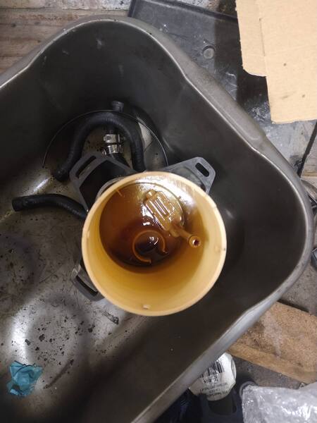

Retaining ring off and hoses removed allowed me to get the top part of the pump off. The bottom part stayed put and seemed quite attached.
At this point I looked at the Haynes manual (I know, i know.)
I'll skip ahead to the removed pump for descriptive purposesIMG_20200903_202023828.thumb.jpg.2a1441a8cfab6d5a76818c9e5069b25e.jpg
The rubber cross shaped part is supposed to stay attached to the tabs on the bottom of the tank and the pump unit is supposed to twist free. Except, of course it didn't. I had to remove the whole thing as one which involved turning it upside down in the tank and squeezing it out through a hole it was never designed to fit out. Joyous.
Once I had it out I realized the problem-a zip tie holding the rubber part firmly onto the pump. Thanks Jaguar!
You can imagine how much fun this all was, especially as there's still a gallon or so of 20 year old petrol in the tank!
Next up, open up the plastic casing of the pump units somehow without breaking 20 year old plastic tabs? Then I can fit the new pump and rubber hose.
The tank was remarkably clean inside, I'll drain it out and have a new fuel filter here for it. Running at the weekend? Stay tuned!
Cheeky wee lunchbreak update.

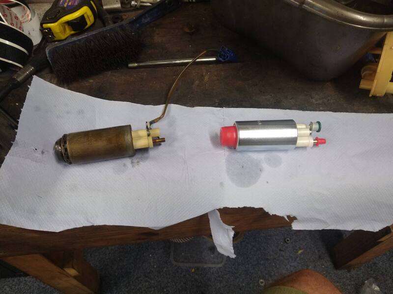

Managed to prise the top off the fuel pump housing without breaking anything to reveal the dead pump.IMG_20200904_124146212.thumb.jpg.1a5254f86cafb8496c771697b5ea93e8.jpg
Old Vs new pump
Nastiness inside the housing. I've got it soaking in petrol here, the black stuff is nasty and tough to remove
Will leave that to soak for a while and will then clean it up before it goes back together.

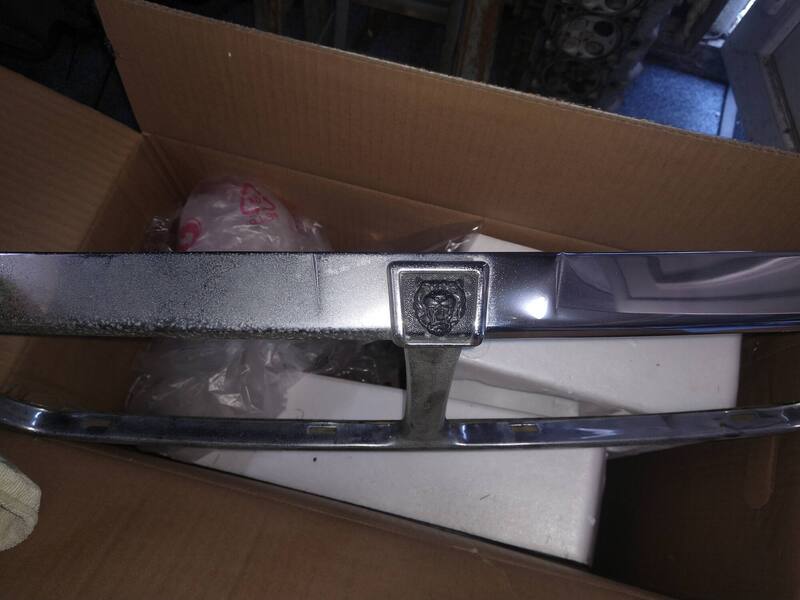

Also started on polishing up the grill which had been removed, will get that finished off soon.

does Carb cleaner to remove the black gunk? Looks that type of stuff that is stuck in carbs.
I don't have such a thing, I'm too modern for that ;)  I tried brake cleaner which didn't seem to do much though.
It does scrape off-it's more like goo for want of a better term. Will leave it soaking in petrol for a while and see how it goes.
