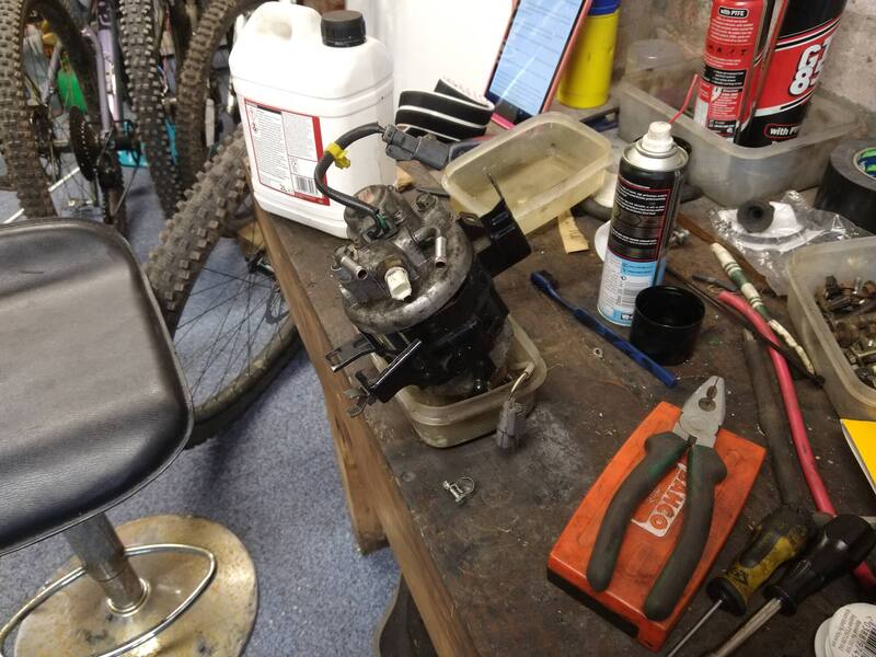

Got stuck in to the throttle body on the Jag today. Stripped down to get to the bottom of the stickiness
Once cleaned up it was back on and making a big difference to drive. I gave it a quick wash and took it a spin.

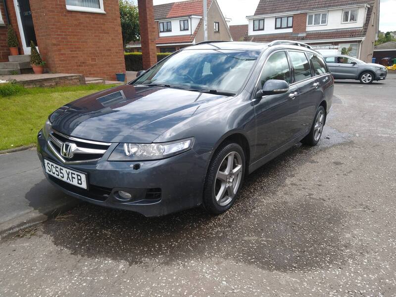

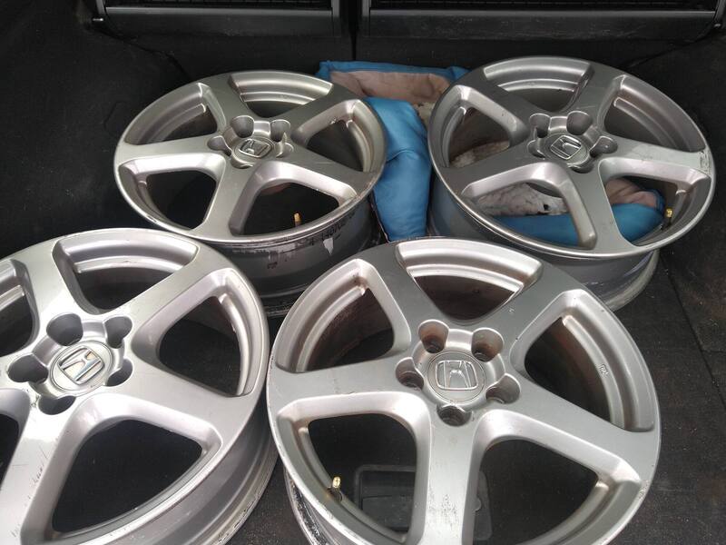

The Accord has got some love too. Last Sunday I picked up some wheels for it. The existing ones are too far gone.IMG_20200712_175932796.thumb.jpg.288827090a2dd7901cd7dd72c6090a72.jpg
And the other day I paid a visit to the local scrappy to get a back bumper in the correct colour.IMG_20200715_181113816.thumb.jpg.15931e0600aee2c0b926325d70c8877d.jpg
I got 4 tyres fitted to the new alloys yesterday to replace the mismatched budgets that were on the old wheels

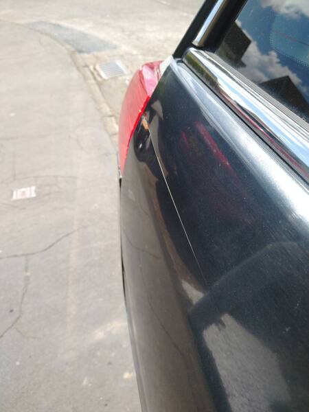

This morning I swapped bumpers over and had a go at the worst dent.
Before
After
Not a great pic but it's better. I struggled to get the last bit pushed out, might have another crack at it later though.
Quick wash for this too and it's looking a lot less offensive

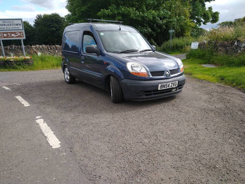

Kangoo was finally put back together last week.
Annoyingly the steering wheel doesn't sit straight now with the new column, it's about 45 degrees out.
Annoying as there's only one way it can go on the rack and one way the wheel can go on the column. This means the column has been split at some point and put back on wrong. I'll need to adjust the tracking to fix.
Took it a blast and it was going wellIMG_20200719_165902308.thumb.jpg.0cfa5bffa8c8fc99586541a64afaca59.jpg
Yeah, about 5 minutes after this it died....
I coasted to a halt and started prodding. There was no noise from the fuel pump so I called my mate to ask where the fuse/relay was. On spotting a blown 30a fuse under the bonnet he said "yeah, check your lambda wires, if they melt they'll blow that fuse." IMG_20200719_173206085.thumb.jpg.e5fb69605cafd6ce8639e3ab61a56adc.jpg
Oops.
The wire must've came loose from all the moving up and down of the engine required when doing the timing belt. GLFery resulted in them melting to the exhaust, popping the fuse and killing the pump.  I chopped off the melted wires, stuck a new fuse in and we were away again?
It turns out the melted wiring was for the post cat lambda which has been chopped on this thing-it doesn't seem to bring the EML on amazingly so it was just a case of chopping it and all was good.
I rewarded it by fitting a fuel sender from a petrol Kangoo I liberated from the scrappy.

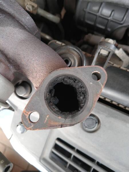

Other than that I pulled the EGR valve off to clean it. It wasn't too bad at all, unsurprising with the low mileage.

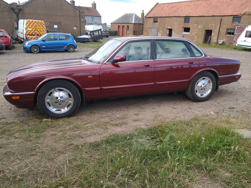

Jag
After mentioning on another thread that this would be up for sale in the near future a shiter local to me contacted me to see what it needed. A price was agreed on and a deal was done pending me sorting out a couple of issues
First up, brakes. The front brakes had developed a pull to the right. I stripped them down and checked the pistons. The passenger front had a sticky piston so I (carefully) pressed it out far enough to be able to clean it up-here was a bit of corrosion on it so emery paper was deployed. I pressed it bad in and tested it-it was now moving freely and pulled up straight so that's a win.
The handbrake shoes were catching slightly on the NSR so I pulled off the wheel to adjust it. It's still doing it a bit but doesn't sound as bad. At the same time I got my grease gun out and greased up the UJ on the driveshafts on both sides.

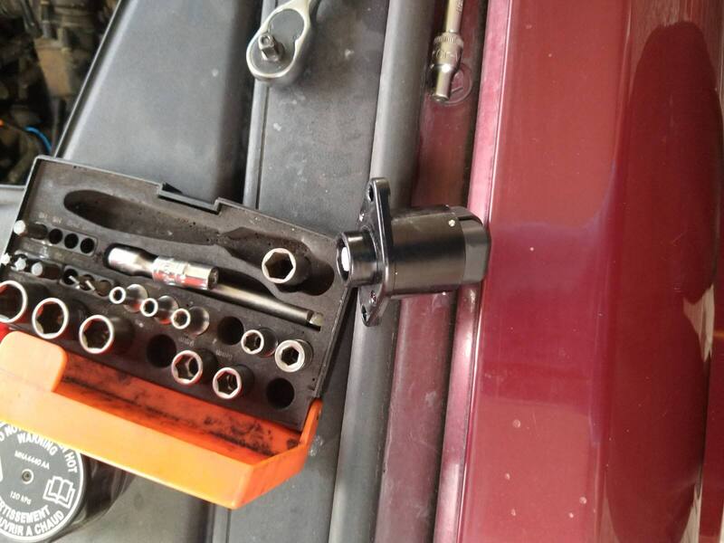

The main thing I wanted to do though was fit the new ISCV that I'd bought for it. I was't sure what was causing the occasional no idle from cold but an ISCV was cheap. Apparently a Renault part was a perfect fit for a fraction of the price. Yeah, about that...
Air box pipework off-the throttle body needs to come off to get the ISCV valve out
I fitted it and fired it up. The revs flared slightly but it settled down to an idle-all good I thought. I then went for a drive and stopped for fuel. On restarting it ran like shit-revs fluctuating between 1500-2500rpm at idle :(
I  nursed it home and stripped it down. On removing the airbox pipe I heard something rattling around inside it, Hmm.
Here's how the ISCV came out...
And here it is beside the old one...
The rest of it were what was rattling around inside the trunking...
Turns out that the Renault ISCV isn't quite the perfect fit. When you switch the ignition on the little plunger extends out into the throttle body and back in a sort of self test thing.
 Except, the diameter of the cone on the end of the plunger of the new one is too small, so when I started it back up after refuelling it extended all the way out and fell apart inside the throttle body. Needless to say a bullet has been dodged with that one as if the parts had went into the engine that would not have been pretty...
I used the old plunger on the new ISCV and fitted it, thankfully it fired up and ran. Whew.
So, on Saturday night I picked up @SRi05 from the train station and took him to meet his new chariot.
Farewell big Jag! Enjoy the next stage of your resurrection after 3 years sitting on a drive unloved :)
It is a lovely thing and I'd be sadder but this should clear the driveway to allow me to get the XJ40 home. I'm going to see the guy this week to see about arranging a day to give it a going over and see what it needs to get it rolling/running. Ideally I'd drive it the mile home but a tow/recovery might be a better option. I might need a few shiters to help push it up my sloping driveway though. Hint, hint...
Jag parked up after a leisurely waft this morning. Cheers for being so helpful in collecting this and for the fettling.
Sent a few messages to a friend RE the paintwork yesterday, bonnet is 100% being resprayed, I’m pondering whether to just get him to do the boot lid and roof as well while it’s in. Guy round the corner is a mobile tyre fitter so he’ll be coming with some new rubber on Friday.
After that it’ll be used for daily waftage for my minor commute. I missed my old X300, such a relaxing and comfy place to be.
A bit of paint should finish that off nicely. They really are a great looking car. I need to sample one at some point while there are still a few left. I hope you enjoy driving yours....
