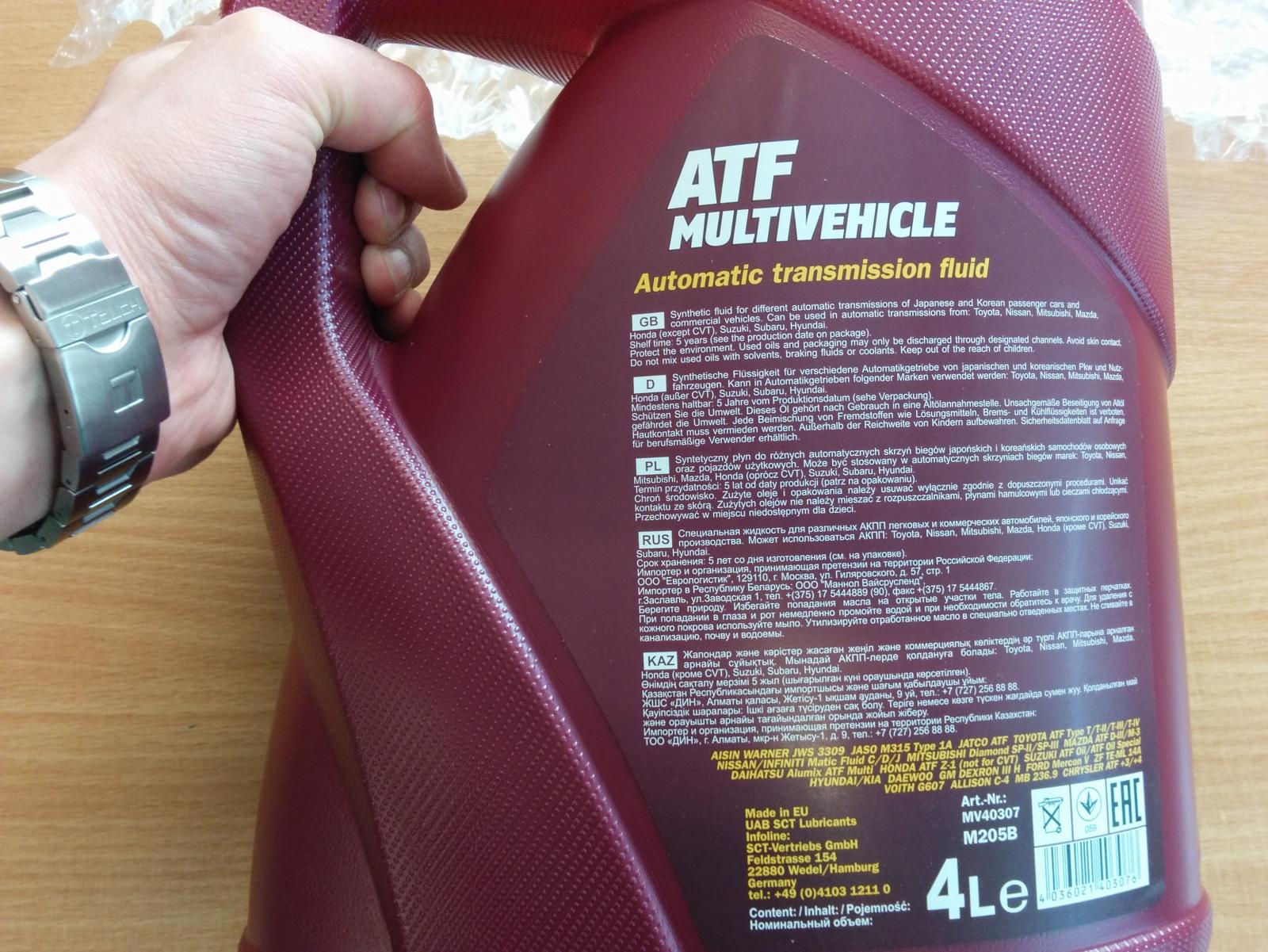

The good news is that this isn't actually as special as it once was (because more modern cars around). Also the fluid meeting that spec can also meet many other specs too, so you get universal type fluids. Which is exactly what the Mannol is. Here is the label on the back of my bottles of the stuff:
