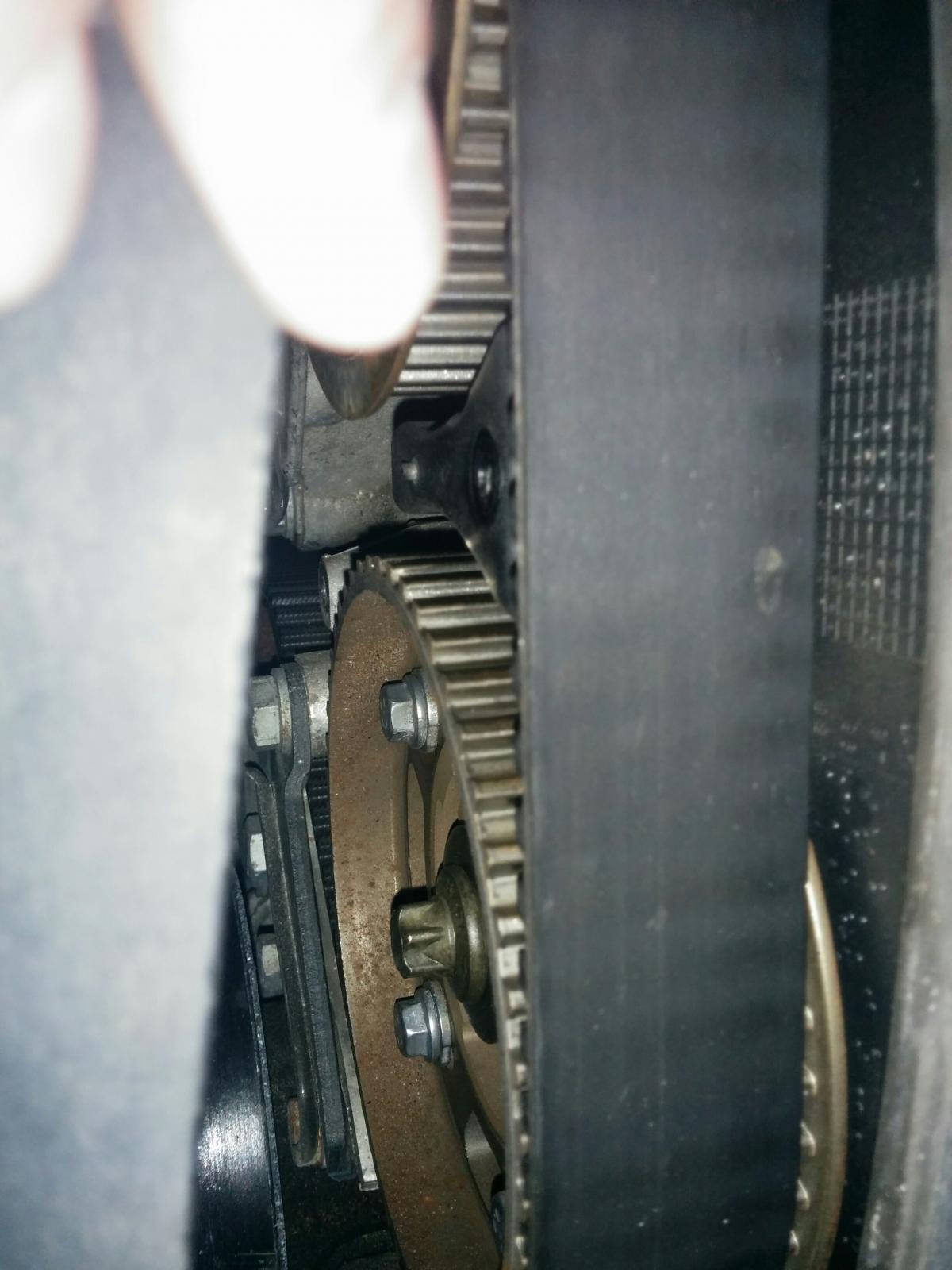

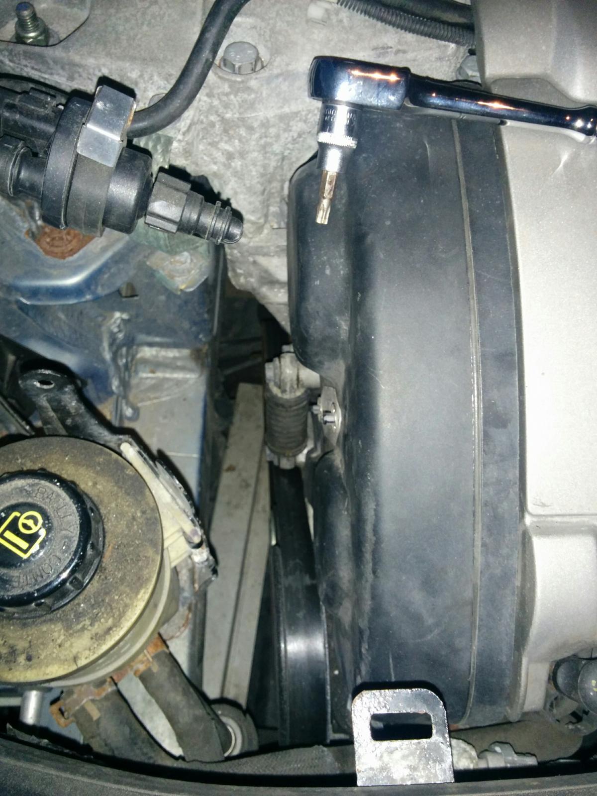

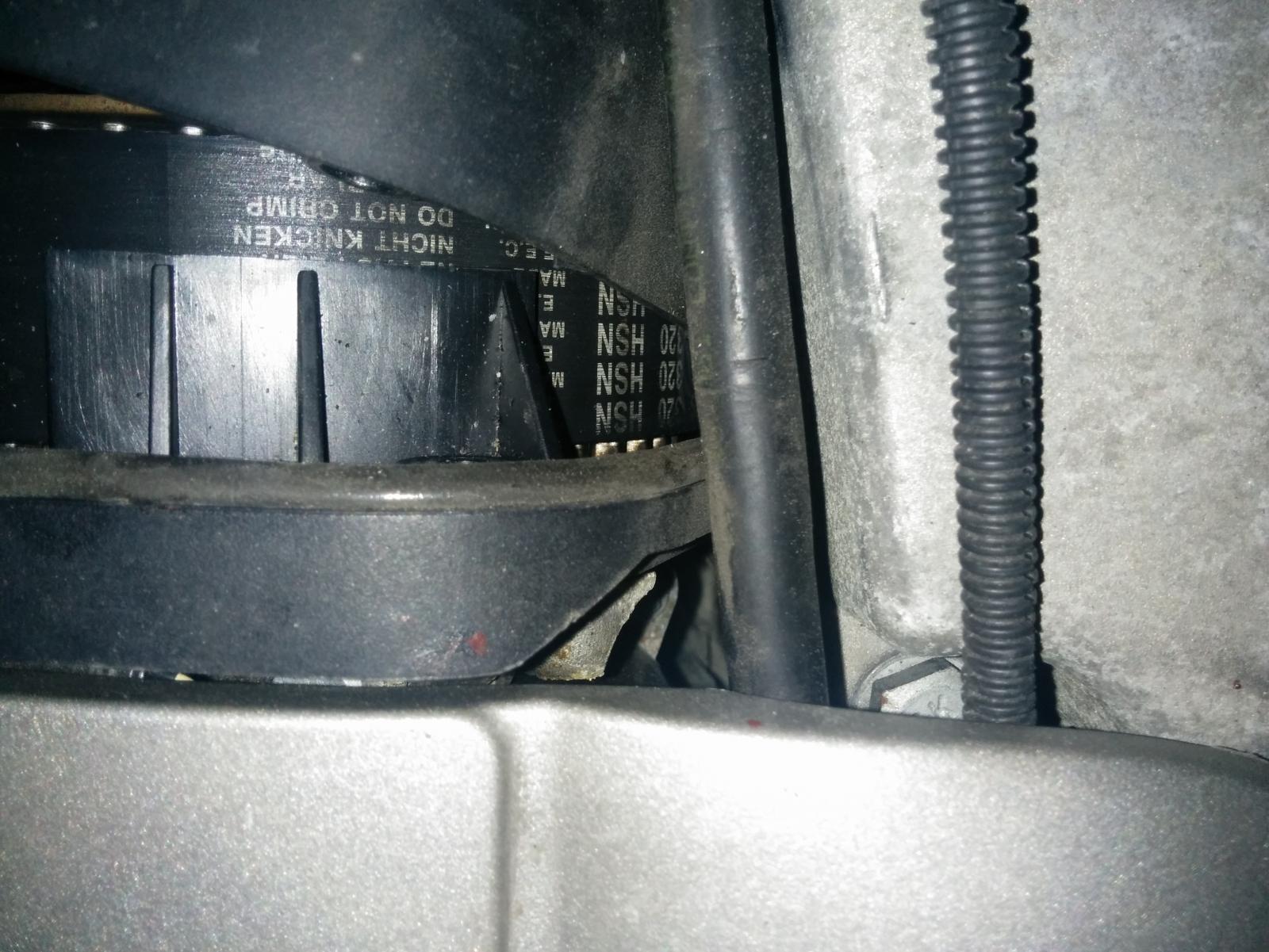

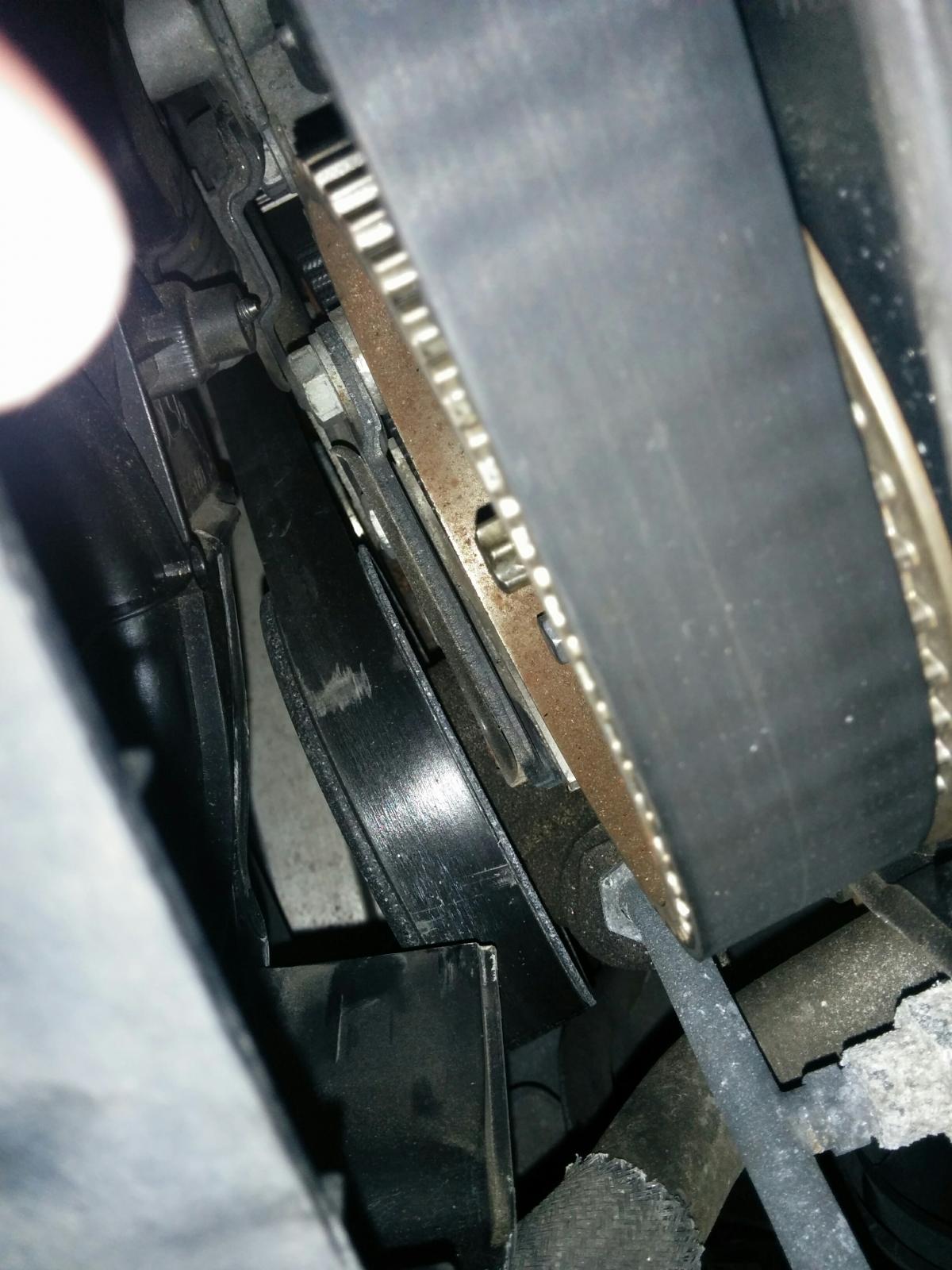

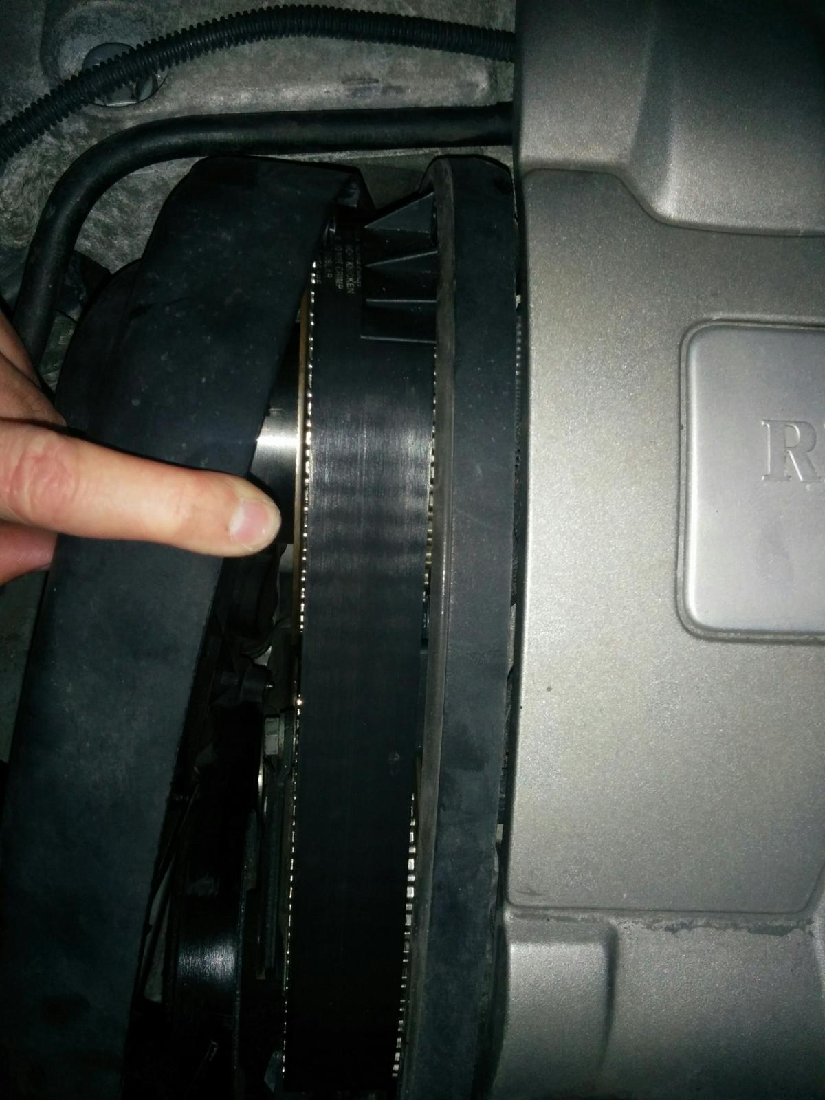

I couldn't get the cover completely off without removing the top engine mount. But managed to bend it back and got these pictures. Was getting dark at this point, so phone camera flash was on.
The mark on the belt below is the aux belt where I caught it with the cam cover. Only light scuff.
Doesn't look too bad shape to me? Are cambelts date coded?
The aux belt doesn't look too bad either
Not as tight between the engine and car body as I thought. Sealey ratchet at the top for size reference.
Yeah, I'd be happy with that given the value of the car vs the cost of changing it. Get driving it until something else breaks!

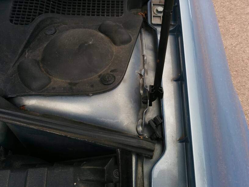

Fixed the bonnet stay - important thing to have working well on a Laguna 2.

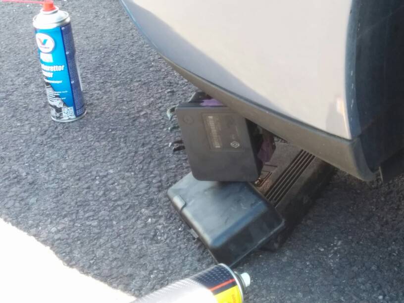

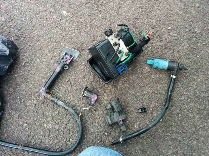

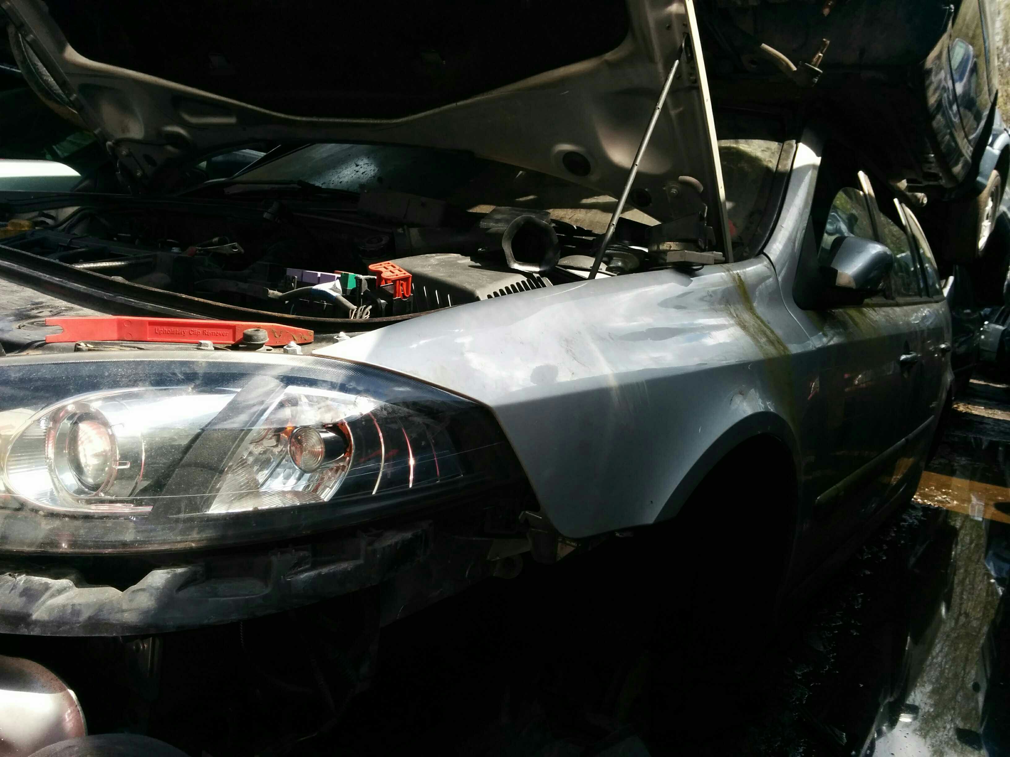

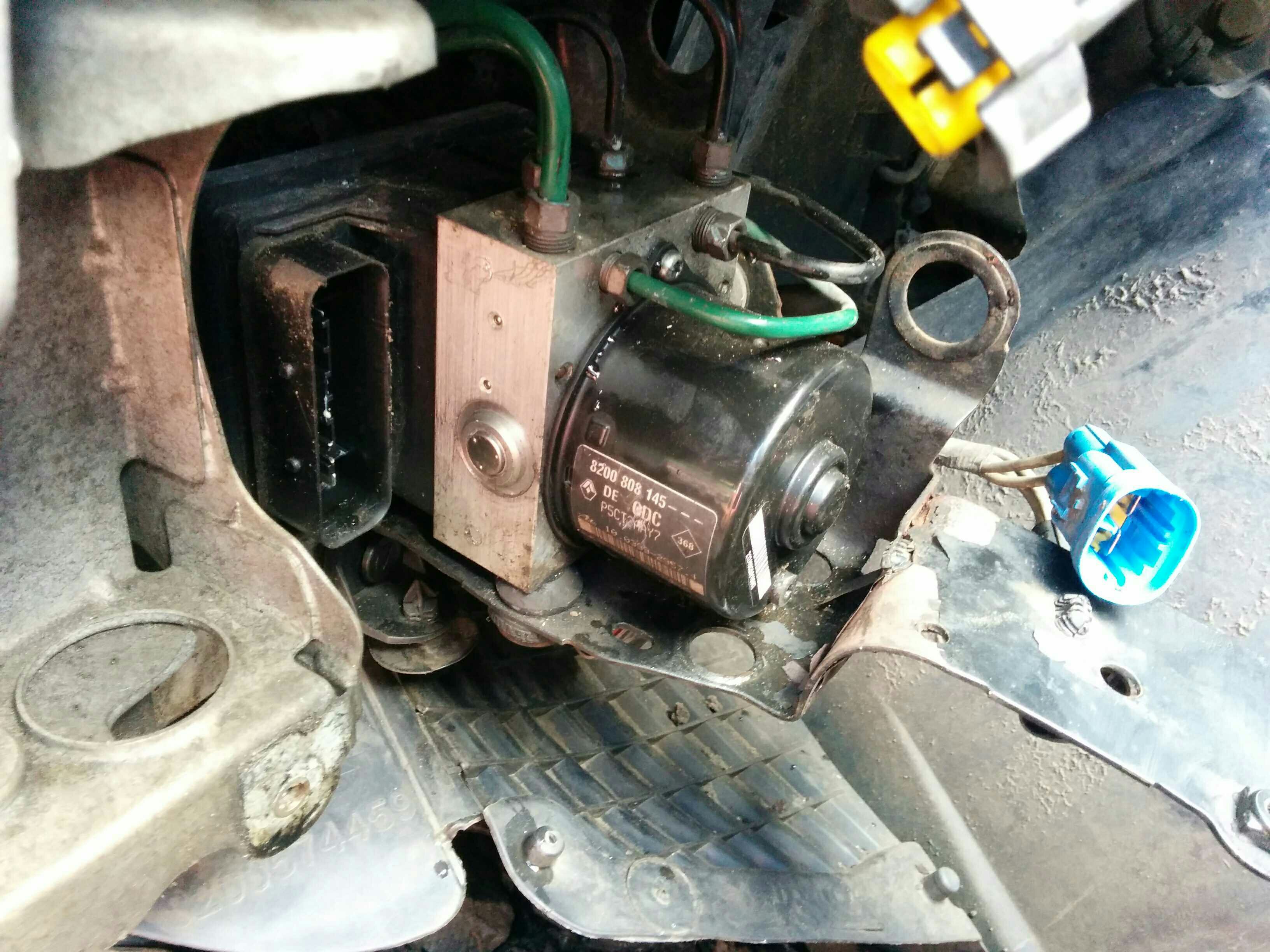

Plugged in new ABS pump and did a code scan. Only code was low battery voltage. Checked live sensors, brake pressure sensor is reading zero (faulty reads max). So hopefully a good pump!
Debating whether to swap it whole or use the valve body on mine (that contains the brake pressure sensor). Might not fit swapping the valve body or incompatibilities. If swap whole, then as from a 2.0dci, it may have different ESP setup and programming.

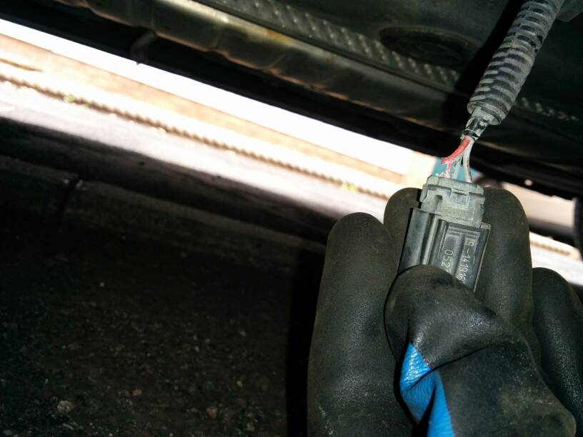

Went to fit replacement tyre pressure monitoring receiver. Disconnected the antenna and discovered this.
Bugger! I didn't cut off the connector at the one in the scrappy either. Looks like I'll need a trip back. :|

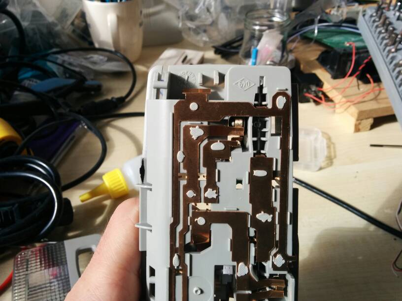

Fixed the interior map reading lights not working unless pressing hard on the switch. Contacts were really dirty, so a scrub of sandpaper on them brought them back and made the bulbs brighter.
This is a lesson in using the least possible materials in making this work. The contact design looked proper shonky! This part is made in Switzerland...

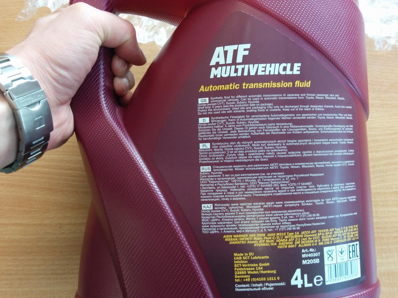

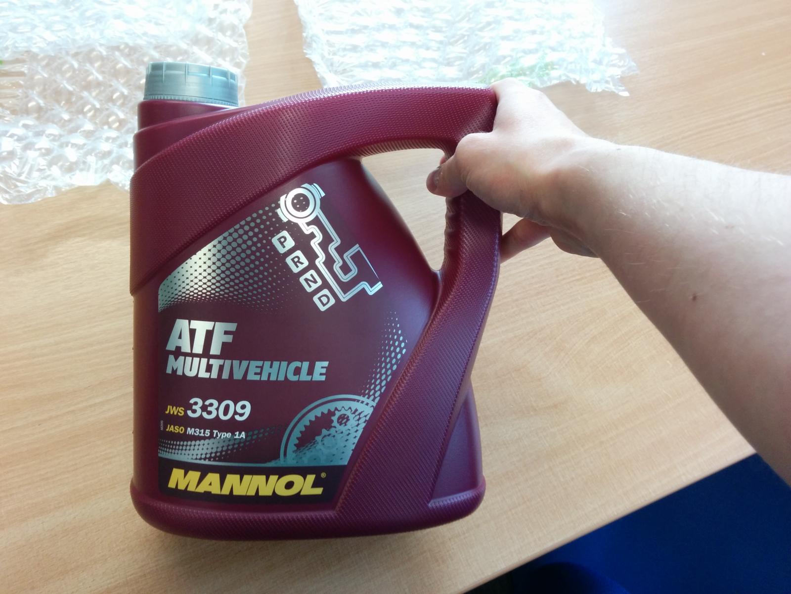

This arrived today. Not bad for £50 posted from Germany.
Especially as just one of these in Mobil is £50.

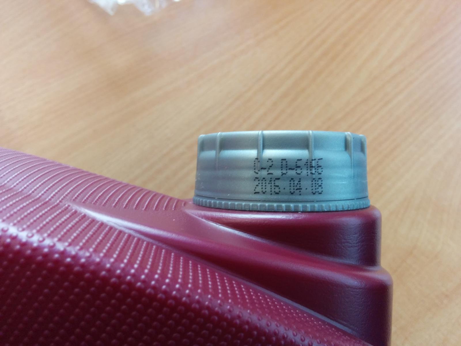

It says it should do the trick (Aisin Warner JWS 3309 spec). Of course its only a bargain if it doesn't bugger my 'box up. 5 years shelf life - 10.5 years the stuff has been inside my box. So probably due flushing just on oil age.
Very fresh stuff too!
I'm looking forward to you being the guinea pig for that ATF, if It doesn't break a Renault autobox then I'm hopeful that it should work in a Honda.

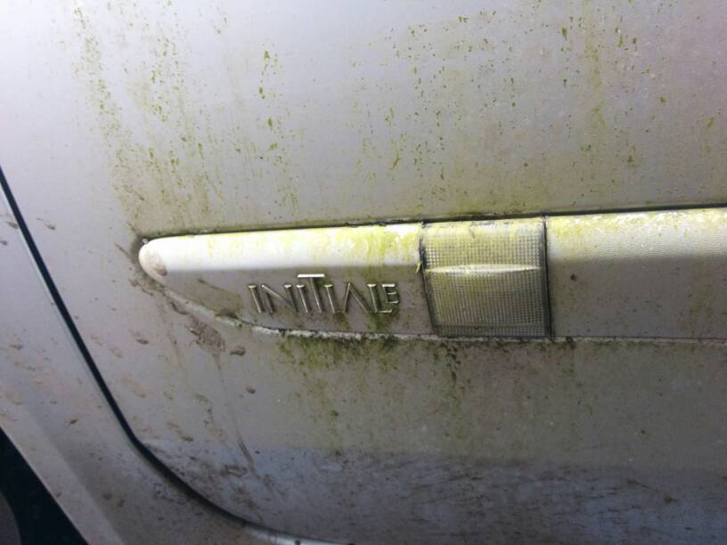

I did realise yesterday that it literally has zero indication of what engine is in it. No door badges that say 3.0 v6 (ph1 said it on the passenger door) - just says Initiale, no externally visible exhaust differences, no extra trim, nothing. Could quite easily be a 2.0 petrol, 2.0t petrol, 2.2dci, 2.0dci or the v6! No wonder I get people looking when kicking down and release the growl. A proper sleeper.
