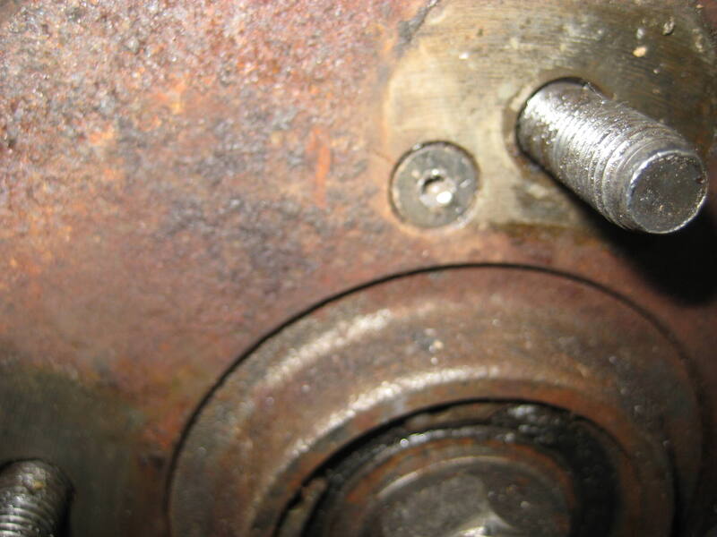

strangeangel Posted November 24, 2019 Author Posted November 24, 2019 Unusually, it's not raining, so let's see what's up with this brake. First job is to find somewhere safe to jack it up - defo not under the battery tray then... This all fell off when I podged it. It looks to have been repaired* by having a sheet of fibreglass mat stuck over the rust, which was just about the worst thing they could have done as it's trapped the water in and rotted it even faster than if they'd done nothing. I was a bit worried about this, until I looked more closely and saw that the car is built onto some sort of alloy frame which appears to be in perfect condition. That shelf is going to need work then, but at least there shouldn't be any vehicle structure issues. Anyway, let's have that drum off: Fat chance. Out with the big drill, then. Everything looks nice and clean, pistons go in and out easily etc. but there's got to be something wrong. Stripping it all down revealed this: This handbrake operating mechanism is seized solid. There was no way you could tell while everything was still in one piece! It did seem to operate OK when I tried it on the jack earlier, but I wonder if this is causing the the handbrake to stick intermittently? I'll free it off and give it a thorough clean and see what difference that makes. somewhatfoolish, Mrs6C, theshadow and 7 others 10

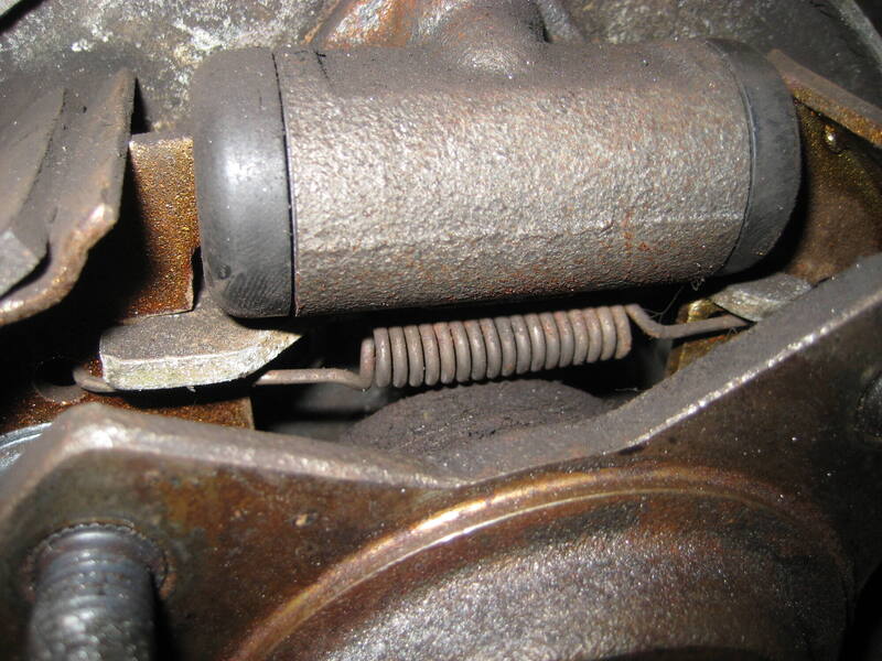

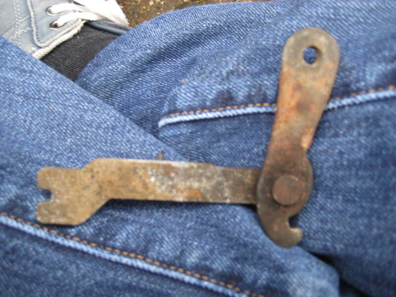

strangeangel Posted December 2, 2019 Author Posted December 2, 2019 It's actually been warm enough to set foot outside today, so I re-assembled the N/S rear brake (and the now freed handbrake mechanism) which leaked out so much smoke last week. Every drum brake I've worked on up to now has had either a manual or automatic wear adjuster - these have nothing. Is this unusual? Anyway, I had a quick run round in it afterwards to see if there was much difference and I have to say there wasn't. It still gets up to about 30 easily enough on the flat, but show it a hill and it doesn't want to know - we're talking 15mph here. So although it's legal and running and everything it's not going into use until I can make some modifications. I think it's time to go and do some reading... Saabnut 1
