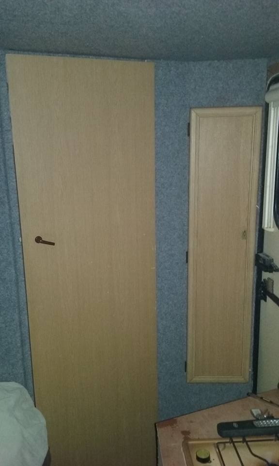

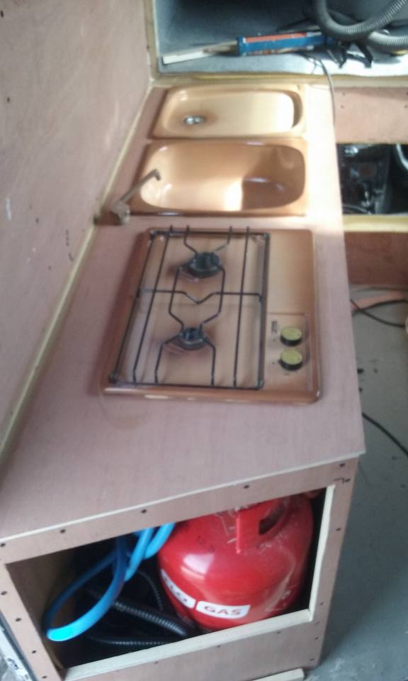

I need to take some better and more recent pics but here are a few during the build

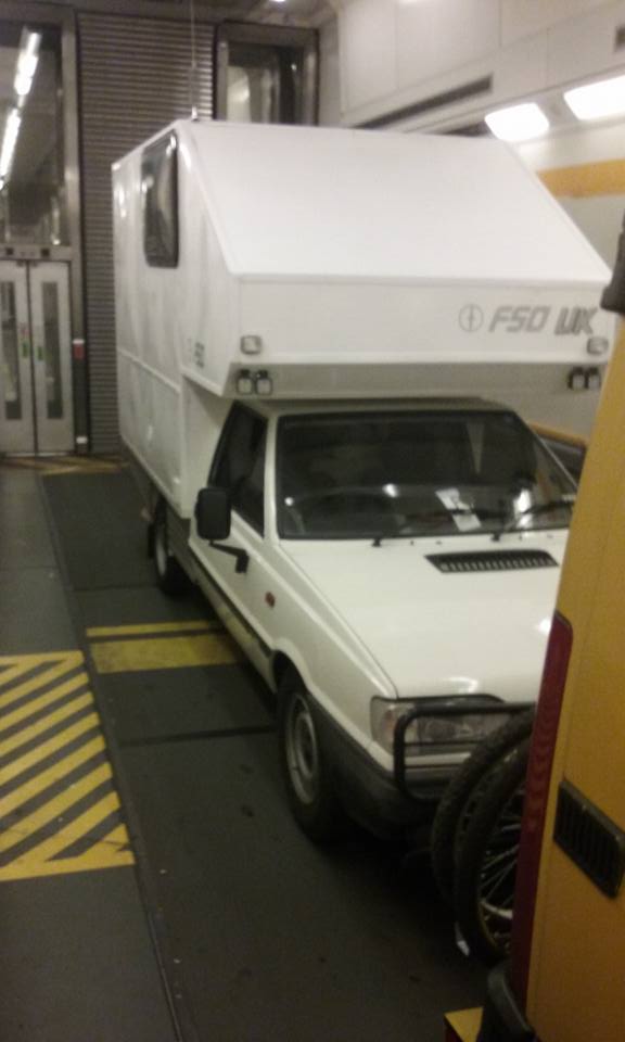

FSO originally got a company to build 6 prototype campers and only one still exists in Poland. There are other conversions but very rare. I built this entirely myself. I would stick my neck out and say this is probably the only RHD FSO caro camper in the world. :-)
That's like a Starcraft for the nineties, with Landrover mirrors!!
Well spotted on the mirrors ;-) I fitted these so I'd have a good view behind the body especially as I will be spending a lot of time driving abroad on the wrong side of the road.
