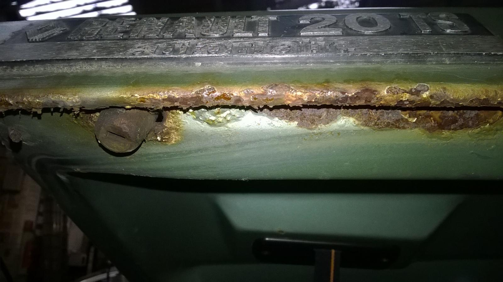

So I will leave the horrible mess in the engine bay to my mechanic. Now lets talk about something (only slightly) more cheerful: tailgate rust - this is not that serious and certainly not curtains for the tail gate - but advice on treatments and repairs would be appreciated folks!

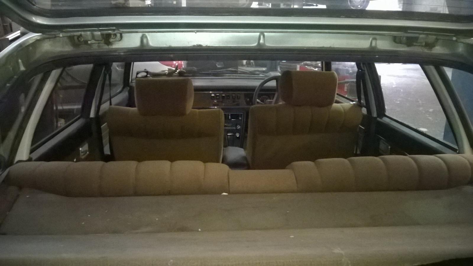

a couple more views of the ill 20:

Bilt Hamber stuff all the way. Fantastic products for de-rusting.
Cor that interior looks like a comfy place to be.
Bilt Hamber is the go-to for most these days, I'm still yet to use it.  Jenolite is quite good at keeping minor rust away for a long time as is Kurust, the latter needs a lot more prep to be effective.  Lashings of paint afterwards in any colour you have to hand will keep it solid as will pumping the tailgate full of cavity wax or whatever providing the rust hasn't got too serious a hold.
