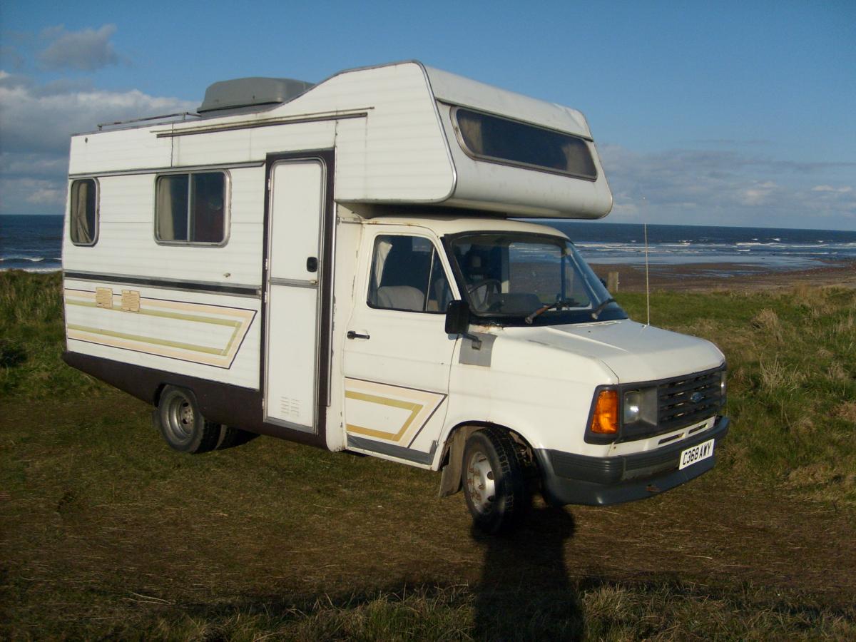

Here's mine, you've all seen pics of it before though.
They are great vans, but they rot! Check cab steps thoroughly. Check all the obvious places like sills etc etc. the windscreen surround can rot too, check for bubbling and rusty stains on the paint around the seal, sometimes the rust can be seen inside the van on the metal dashboard where it meets the screen seal. You can also easily look up under the dash/glovebox at the base of the screen surround area and see if there's any grot there.
The one in your pic has been painted in this area by the looks of it as the mk2's often had a satin black painted section around the windscreen, so check it!
The front cross member under the radiator had surface rust on mine so check that too.
Mechanically these things are very basic and simple. Steering box will have a bit of play but shouldn't be excessive and check it for leaks.
If it's a diesel I'd expect it's the 2.5DI, which is a superb piece of kit. Again, it's a basic engine (doesn't even have glow plugs) but they go on and on, although they do sound like a proper old truck engine! I really love these engines and if you find it a bit slow then just add on the turbo set up from a later 'smiley' transit, they made them upto 2001ish so they are easy enough to find. A five speed conversion (using a 'smiley' transit as donor) is worth doing too if your going to be changing the box anyway.
