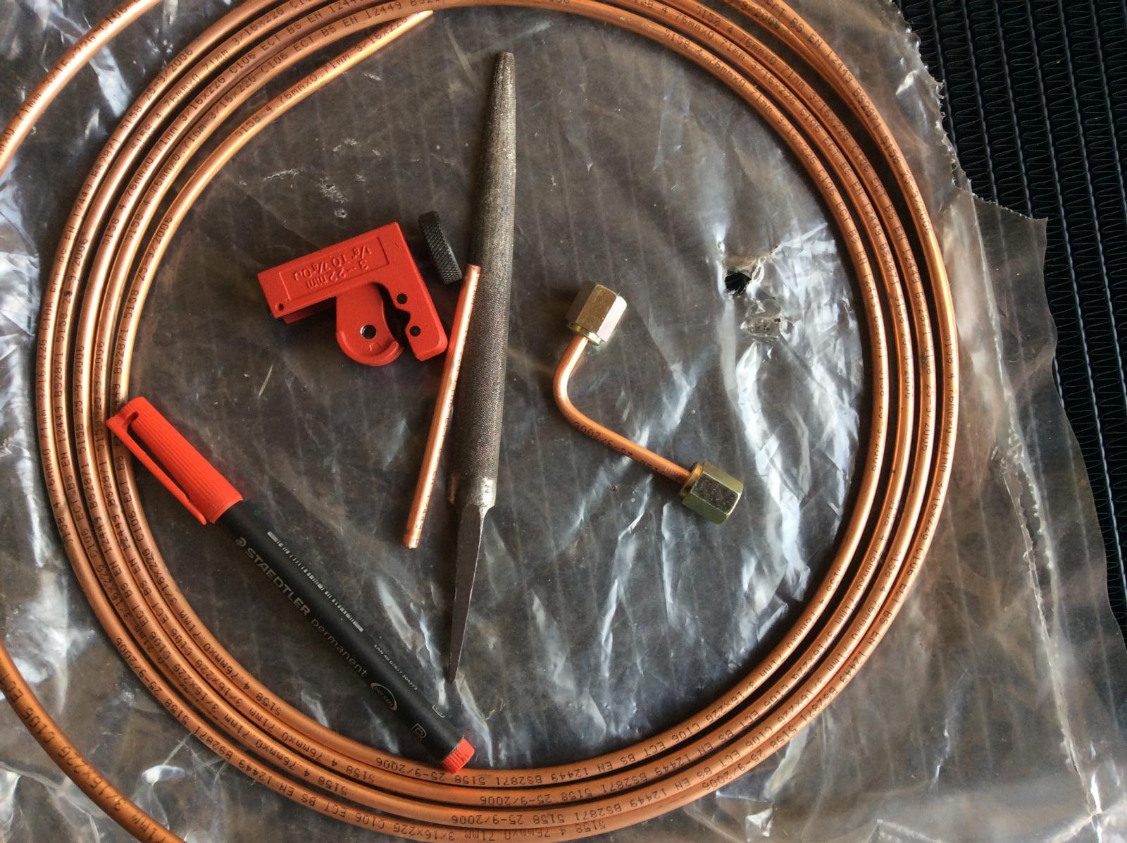

Got the brake pipes almost finished this afternoon.
First I needed to clip the long front - rear pipe into place along the rearmost end of the chassis. With that secure, I could attach the new joining piece. I’ve put this right on the very end of the too short front - rear pipe. Reason being, is: A, it’s easier! And B, there’s two of the factory tangs attached to the side of the chassis right next to it, so it’ll be as secure as it possibly can be.
Then I just offered up a short length of brake pipe, cut and bent it to length/shape, slid on the two new unions and flared a female flare onto both ends. It fits perfectly so I’ve tightened it up and tidied everything up so it looks the part.

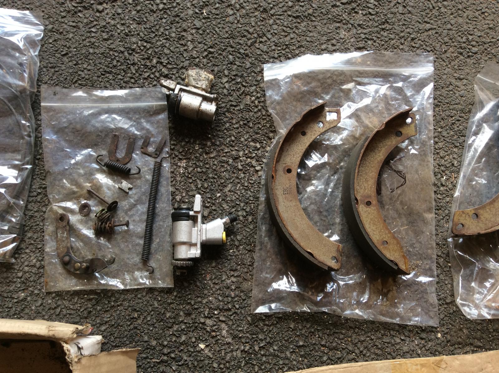

The next step was dig out the new rear wheel cylinders, check the unions on all the pipes do actually fit them! Which they do.
The wheel cylinders on this car are actually not the usual mk2 parts. Because this car is such an early one it’s still using many mk1 bits, the axle/brakes being one of them so everything here is mk1 stuff. These cylinders are the old single acting type, whereas a normal mk2 or 3 should use the more recognisable double acting type.
The curled up pipe in this pic is the final one that connects both the rear wheel cylinders together and runs across the rear axle.
To get this on I bent it straight, measured the length and marked its centre. The centre point can go on directly behind the securing tab on the rear axle, right above the diff. It was a bit tight to bend it to shape and feed it around the anti roll bar but it’s finally on and in place. It will only go on in one shape and position. Once in place I’ve tapped the securing tabs down onto the pipe to secure it permanently.
I didn’t have the original pipe for this one though so I had to just do it from pics on the web and my best guess/memory.
Here all the pipes are on and in place, I’ve just curled the ends of the axle pipe up out the way for now so they don’t rub on the wheels.

I’m not going get the rear brakes fitted today, I’ve dug the bits out of the boxes of parts and some of it isn’t as good as I thought it was, and I can’t fit bits that aren’t up to standard.
Both the handbrake adjuster arms are broken, so there won’t be any self adjustment. That’s not the end of the world as I’d been running around with them like this for a while before thecar was stripped but I’m not doing half arsed stuff like that this time. Also, all the shoe hold down pins and springs are rusty and past their best, and one of the sprung clips that hold the wheel cylinders in place has also broken.
I’ve ordered the new bits, all off eBay! The pair of adjuster arms I need are custom made and cost £46 for the pair though! I don’t have much choice though.
Instead I’ll get a few other bits and pieces done instead. The diff and gearbox need filling with oil too.
Here’s a few pics of today’s limited progress.
Here’s a selection of the rear brake bits. The springs are all fine, so will be cleaned up and reused. I’ve got two new rear cylinders, but the little adjusters that fit into them need a good scrub. The shoes are fine, plenty of meat left on them and they’re not actually that old either.
The handbrake adjuster arms have both snapped off, not much you can do here other than try to buy new ones. All of the sprung cylinder clips are quite rusted and pitted, one has also broken. The hold down pins and springs are all pretty poor too.
New bits are all on order so I’ll clean up what I’m keeping, and once the new stuff arrives I’ll get the rear brakes built up and finished.
