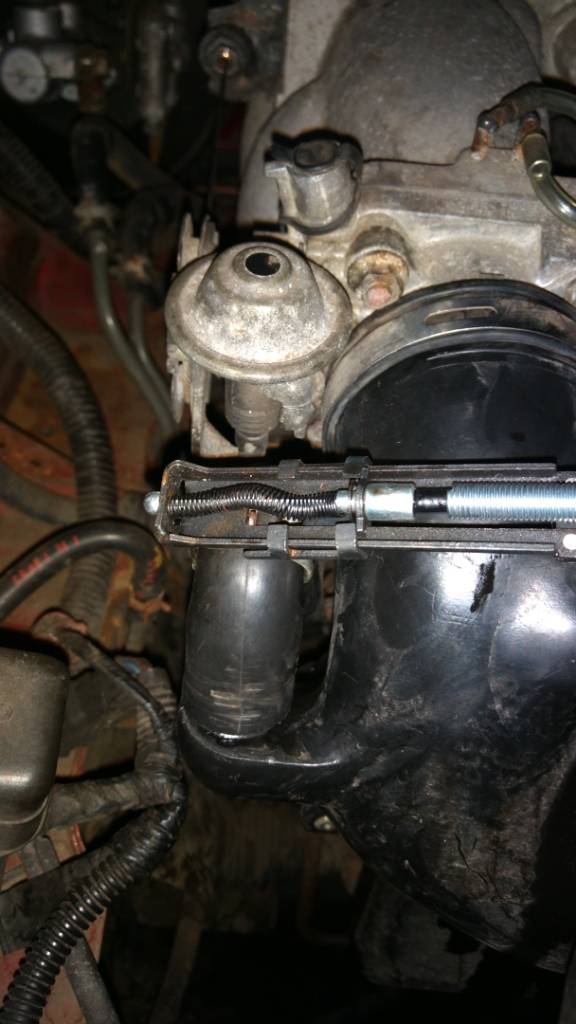

Not sure how I ever survived with hose clamp pliersattachicon.gifIMG_20180419_203626.jpg
In your pic above, what is attached to the vacuum take offs in the top right corner ? They should be looped / blocked, if you have a leak it would bugger up the idle.
Here's Brown Bear looking for vacuum leaks - is the looped clear tube still there ?
Yep still got looped tube - being clear it is hard to see
