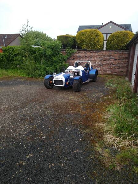

So, not long after getting it back on the road I decided to take it a spin, probably it's last of the year I thought with it being October.
Sadly, it definitely would be it's last of the year as I managed to crash it :(
Low speed (<20mph) heading towards an acute angled left hand corner into a bridge on a narrow country road and a car comes out of the bridge over the road on my side a bit. I jump on the brakes and cold tyres(R888s) and greasy tarmac causes me to lock up and smack into his RH rear door. Fuck.
His MPV thingy has aftermarket sidesteps which take most of the damage, my front RH suspension is fucked though. We sort it out without insurance, I buy and fit a set of sidesteps to his and we're both happy. If we'd went through insurance it would've been 50/50 at best so i took the hit.

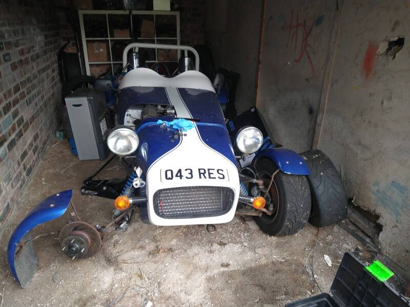

It sat in my lockup and I forgot about it as I was busy doing the engine swap on the MR2 and enjoying Knockhill. I'd been thinking about selling this before anything happened as I'd kinda decided I'd had my fun with it. Ironic as I'd managed to get it running and driving pretty well, it was a bit of a horror show in some parts when I got it.

The main thing that put me off was the fact you can't pop down to your local factors and buy a set of wishbones for a 2005 Locost. They don't exist. And my manufacturing skills were zero. So it sat in my lockup forgotten about.
At some point last year I discovered Rallydesign sell a full Locost wishbone kit, everything I need including bushes and new balljoints, the lower being from an Austin Maxi for extra shite points. I measured, calculated, measured again and decided it seemed to be a good fit so I duly ordered them up. On arrival I was happy to see that they fitted perfectly, however the inner sleeves for the mounting bushes were a larger diameter-I'd either need to drill out the mounting holes on the chassis or get new bush sleeves made up. I duly forgot about it again for a while.
Fast forward to lockdown and the ever wonderful @Tickman on here saw my cries for help and offered to turn down the old inner sleeves and press them into the new ones, solving that problem. He was far too efficient and had them back to me within a couple of days. Guess I'd better do something then!

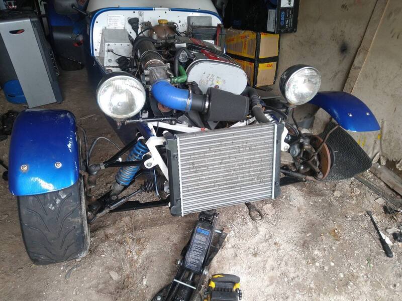

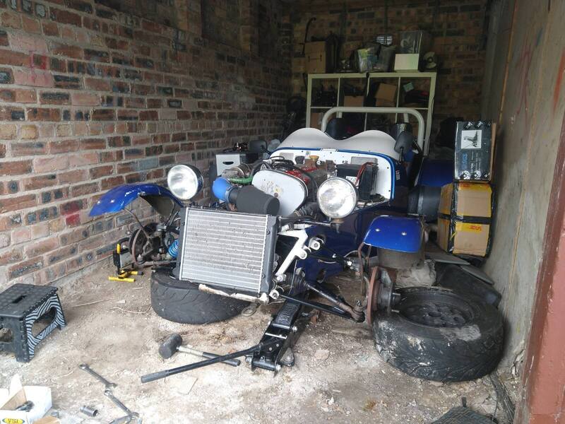

So, here's how it looked after 18 months or so of being forgotten about
I removed the nose cone for access and started stripping it down

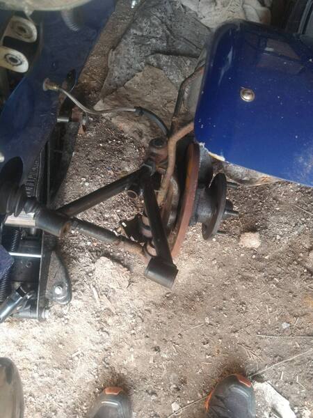

The old LHS partly dismantled

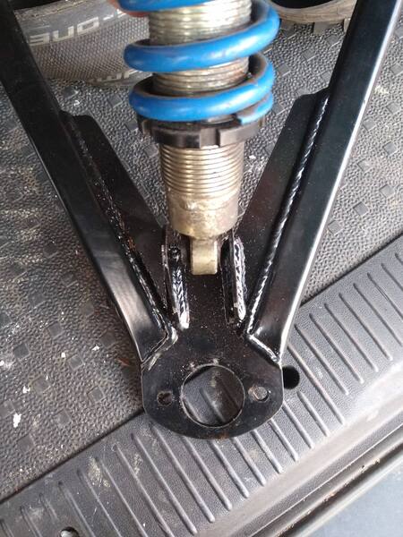

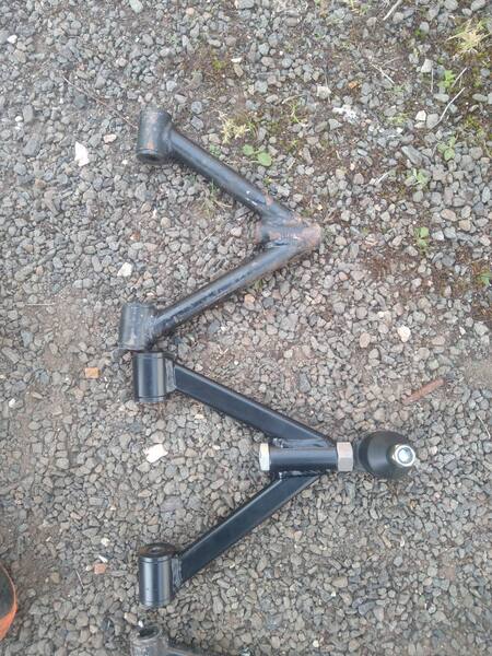

New vs old wishbones
393784184_newlower.thumb.jpg.ef9abb5ae4f0415ea466d346b86fdf31.jpg1736692942_newupper.thumb.jpg.93a5bf1bbb6ad400b25f24f526d14d53.jpg
The old wishbones were home made and pretty skinny, however as they failed they saved the chassis so I'm not complaining. New ones are much nicer looking.
It all went together pretty smoothly with the exception of the lower shock mounts which are wider on the new wishbones. I'll need to source new bolts and some spacers but it's together for now to get it moving.

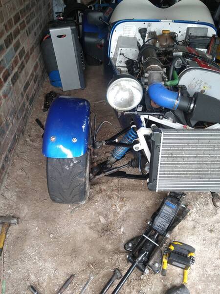

Drivers side on first
1629965122_driversfitted1.thumb.jpg.9138b89230b258c6dea8c21cb5ab8170.jpg230171959_driversfitted.thumb.jpg.e11735c34fc93307a51f13ec871632e7.jpg
And then the LHS was fitted and it could get some wheels on and back on the ground for the first time in too long.

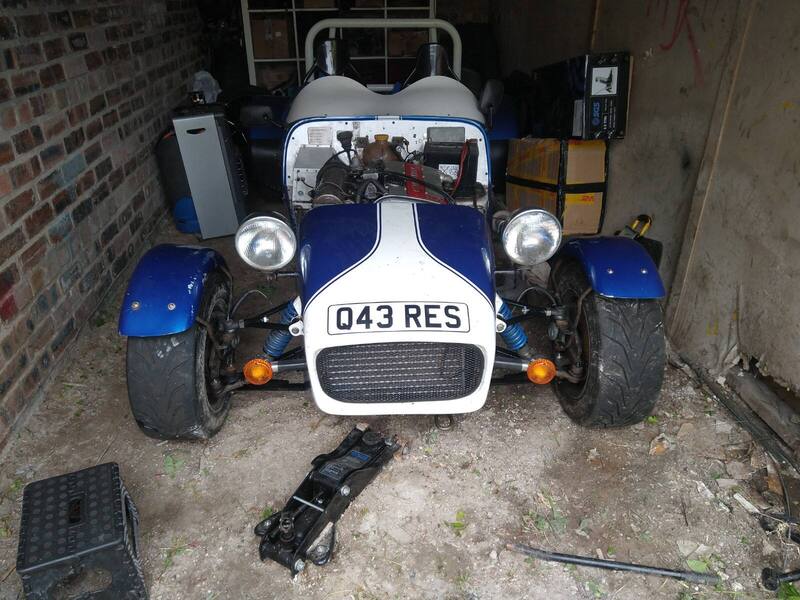

So, with it now back on all 4 wheels I decided to pull it out of the garage for the first time. Although it had other ideas. Remember the low brake fluid? Yep, I had no  clutch. Bugger
I'd had issues with the clutch before, there's a leak somewhere in the system. It usually came back after a bit of pumping though. Fnarr.

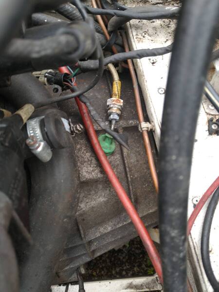

This time it didn't respond. It's the Omega gearbox but there's nowhere to bleed the clutch without stripping the gearbox out as far as I can see. Here's where the hose enters the box.
In desperation I cracked off that union and let some fluid out, amazingly this fixed it and I had a clutch again! If any one can shed any light on how it should be bled properly I'd be grateful. Getrag 265/285 box from memory out of an Omega I think.

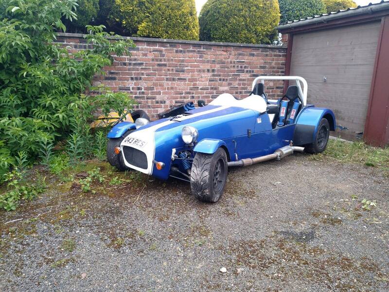

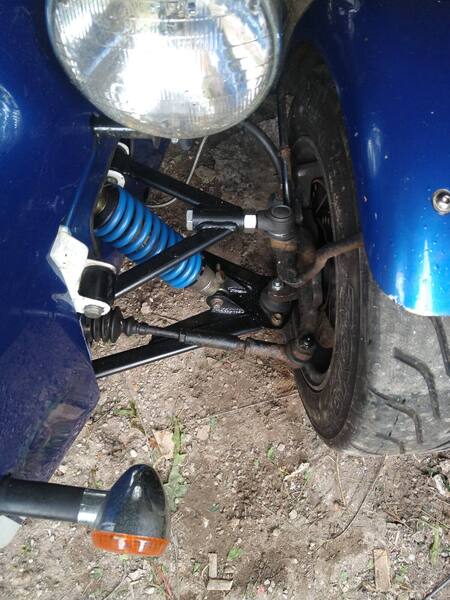

And here's the new suspension in daylight
Tracking is miles out and it needs new steering arm boots as one has split. I adjusted the tracking a bit hence the boot is twisted in that pic.
I insured it (£95 for the year) and took it a very quick spin as it's sans MOT and was raining. Nothing untoward apart from the tracking so that's good.

Think I've worked out how to bleed the clutch-turns out there's supposed to be a bleed nipple on the underside of the gearbox. Quick look at a photo of the box and oooh hello
Will have a crack at that when it's back at the house and will try and get to the bottom of the leak-it may need a master cylinder. I've also got a bias adjuster for the brakes I never got round to fitting
