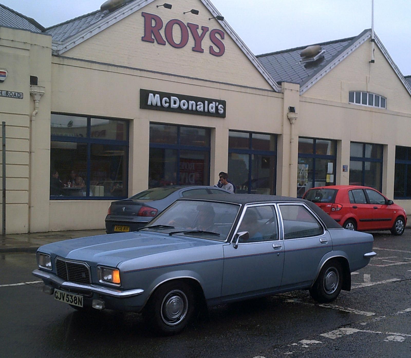

In a soggy Roy's Town a few years back.

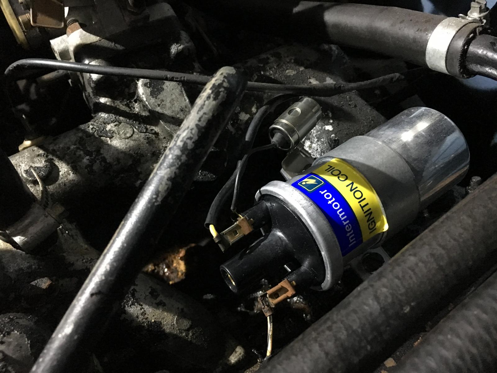

Shiny new coil and condenser arrived in the post so I fitted both today.
Before:
After:
And now the bastard won’t fire up at all, at least not properly.
I ran out of time to troubleshoot it this evening. Will investigate some more tomorrow. First things to check are the connection to the king lead (yes I did plug it in after I took the second photo) and the battery which might be a bit low.
Pretty disappointed - I fabricated a lovely bracket for the condenser and cleaned up all the contacts and everything.
Try putting the old condenser back on. I bet that’s the problem, fresh out the box and already duff. This is what was causing no end of shit on the Mercury.
Will do if a new king lead and battery charge don’t fix it, and the old coil. Kept both, for that reason.
The king lead is missng in the second picture.Ben
I’m dumb, but I’m not that dumb.
