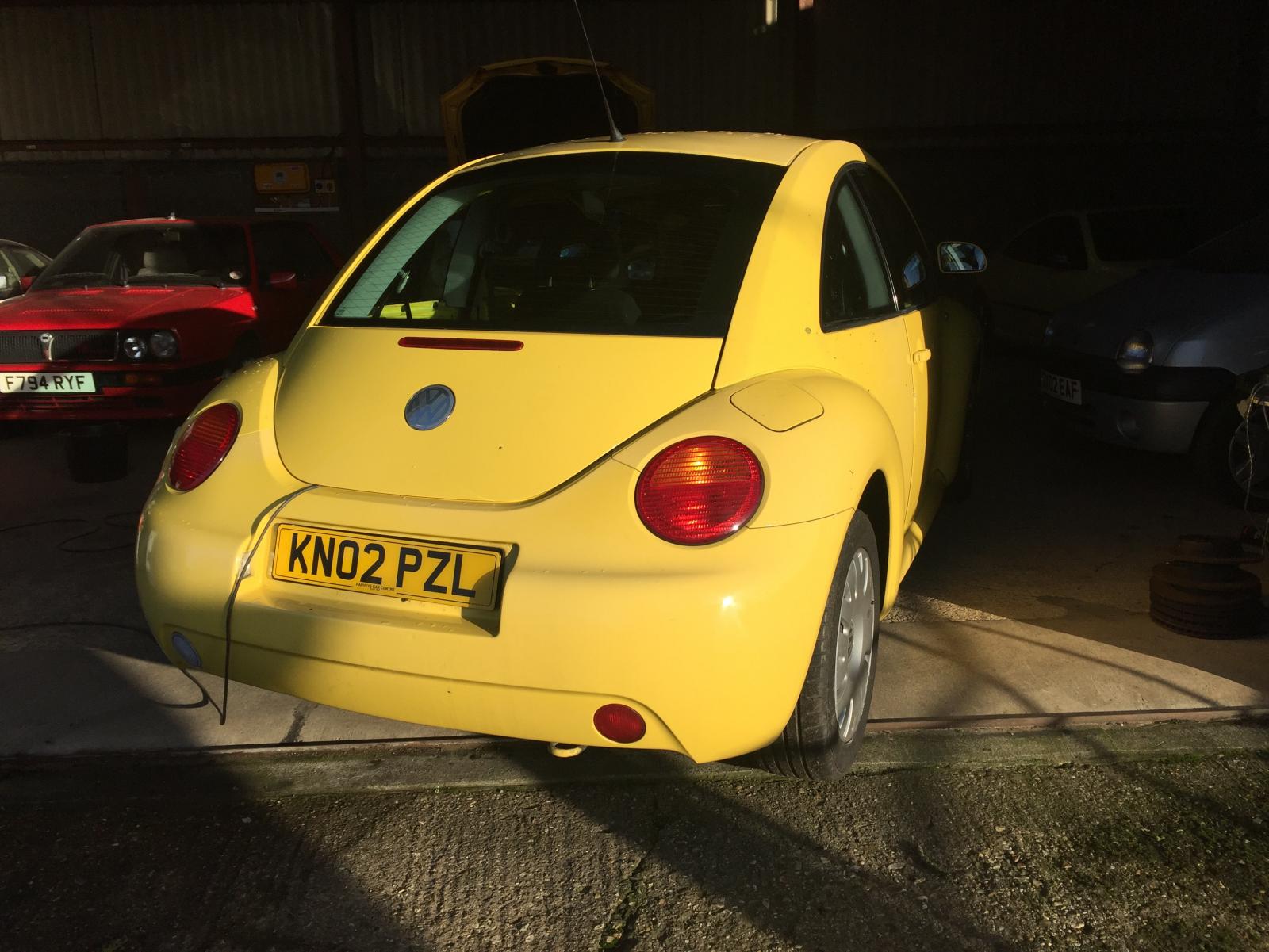

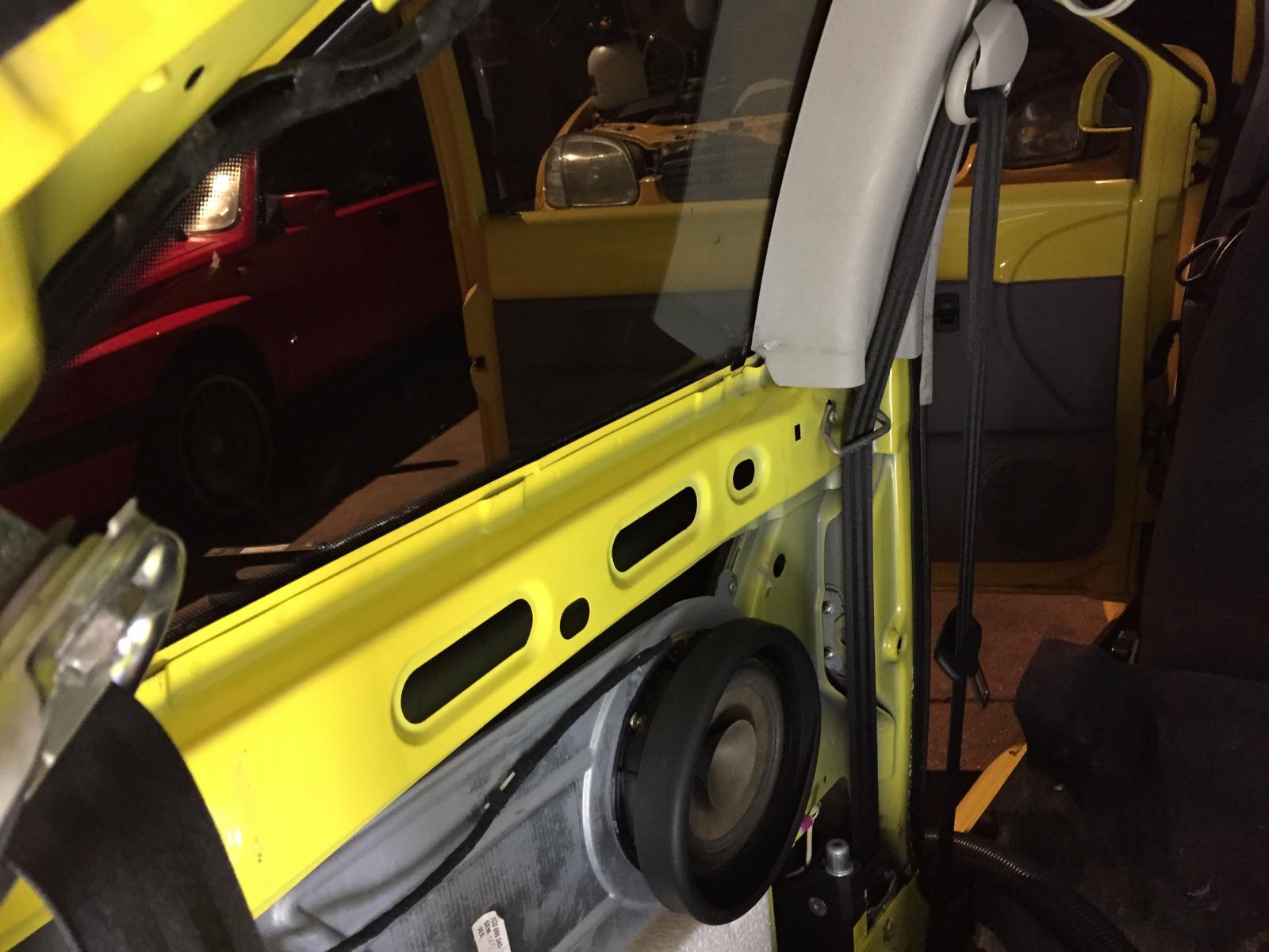

Bear Posted December 31, 2015 Author Posted December 31, 2015 Judging by the resin I had to clean out, this one had a different kind of cig in it. Reconnected drain hoses, left car in rain. Water running down... ... The inside of the tailgate aperture, out of the drain hoses. Headlining still dry. So now I just need to dry the rest of the car out then I can replace the trim. Yellow radio installed and working fully having sussed out that the "what the hell kind of antenna connector is this?!" was actually an entirely normal one where the pin had broken off and stayed in the socket. I need a new floor console, 12V sockets, armrest buttons, handbrake button, lower button trim/screws, assorted trim fixings and screws, and preventing from sending the same gorillas that worked on this car before around to the seller's house. I also need to fix the door lock mechanism, which is the first "WTF, VW" job I've seen. Weirdest way of making a door EVER. Apparently common to Mk IV variants and no doubt later ones.

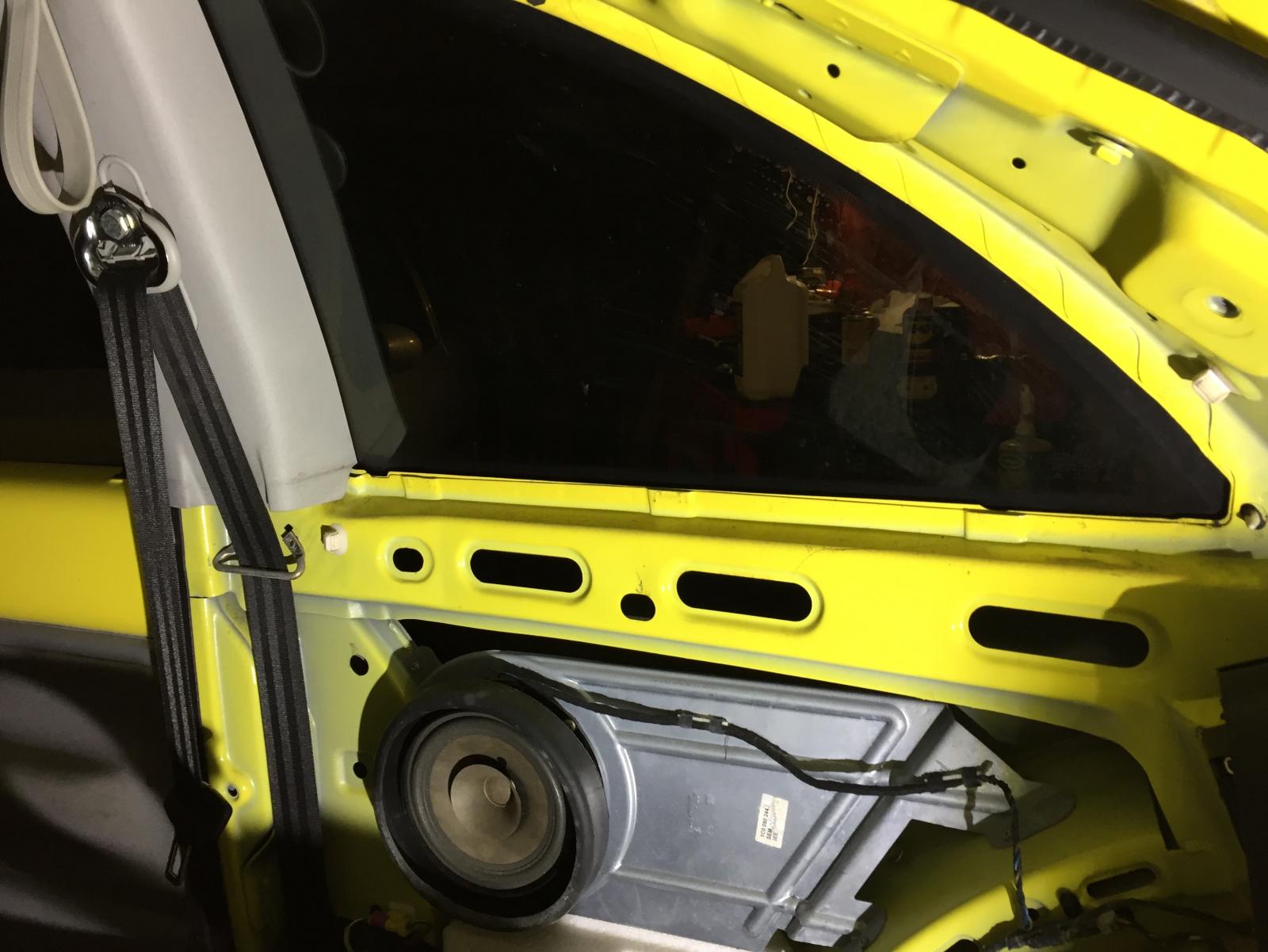

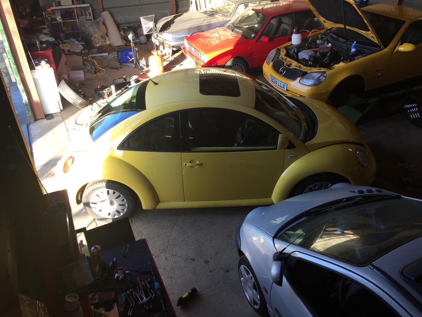

Bear Posted December 31, 2015 Author Posted December 31, 2015 So, last night and today, more Beetle things, all along the same lines. It's clear that despite what the UTTER MORON working on the car in the past (how the hell do you break the entire centre console. HOW?) thought whilst wielding the bathroom sealant, there is absolutely no evidence of water coming in the side windows. Which would have been flaming obvious when they were mangling the quarter trims, not installing them correctly, and losing clips. GGRRR. Morning: Sunrise in the garage. You'll have to imagine some classical music. Even though team yellow loves Absolute '80s. Popped the heater in after pointlessly vaxing carpets. The headlining was dry after the rain, but the sodden trim and sound insulation means this is going to be a problem for some time... Fortunately the sun wants to help. Meanwhile - respray roof, or be true to Concept-1 with gloss black vinyl? Coprolalia and Magnificent Rustbucket 2

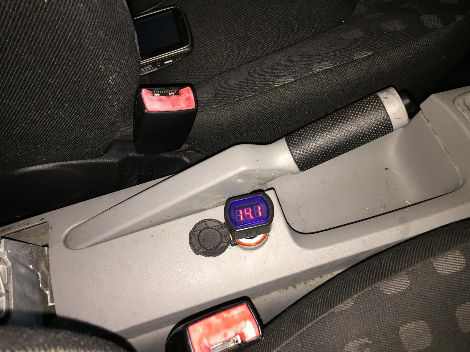

Bear Posted January 2, 2016 Author Posted January 2, 2016 Battery from A-class swapped in - was exactly the right model Halfords Calcium (doot doot, thank mr skeltal) model and despite much abuse and lack of use, is happily charging and behaving. Trim going back in - jetwashed around sunroof, no leaks of note (it's hard to tell when the car is still full of condensation and cultures). It's looking quite good now. As the console is trashed anyway, going to get creative on satnav mount and maybe even just pay for the map updates for this ancient TomTom 950. The Beetle is now named Ludo, and that will stick. It is the Bug of Eternal Stench. Pillock and UltraWomble 2
