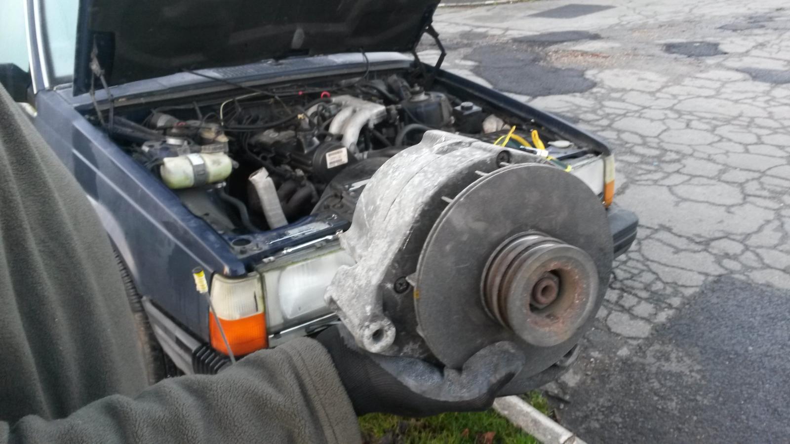

Just about to whip the alternator off before we go hunting for a replacement.

Going well so far. Getting this off was almost easy. To the motor factors!

Aye. An update. Due to perspective, the new alternator is much smaller. My mate managed to find this one, for a nice cash price at a fairly local motor factor. We headed there, then went and scooped up Panda and mini-Panda so they could get heading East. Then it was home to fit this.
Access isn't too bad but getting everything lined up for the main bolt to go back in proved tricky. I also topped up the coolant and examined the non-working sidelight. Hadn't realised they were twin filament! I didn't have a replacement with me. Meh.
With the battery charged overnight, we connected everything back up, started the engine and tested with a multimeter. 14v! Brilliant. A celebratory cup of tea was had. I then hopped aboard for the long drive home.
