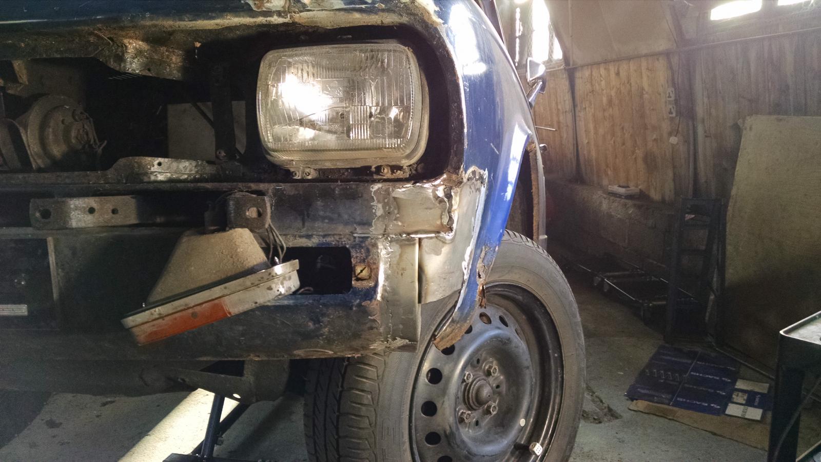

I've got Sonic in a position to have a bit of a fettle.
This needs the fiberglass removed and metal putting in.
Some work on the arches too.
Looking a bit full in here.
After getting Sonic on the SeeSaw the other day I got started today.

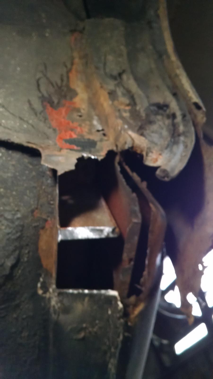

First I pulled out the fiberglass and was left with this.

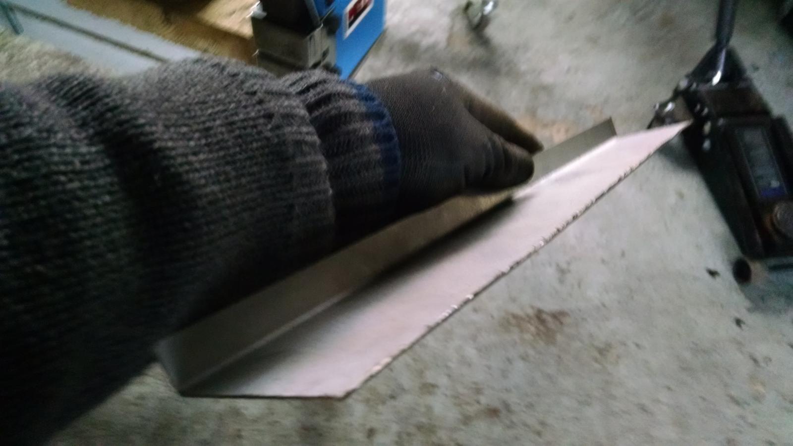

Got a piece of metal and put a bend in it.
The front isn't flat so I had one piece for the recessed bit.
I put a bend in the other piece with the shrinker. Then stuck those in.

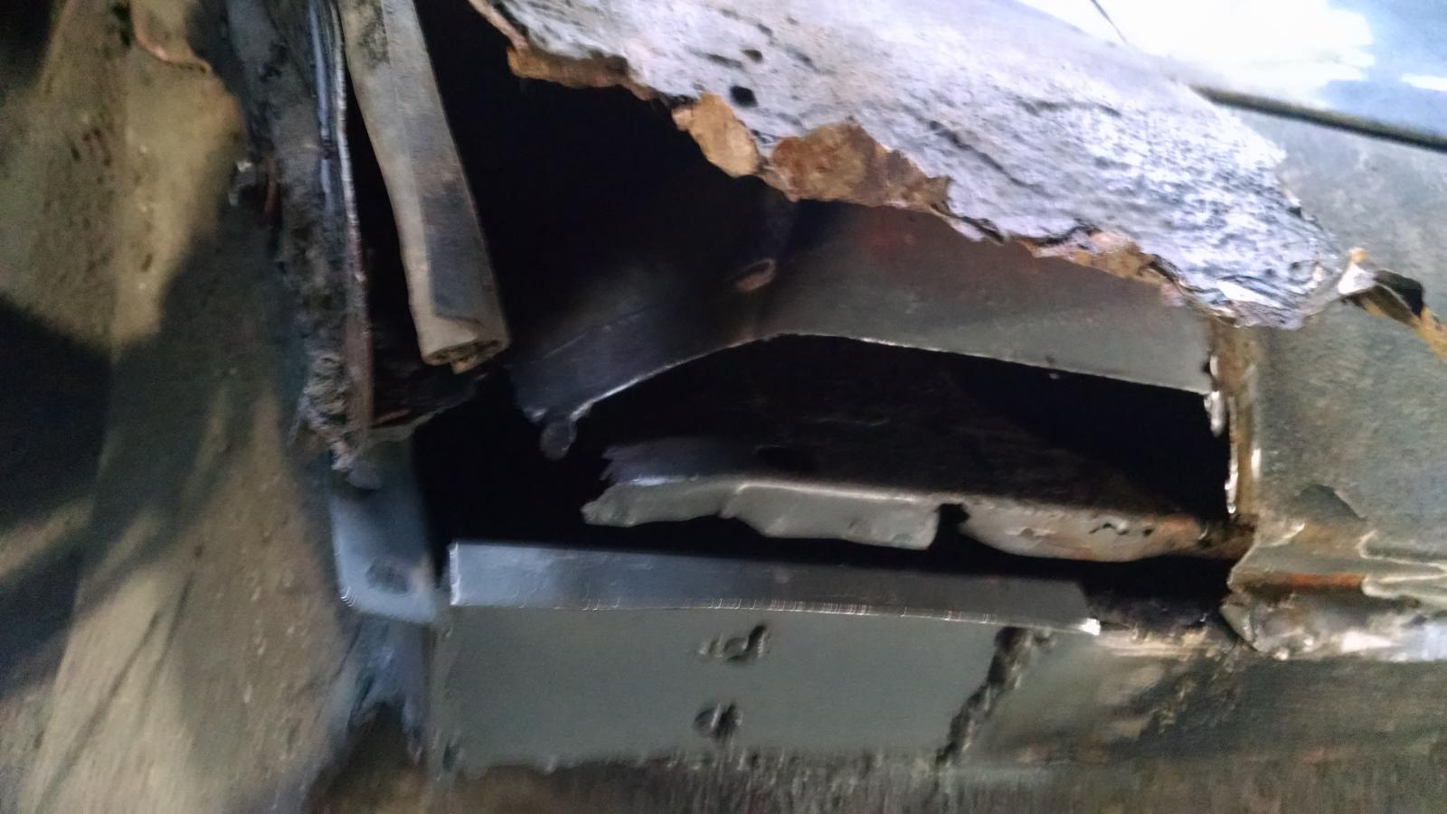

Then I started on the wing piece.
Half of it in. I then made and fitted the next bit but no pictures as I was doing a lot of thinking.
The bit where the sidelight screws in was a bit rusty as can be seen above so out that came.
Made a bit.
Stuck it in.

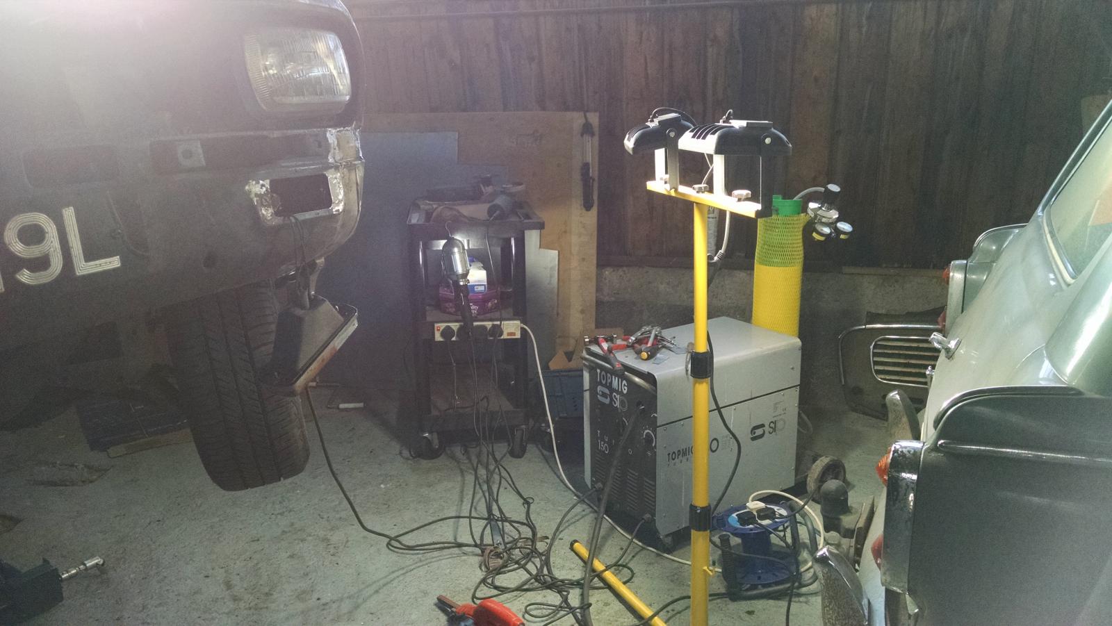

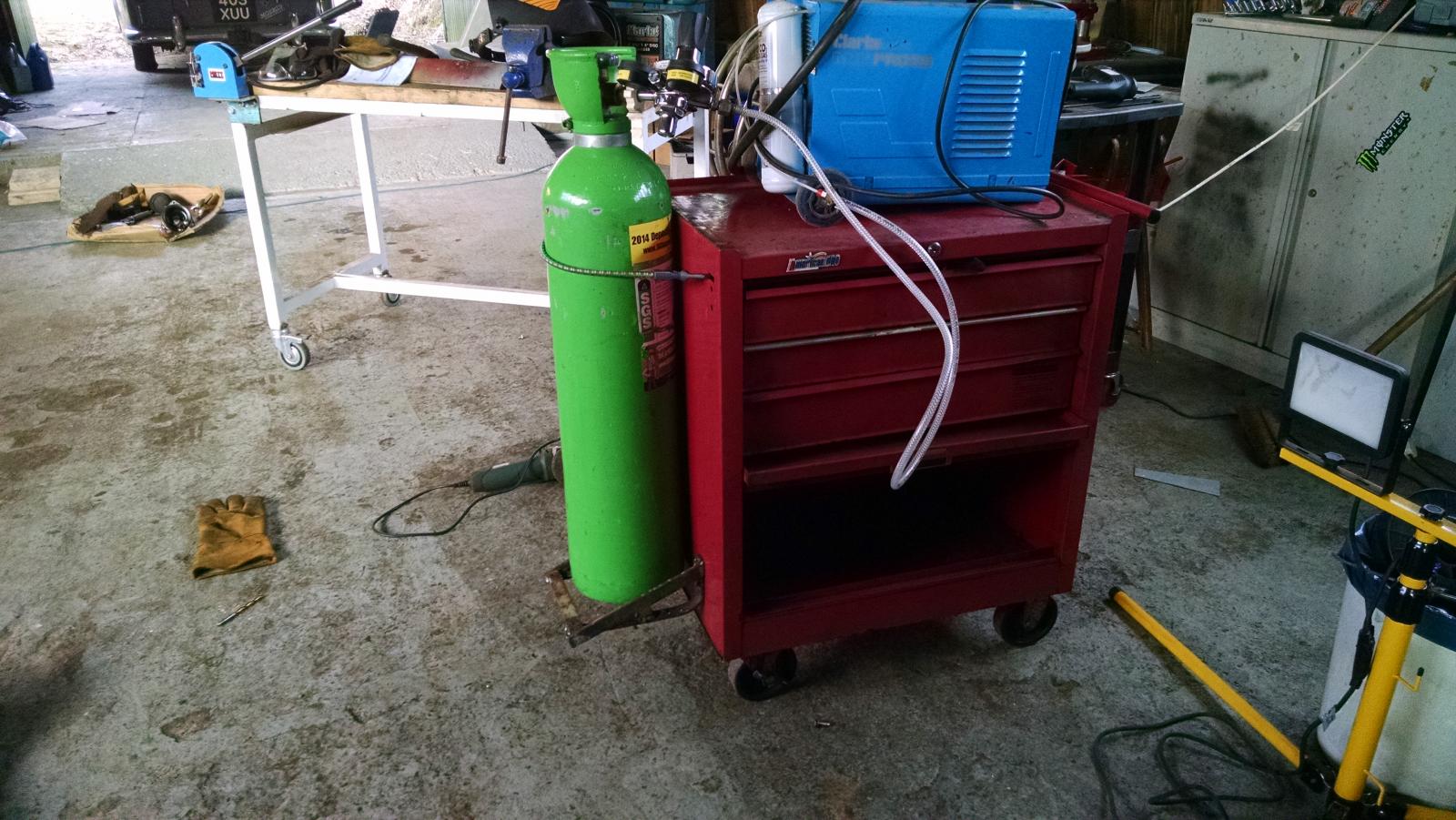

Today's set up. I have been using a friends welder which after the wire feed tension mod (a piece of metal connecting either side of the wire feed rollers) it isn't too bad really.
Some friend that! Isn't too good either. If a friend of mine appeared at mine with one of those I'd send 'em packing!
He was sold it by someone who should know exactly how bad it is and is supposed to be a friend!

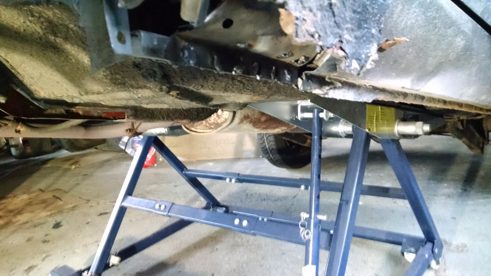

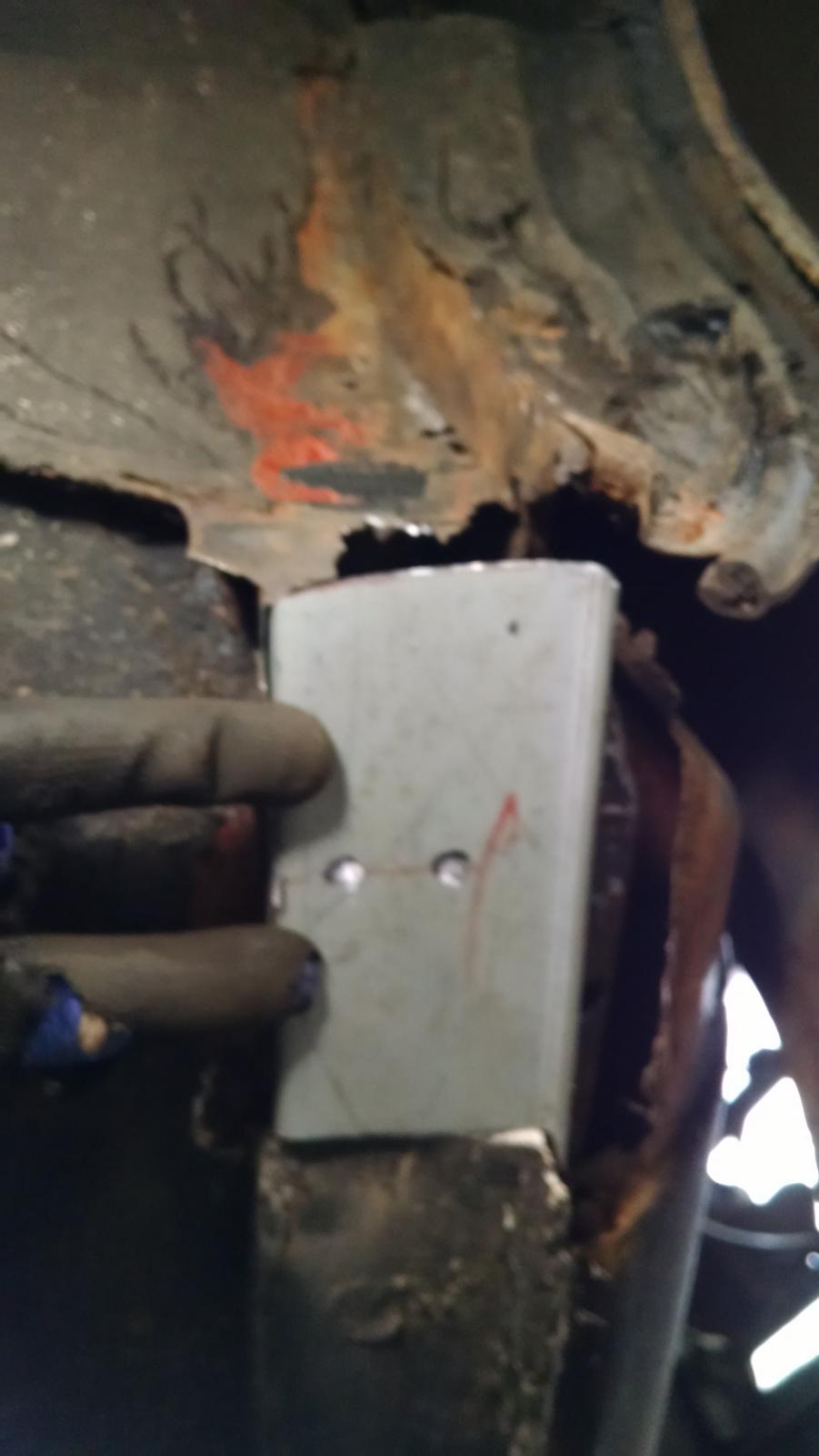

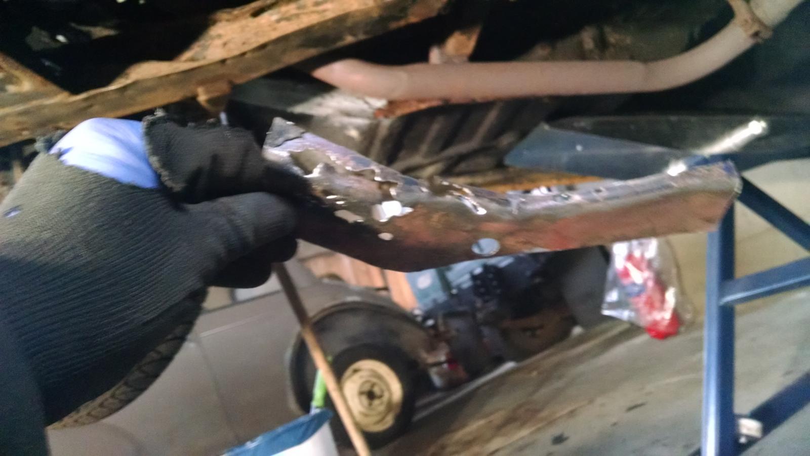

Started on the front of the passenger sill. Cut some stuff out.
Cleaned it up.
Piece to go in.
With a cut out for the piece already there.
Got distracted.
Cut that out too.
It was vert flimsy.
Back on track I put the piece in.

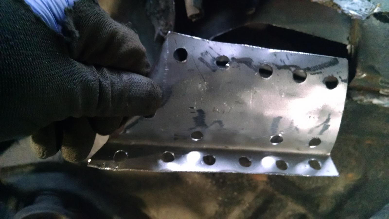

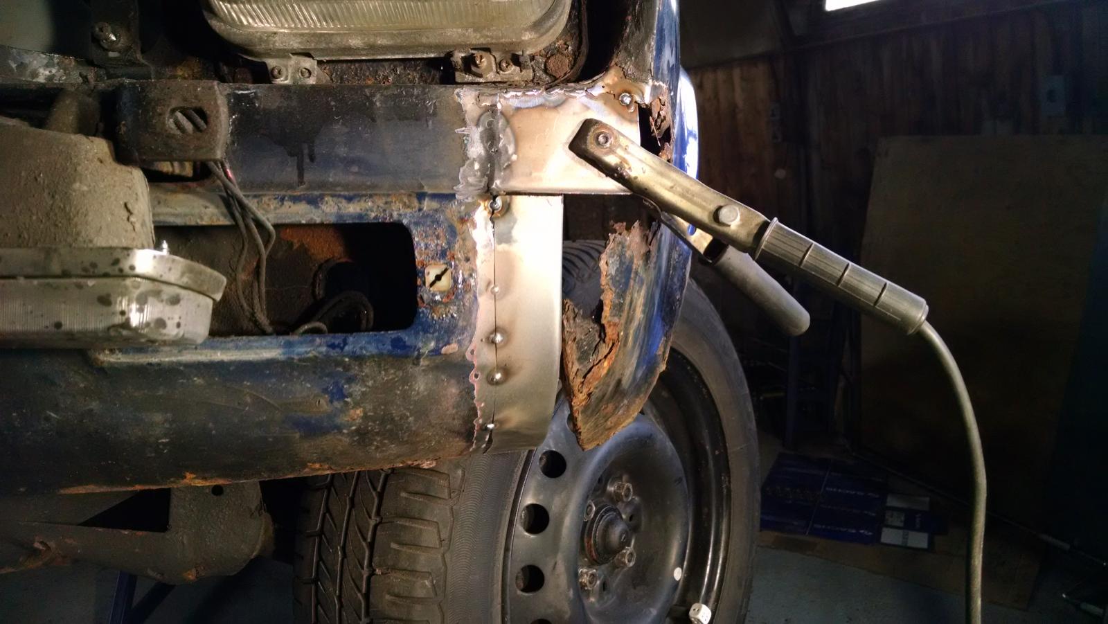

First piece of the sill closer.
Goes here.
In place.
I also plated a bit of the wheel arch just where it meets the sill bit took no pictures of that it seems.

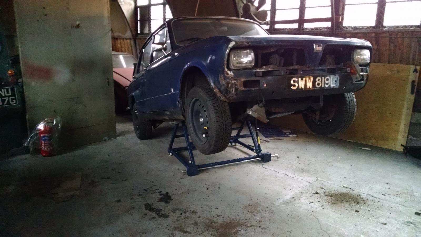

Im envious of your lift as well, no scrabbling around under a car thats barely a foot off the ground!
More superb fabrication there and very neat cutting too!
The lift is great, I was sat on a chair while doing the bit at the front on Monday!

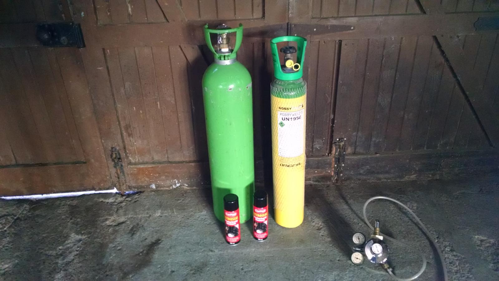

The last thrilling update ended in having run out of welding gas so supplies were acquired. The 20L SGS gases bottle is very heavy!
Oxford out of the way for a good tidy up.
Anyone who has a gas bottle but no place for it will have undoubtedly discovered they like falling over and breaking the regulator. I decided to be proactive for once and used some old metal from a fence to make the support at the bottom.
Oxford now back in place ready for its next session.

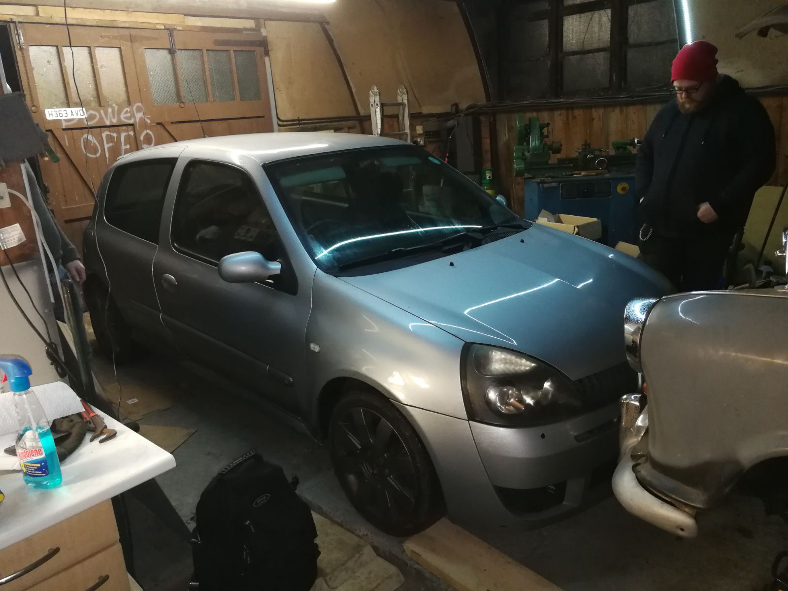

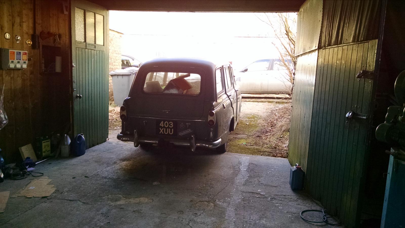

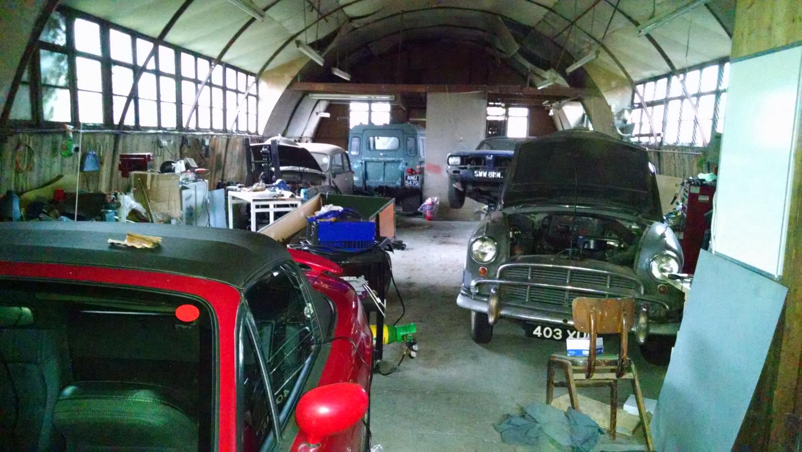

When 320T was up on Sunday fixing* more of the Oxford he left something behind.
So it was pulled in at the end of the day.
Just a little bit tight in here.
No I am not storing all of his cars, only one of those cars in the last picture is his, now!
  • Like 8
