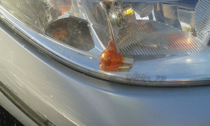

One uneventful journey later... it goes well enough but there is a banging noise from the front left side and rough roads make the same wheel hammer a lot. There is a full strut in the boot though, and the MoT checker shows that I advised the NSF shock for a leak back in july.
