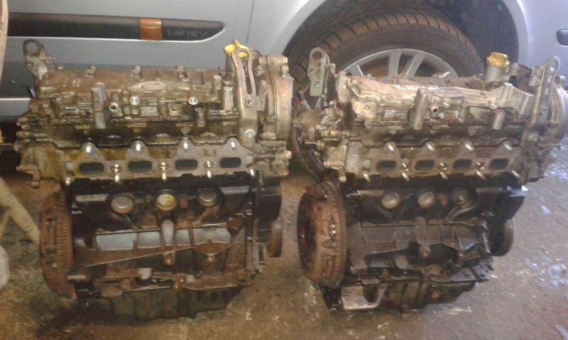

Dink - they sold it to me on ebay and it's clearly not as described. I'm hoping to persuade them to send another one ASAP and collect this at the same time because massive ballsup. No way am I spending more money on a gearbox that fits the engine but mightn't fit the car.

I know what you mean. It's why I was methodical and careful with everything removed to the extent of checking that parts were going to fit the new engine. I think this is the first time I've come across an incorrect bellhousing pattern though.
Actually, while typing that I remembered it isn't. Phase 1 and phase 2 Talbot horizons have different bellhousing patterns because the early one is a simca gearbox and the later one is a peugeot one. Guess how I found that out (on the drive of a council house almost 25 years ago...)

Appears to be the following engine codes for F4P:
JR5 gearbox: (5 speed manual)
F4P770, F4P772, F4P774
DP0 gearbox: (5 speed auto)
F4P771, F4P773, F4P775
Maybe you have a F4P that mated with an auto box?
Edit: Just saw the pictures again and re-saw the clutch plates...
It's OK, a trawl through Ebay has confirmed it for me.
F4K 1.8 from a 2002 Megane Scenic. (edit - it's a F4R, there is no such thing as a F4K but the block stamp looks like one)
Fugging hell man, the breaker needs bloody shooting if you ask me. Still, let's hope they can rectify the problem and get correct engine out to you. Keep going with it, will be ace when it's finished.
Further digging - F4R 2.0 from a 6 speed laguna, megane or scenic seems most likely. Early F4P and F4R have the same bellhousing pattern and the JR5 box but later 2.0 has an entirely different bellhousing because of the box.

I phoned the breakers first thing, they are sending me another engine and don't want the other one back. I also checked in the scrapyard and it is the correct engine for a 2.0 16v laguna with a 6 speed box. Anyone need it?

Probably, but he would still need to use the old engine block which is very likely to be borked.

My Laguna has a 5-speed box (I think), because of that the crankshaft rotates in the opposite direction or something, so this engine is no good to me
Unless yours is an IDE (and I hope for your sake it isn't...) the top end should be the same.
TBH I think I'll throw it on ebay for collect only 99p start (may swap XBOX_PHONE_CORSA) when the other engine turns up. It looks like it's actually harder to find a 6 speeder if you need one!
