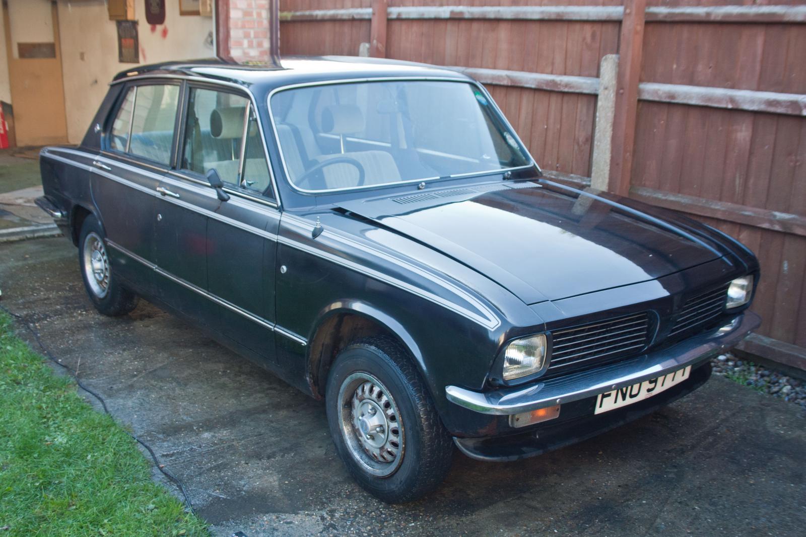

Dolomite SE all finished... For now!
I was eyeing up a set of 155/80's in Falkin rubber for £115 for 5 but wonder if a slightly wide profile would handle a bit better, although anything will handle better than 30 years old ditch finders...

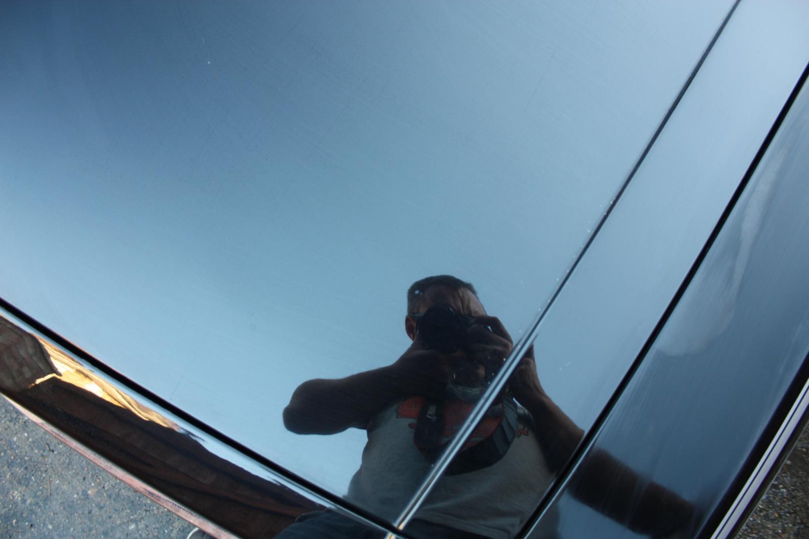

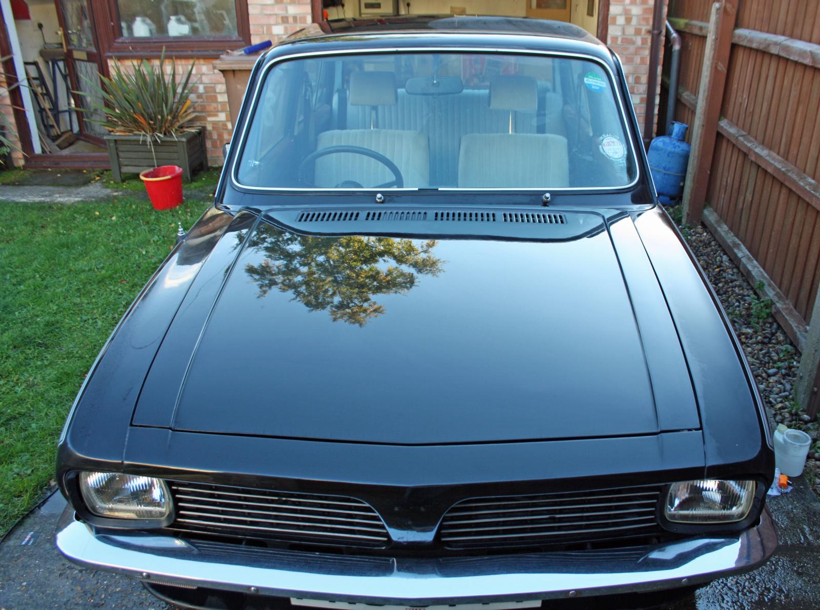

As I've been posting on the News24 thread I've been doing a bit more to the Dolly this week, namely flatting back and polishing the paintwork, It's been a slow a laborious job and I've only managed the bonnet, roof and boot so far but the results have been outstanding and very promising.
To be honest my photos don't do it justice but you get the idea.
I also had a go under the bonnet, I've managed to get it looking better but i didn't remove the wax, only the bits that were on the bonnet stickers and vin plate, I also removed and cleaned the washer bottle, and replace the string holding it non.
Now here something, the lady before me paid £19 for a new washer pump and another £35 to have it fitted by this garage that ripped her off, i thought I'd try the old pump as it's still there and see if i could fix it, unbelievable it worked straight away and there nothing wrong with it! So I've removed that nasty plastic one now.
  • Like 18

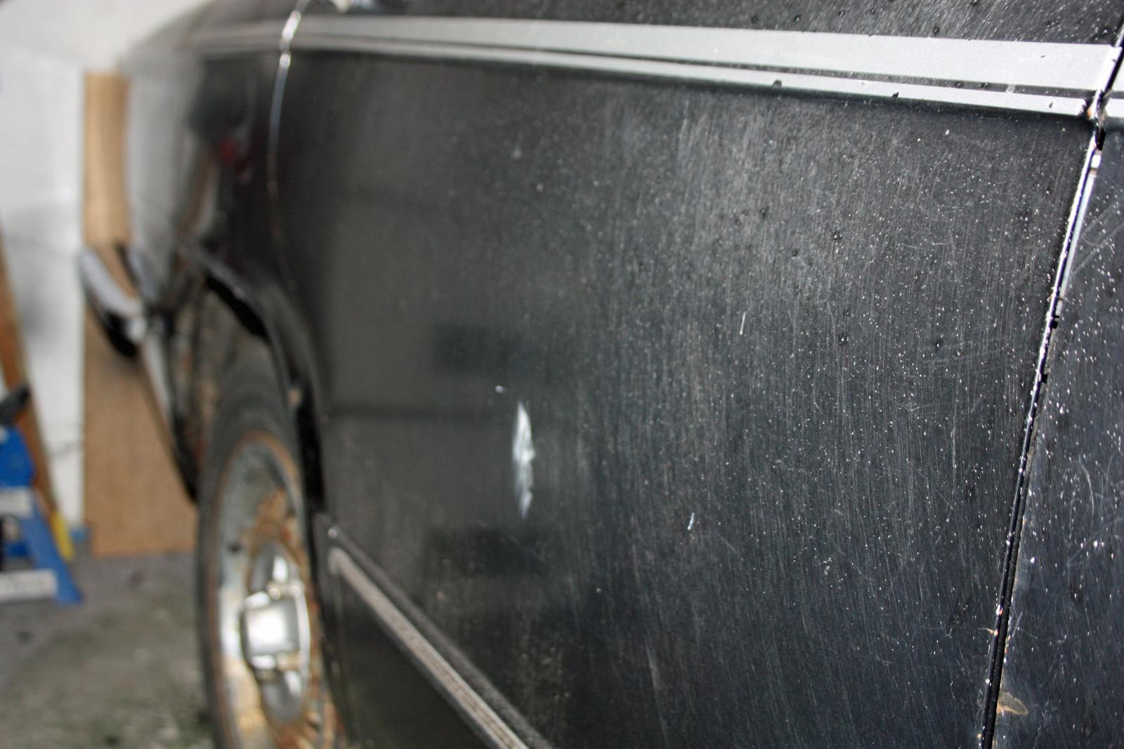

If that is the worst of it on your sills then it'll be a piece of piddle. A weekend or two with a knotted wire brush or the like, some Kurust, some acid etch primer, a couple of coats of red oxide, grey primer and topcoat will have the sills looking like new.
I was going to DA them back to metal again and etch them, primer them and possibly run some stonechip along them before painting. The other side isnt quite so easy as it had a dent in the sill and that big dent in the wing, oh and the valance is quite snotty too.

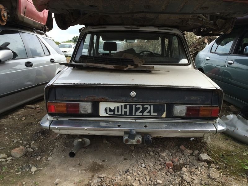

Trig you do know about the Dolly that's being broken near mine don't you? Could provide a wealth of parts for yours?
I didn't know about that one Pete. TBH I don't think there's much I need now other than possibly rebuilding my brake master cylinder again and the Servo. I think that ones a 1850 HL, shame as if it was a 1500 I'd have that stainless exhaust of it!
Hmm, that rear bumper mid section looks better than mine ;)
If you are going anywhere near with a large tin of PlusGas and some spanners :)
A sad sight. I knew I'd seen that car somewhere before, there is a picture of it on Flickr from 2013! Apparently it is/was an 1850 auto.
