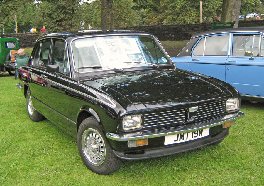

Dolomite SE all finished... For now!
Inspiration for Triggs. One seen at a show in Leeds a few years ago

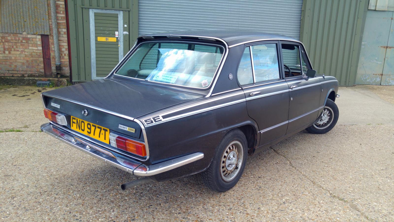

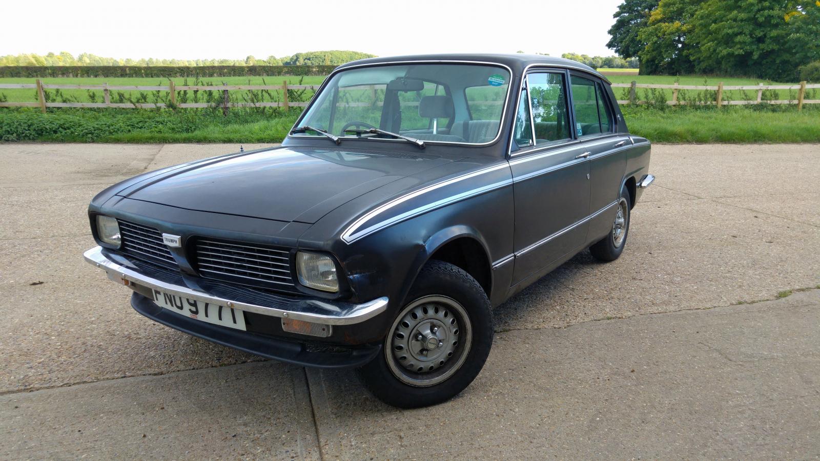

So I spent some time this afternoon playing with this, I have to admit moral is sagging a bit on it as everything seems to be against me and every time I look at it the bodywork seems to get rustier. :(
It was moted in March and had nearly £400 spent on the brakes, god knows what they done as the rears were thick in grease and down to the rivets and the pads were metal to metal as well as two holes in the inner arch at the rear and the centre exhust mount is broke, on and when they fitted the new steering rack gaters they forgot to do up the track rod nuts so it was all loose!! Stevie Wonder must have done the test.
So we replaced the rear shoes without to much hassle and cleaned them up, the front weren't quite so good, we fitted a new caliper repair kit to the offside but the nearside was really rusted up and full of water, I'll need to order a pair of pistons for it as well as a wheel bearing and now a master cylinder repair kit as that's started weeping now too...
Bloody old cars!

I spent a little while on the Dolly this afternoon, after the fuber by the supplier of the brake parts me and dad decided to refurbish the brake master cylinder instead.
The kit was £12 which is good value really, managed to get the old one off and stripped and cleaned, the inside was black and a few of the seals were damaged so it's no wonder it leaked and I lost the brakes!
After bleeding and refitting it it's looking a lot better now. We can't check it yet though as we still need the caliper pistons.

Funny you should ask, I spent a few hours on it this afternoon which helped my mojo no end!, We fitted the new caliper pistons and seal, replaced the wheel bearing, bled the brakes all round and changed the exhaust rubbers too.
So that means all that's left mechanically now is a good service, adjust the tappets and change the ignition parts, especially as it's pinking a little bit. I took it for a road test up to the local farm, the brakes are a bit spongy but with new pads and shoes as well as caliper seals it's all got to bed in so i guess that's to be expected for now. It's such a nice car to drive though! the little sporty steering wheel and neat little handling along with the bumbling exhaust note makes it such a fun little car to nip about in!.
I'll be happier once i get some of the bodywork sorted and fit a new set of tyres, trust me, my camera phone does make it look nicer than it is!

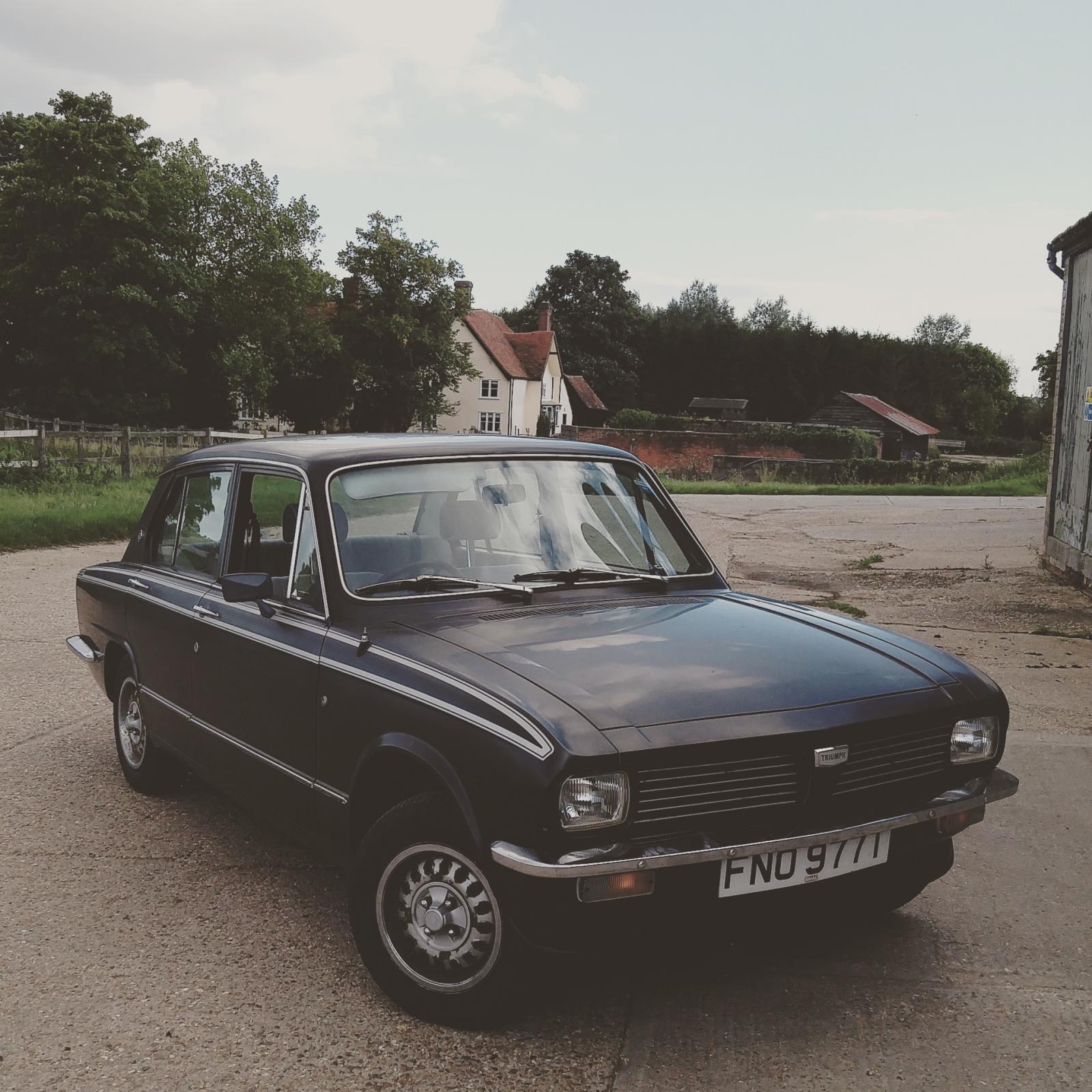

Some artistic instagram shots.

Today I done all the serviceable bit on the car, points & condenser, set up the timing, change the oil and filter, new plugs and leads, had a bit of a mare whilst adjusting the rockers as the rocker cover gasket I bought of eBay was of a Ford and the old one broke when I removed it and as we couldn't get a replacement we had to stick the old one back on again.
The brake master cylinder still isn't right as the petal loses pressure whilst you foot is on it, if you pump it it comes back again.
It home now anyway, the drive back in the dark was painless other than the brakes, it's a little tappy but that could be a exhaust gasket and the lights puslate with the engine which wouldn't be great if I suffered from epilepsy! The tyres are harsh as hell too.
