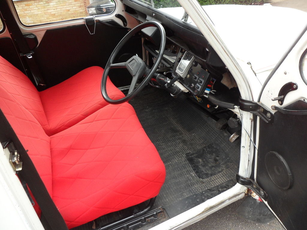

I find my 2CV quite narrow with little elbow room, does the Dyane have more interior width?
Yes. Body is a bit wider, and the doors are scalloped, so you get a lot more width.

Widest of all the A-Series Citroens I think.
