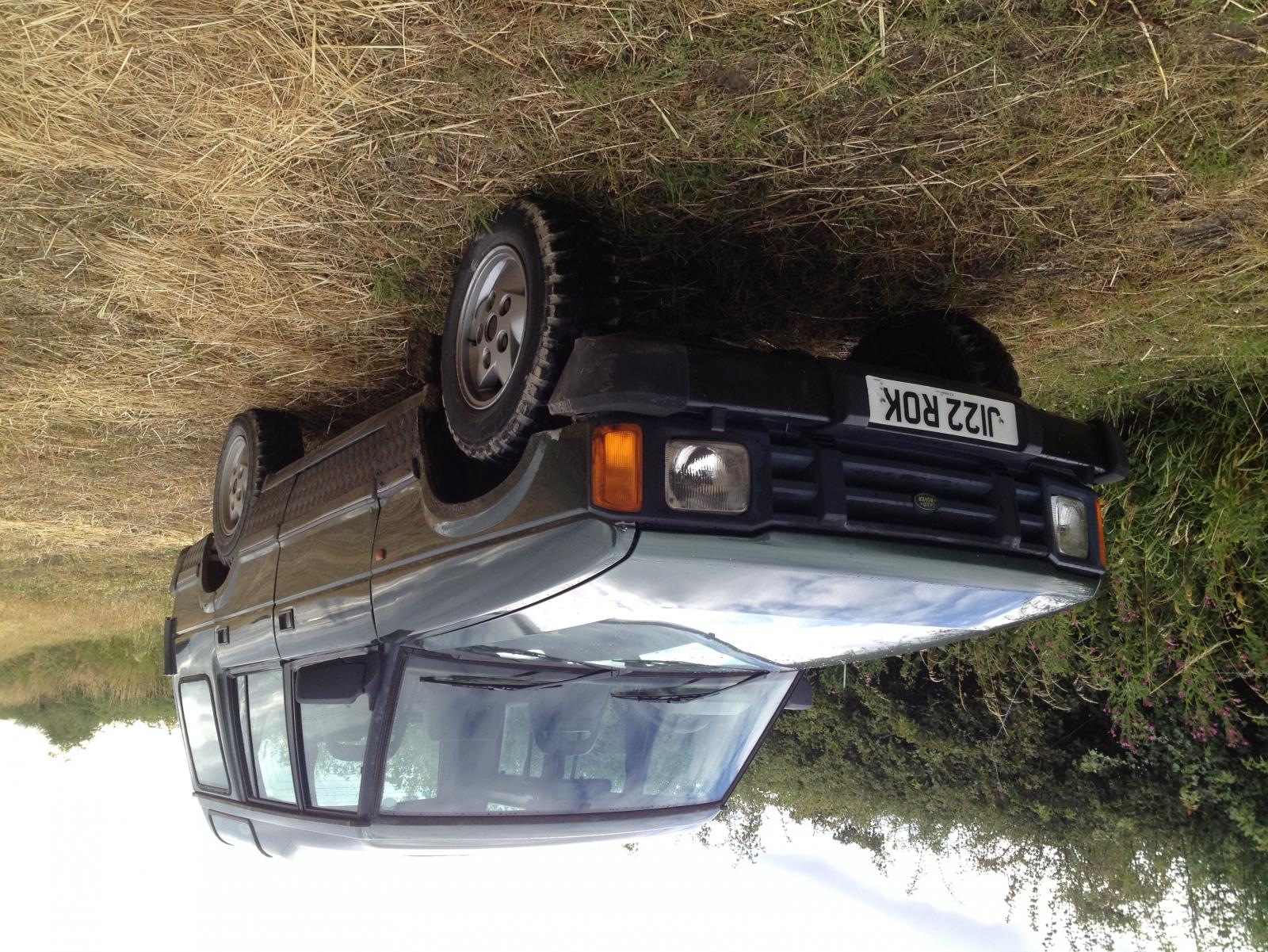

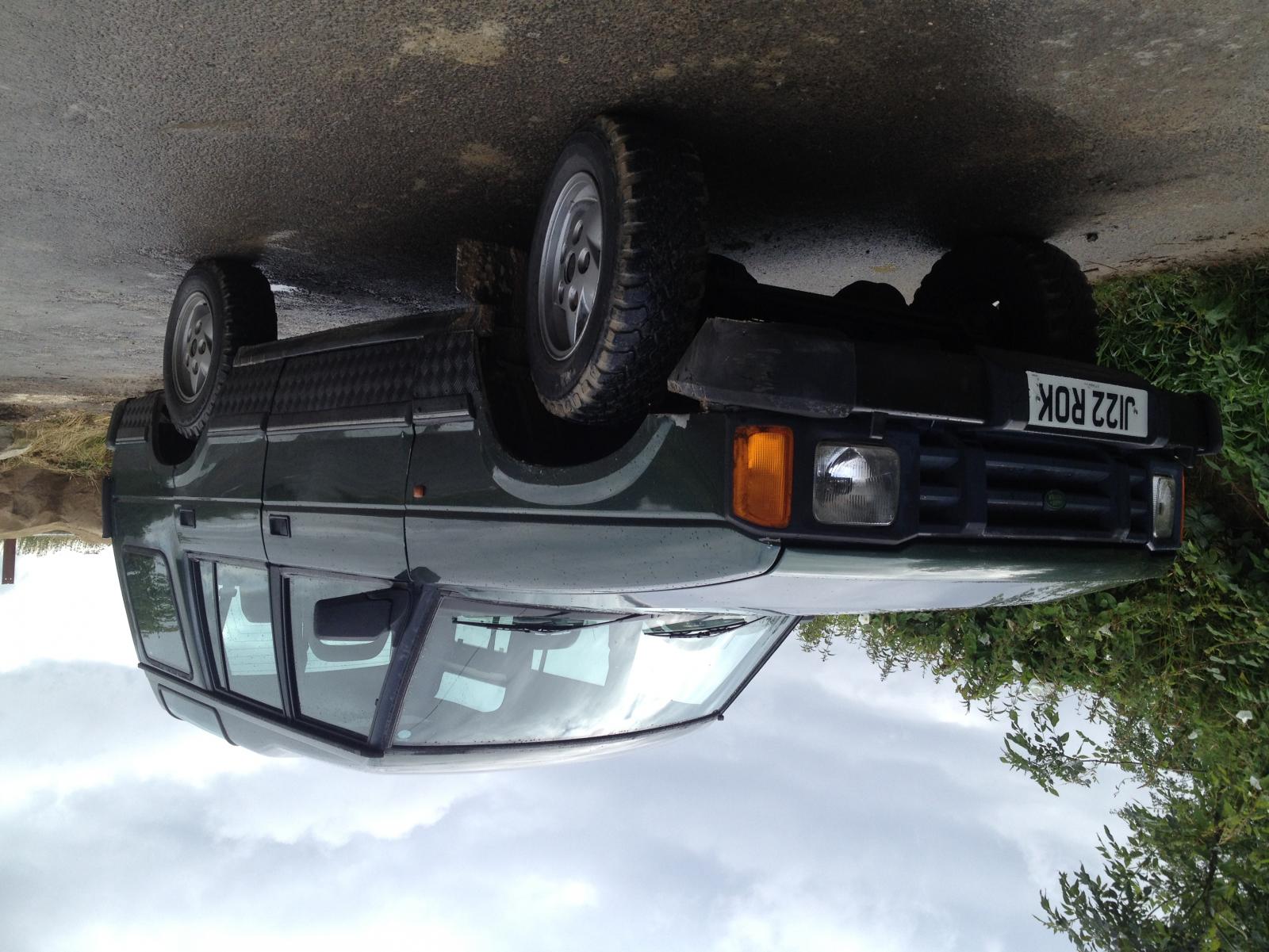

Well, I'm a convert, at least until MOT time in january. It's rough in places but the usual grot spots have been looked after over the years it seems, everything works and it doesn't rain inside.
I've given up trying to make phone pictures the right way up, they are hell bent on being upside down

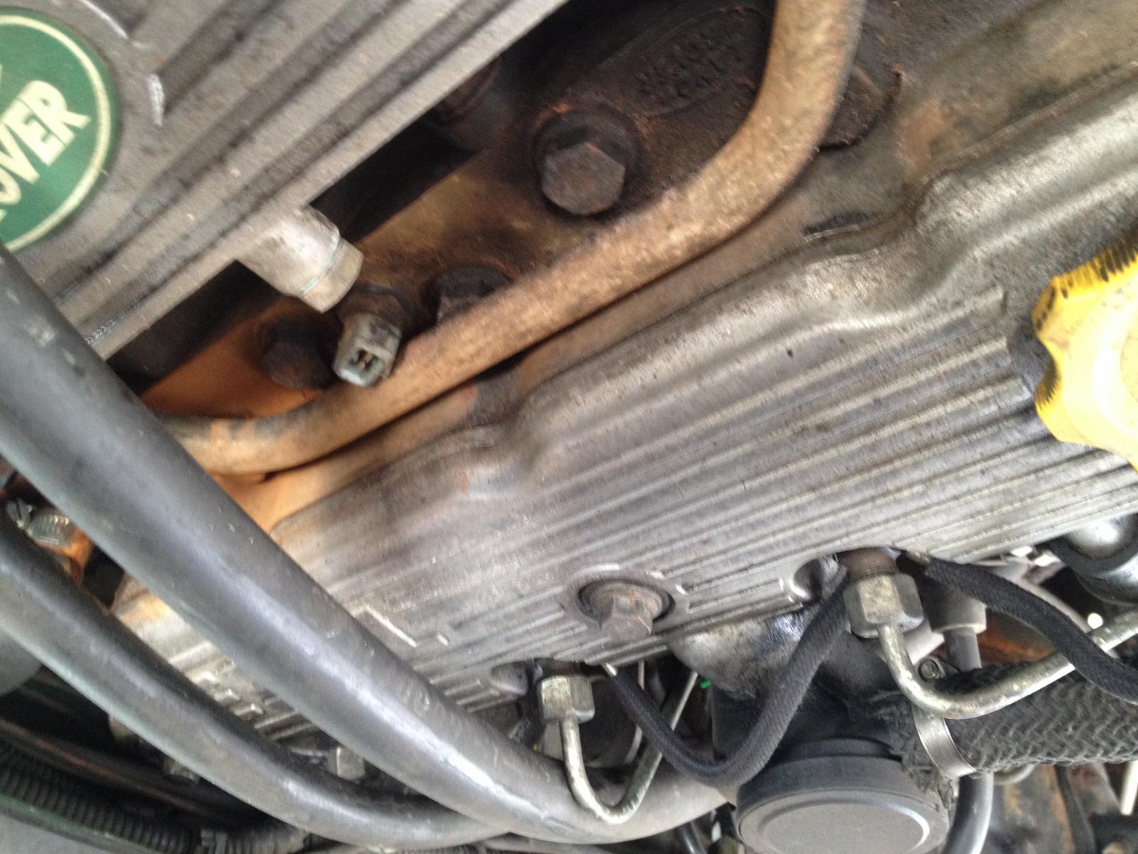

One possible issue I have noticed is a tiny amount of steam coming from under the grille after a run. Not sure if this is just water that has been splashed onto the engine by the wheels or if it's getting out somewhere. No apparent use of water or any signs of HGF, but this seems an odd place to have a rusty stain:
To my surprise, SWMBO likes it a lot, and even had a dream about it last night!

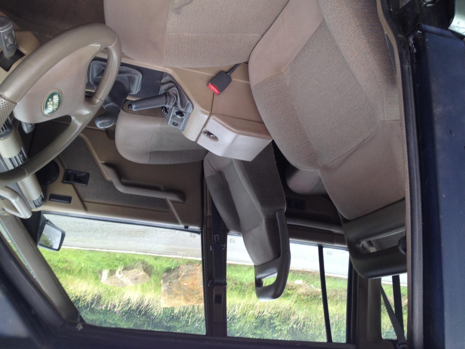

Nice one, that looks great! Check the base of the rad- they go crusty at the very bottom. I notice it has the cubby box between the seats- they're quite sought after nowadays! Is it a 7-seater?
