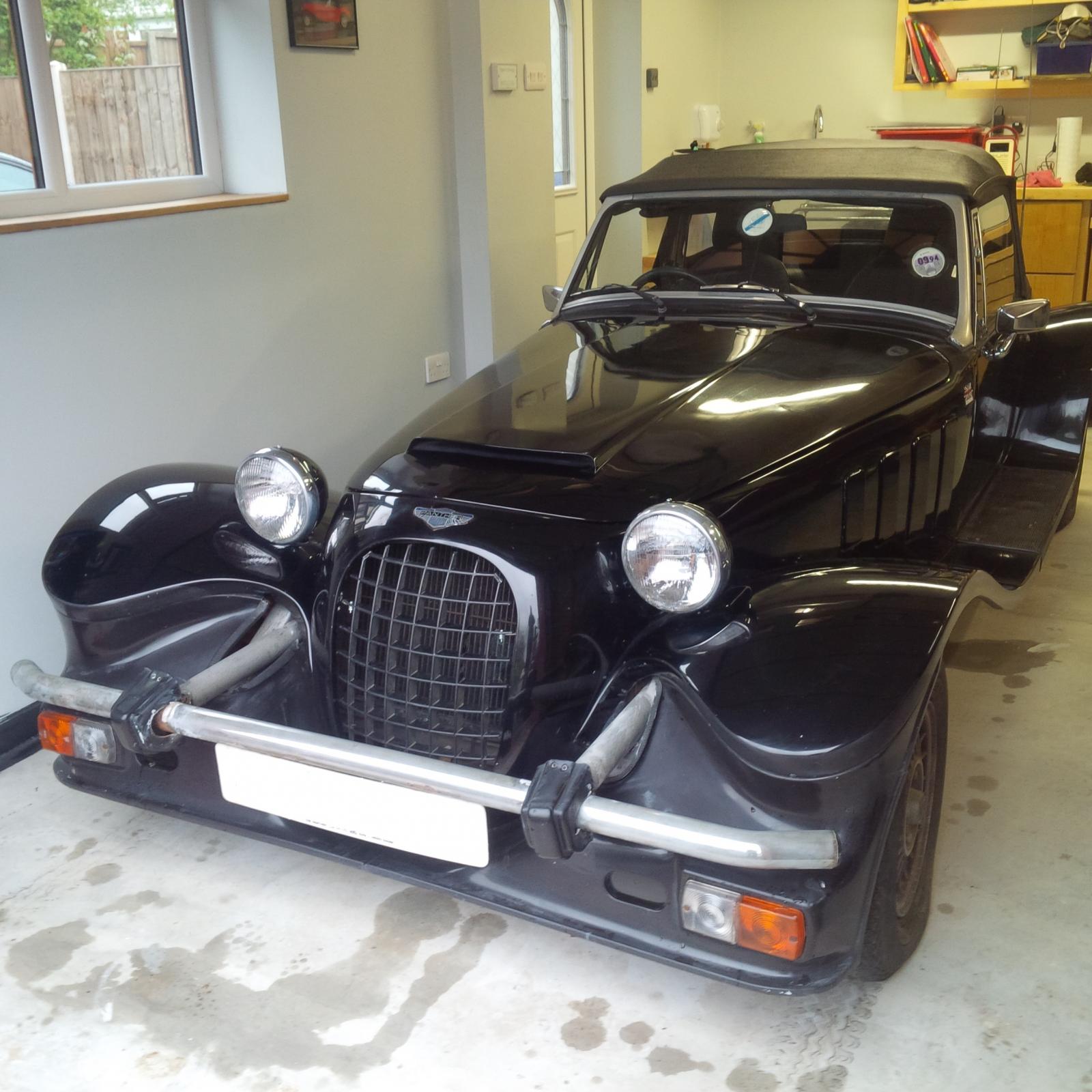

Panther Kallista, 1983 Y plate and has stood since the last MOT in 1994. Here are some more pics, well done Mr_Bo11ox!

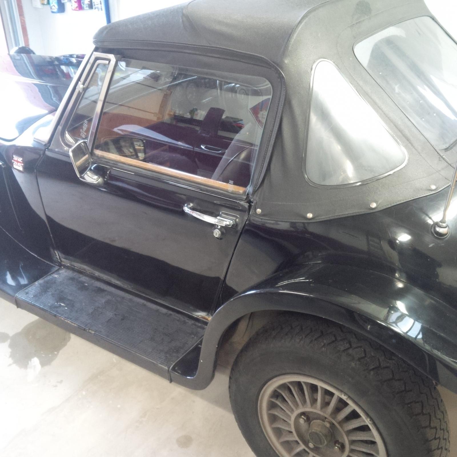

Managed to get this for just over a grand, it needs welding and door repairs (lower hinges have fractured). Engine has not started yet but i plan to drop some diesel down the bores before attempting to start it.
Full history file, including original build docs and bill-of-sale. Looking forward to getting stuck into this one!

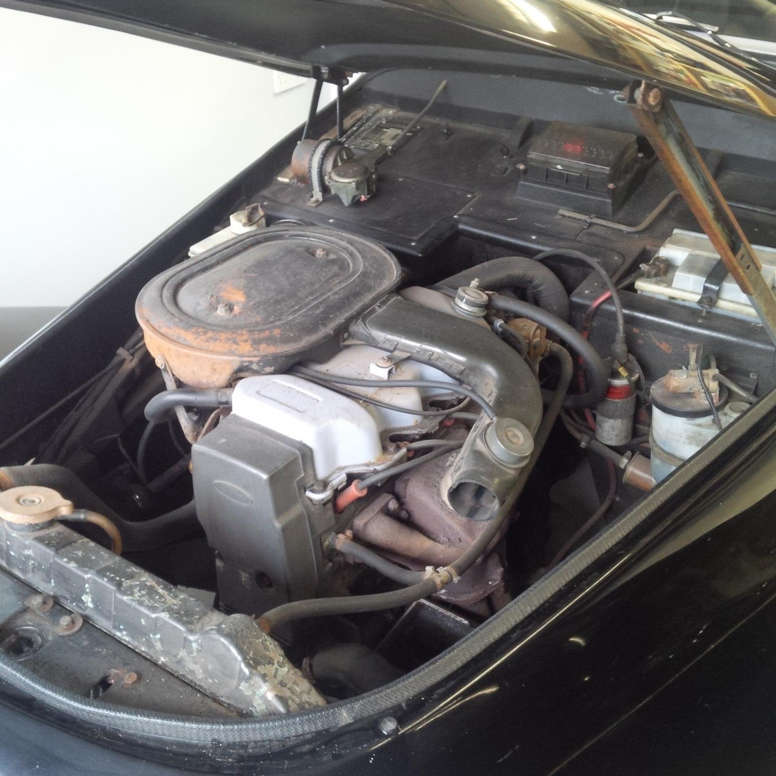

Looks great! Having just done the cambelt in my CVH escort the north south installation in the panther looks a lot easier to get around.
£1000 is a fuppin MEGABARG for one of these, you should be quids in. Think they look like a Lima but are completely different under the skin, are they a tubular steel chassis? The Limas had a Vauxhall Viva floorpan I think.
Chassis is steel-box space frame type, with tub and outer panels attached. Ford running gear and many other recognisable parts. Front doors are stretched Midget as is the screen frame.

That CVH looks totally wrong in that! Proper bargain though. Seeing the photos reminds me that i worked on a white one many years ago, I think i may have even driven it on the road, It must be something I've tried to block out of my memory.

Would throw a new cambelt in it before trying to fire it up as it's been dormant for so long. The CVH is one of the easiest to do especially as it's mounted conventionally.
A cambelt definitely and I'm expecting to strip the carb too, that 20 year old fuel tends to turn to powder and block things up.

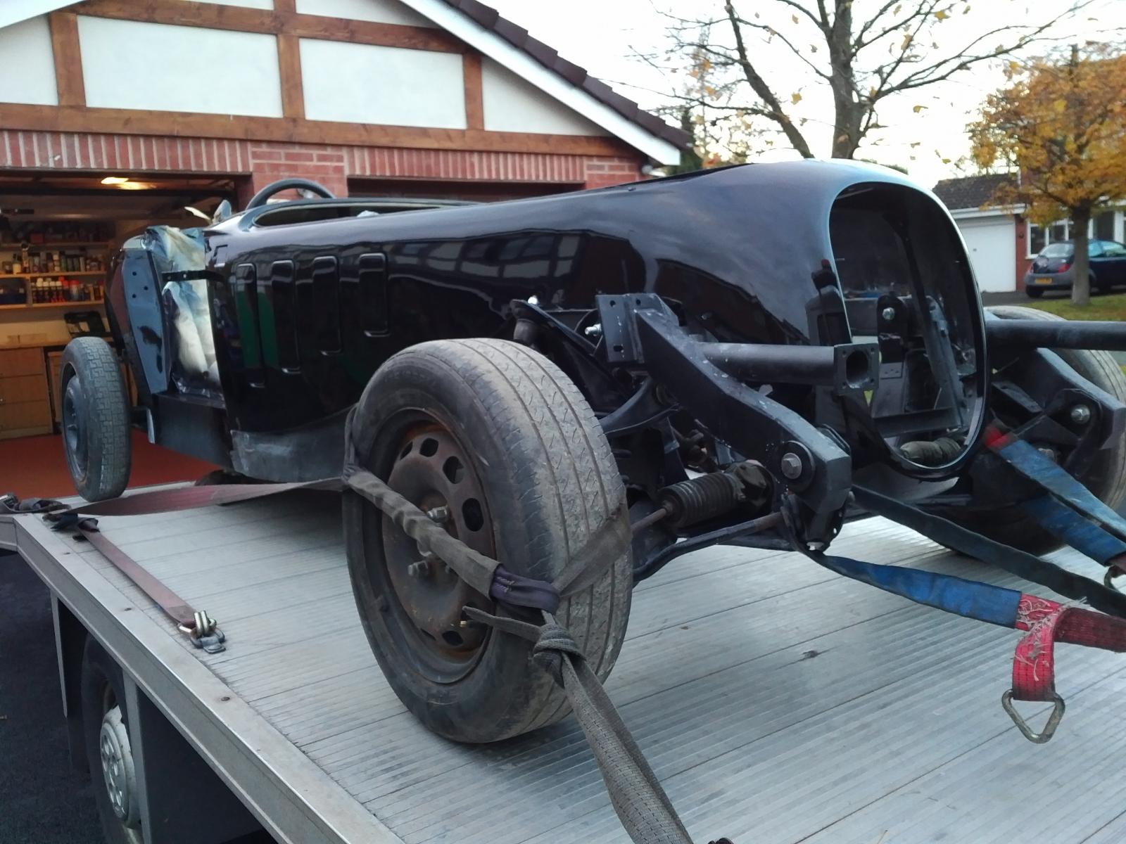

Work on this project has progressed at varying rates recently and I apologise for neglecting this thread, lacking updates. The chassis has been welded, door skins repaired (two MG Midget panels per door) and a nice paint job added in Ford Panther Black metallic.
The photos are self explanatory,

It has the XR3 CVH 1.6 with a DFT Weber. Head will be ported, polished on the exhausts and matched to the manifolds for optimum flow. A fast road cam and vernier pulley will also be fitted with a branch manifold.
I've overhauled the carb and polished the barrels, again improving air flow.
I will get the pistons out this week, bores look ok but I'm thinking boring out a couple of sizes will help. It won't set the world on fire but it should be good for an additional 20hp.
Those are a much better engine that everyone seems to remember. Trouble was they were one of the first to use modern thin oils & everyone just stuck thick stuff in. That made the hydraulic tappets collapse & then you had a rattly engine with no power.
