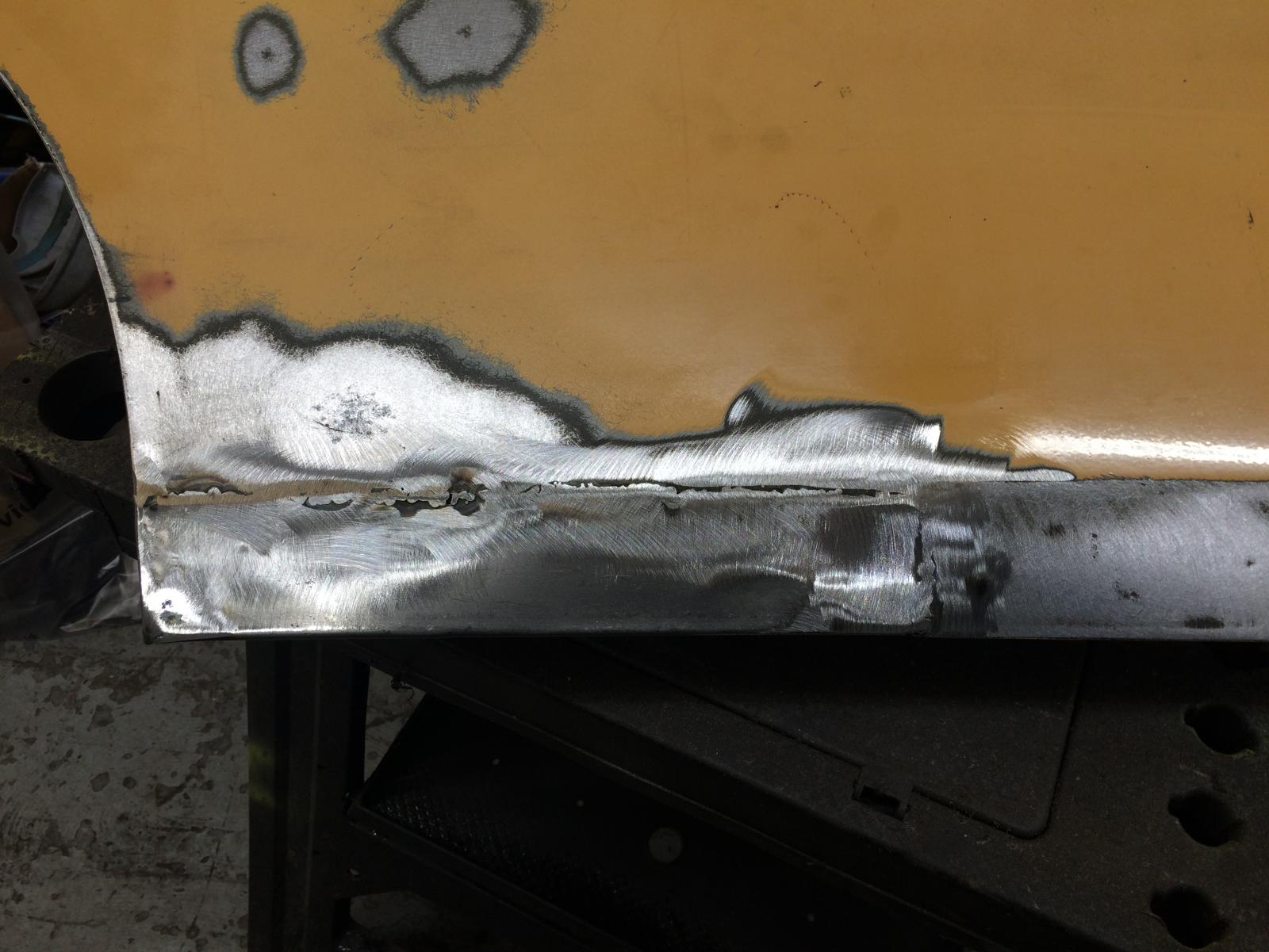

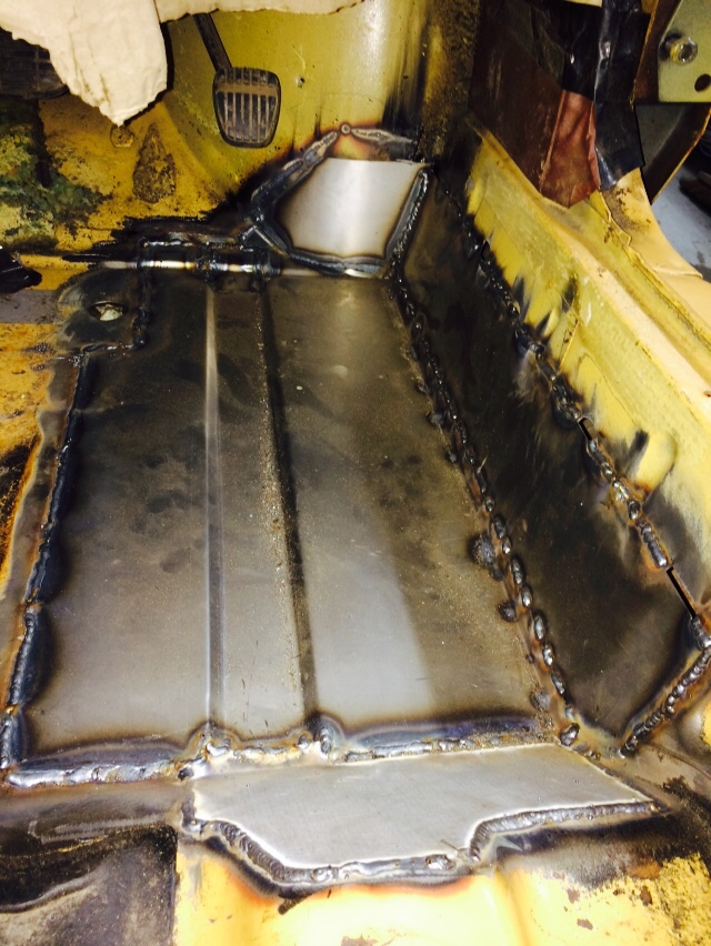

Another good days progress with GEOFF the welder who repaired the large hole in the drivers footwell, with repairs to the sills and all the other bits in that corner needing attention.

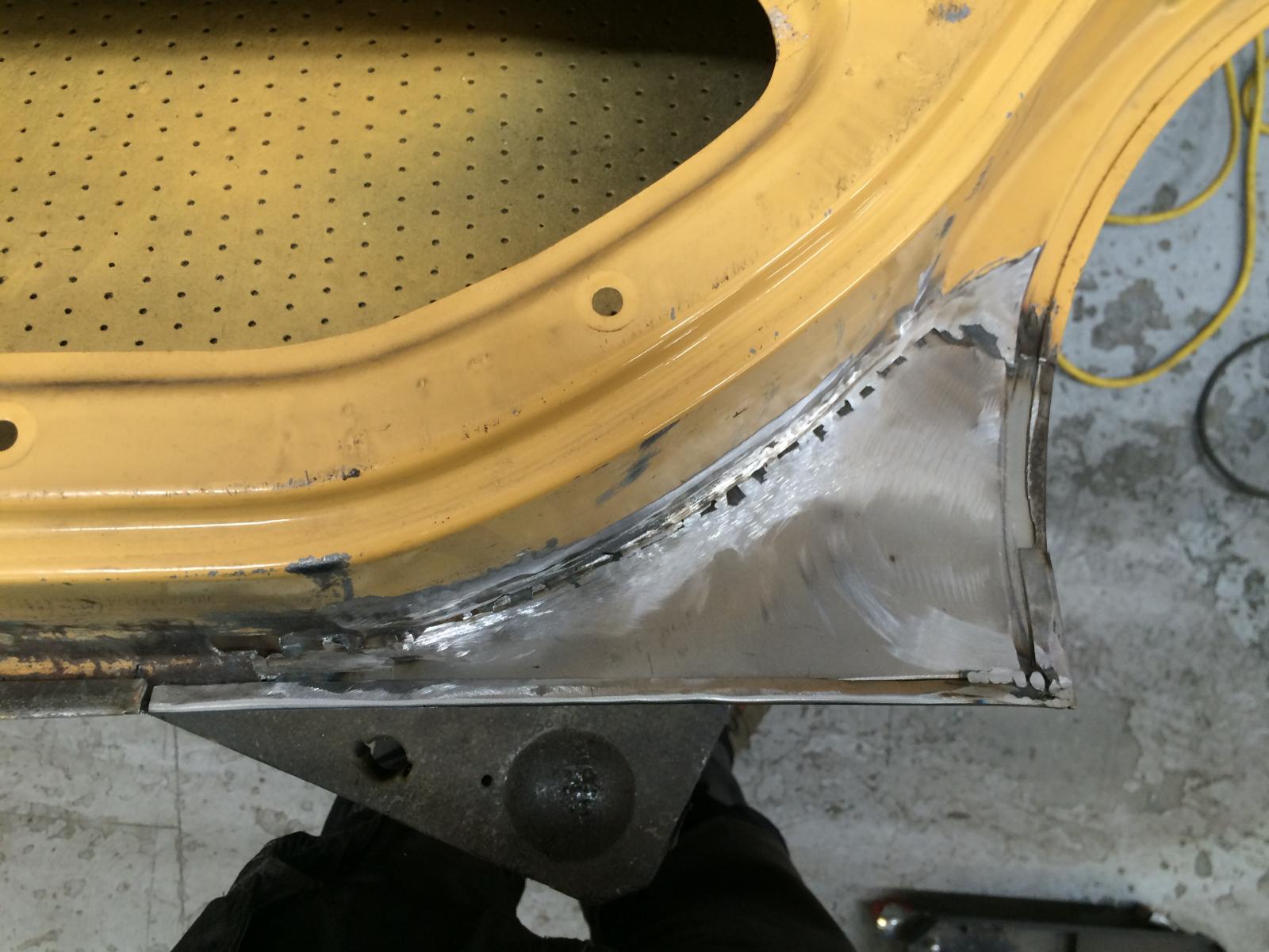

Instead of getting in his way pretending to help I decided to have a go at one of the rear doors, it took me all day but I managed it in the end it was a lot of faffing about but satisfying to have done it myself.
It's really good having a mate do this work as he is willing to teach me as we go and I really enjoy having a small part of the welding done myself.
Here's Geoffs new floorpan repairs.post-17756-0-61293300-1452714082_thumb.jpeg

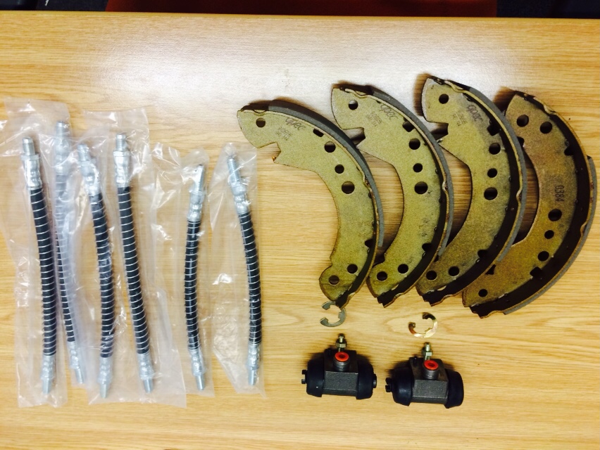

Some nice new brake parts turned up today.

Finally got the o/s rear door finished, not quite to Geoff's standard but you've got to learn somewhere.

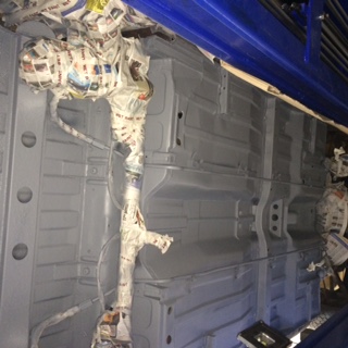

Got a lot done this weekend, cleaning and painting underneath with a rustproff paint prior to underselling it.
I like to scrape off all the old under seal even if it is a pain of a job to make sure everything is ok and the new paint sticks well as this will prevent more welding in the future.

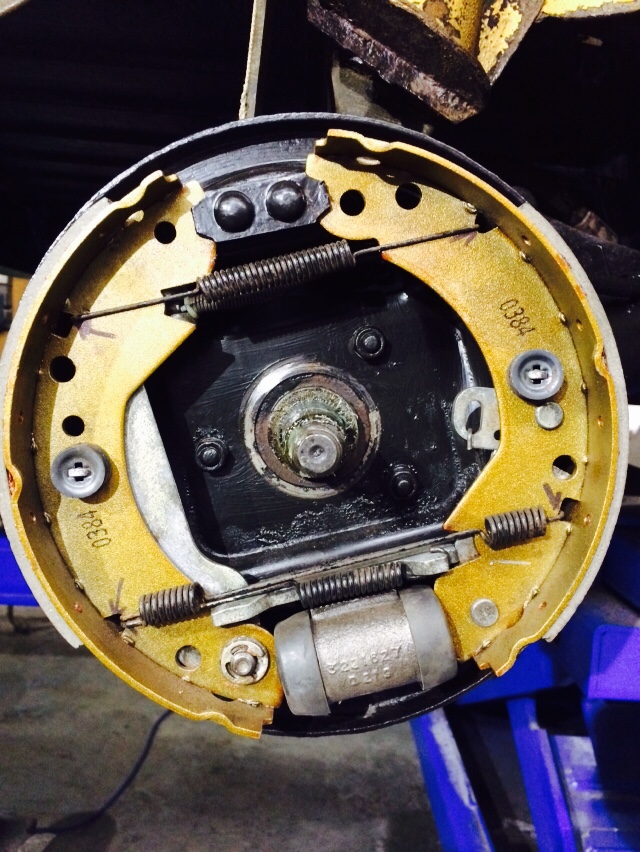

Even had time to rebuild one of the rear brakes after cleaning and painting the back plate a new rear cylinder and new shoes were fitted, the drum was in great condition with no wear just a small amount of surface rust to clean off after it has stood for many years. I have decided to renew the pipes as I have already removed them it won't take long to make some to to same shape and it's probably quicker than cleaning up the old pipes.

I have finally got the floors repairs completed and it has now been seam sealed and had 2 coats of zinc 182 applied, I shall wait a few days then the Schutz can go on before starting to rebuild the underneath with new brake pipes a refurbished fuel tank and a full new exhaust system.
It's starting to feel like progress is being made and the horrible job of cleaning underneath is now behind me.post-17756-0-61563900-1455045145_thumb.jpeg
Had a good weekend having applied the Schutz and repiped the rear brakes.

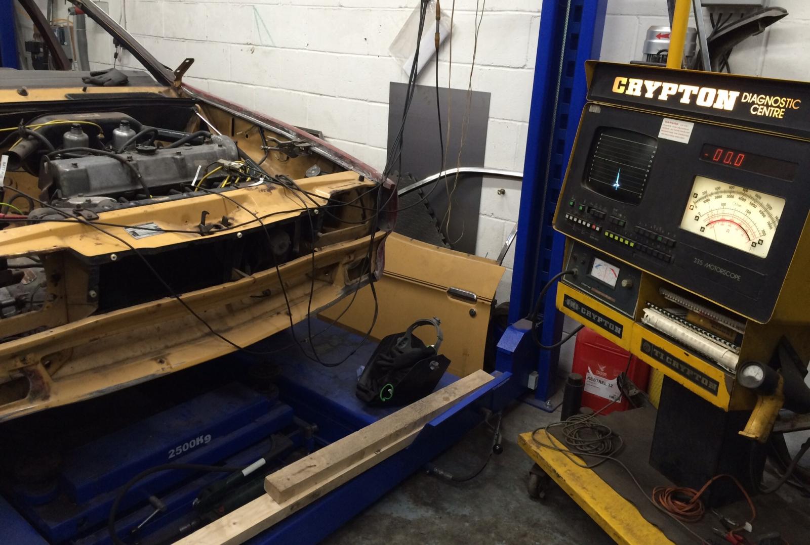

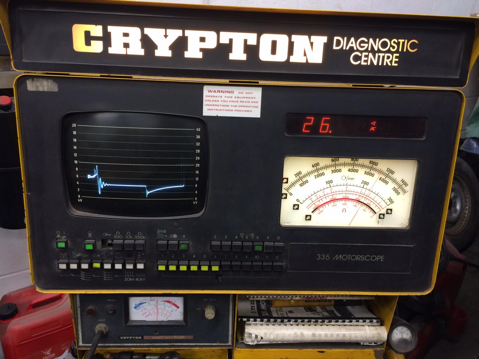

Time now to hook it up to my toolshite for a quick tune up.
Now we're talking, no OBD and laptop rubbish need apply!!

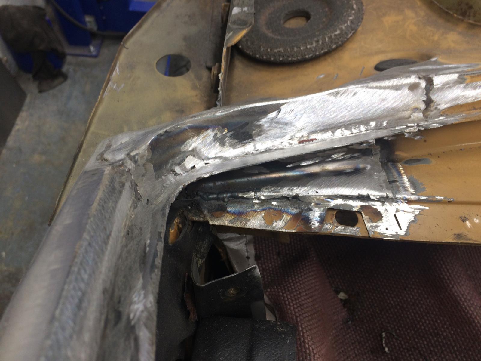

It's quite slow going with this car but we had another good day with my mate sorting out all the nasty rust around the windscreen and windscreen pillars. Not a lot to see for a full day's work but it was all fiddly stuff.
Whilst he was doing that I started bogging the previous welded areas so they are roughly in shape, probably now got a day or two welding left now.

A before and after shot of the welding

That is some of the nearest welding I have seen. Are you aiming for concours as it looks as if that's what you are going to get!
Geoffs welding and fabrication is excellent and this has been his trade for over 40 years now. I do want a solid car with all the rust cut out and dealt with now rather than it coming back later.
This will be far from concours though, I am aiming for a reliable daily driver in a very tidy but not perfect condition and have tried to give it the best chance of survival as it will be used all through winter.

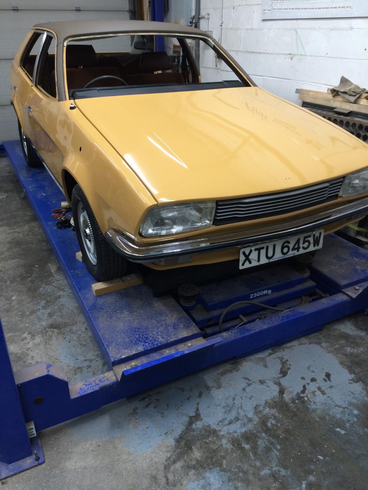

It's really coming together now the main shell has been painted and this weekend I painted the bonnet and boot.
My mate came round today and we fitted and aligned them but still have 4 doors to repair and paint.

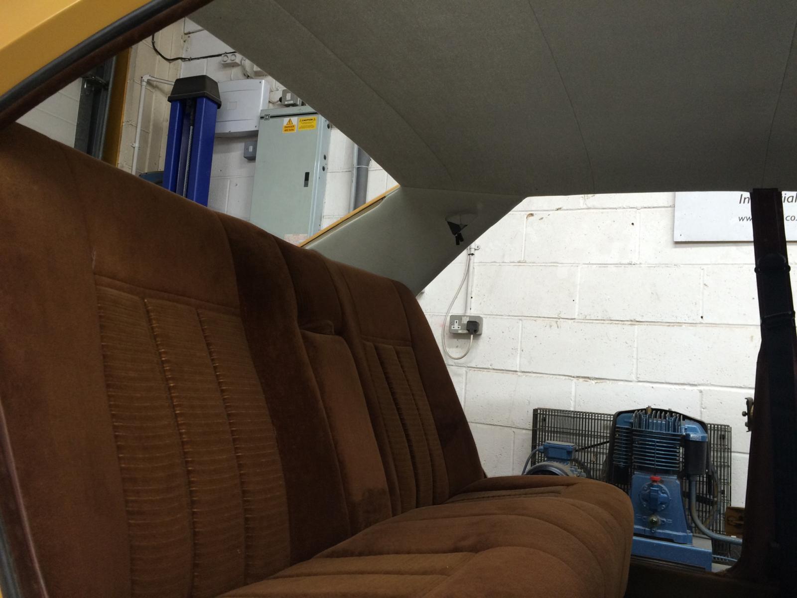

I went to the trim shop and bought some matching carpet so this will be tomorrow's job, just waiting for the trimmer to fit the new headlining and vinyl roof hopefully this week.
Trimmer turned up today and fitted the new headlining but will have to wait till next week for the vinyl roof.
I have been busy making new carpets this week and starting to refit the interior which can be finished now that the headlining is in so having fun adding lots of brown bits to the car.
  • Like 9
I have now got 2 doors painted and refitted, the trimmer came today and started on the vinyl roof but was short of material to finish the rear quarter panels so I'm still waiting to book the glass fitter for the screens.
Lots of other little bits and pieces also finished and I hope to start on the last two doors tomorrow.
