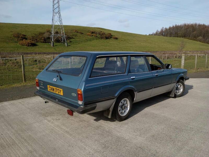

DodgyBastard Posted March 17, 2022 Author Posted March 17, 2022 Weighed in some batteries and a cat, the cat was from the Suzuki samurai and I got £100 for it. I got £83 for the batteries. With my winnings I visited the scrapyard and bought a pair of good batteries for £25 each. Mot prep for the cortina involved buying a battery and fitting it. I will just wait and see how it does at the test. It does seem to be pulling left when braking, I can't tell whether it's brake or suspension related. I have another car meet arranged for Sunday morning in Kinross, if by some miracle the cortina passes I'll go in that but if not it'll be the 505. Mrs6C, Coprolalia, rainagain and 4 others 7
Shite Ron Posted March 17, 2022 Posted March 17, 2022 I would guess that the pulling to the left is a sticking R/H caliper, work the piston in and out using a pry bar may free it. It was a common issue 30 years ago when I used to buy and sell mk5’s..

DodgyBastard Posted March 18, 2022 Author Posted March 18, 2022 4 minutes ago, captain_70s said: Only just noticed the 'Tina is a 1.6, must be... Leisurely. Certainly looks smart. It goes quite well, certainly not the fastest thing in the world. It feels a lot smoother and quicker than the purple Cortina with an alleged "tuned" 2.0 pinto but that's probably down to it being looked after properly. It's in decent enough condition overall and solid underneath but does have various bits of filler and weld repairs on the sills which I only really noticed when looking at on the ramp. I paid £2800 for it which seems about right for the condition of it. Shite Ron, TrabbieRonnie, The Moog and 1 other 4
DodgyBastard Posted March 18, 2022 Author Posted March 18, 2022 Oh dear. fucked the sump while parking at the MOT. rainagain, Dyslexic Viking, rob88h and 16 others 19
captain_70s Posted March 18, 2022 Posted March 18, 2022 Ground doesn't even look that uneven. Wouldn't have these problems in an Africa spec Pug...
DodgyBastard Posted March 18, 2022 Author Posted March 18, 2022 Metal bollard. wesacosa, Mrs6C, AnnoyingPentium and 2 others 5
mk2_craig Posted March 18, 2022 Posted March 18, 2022 Ahhh fuck. Easily fixed though, just hammer a smaller engine over it. 1.3 will be fine, then do the Lands End to John O Groats run in both style and comfort. timolloyd 1
juular Posted March 18, 2022 Posted March 18, 2022 2 hours ago, DodgyBastard said: Metal bollard. Did you stop the engine in time?
DodgyBastard Posted March 18, 2022 Author Posted March 18, 2022 Stopped the engine straight away, I welded a small plate over the hole and filled up the oil. Seems to be running fine. Wibble, alf892, wuvvum and 23 others 26
