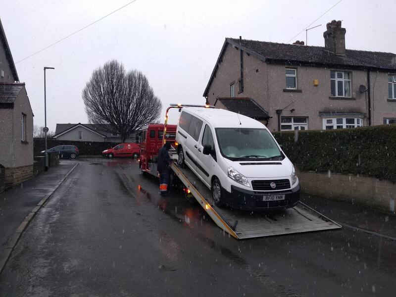

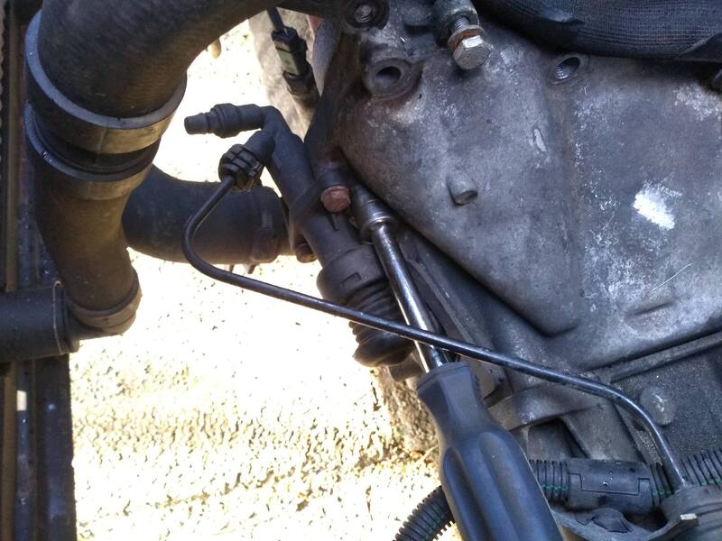

It did blot it's copy book last week and I had to actually lift a spanner for once.
On a day when I was planning to pedal to work I had a parcel to drop off so drove up the road to do so. Got back in and no start nothing, not even a click or try. Bridged the terminals on the starter and it started, but the starter stayed engaged. So I cut the battery and called Autoaid.
Once lifted home I whipped the starter off to have a look. I had noticed that it looked new when inspecting it after purchase.
Access was OK down the front of the engine, just one bolt was a bit of a squeeze next to the clutch slave.
I got the starter off and bench tested it, it was fine. Looked new as I said and it had a sticker on suggesting it was a refurb fitted in 2017. Put it back on and replaced a blown fuse for it and it was all fine.
Fixed for £0 and half a day off work. I was tempted to tear down the starter and clean and grease some shit, will save that for if it continues playing up and sticking.

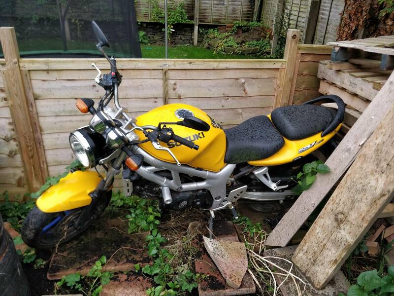

I took the carbs off a while ago to try and fix the chokes but never finished the job. One of the retaining bolts for the choke snapped off and I made a poor job of drilling it out.
I did offer it up on here but understandably didn't get much interest as a non-runner. I have now bodged the carbs back together and got it running again, it's booked in for MOT on Friday.

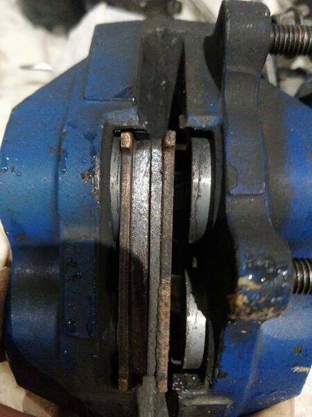

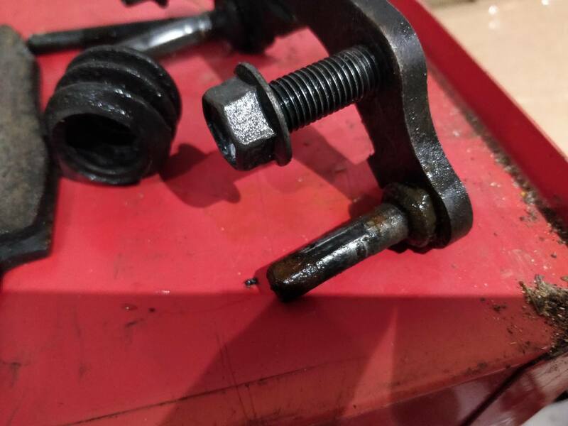

Brakes now temporarily sorted on the SV.
The rubber boot things on the sliders are not in the best state, 2 of them are ripped and not keeping water out and the other 2 are a bit baggy as some idiot (ie me) cleaned them in petrol last time and they swelled up.
So I just cleaned them all up and greased them for now, hopefully that will be good enough for test but I'll order some bits and redo it properly.
Rear brake was a bit easier, I just ragged it on the stand and did some braking and it seemed to free off fine.

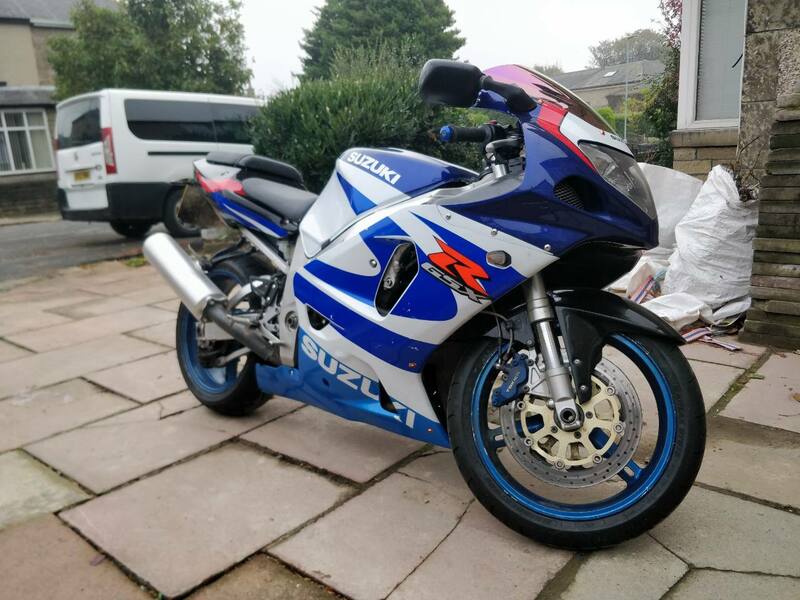

Anyway what did I win?

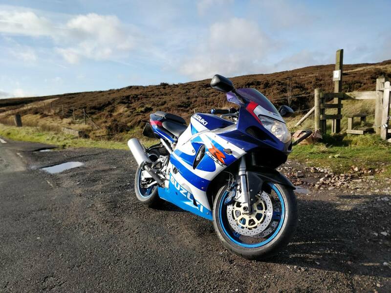

Look at it man! It's a blue and white GSXR in 750 flava. My mind is basically stuck at the age of approx 19 which happens to be roughly when this thing was new, and I'm slightly amazed I can buy and insure it for such reasonable prices.
It has the obligatory tiny indicators, hack job "tail tidy" and double bubble screen, and the top yoke has been drilled for a bar conversion. Other than that it's standard even down to the original end can.

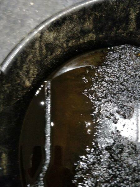

I had messaged him about the running fault and done some research, I thought it was probably the fuel pump. Had a quick diagnose when I got it back.

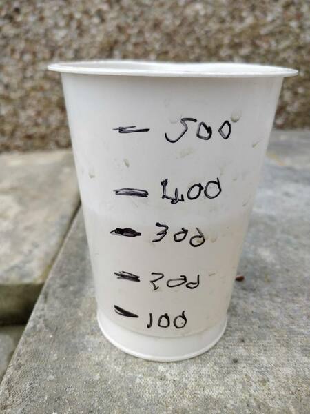

First, I prepared the dealer grade diagnostic equipment using a measuring jug and an old pot noodle.

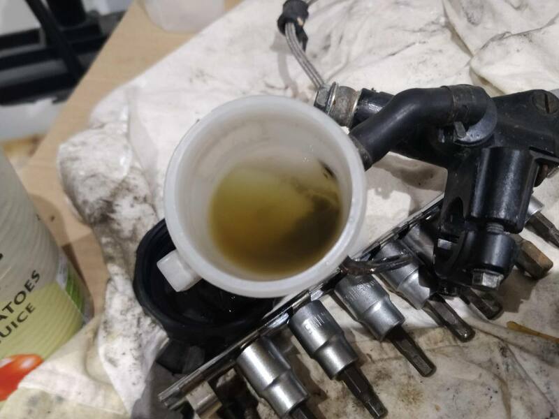

The manual says the fuel pump should flow 1200ml in 30 seconds. Due to the size of my receptacle I ran it for 10 seconds and got about 300ml:
Deffo a bit short as should be minimum 400ml in 10sec. The fuel that came out didn't look too clever either:
Also seemed to leave a bit of sediment, not sure if that shows up on the picture.

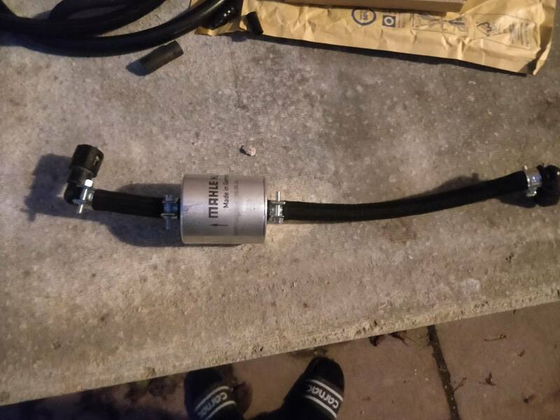

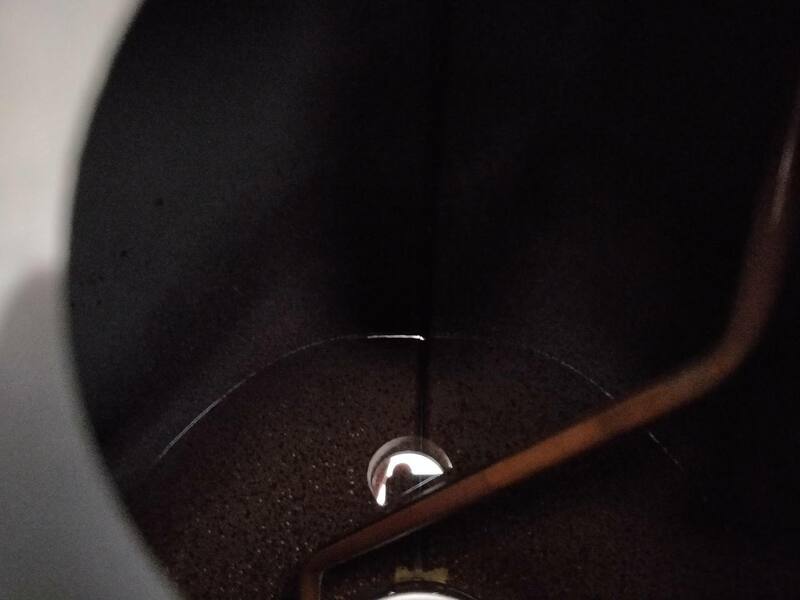

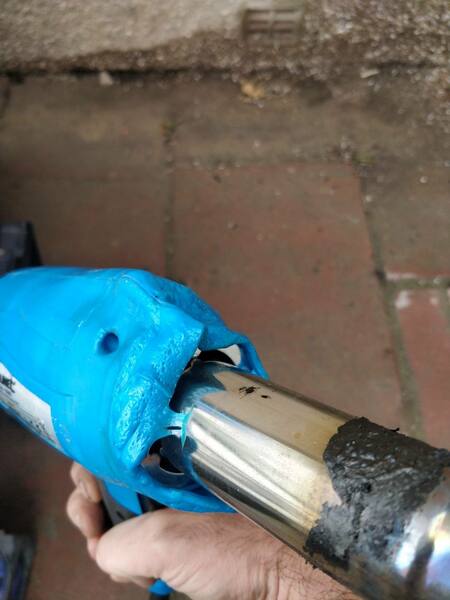

Pulled the fuel pump assembly, tank doesn't look too bad inside and the pez looks fairly clear compared to the stuff that came out the pump:
So loads of Suzukis of this era use the same fuel pump assembly. In what is either a blindingly stupid idea or a clever way to make lots of money on parts, the fuel filter is combined in the pump/pressure regulator assembly in the tank. This mutha is only available as a full assembly for about £350! Number 2 in this picture.
Obviously this means the filter never gets changed and leads to the pump failing due to having to overcome the restriction of the clagged up filter.
Spending this much on the bike was never in the plan but luckily some clever people on the internet came up with a workaround.

In short by drilling a hole in the right place in the filter outlet you can bypass the built in filter and use an external one which you can, y'know, replace occasionally.
I did this and cleaned out the housing as best I could with brake cleaner, rather a lot of skanky brown smeg came out:
Hopefully this means my new pump will last more than 5 mins.
I am still waiting on some hose to arrive to finish the job off but I did manage to get the pump assembly back together and back in the bike.
Will get some hose tomorrow one way or another and will see if warp speed has been restored when I ride it to MOT on Thursday.

It's only gone and passed. DEPLOY MOORS PICTURES.
Slightly along the road from here there is a little car park that used to be the one for this picture with the little lake in the background, but they've blocked it off with concrete blocks and big gravel.
Here is my external fuel filter, it's nice and small and I managed to squeeze it in under the tank so the lines aren't loads longer.
The fix definitely worked, I am too scared/sensible to redline the bike on the road but I got to 10krpm and no issues.
There is a little stumble/hiccup about 2-4krpm which is annoying as that is where you are riding in traffic, did seem to get a bit better as I rode so will see how it goes, may need to clean the injectors too.

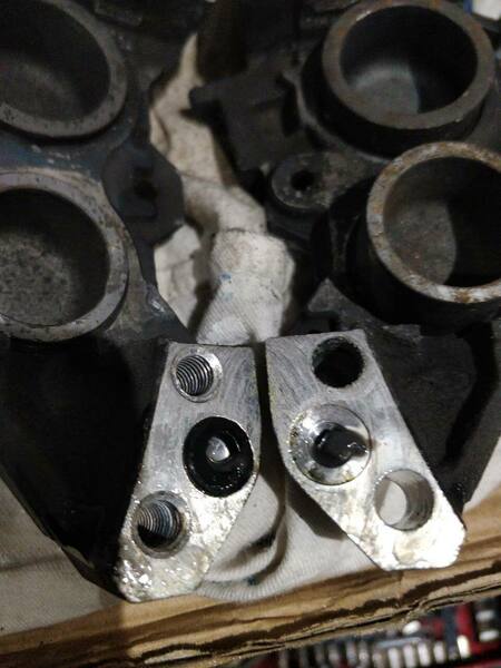

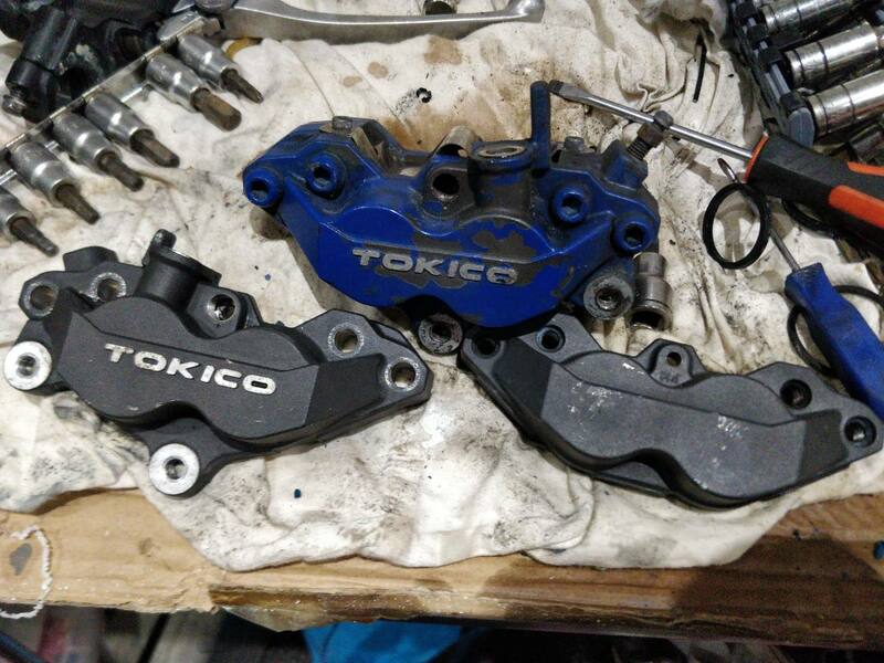

I wasn't impressed with the brakes on this thing, the MOT tester mentioned it too. They were good enough to pass but felt terrible, with a pronounced kind of pulsing, not high enough frequency for a warped disc but maybe sticky pistons.
Pulled them off and had a look. First thing: pad wear seemed quite uneven on both sides.
The reservoir looked nice*
Split the caliper halves to find there was a sort of grey slime in the bottom port? Algae or something?
Anyway they had also been badly painted blue so once they were stripped the first job was a once over with thinners to get them back to factory* finish:
I did order some new seals but ended up reusing the originals as they were all OK.
The finished article:
I also upgraded the master cylinder to a modern radial jobber, you can spend £200+ on a billet Brembo item but this is AS so mine is a £45 second hand part off a 1000RR Fireblade.
Went on OK with just a tweak to the reservoir bracket and a new bit of hose.
Got it all fitted and bled up today and feels awesome at pushing speed on the drive, will get out on the road to try the next time it's not soggy and miserable.
