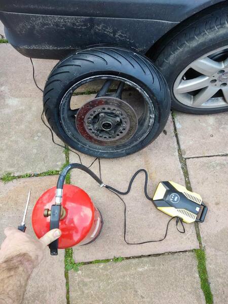

Right been a week or two, managed a few bits.
TMax is MOTd, the tyres turned up from Demon Tweeks 1 day outside the retest period, cheers cunts. I spent ages trawling through their site and the best I could find was 1 tyre in stock that day and another that was coming into stock the next day. Ordered and they emailed the day after with a stock update that the next day tyre was now a week away and it still wasn't sent till a day or 3 after that. From the state of the stock on their website (order now - in stock in 60 days) I reckon this is more supply chain kaos than them being shit. Still annoying.
I did the tyres myself which called for my DIY compressed air tank setup:

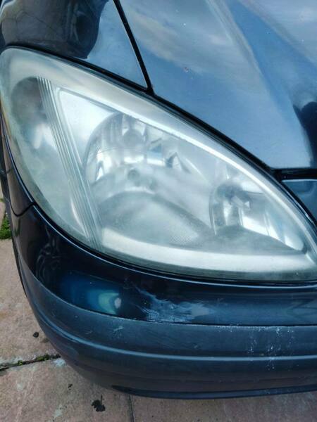

Fitted an android double DIN jobber with a reverse camera hidden in the boot handle. Pretty chuffed with the installation, that bezel between the stereo and the DIN surround I designed and 3D printed. Also fitted a gearknob and gaiter and a sew on leather wheel cover. While I was faffing with the gearknob I replaced a plastic bush on the lever that was a bit floppy and reset the cables. When I got it 5th and 6th were barely achievable, and when I first put the bush in 1st and second weren't where they should be, there is a stop for 1/2 that's part of the lever. Adjusting the side to side cable to put 1/2 back in the right place made 5th and 6th much better, I assume it was adjusted to get 1st with the play in the lever. Very satisfying fix for the £4.something the bush cost.
The headlights were translucent at best so I tried some cutting compound + autosol. Its made an improvement but there is still some clouding, having watched some videos I think I need to go back and start with 1500 grit and work my way back up.
B4:
After:
