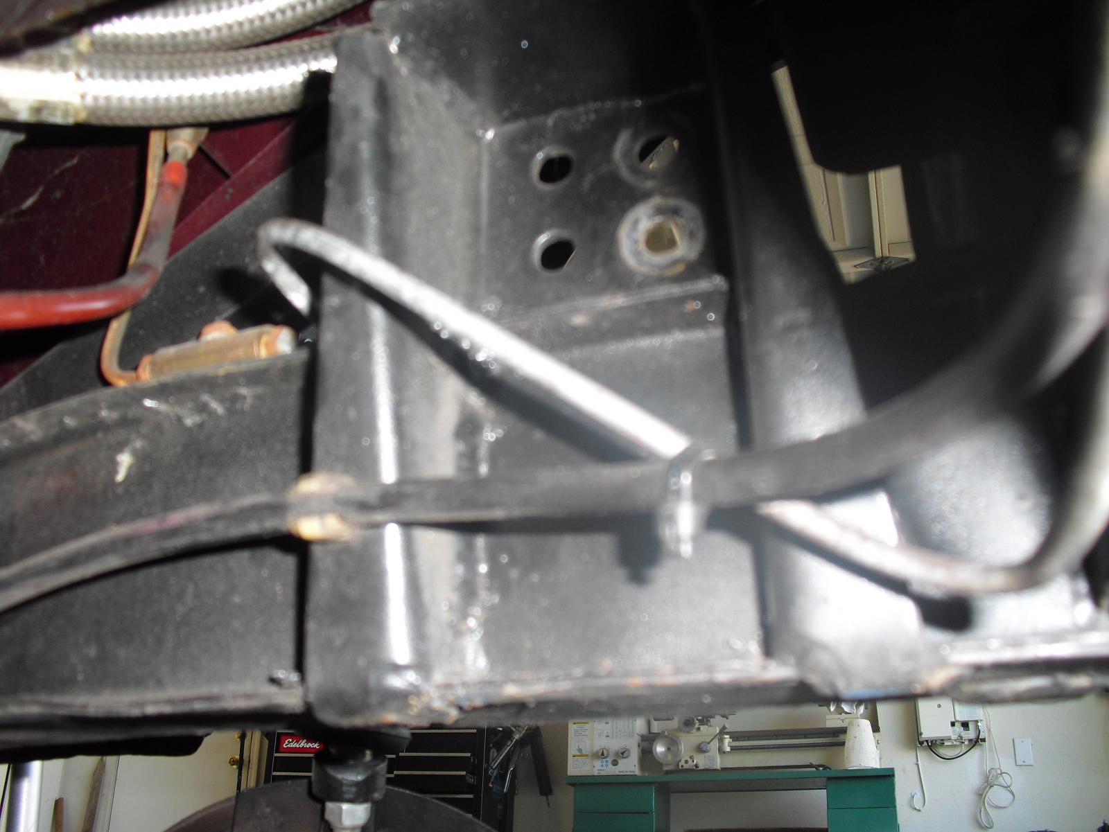

A bit of an update, this proved to be a bit too much for SWMBO, so I've been using it as my daily driver on and off for the last 12 months or so. A couple of days ago the left front started to rub on full lock, immediate investigation started.
Hmmm, this don't look right for starters.
At first I thought top or bottom joint, or a knackered bushing, but after much prying and rocking I couldn't find any play. Time to look elsewhere, then I spotted this.
Bent and torn wishbone mounting bracket. I suppose this is what happens when you drive a 45 year old car like a hooligan. It's an engine out job, then some grinding and weld a new bracket on. I'm not dragging a load of gear back home to do this in the garage, so off to the workshop it goes.

Erm which bit am I supposed  to be looking at - it's like where's waldo to me. Circles and arrows and a paragraph on the back of the pictures. As specified by Arlow Guthrie in Alice's Restaurant. Please. :)
 Right in center of pic above braded hose, where you will just see one of two attaching studs in the middle of two brackets............that gap is the result of fractured metal.

I'm still not sure I can see it. Is it at the top of the upside down U bracket or to the left of that, the bit with the bolt through it that we can see the nut on? Anyway, good luck with the welding. I've always liked the TR4 through TR6  models. I guess yours is TR$.

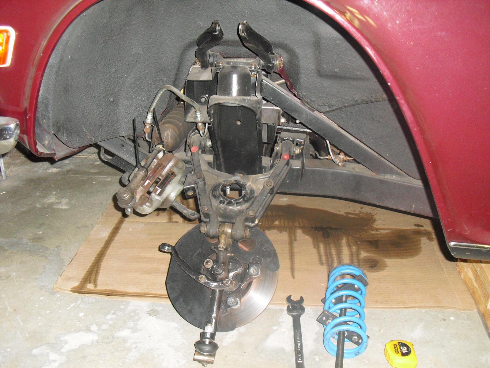

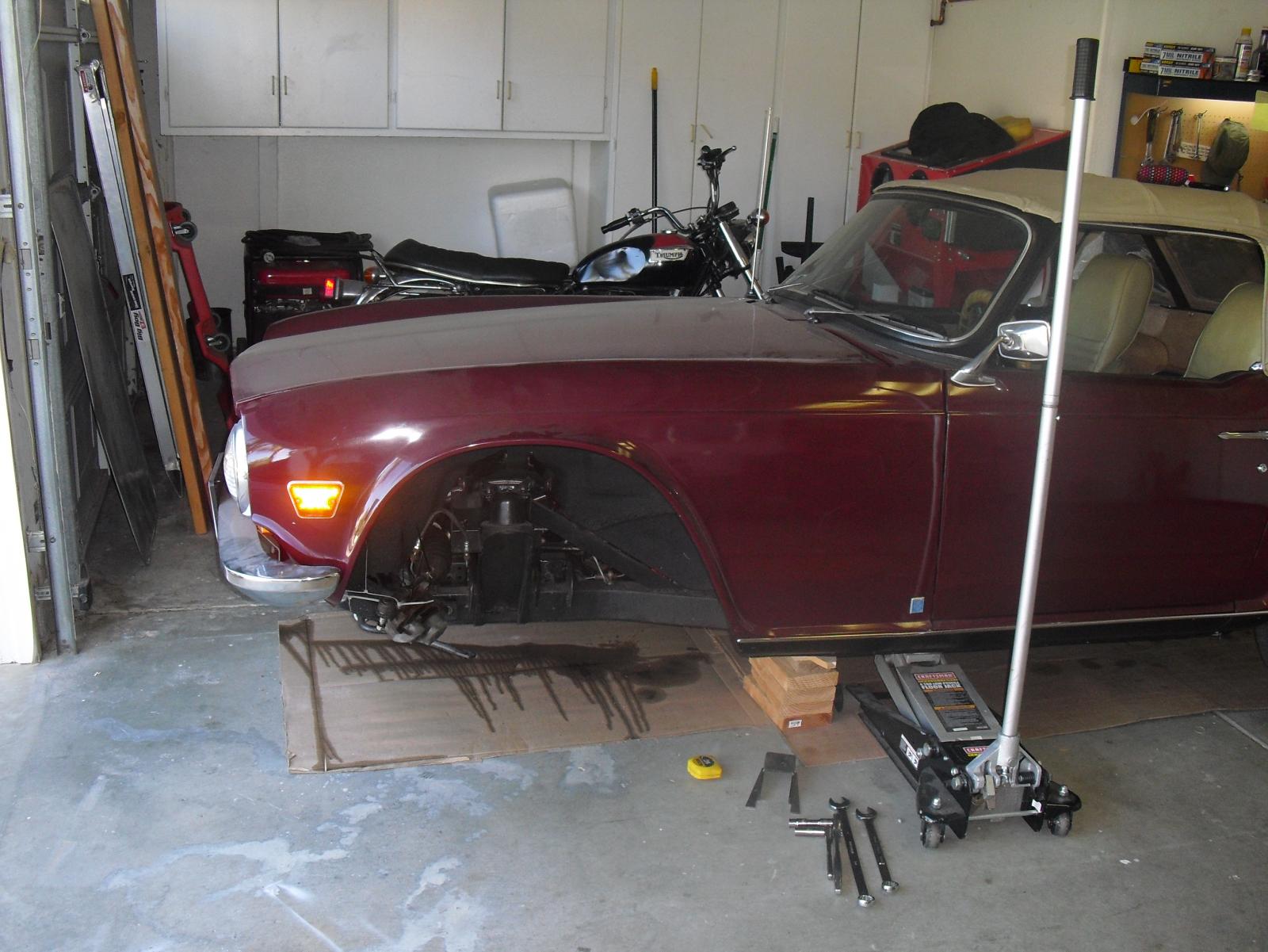

Well I never did find time to get this in the shop and fix it, so after a couple of weeks outside in the desert sun I took it back home and shoved it in the garage under the "things to do" list.
That was months ago, she says I'd better get on with it or else........So here we go.

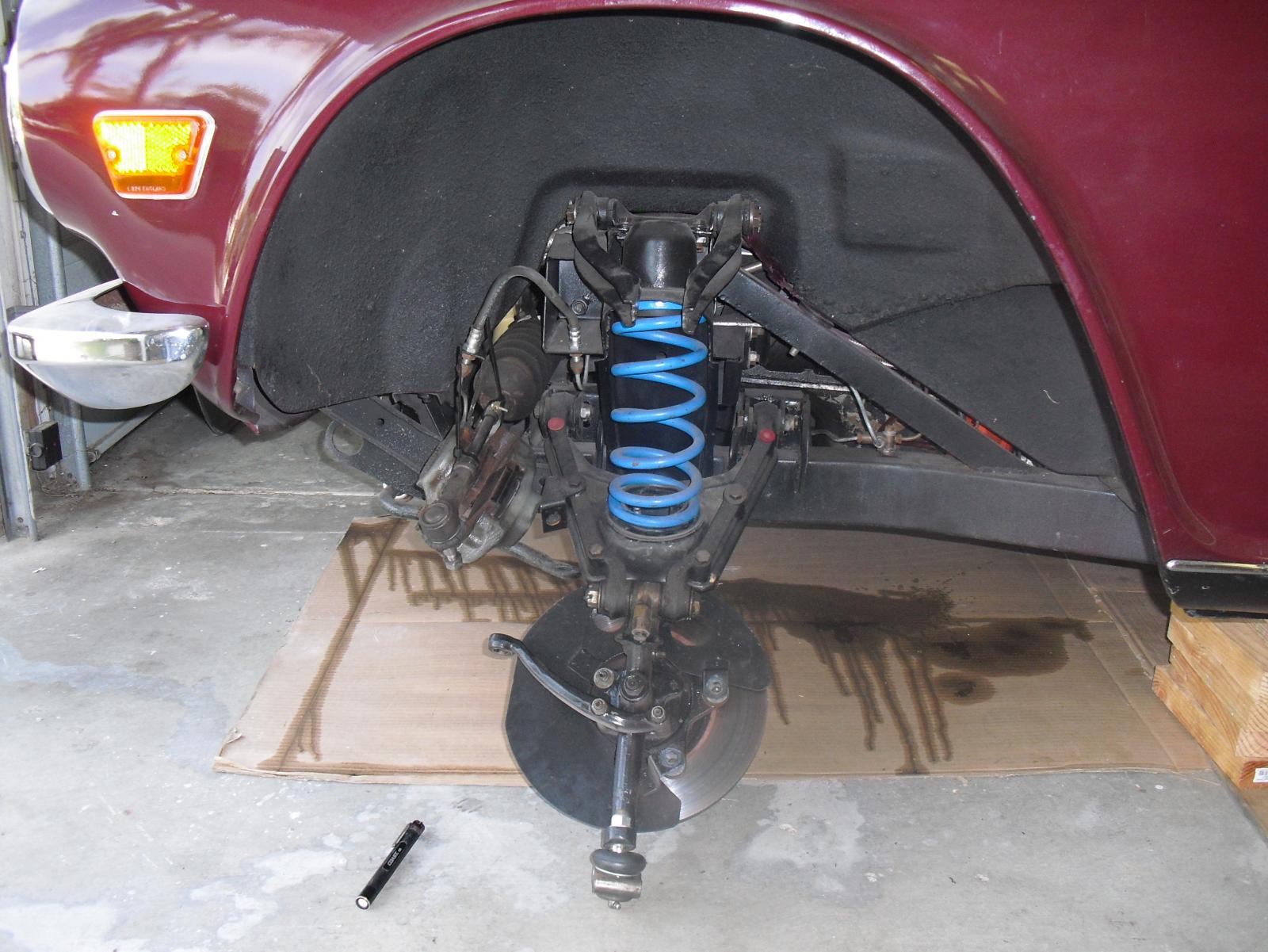

My spring compressor is far too big for this, but I can use its screw and make a couple of clamp plates.
Remove bottom wish bone
This is the problem, can't see it in the pick but the bracket is all fractured on top and between the holes

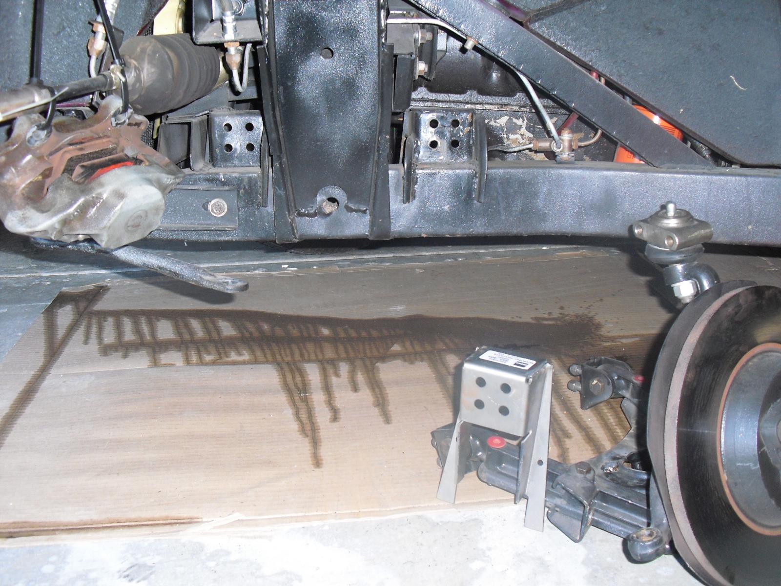

New bracket purchased.
Rear view.
