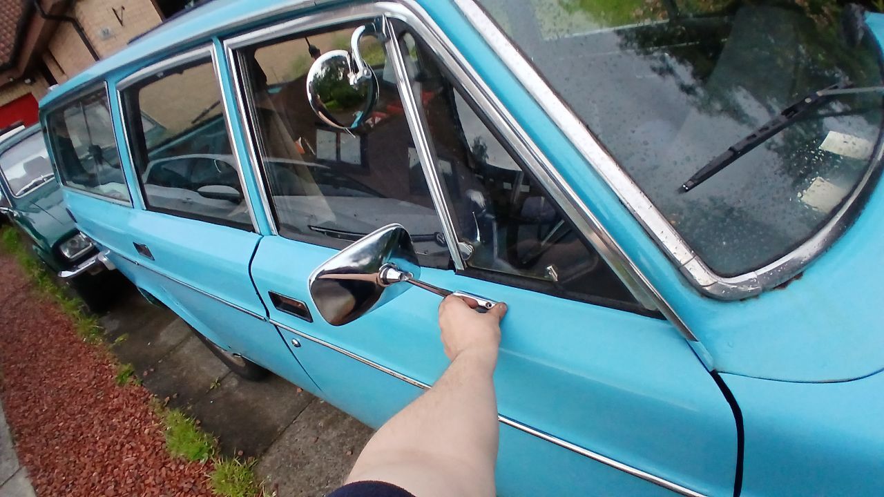

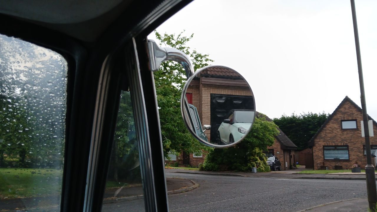

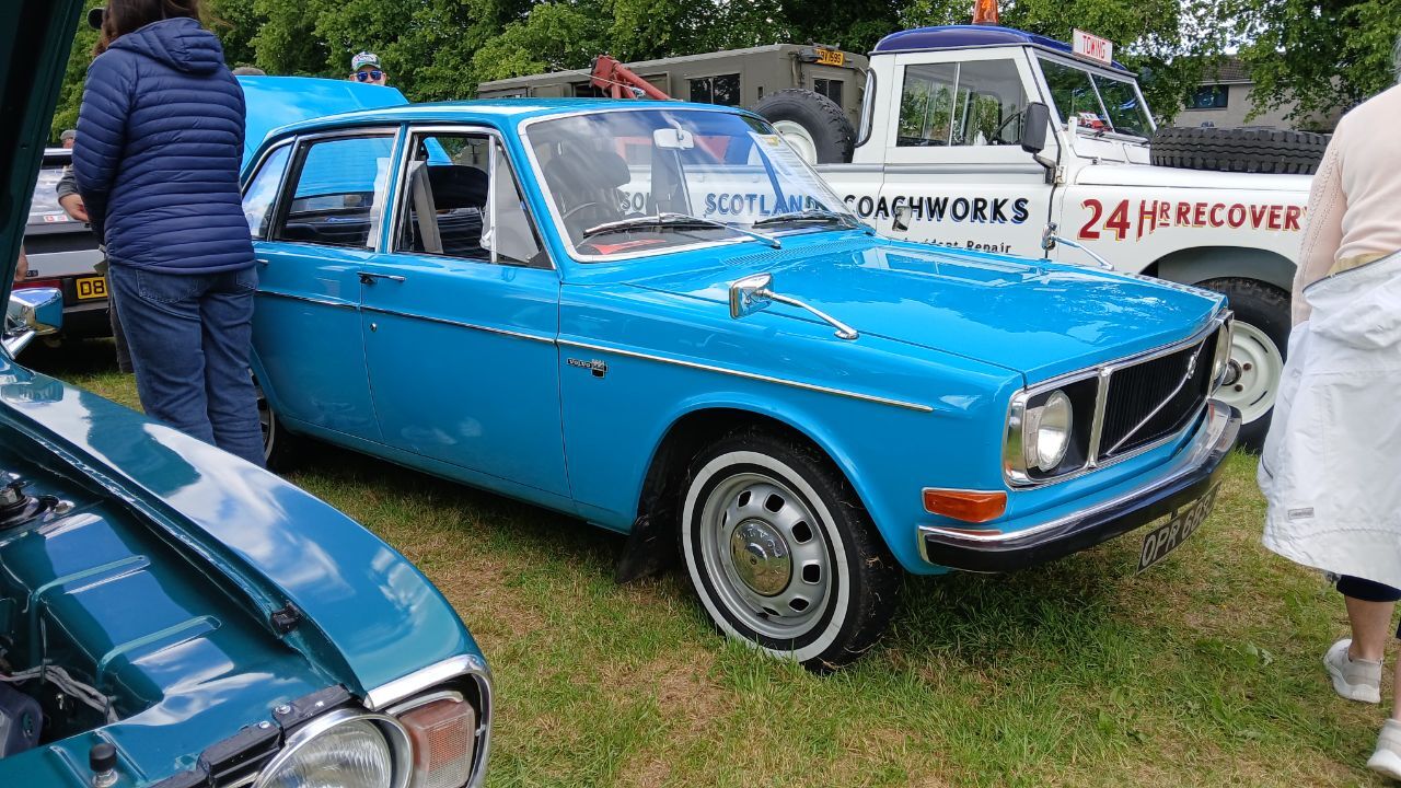

Trying to decide if door mirrors are worth the hassle...
The wing mirrors actually have a wider field of vision and I like being able to see them while looking dead ahead...
I think door mirrors look better on this age of car, but then I'd have to fill the holes in the wings etc...
They did polish up alright...
I'd quite like to assemble the correct 1972 De-Lux grille. I don't mind the earlier style but seeing it with the newer flush fitting door handles winds me up. 😂

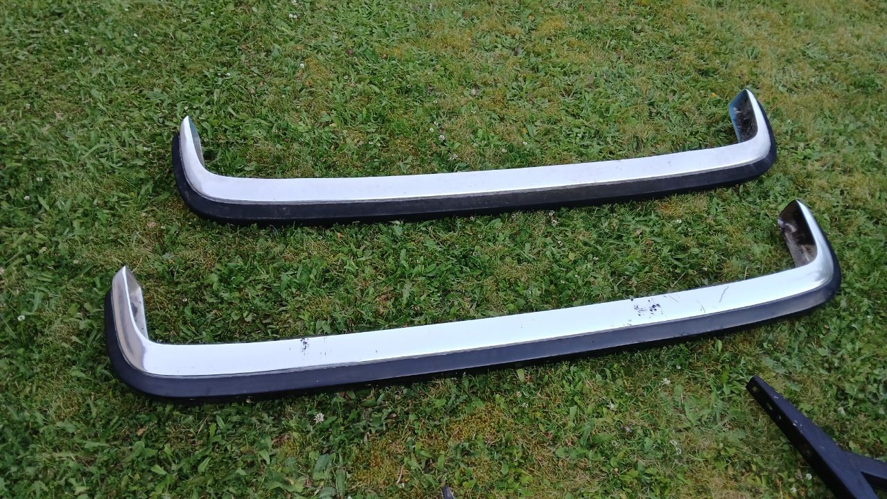

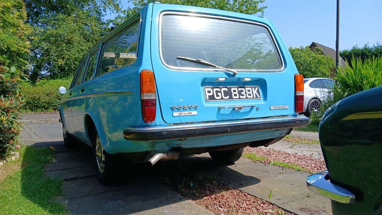

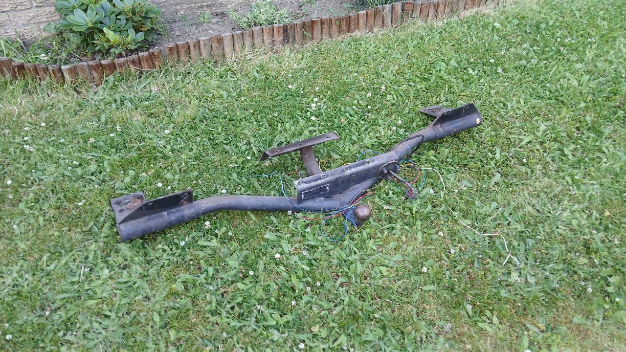

Decided to remove the shin basher, as I'm not going to be towing anything with a 80bhp auto...
6 bolts through a plate on the inside of the boot floor, 4 through the spare wheel/storage tubs either side, 4 through the bottom of the bumper and 2 shared with the bumper mounts.
Only the ones into the bumper were a pain to get to, as the nuts are inside it. They were also all different sizes. Nylock nuts used throughout.
The main issue was the bolts shared with the bumper mounts. All of the towbar fittings were metric, and those bolts were no exception. They go in to captive nuts behind the rear valance. Volvo didn't switch over to metric until the 200 series came out in 1974...
Yes, the (massively overly long) 17mm metric bolts had been effectively cross threaded into the imperial nuts, presumably with a impact gun.
What felt like a billion years later with a breaker bar, lying on the ground at 25C, saw the bumper off.
Thankfully the upper bolts, of which there are four, that screw into a threaded mount in the bumper itself were missing entirely...
Anyway I had a quick look for some appropriate imperial bolts, couldn't find any, and fitted the replacement bumper with the same wrong bolts. Albeit ones half the length. The upper four bolts are still absent, I'm not entirely sure where they go in from. Presumably inside the boot somewhere.
The wiring was spliced into the original loom with scotchlocks, I just snipped the towbar wires as close to the scotchlocks as possible.
Arselift complete.
I only intended to remove the tow bar but the bumper was off and I had a significantly nicer one sat here...

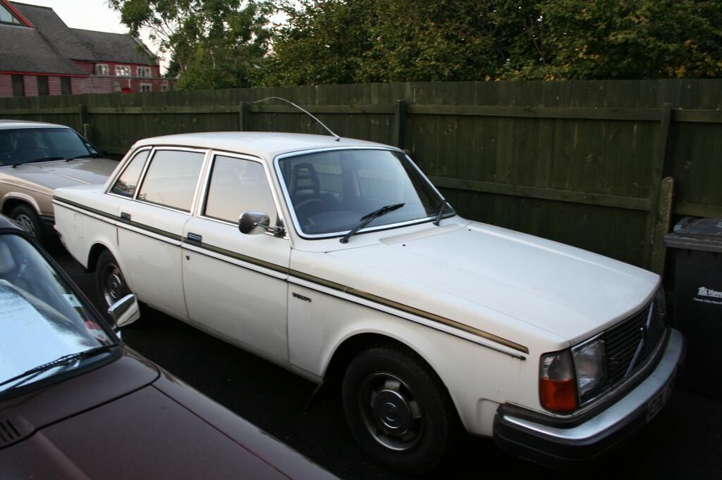

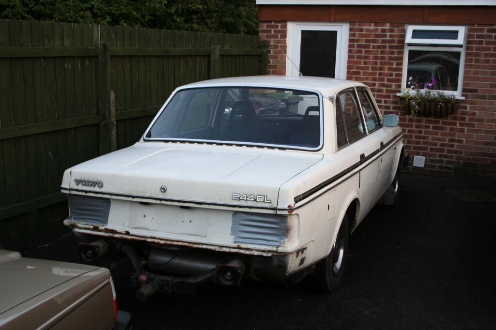

I remember the gigantic tow bar I had on my 244. Fuc*ing huge great thing it was! All tubular steel sections with the tow ball itself mounted on the end of a stubby bit of that tube and sticking right out even beyond the big bumpers.
The amount of times I walked around the car and either tripped over it or smashed my shins on it! I’ve actually still got a big dent in one shin from it to remember it by.
You can just see it in this pic.
Makes mine look practically lightweight!
Was your car a special edition or was the stripe just dealer bling?
It was absolutely massive! It must’ve added a huge amount of weight to the car! Totally overkill really so god only knows what they were towing with it. I’d imagine it’d have done some serious damage to anything that hit it too.
That car wasn’t a special edition, it was a 244DL but the supplying dealer jazzed it up with leftover stripe kits from the slightly earlier anniversary edition 244’s.
It was a funny car though as being the 79 year it had the early big bumpers, early flat bonnet with by then the unique early grill with small square headlights. At the back it had the early big bumper but the later 240 style rear lights and boot lid type.
2.1 redblock power with 4 speed manual. Went surprisingly well and people always used to give it a wide berth because of its rough appearance! Bloody brilliant car it was too. A bit of a cantankerous old pig to start when cold but once warm it was spot on. It’s up in Scotland now and having a bit of work done on it.

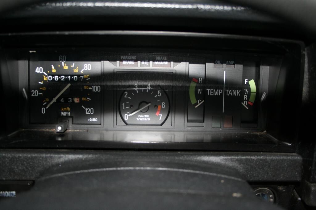

This was the odometer when it left me…
Bugger all mileage on one of these.
