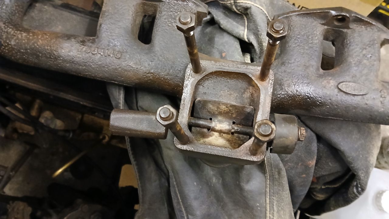

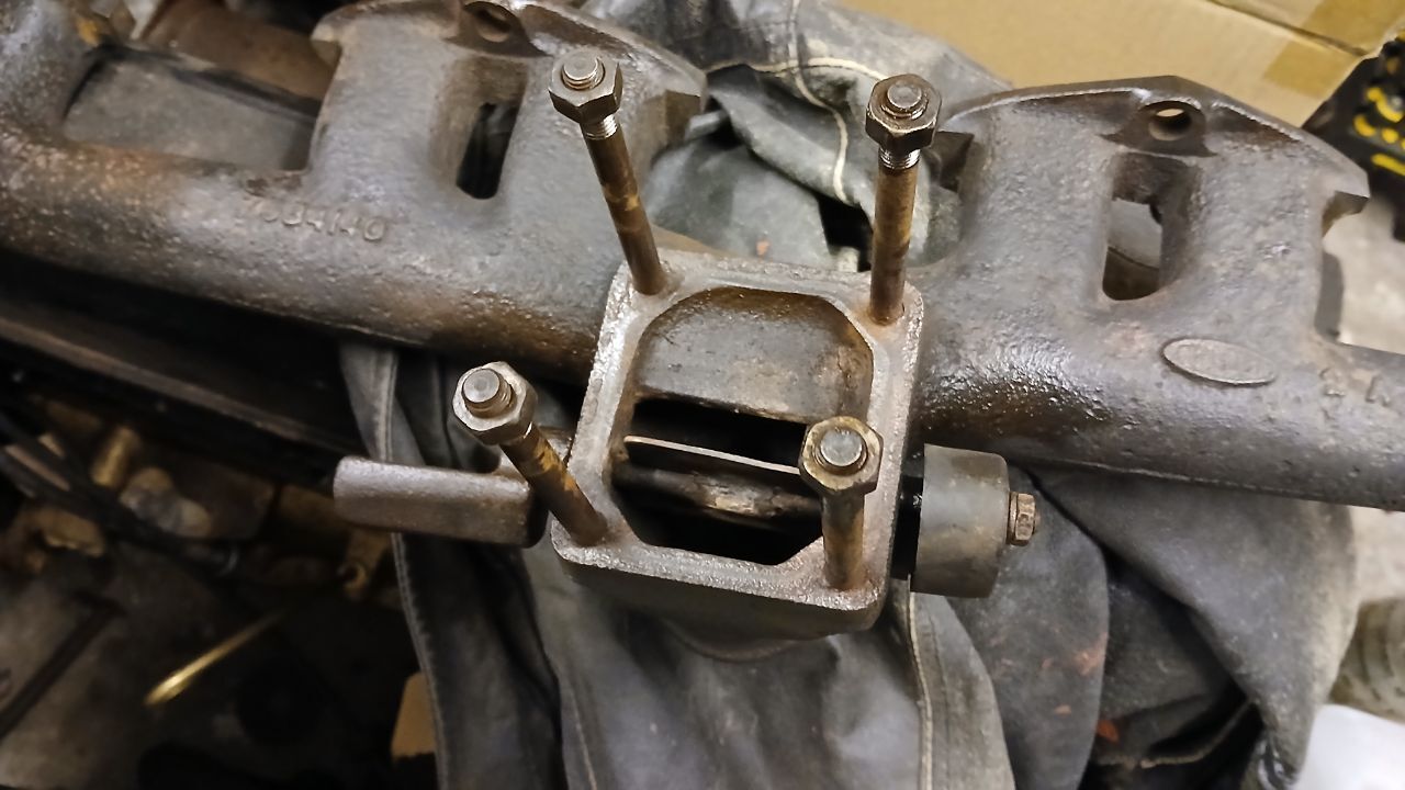

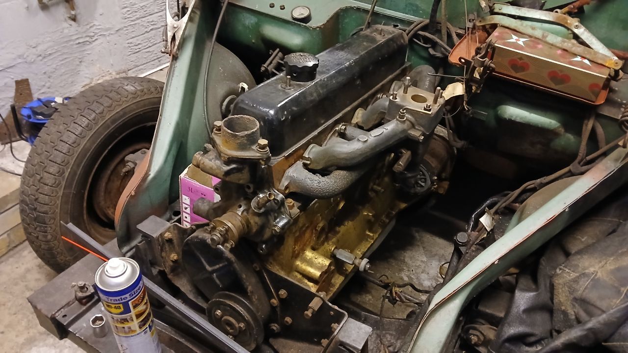

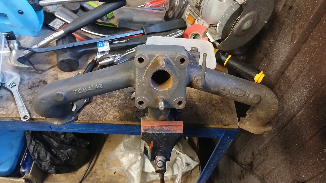

Cleaned up the manifolds. (Left side done, right side untouched).
There is a flap in the exhaust manifold to direct exhaust gasses up against the bottom of the inlet manifold. Seemingly to improve cold starts/running/economy. Naturally this was seized solid and it took a couple of hours with the MAPP gas torch and big hammer to get it to free up.
Conventional wisdom seems to suggest wiring it closed causes no ill effect. It being stuck open can cause vapour lock. Under the little cover on the right is a coil spring which I think actuates the flap as it expands/contracts. Or it would, had it not crumbled to dust in my hand.

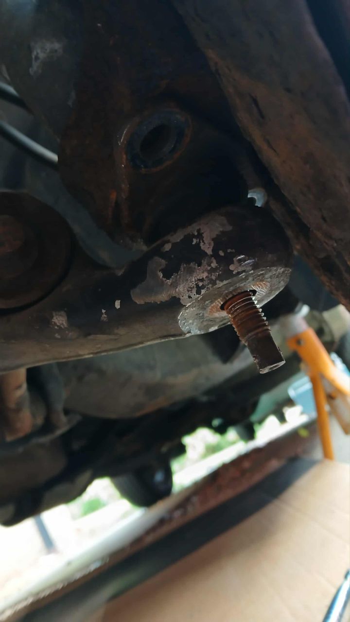

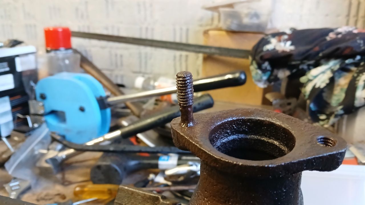

Downpipe stud has also seen better days...

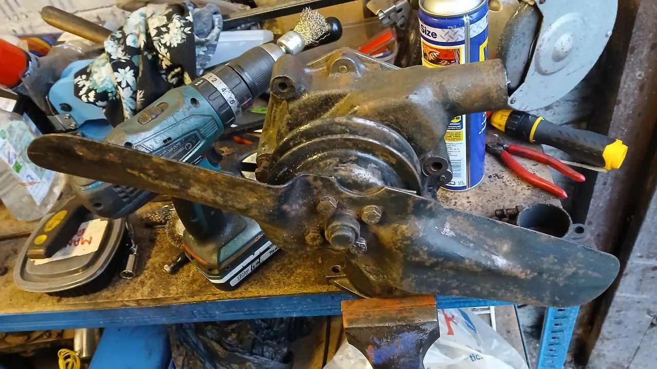

Dragged the water pump out the boot and wire wheeled it. There are a couple of threaded inlet/outlets that are badly corroded and will need replaced.
Spins freely but chances of it pissing coolant out are probably very high. Not sure of the logistics of having it serviced.
Tested out my expensive paint removing discs on the angle grinder. Very satisfying.
Chucked bits loosely on the engine to keep them out of the way.

Is the pump not shared with the later straight sixes like the Ventoras? If you could get a new un it's probably better for peace of mind?
Similar but different.

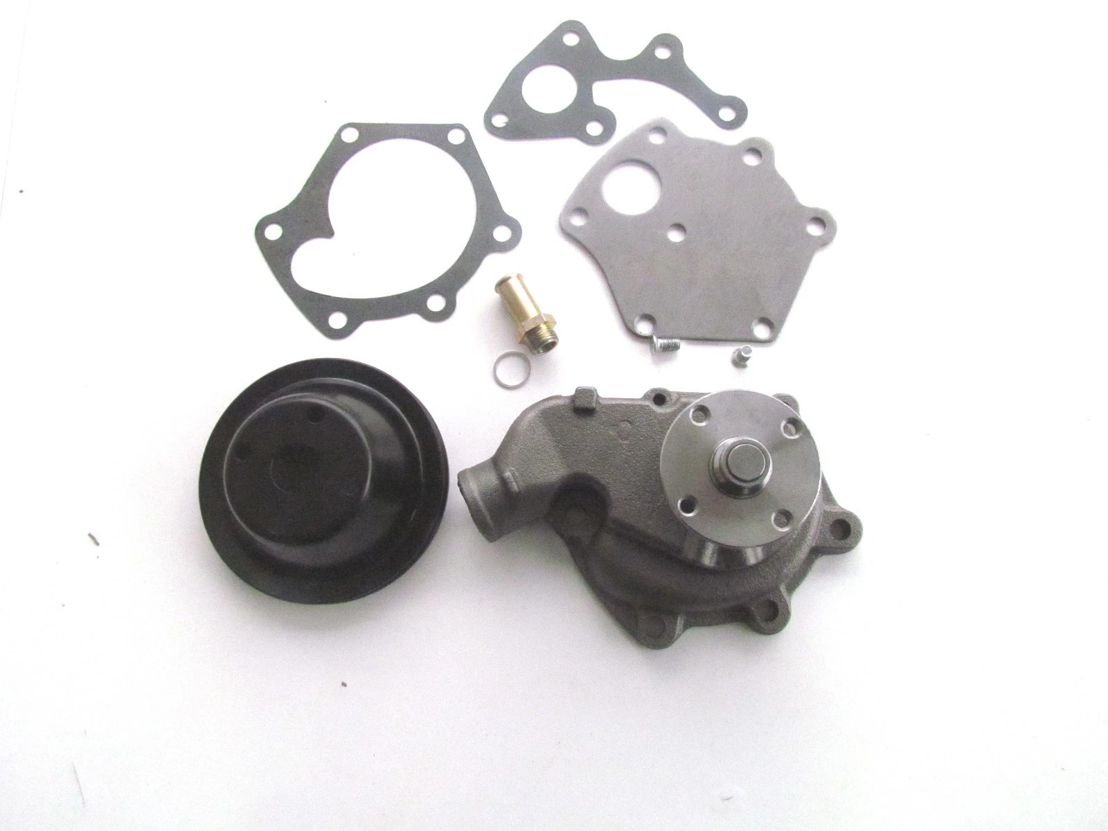

I don't think you can actually get new water pumps for any variation of the 6 pot. There is something to be said for the parts supply of BLMC stuff, even if most of it is junk!
A browse of the owner's club mag and Google has shown that there are a few places doing refurb pumps on an exchange basis. So a solution is at hand if it proves leaky.
Obviously they can be rebuilt by DIY, but it sounds like one of those jobs that's a bit of a faff and potentially ends with a pump that lasts 50 miles because you misaligned something...
I had a look at the water pumps for 6-cylinder Opel now and new ones are available but they look different unfortunately.
Still a result. If you can get a refurb exchange it's like having new anyway. Great to see you cracking on with this 👏

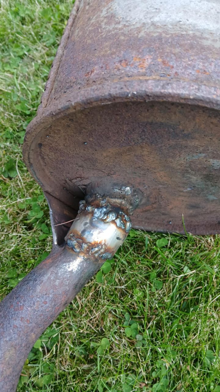

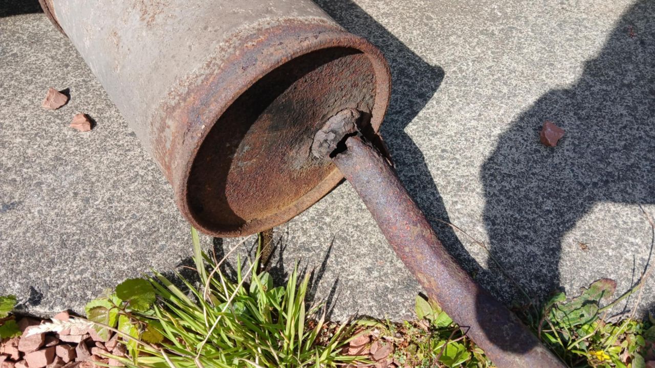

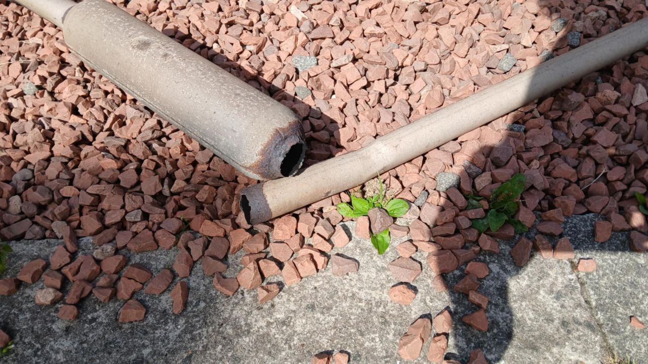

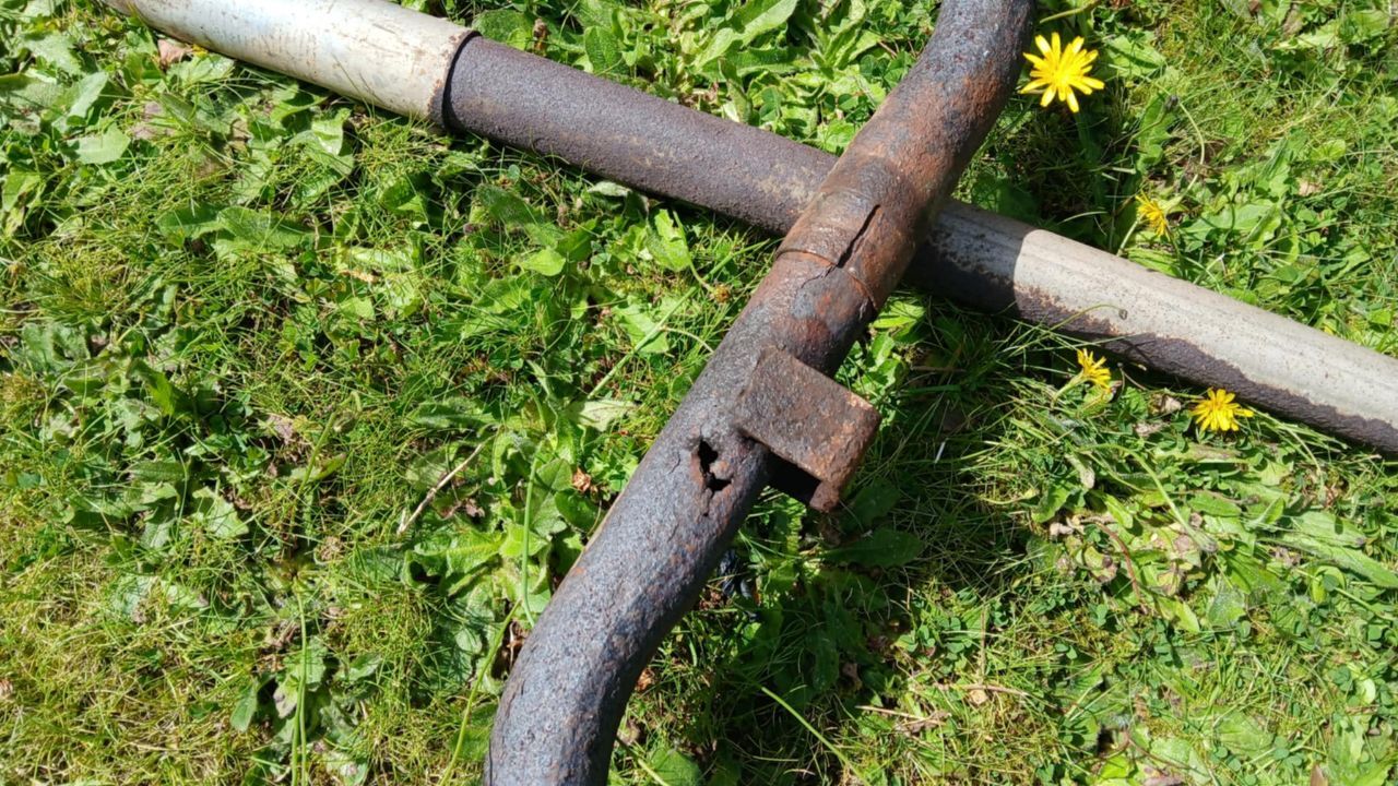

Immediately before it was due to leave the exhaust snapped in half and I foolishly figured it'd be easier to take it off and weld it up rather than bodge in situ.
Unfortunately during removal it promptly fell to bits in multiple other locations...
Fucksake.

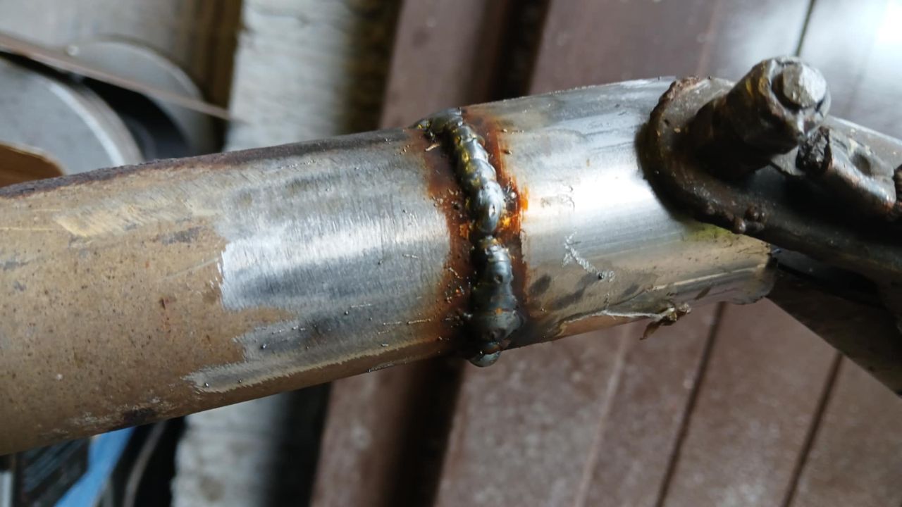

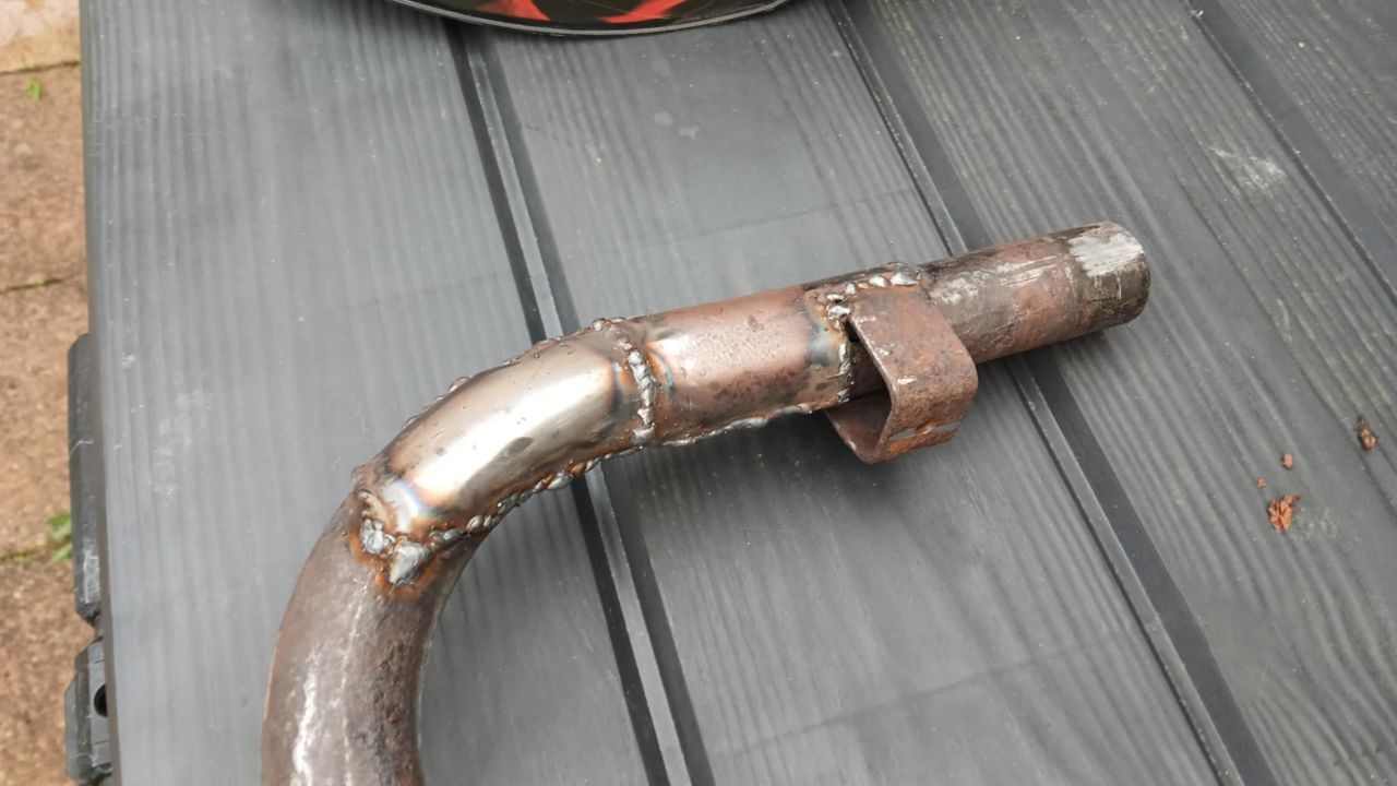

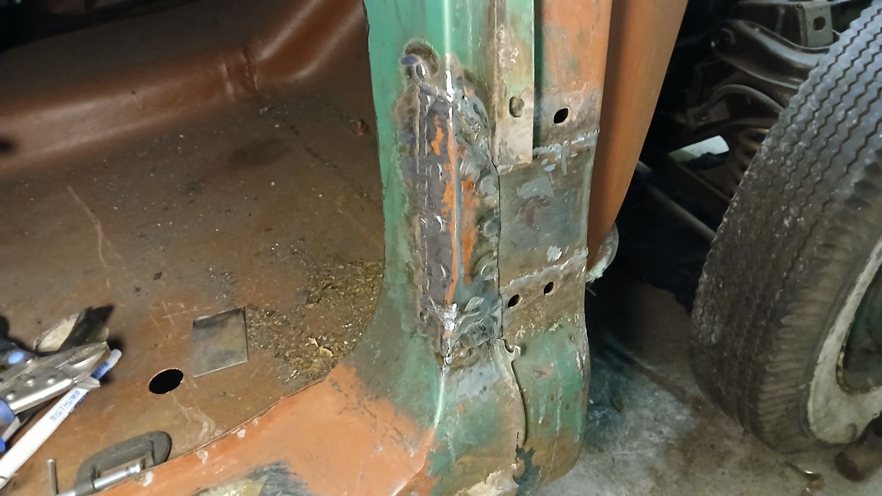

Promptly fired some amazing* welding at the problem...
The following is probably my finest ever welding work.
Ironically on reassembly it started blowing at the manifold/downpipe flange. Fucking thing.

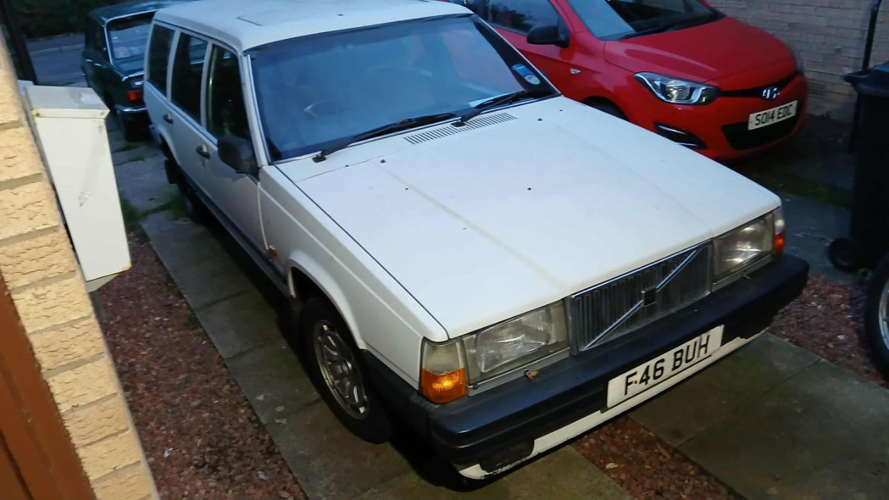

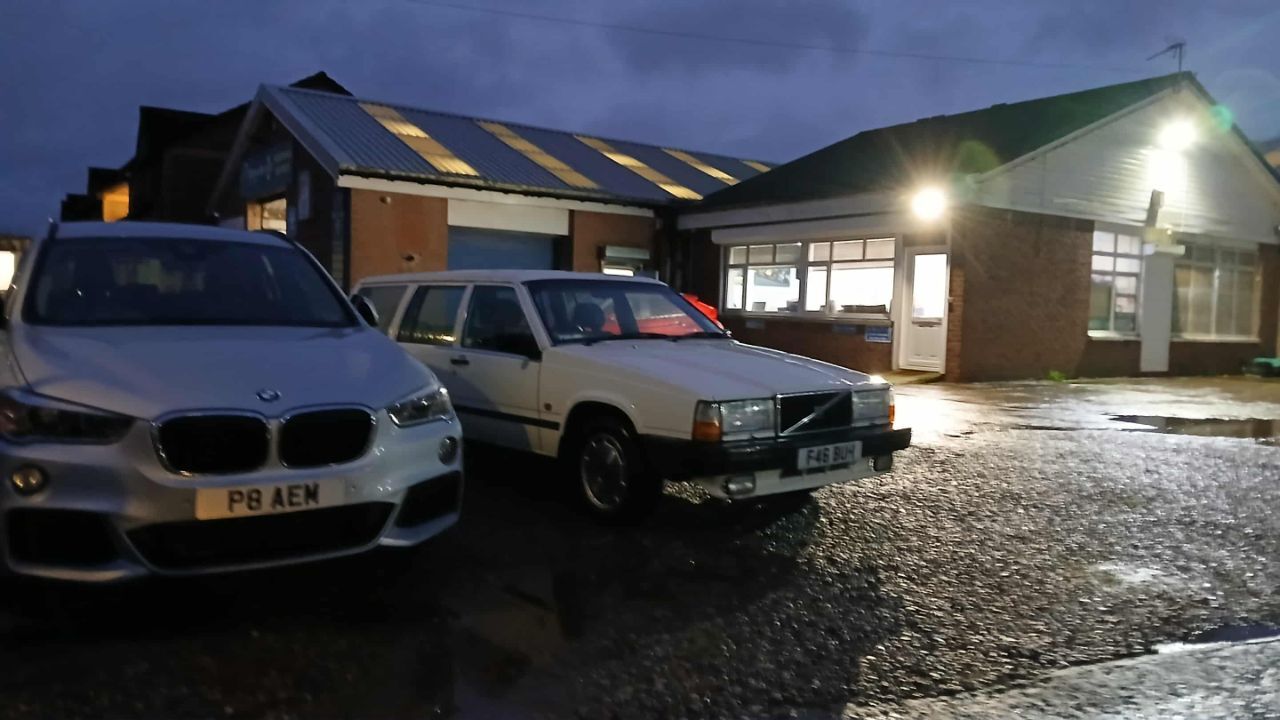

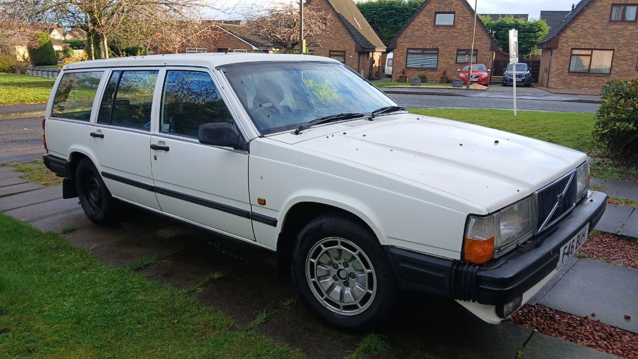

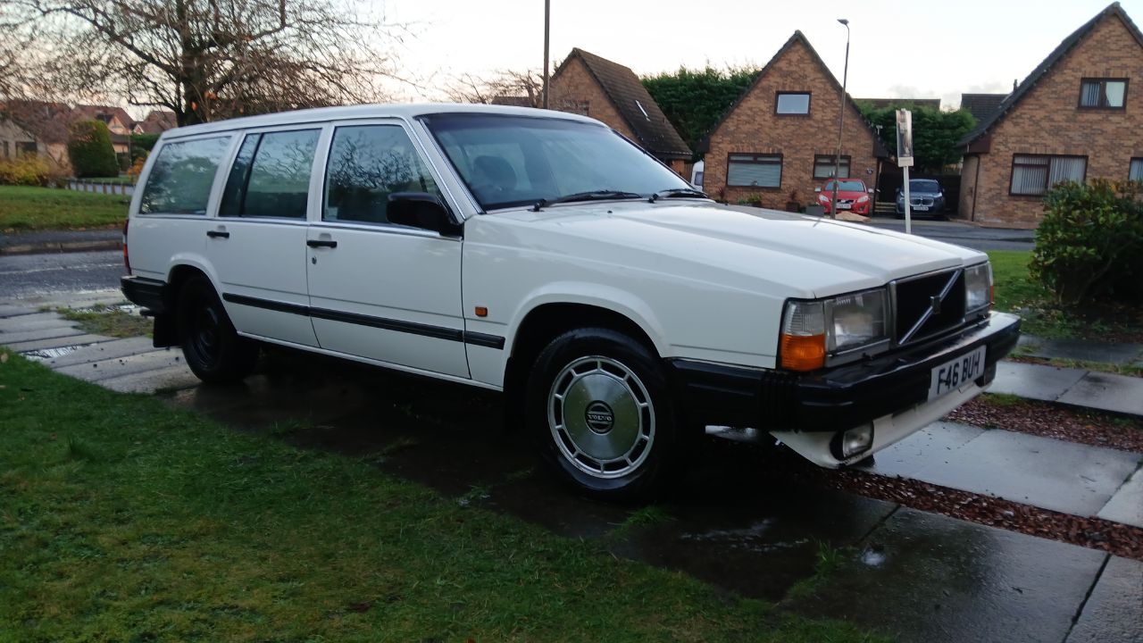

The Volvo ran out of MOT. Threw it at the garage where it promptly failed.

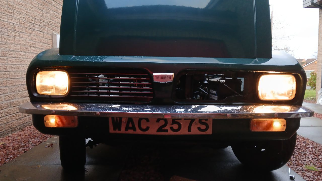

The wipers have never automatically parked, they park wherever you switch them off. From what I understand this shouldn't be a fail, but I'm going to borrow the relevant relay from another Scotoshiter to get it through the test....
Headlight aim has never been an issue before. I'd put good money on their testing rig being buggered.

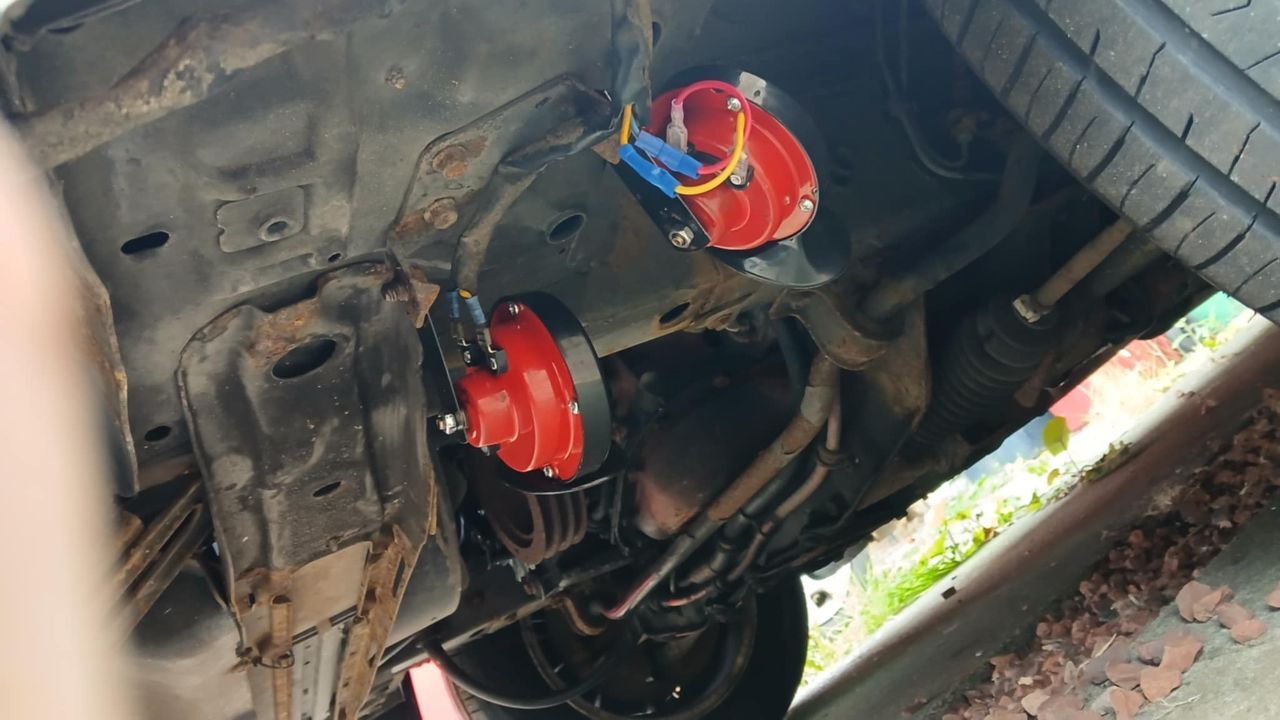

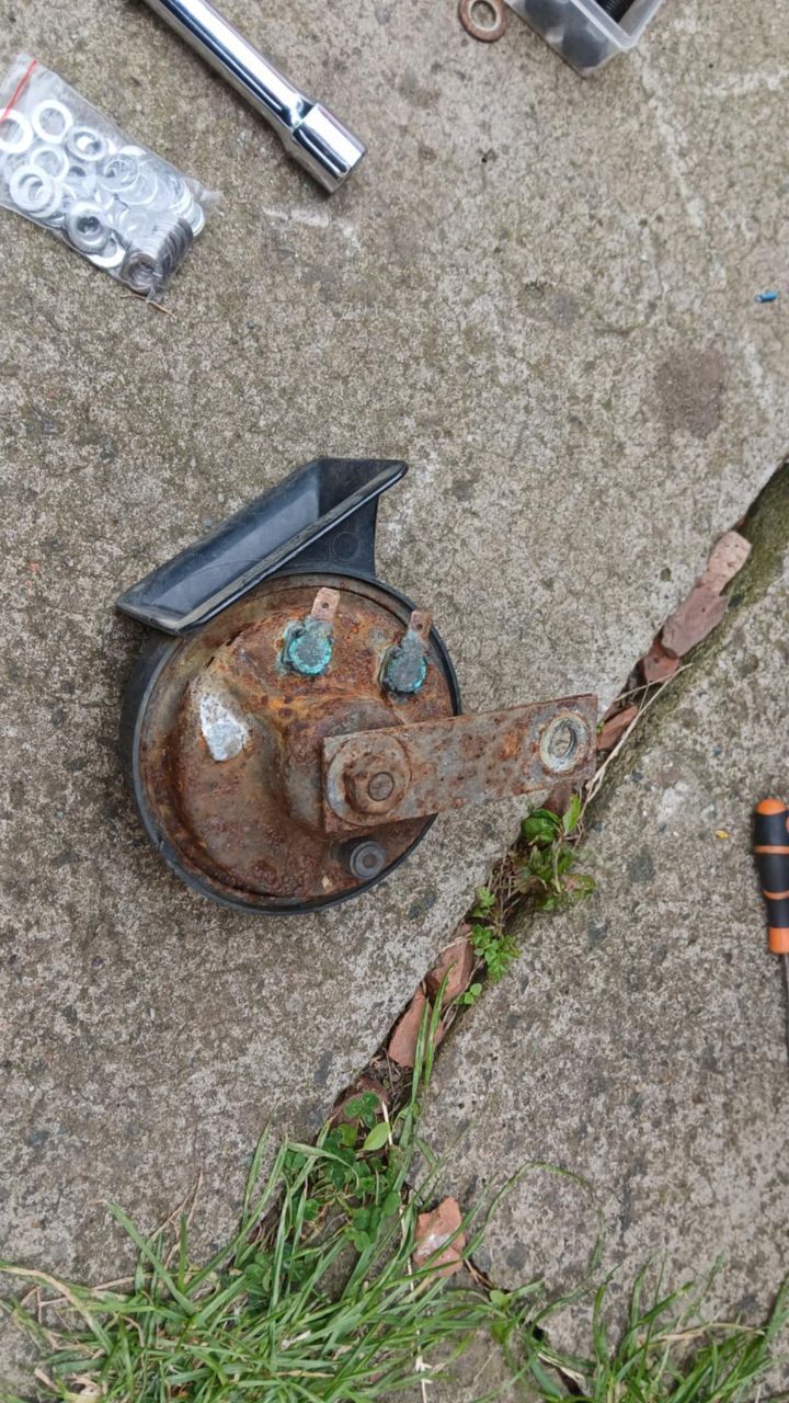

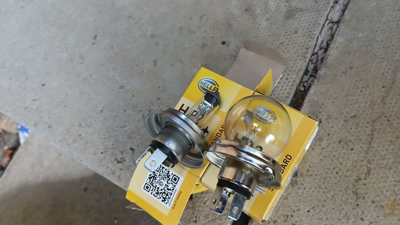

Horn was buggered. I have solved this.

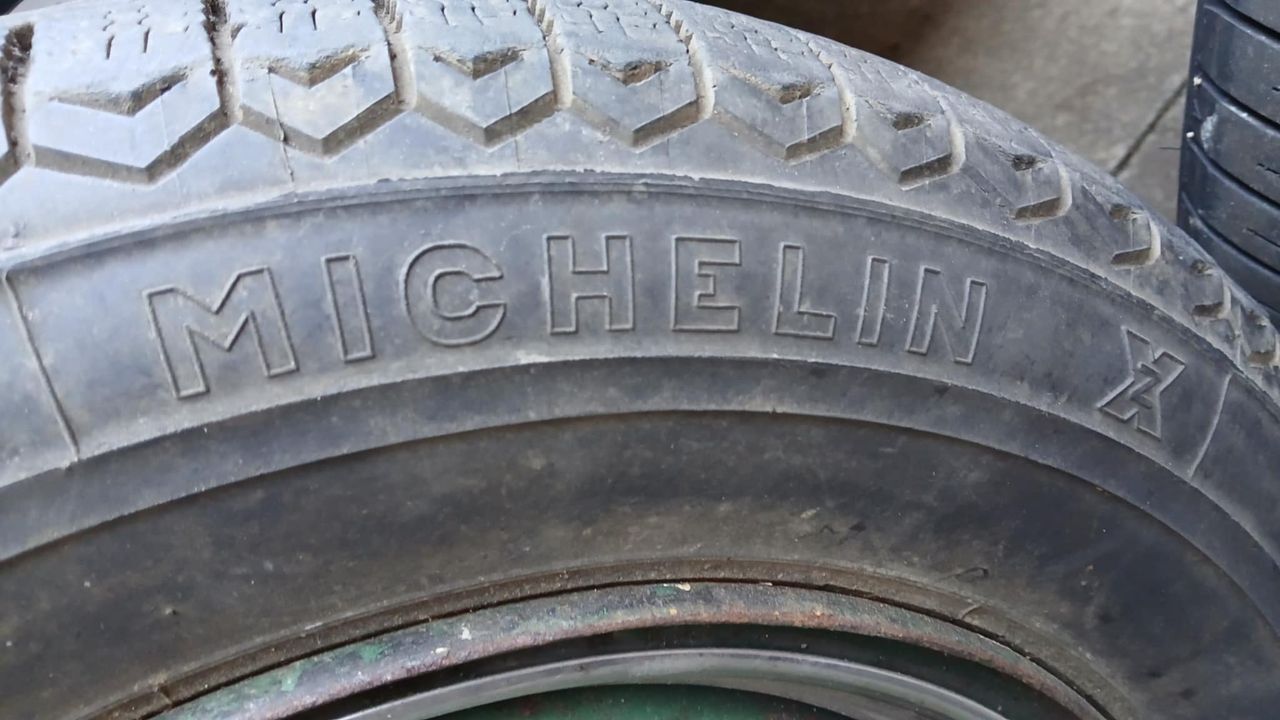

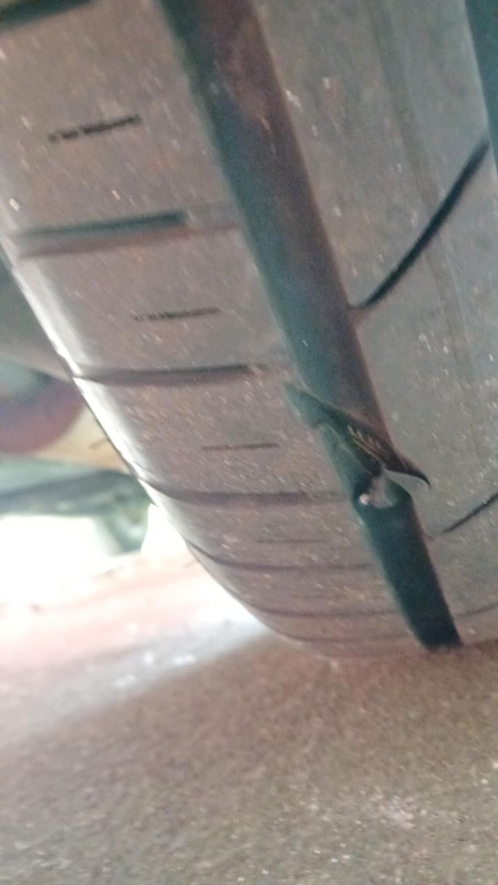

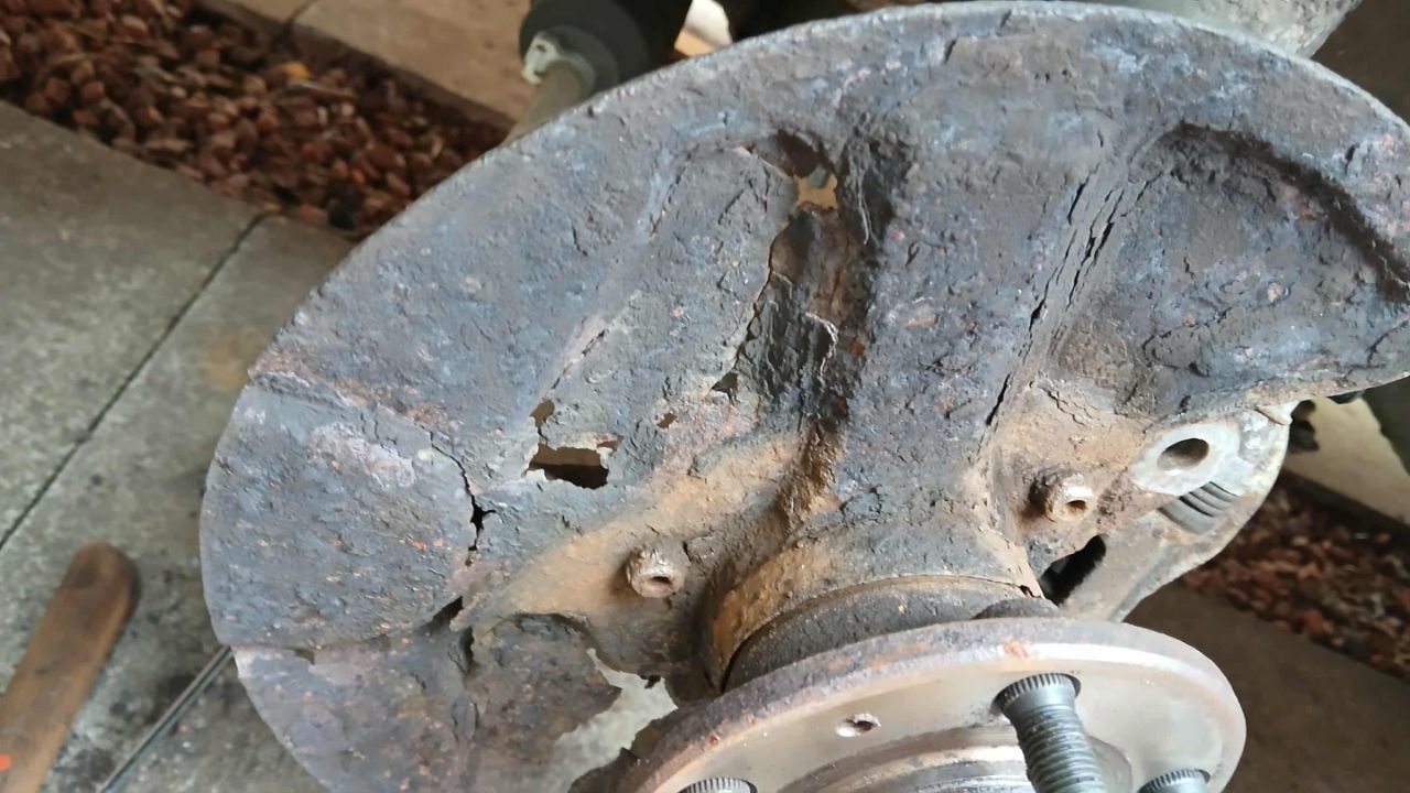

Had a nose at the bad tyre.
Naturally its the newest tyre on the car, probably hasn't done 1,000 miles. Was supposed to be replaced today but the mobile fitter simply never showed up...

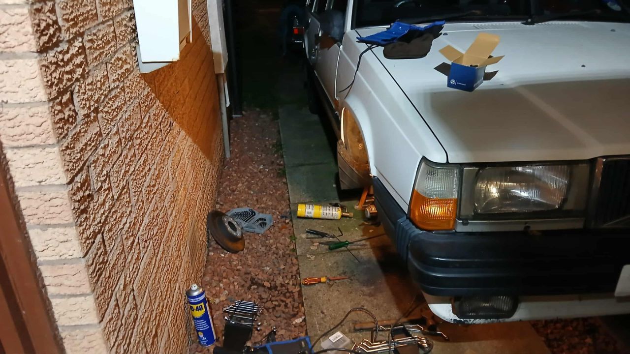

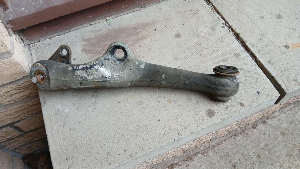

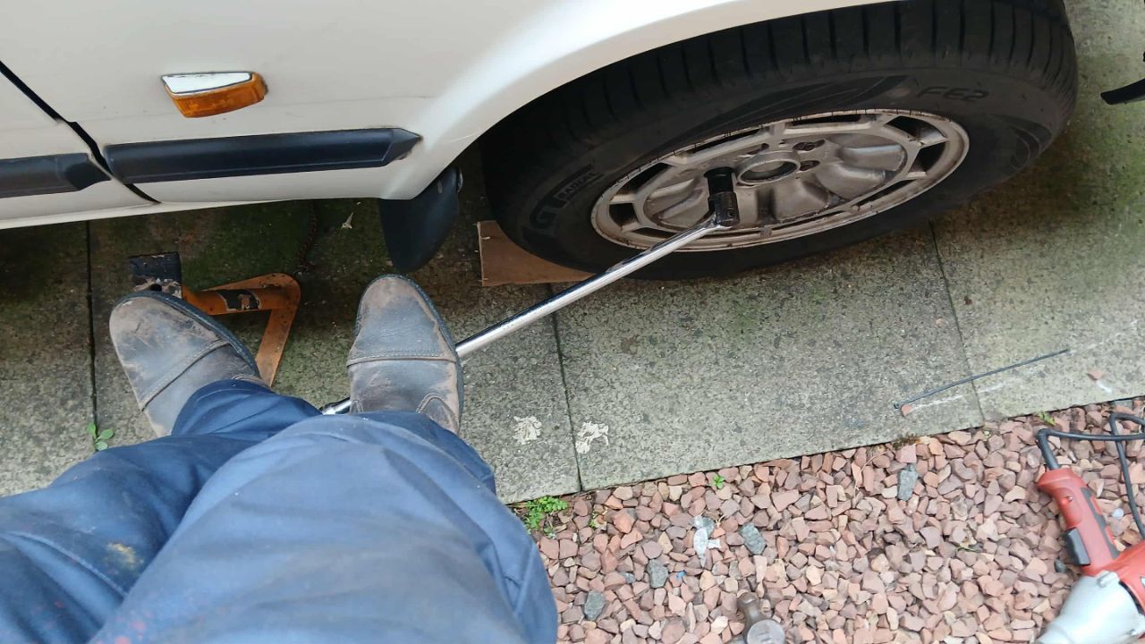

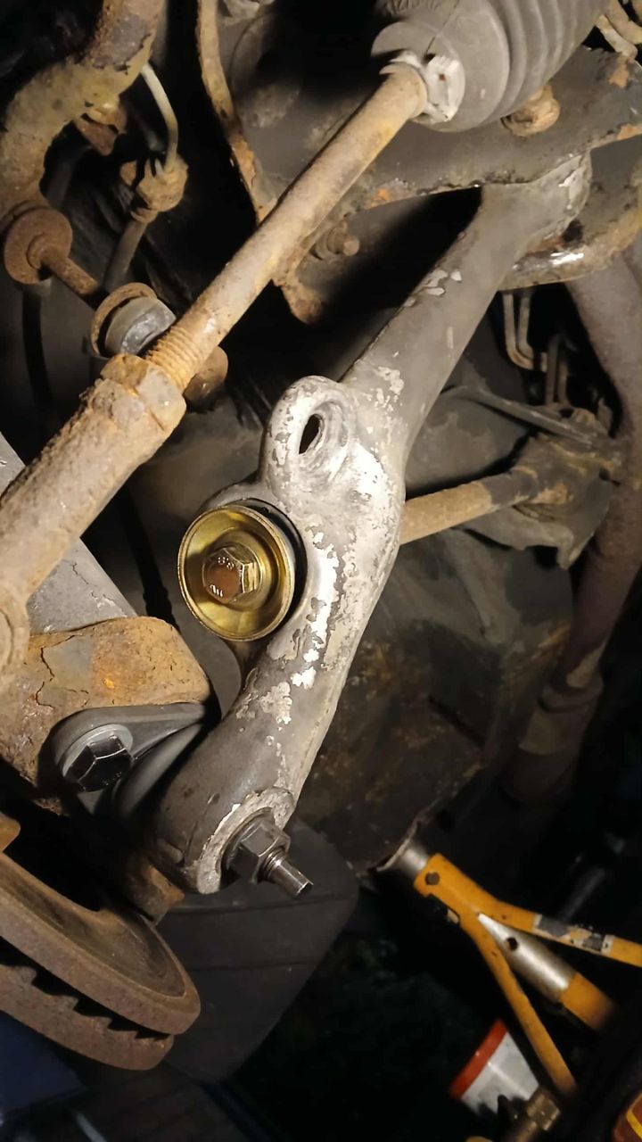

Ordered lower ball joints for it. Not that I can feel any play in either of them. Unfortunately taking an age to arrive so aren't going to get the free retest...

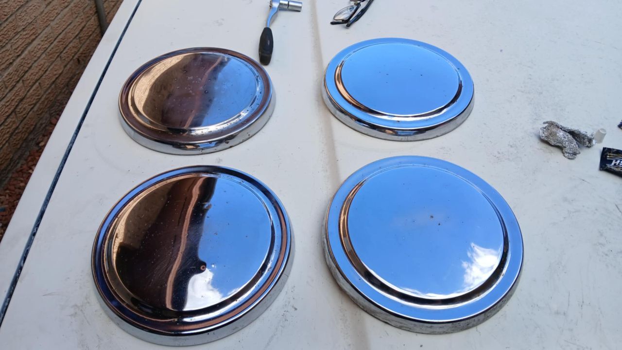

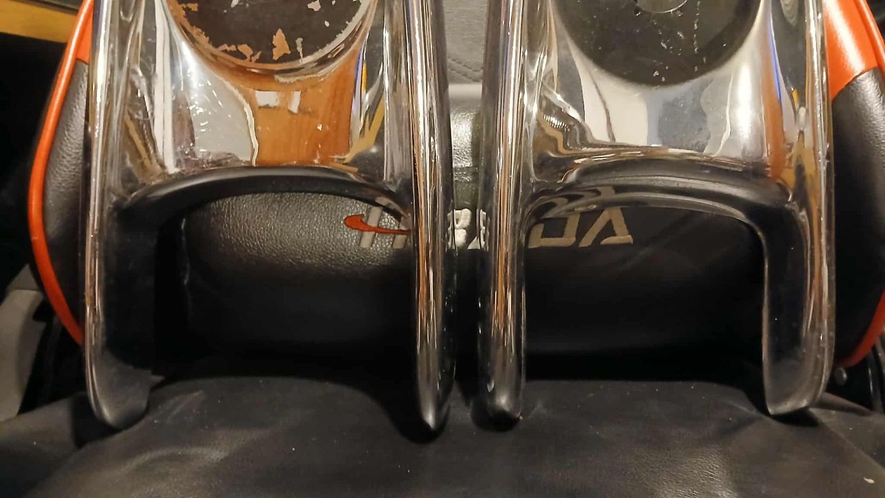

Not much going with the Cresta. I've been polishing chrome in my downtime...
Rummaged through my bits and found the parts to assemble a decent front grille, as the one that came with the car was pretty rough...
It will take some jiggery pokery to get it all to fit together properly. It's a mix of '55/'56 parts which aren't quite identical.

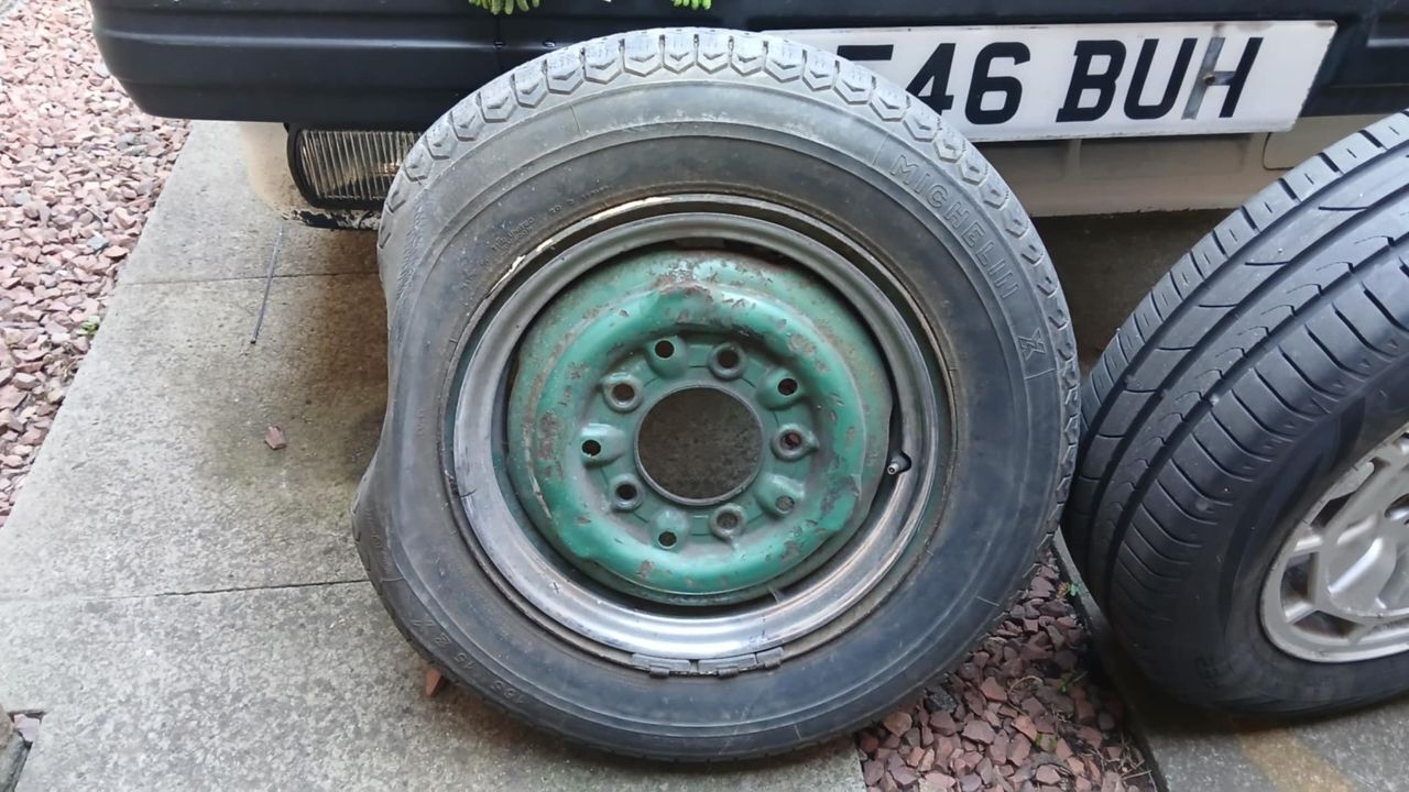

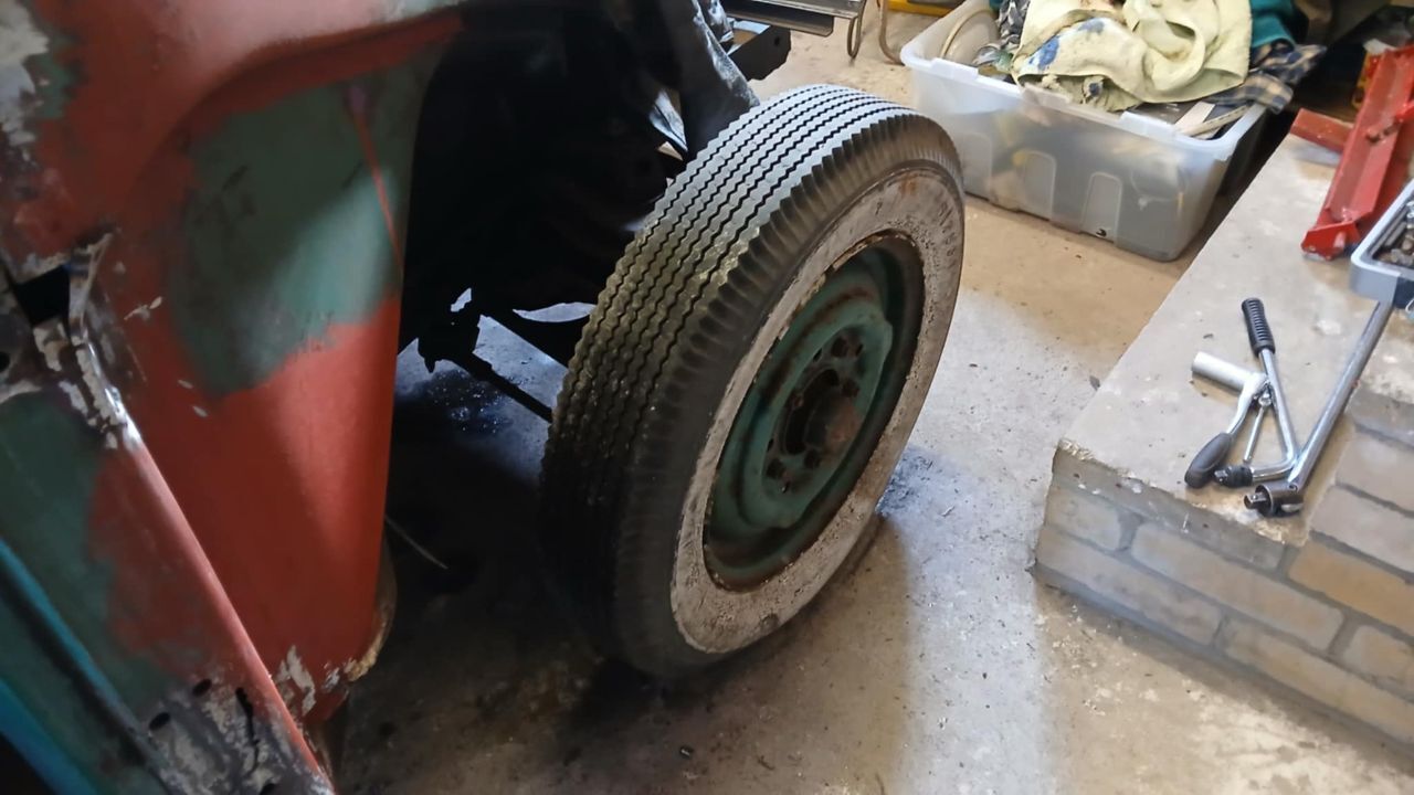

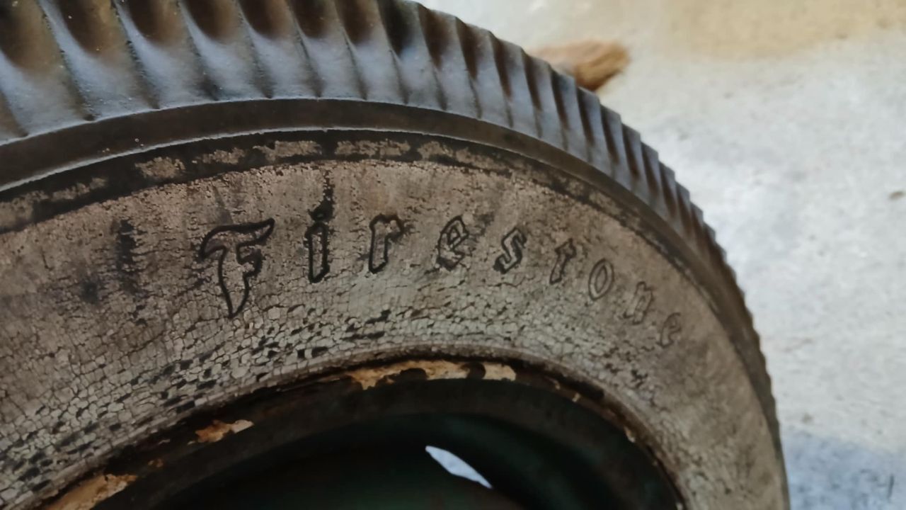

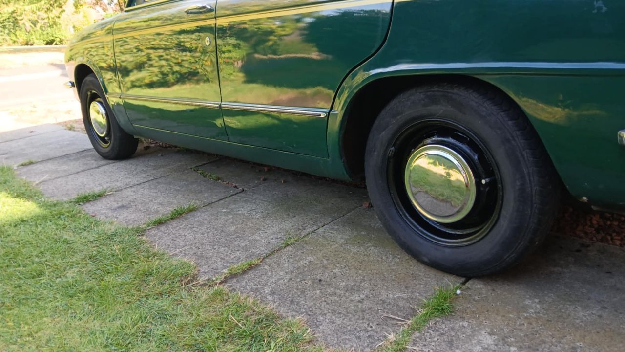

I also got tired of the Cresta sitting on a flat tyre.
Modern rubbish that can't even last 40 years...
Superior 70 year old rubber...

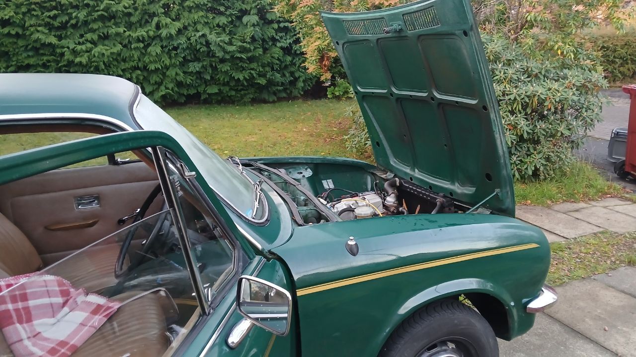

The Dolomite has been largely trouble free and has been the go-to daily.
It was also my Shitefest transport.

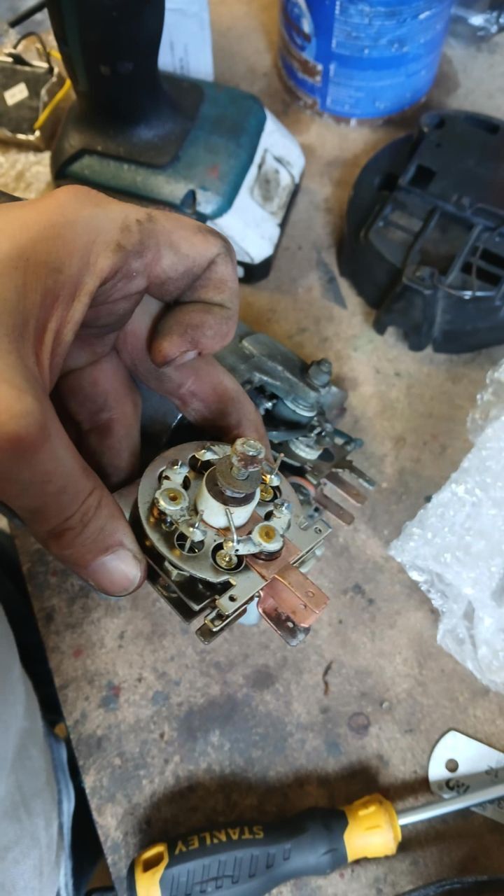

It has recently started overcharging, the charge light dimly glows. Bought a repair kit and replaced the regulator. Still overcharging.
The brand new parts were actually rustier than the bits on the car, so I don't exactly trust them...
All the wiring for the alternator goes through a multiplug into the rectifier, which seems to be fine. I think it's earthed straight through the casing.

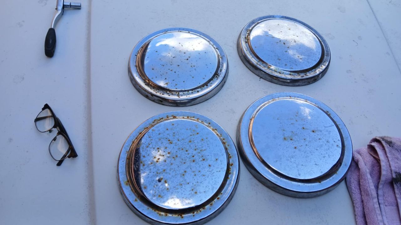

Yesterday I changed the oil. Today I engaged in some turd polishing.
Add in a bit of satin black rattle can and we have a set of fully restored* wheels.

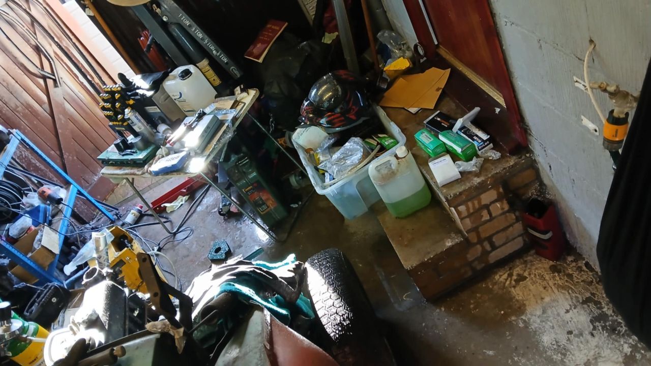

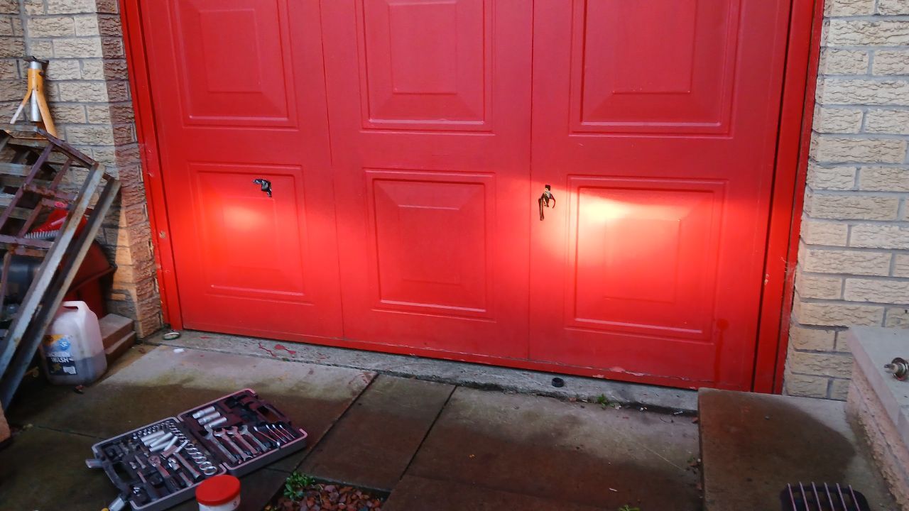

Oh. I also managed to wash my garage.
The joys of the "outside" tap being inside the garage. Hose partially came off the fitting and fired high pressure water all over the place while I was washing the car...

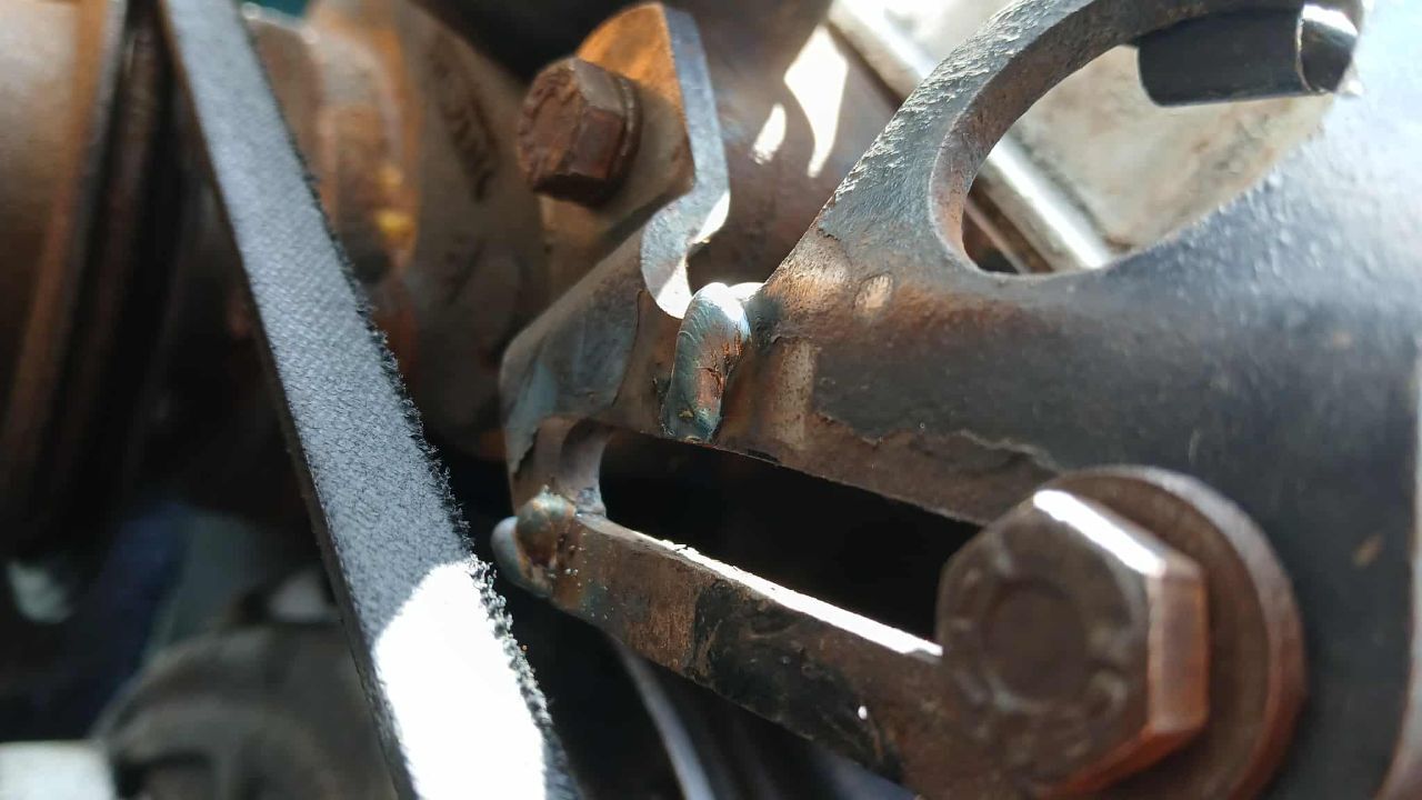

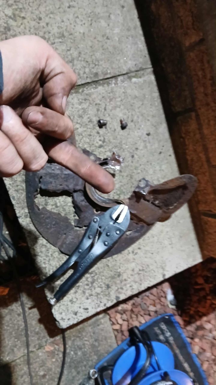

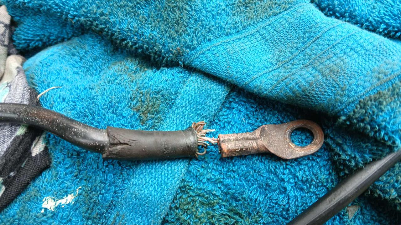

Casualties included the alternator tensioner.
And starter motor wiring.

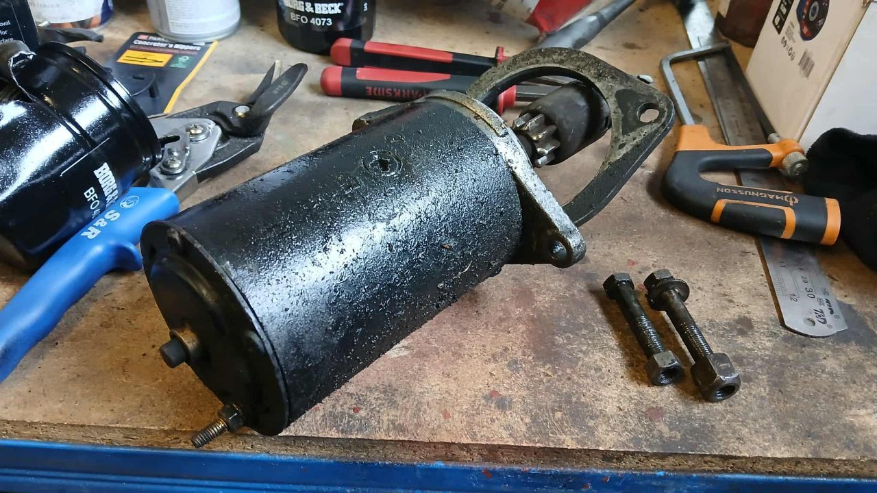

Stripped and cleaned the starter motor, which was full of shite from oil running down that side of the engine from the rocker cover.
There were also some screws loose on the end plate so it was twisting with the motor a bit.

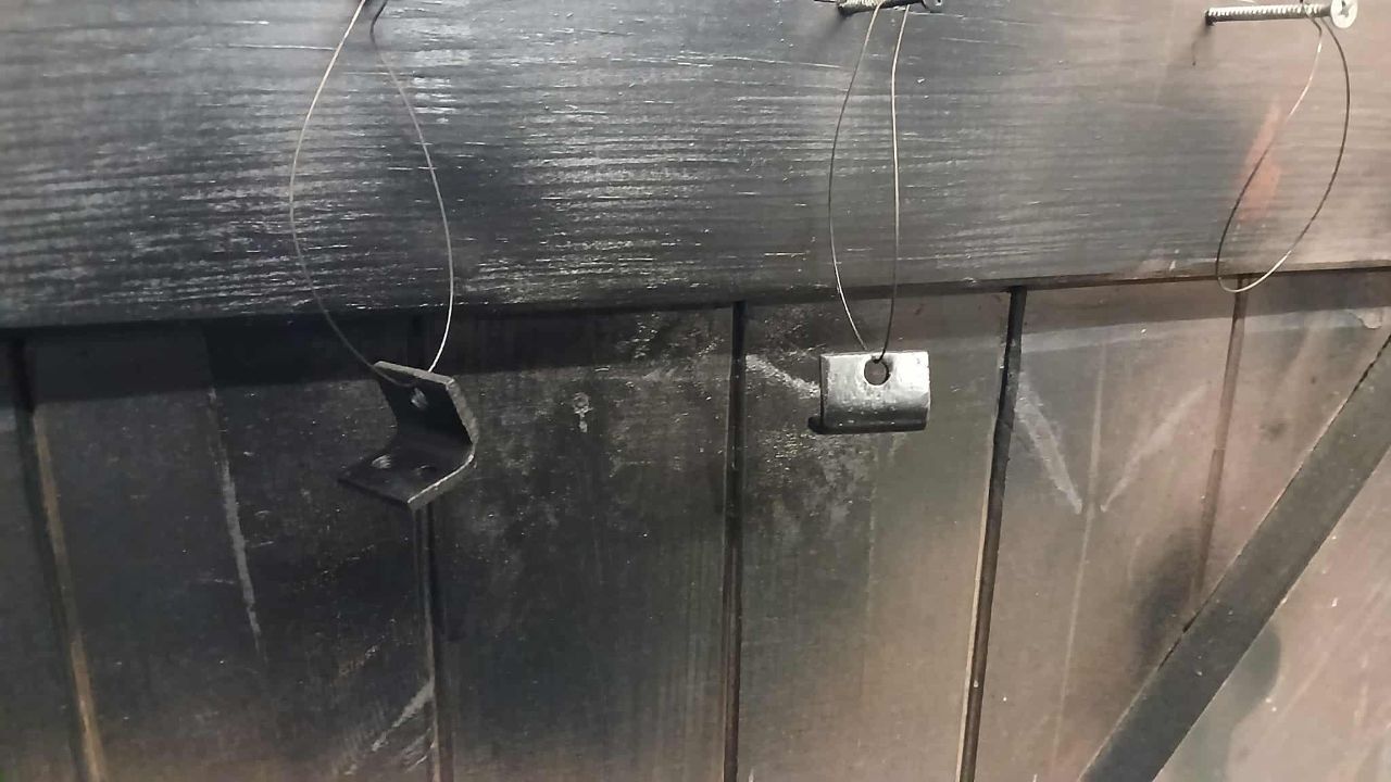

Replaced the toasted wiring with some random shit I found in the garage and threw some shit welds at the alternator bracket.
My welder has a broken switch so I can't turn the voltage up high enough to get decent penetration on metal that thick. You can see the frayed belt caused by the alternator flapping about...

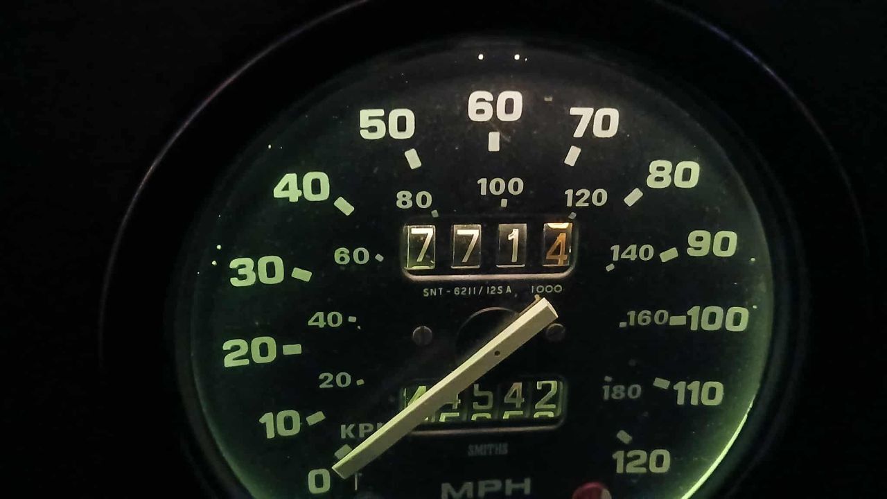

Either way, trip counter currently reads 354, so 1,354 miles completed over the last 3 weeks. Which is good going for an old banger with 57bhp. I was going to take the Volvo up to Dingwall, but haven't had time to rectify the MOT fails.

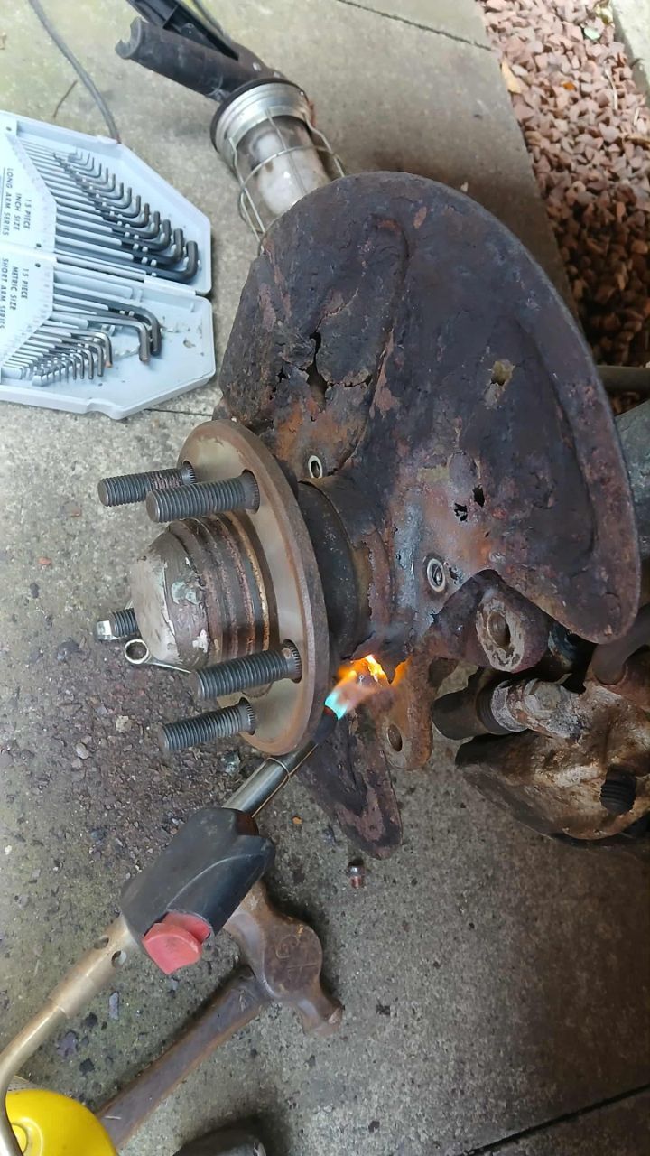

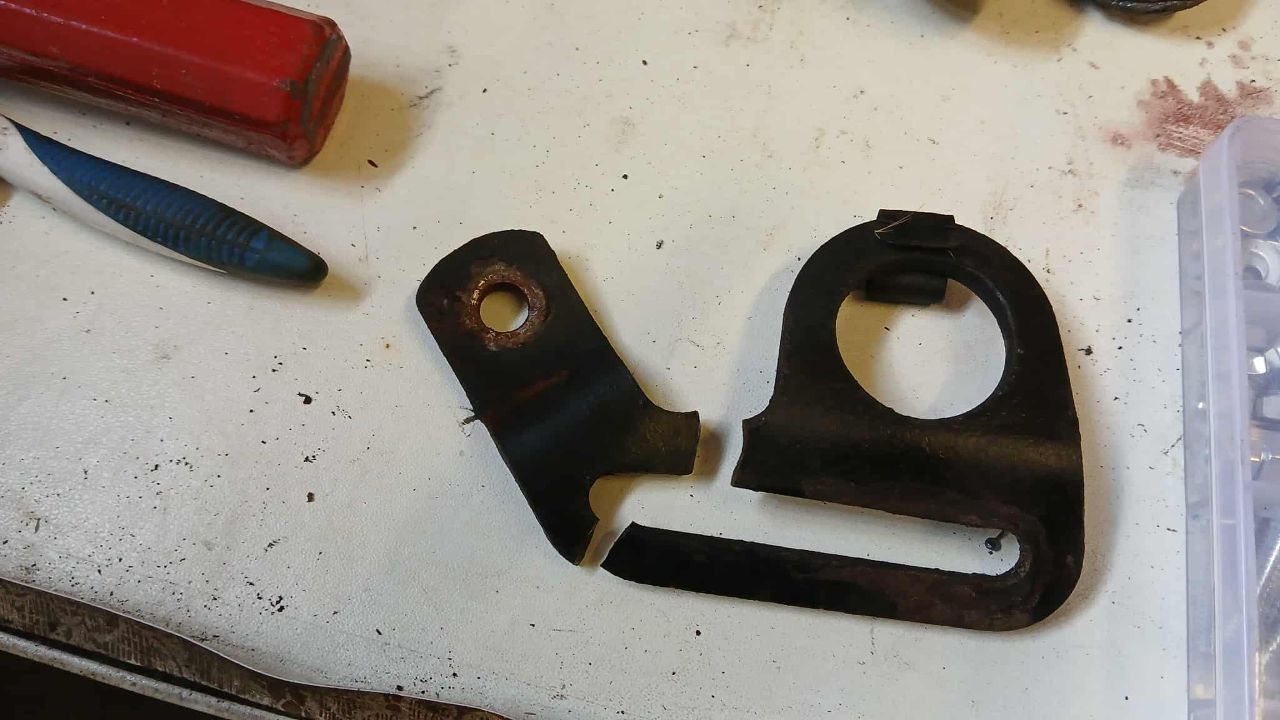

Not entirely trouble free. My welded alternator bracket partially snapped again, the NSF wheel bearing is grumbling on cornering and there is a horrendous low resonance droning linked to throttle application/on the overrun. This is either something touching the body which shouldn't be or propshaft vibration. The prop deffo has some slack now, as you can feel it flapping about when pulling away.
I guess I should be grateful I can reliably do enough miles to wear out driveshaft components these days!

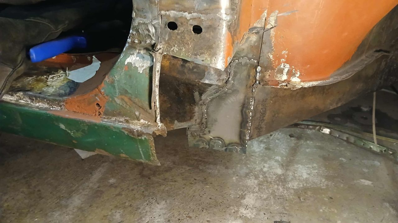

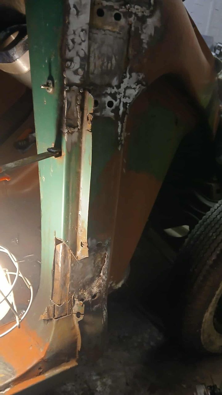

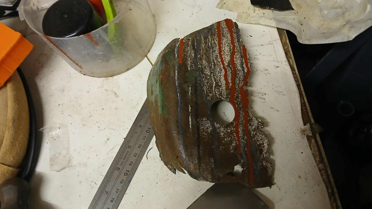

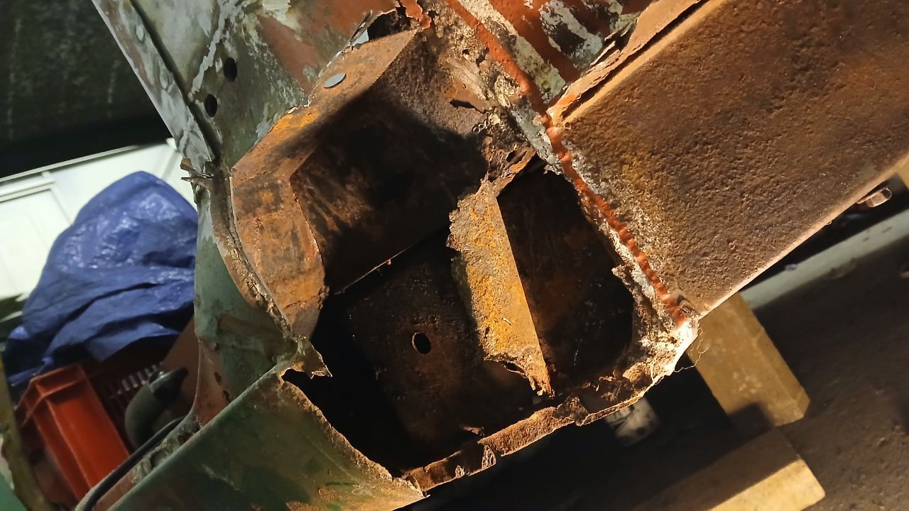

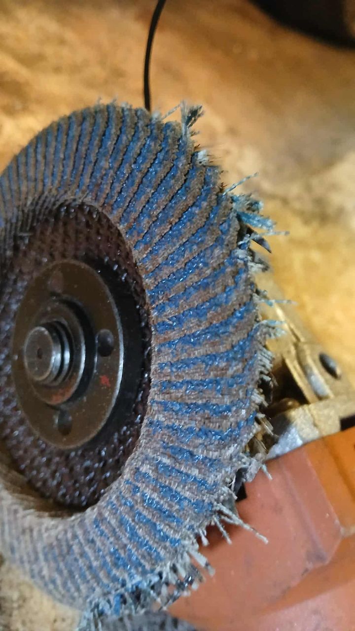

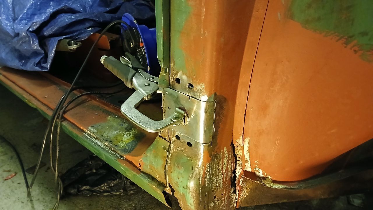

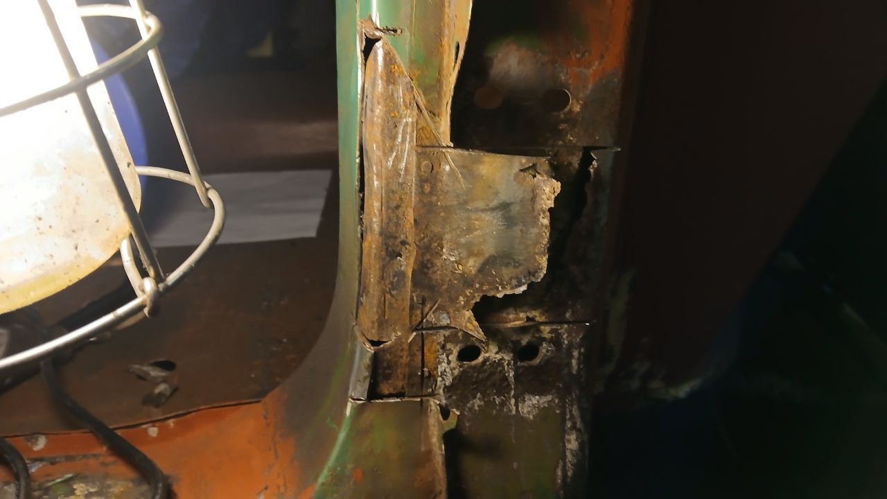

Felt a bit guilty for having a day off work and not doing anything productive. Raining so played with Cresta shit.
Welded the final bit of the upper hinge area and started chopping out the lower hinge area.
Exciting moment when my flap wheel snagged, exploded and yanked the grinder out of my hands and sent it skittering across my legs at full pelt.
A few small holes in my overalls and a bruised thigh was the extent of the damage thankfully...

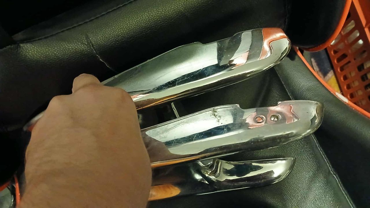

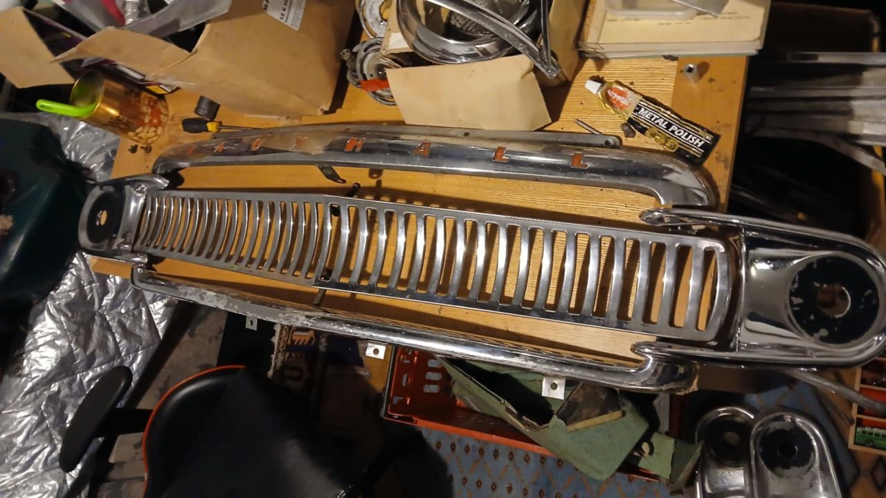

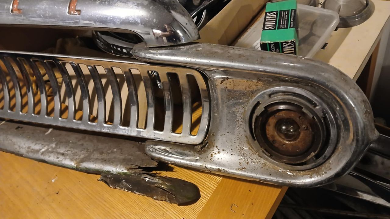

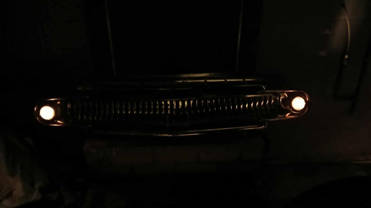

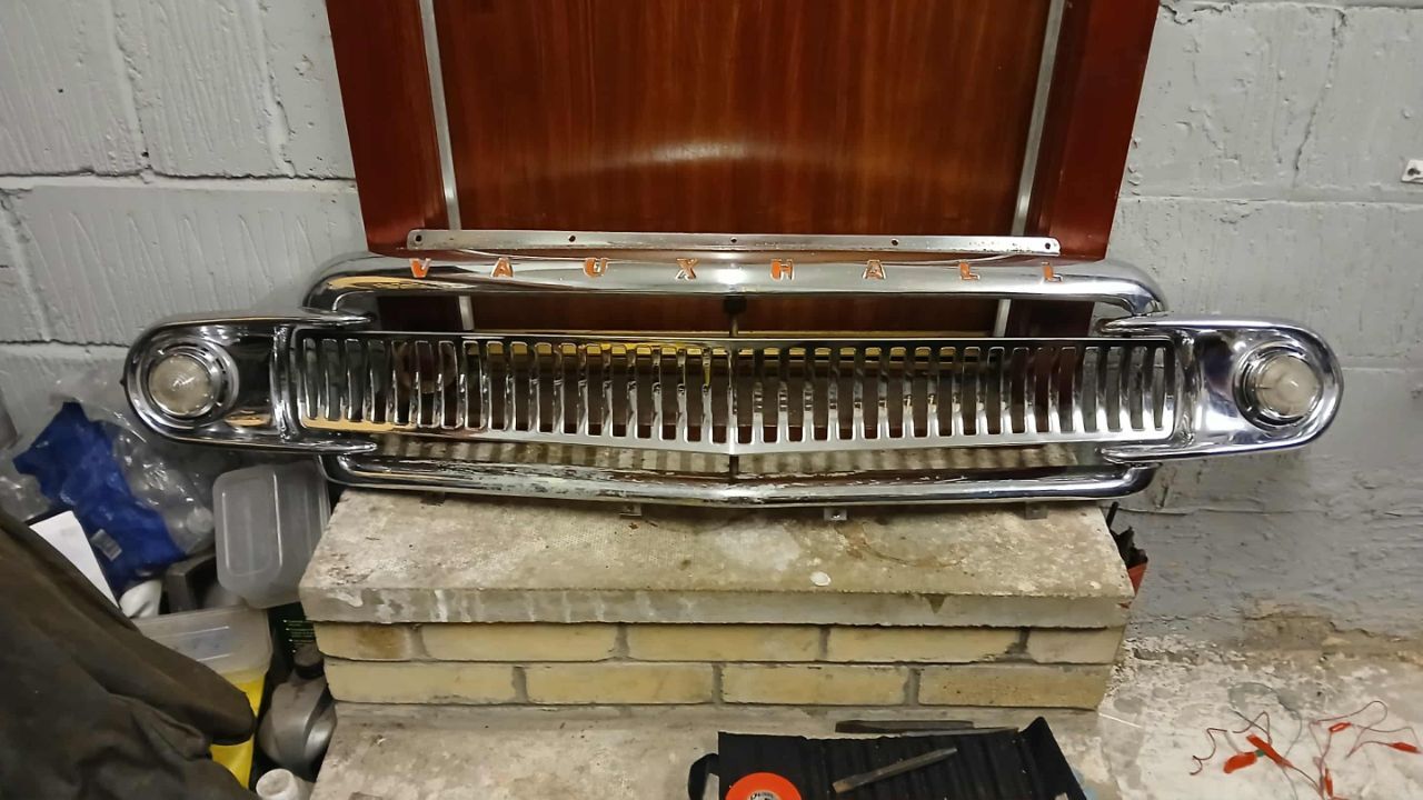

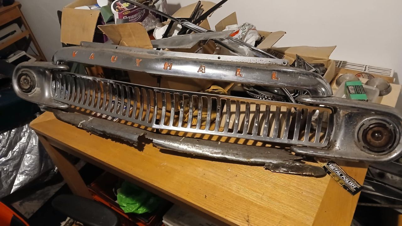

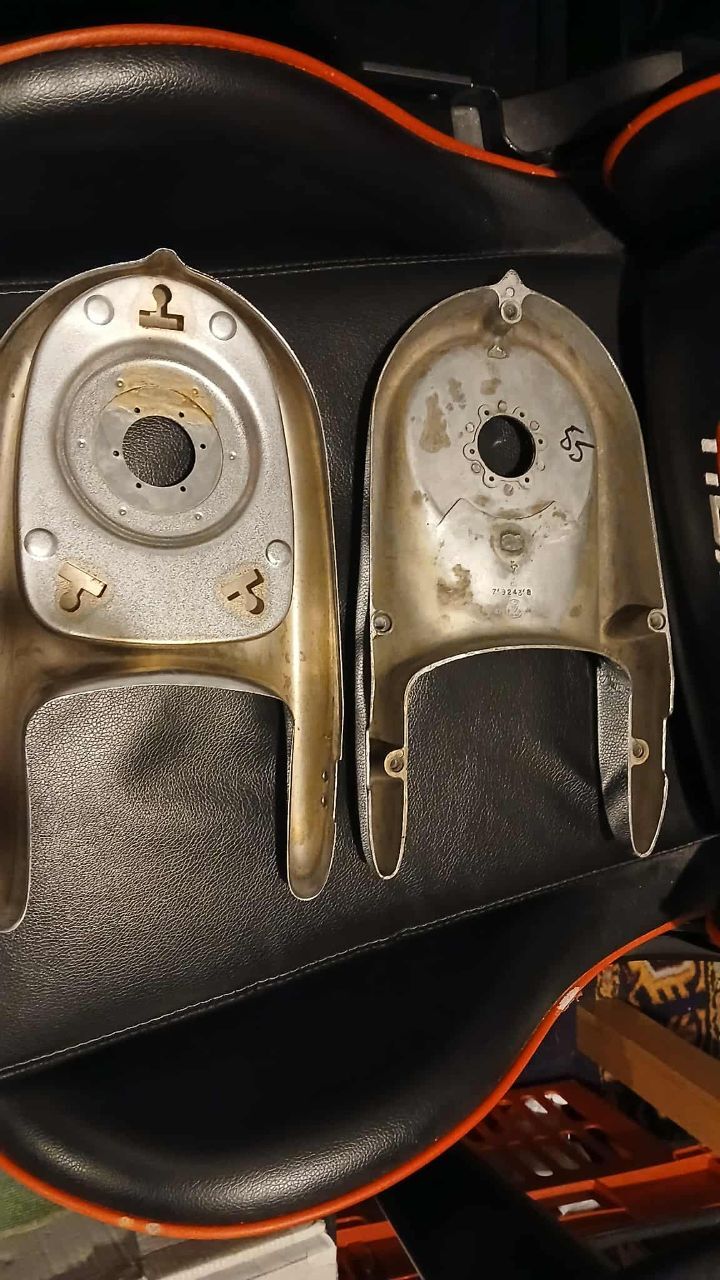

I also started fucking about getting grille parts to fit together.
The complete grille assembly should look like this at both ends.
Beneath the indicator/sidelight surround the assembly is quite obvious.
One bolt goes through all the components and holds everything together. Simples.

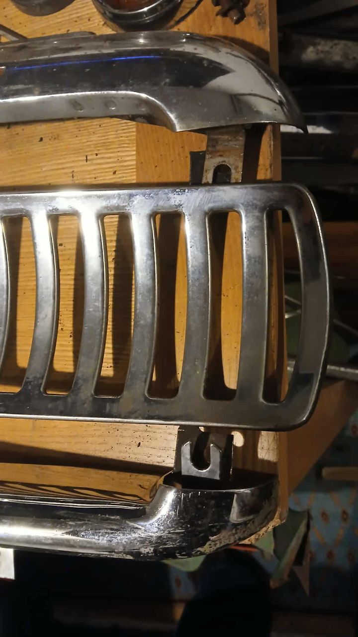

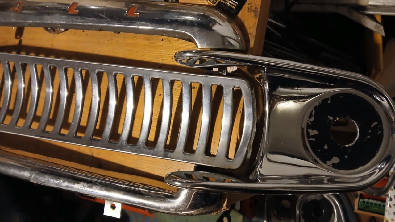

I dug out my selection of best bits (two NOS indicator/surround, a NOS bottom bar, a grille that was NOS but fitted in 1981 and the original top bar) and offered them all up and all seemed fine.
Briefly.

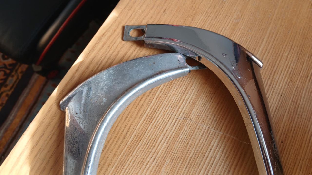

I quickly found that on top of it being fiddly as fuck on a table not quite big enough to hold all the parts that the bolt holes weren't quite lining up on one side...

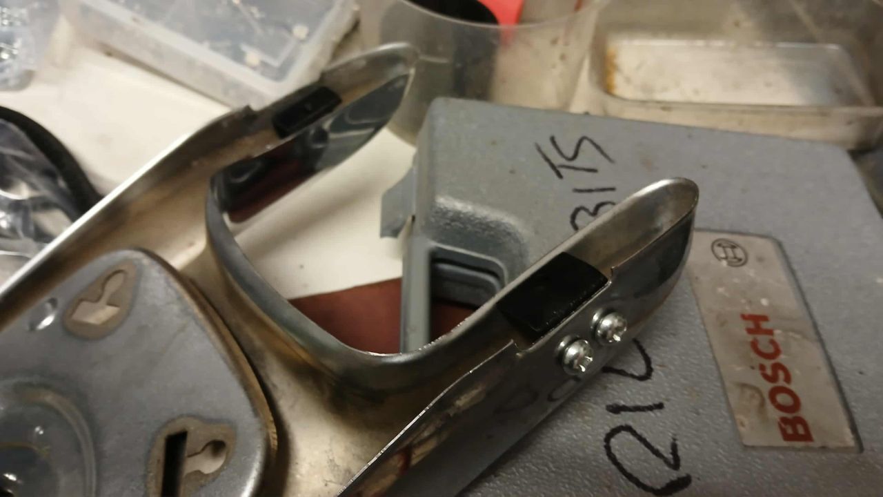

Ah. Although looking nearly identical '55 and '56 have different surrounds, going from a diecast part to a pressed steel one. I think I can get away with using the '55 part with a bit of modification, the area around the grille is a slightly different profile but I reckon it won't be that noticeable once bolted to the rest of the scrap that is forming the finished car.

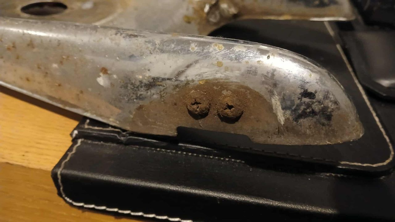

Also my new NOS '56 was missing it's mounting bracket.

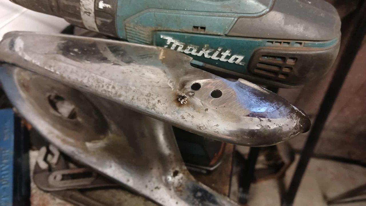

Not a problem, I'll just unscrew one off my knackered old one.
These obviously immediately rounded off despite my best efforts.

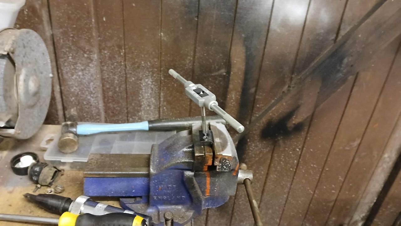

So I did the right thing and ground the screw heads off and then drilled out the remnants before a rattle can resto.
I'll need to re-tap the bolt holes before reassembly.

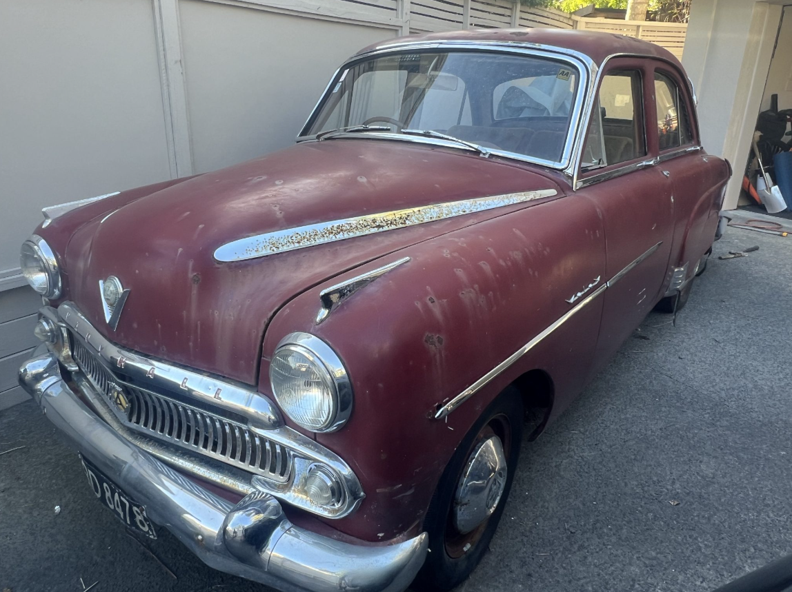

I've been looking for a similar Cresta for sale now and can't find one, which is pretty incredible. The closest I can find is this 56 Velox in NZ. The survival rate  doesn't seem to have been good for these.
Survival rate was abysmal. They mostly went in the bin before they were 10 years old due to major rust issues. Australia and NZ have the highest survival rate by far, due to being a popular car built locally in knock-down kit form and the lack of rust proofing not being as big of an issue. There are also quite a few survivors in South Africa and India, for similar reasons.
This is a photo from 1962, that Wyvern is 7 years old and even from this distance you can tell it is very rusty along the sills and doors, even compared to the older Austin Somerset next to it.
I've been to a lot of car shows and have seen one E-Series...
They also became unfashionable very quickly. As a 1940s design by the mid 60s they were very dated. As the mid 70s rolled around the PA series (as @eddyramrod has) became collectable quite early on as a 1950s rockabilly icon. The E-Series was always a bit more stodgy and the earlier cars with the "crossbow" grille were the first to really become worthy of preservation, but by then most had been long since scrapped.
