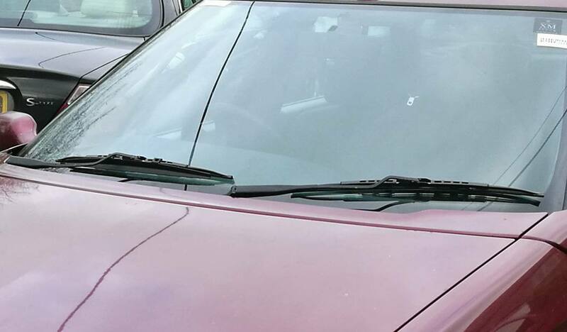

Six-cylinder Posted April 9, 2021 Author Posted April 9, 2021 I am looking for a front wiper motor for our Citroen XM? My garage says it is getting power but all functions only work when they feel like it and they have asked me to find a replacement motor. 1997 XM 2.0 16v auto RHD. Has anybody got one they can sell me?

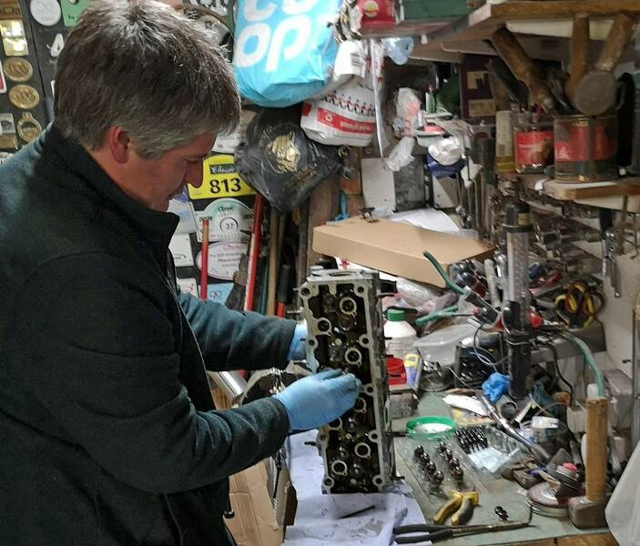

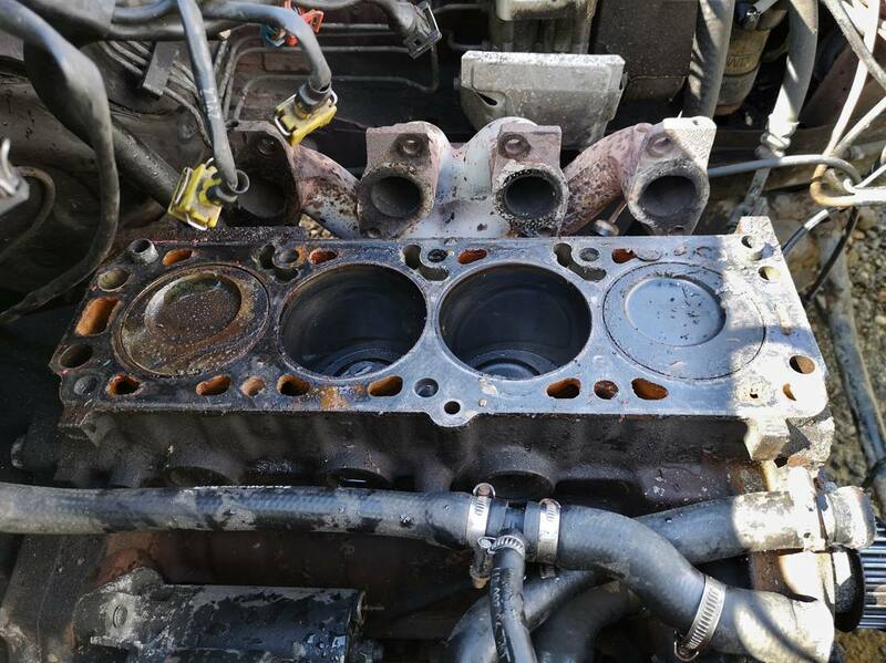

Six-cylinder Posted April 11, 2021 Author Posted April 11, 2021 Today was the beheading of the Carlton, Talbot took his axe and sliced it clean off. Turns out it was pretty straight forward and nothing was really stuck. In fact some bolts seemed quite loose. There is just a bit of corrosion on the head, but it should be fine again with a skim. Talbot has stripped the head and the next stage is for me to get it skimmed. Floatylight, Asimo, LightBulbFun and 18 others 21
Talbot Posted April 12, 2021 Posted April 12, 2021 Definitely a bit of an odd one this. Several items that I expected to fight me all the way were actually incredibly easy and required zero effort to remove. As stuff was being disconnected, I was expecting to find the head gasket had been chaned within the last 3 years or so. However, the HG itself was/is completely knackered and falling to bits, so either it's older than I think, or it's been run with seawater in the cooling system for the past few years and rotted everything out, gasket included. Still, it came off without much issue, leaving a trail of brown mayonnaise everywhere. Other than the failed HG, everything else looked in fine fettle. The only slightly concerning point is the head corrosion shown in the last photo above. The photo makes it look worse than it is, and I think a decent engineering workshop will be able to recover that head back quite well. There's a fair bit of internal corrosion in the water channels (hence my comment above about it being run on seawater) but the head face isn't bad at all. What's quite odd is working on an engine that was designed for transverse FWD applicaitons, and that I only know from transverse FWD applictions that has been shoved sideways under the bulkhead. The distributor is completely and utterly inacessable on this installation, and the additional bits and bobs that have been bolted onto this engine to make it work in a RWD application are quite amusing. The best one is the "fake" water pump, which is about 100mm from the real water pump. It's just a casting with a bearing in the end that the radiator cooling fan can run on, which then necessitates the massively long duct from the radiator to the fan. You'd think Vaux would have just shoved an electric cooling fan on the rad and be done with it. That said, the gap between the radiator and the cambelt end of the engine is absolutely comical, so I think they needed something to fill the space! One thing that is really quite knackered on this engine is the belt covers. The captive studs in the back cover have almost all ripped out, and the front cover is broken in many places. I was wondering about asking on Mk2Cav.com to see if anyone has a spare set of covers. Is there any other Vaux-based forum that might have someone who can help? Mrs6C, Coprolalia, Dick Cheeseburger and 7 others 10
